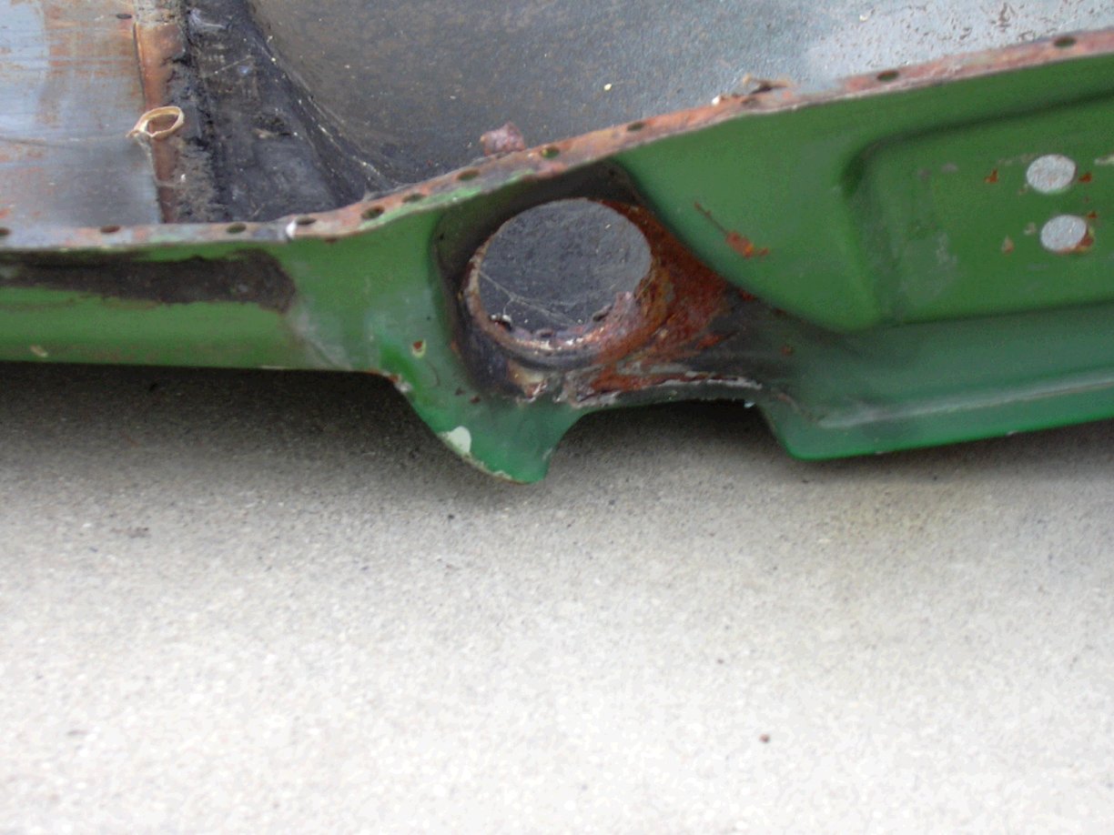

QUOTE(kafermeister @ Feb 11 2004, 10:16 PM)
the door jam should be kept with the quarter to make things simpler. The hard part is the fresh air pickup (vent?) in the door jam.
IIRC, the factory used lead in the area of the air exit tube on the door jamb to smooth things out.
IIRC, the air tube is brazed to the door jamb.

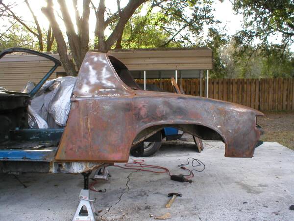

Hi Rob,
Is the existing quarter panel unrepairable? In the picture, it looks like one to be straightened maybe?
John www.ghiaspecialties.com

John,
The panel is repairable, but there is a lot of rust underneath. Also, I need to remove to repair the inner engine compartment side wall and behind the striker is very rusty. The panel I'm replacing it with is almost perfect. Maybe after I remove it, John, you can give me some pointers on straightening it out.

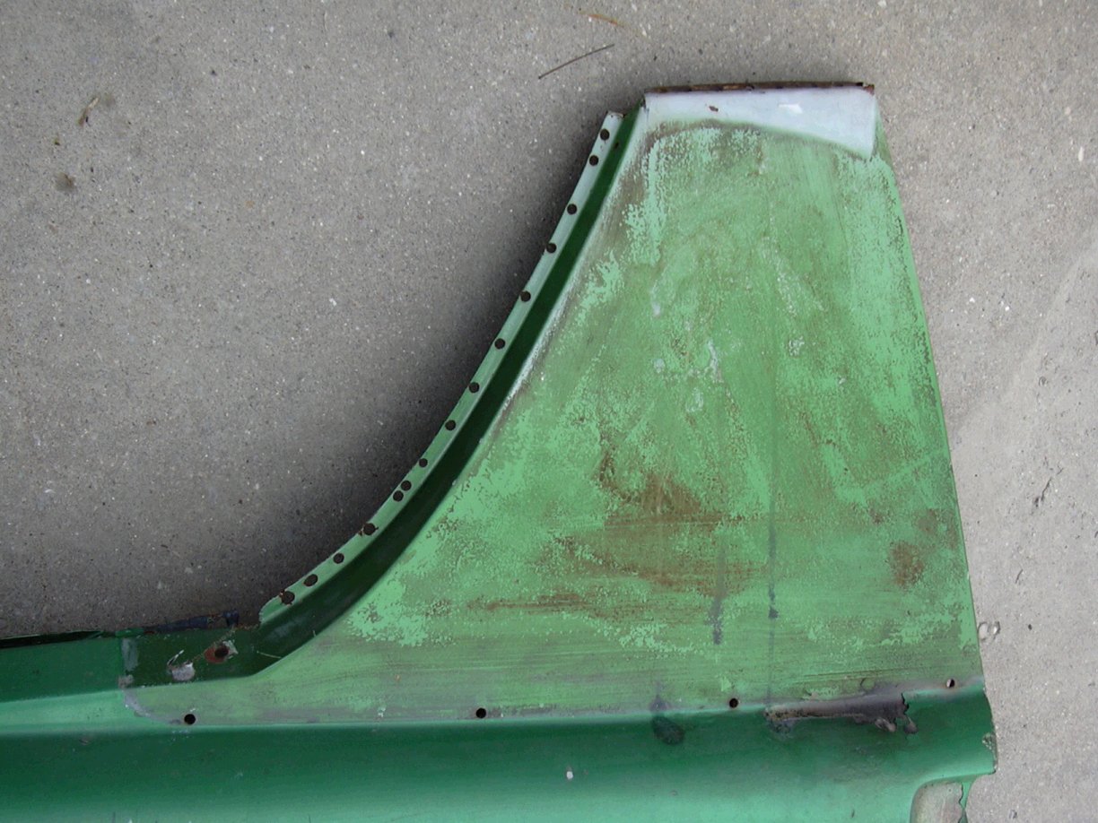

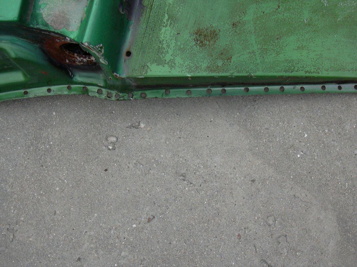

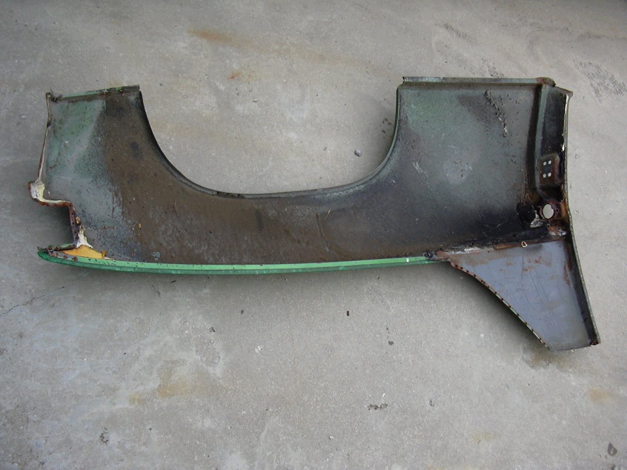

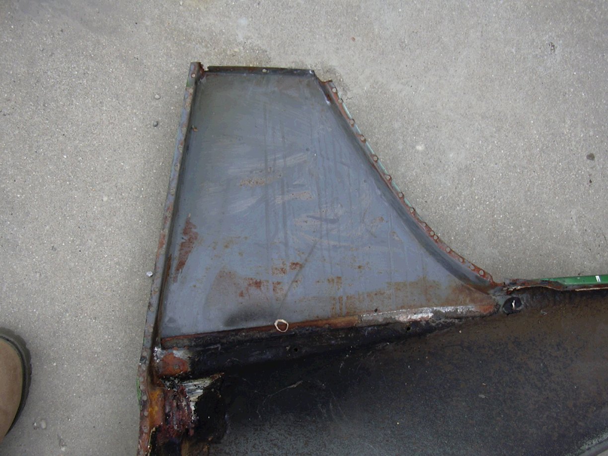

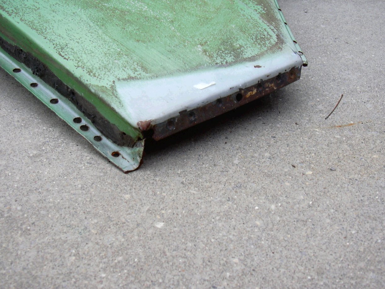

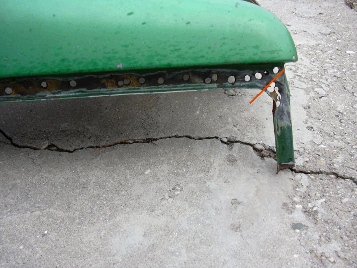

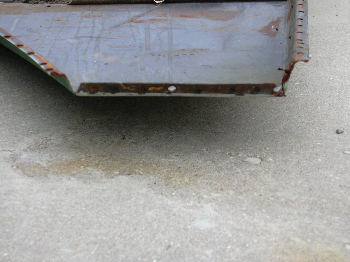

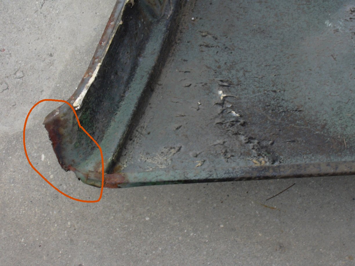

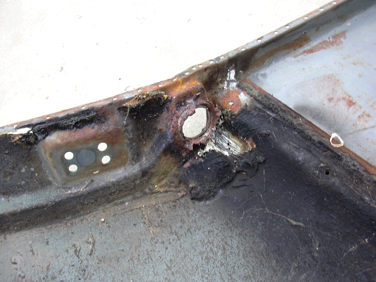

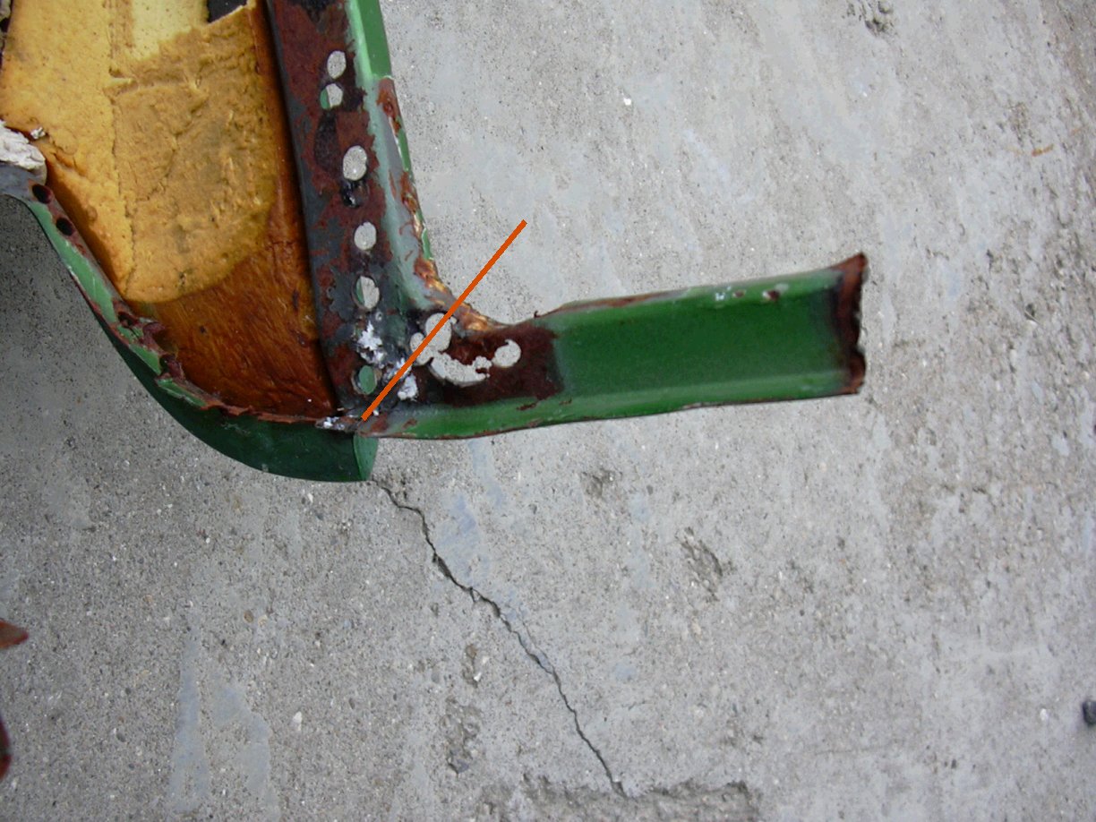

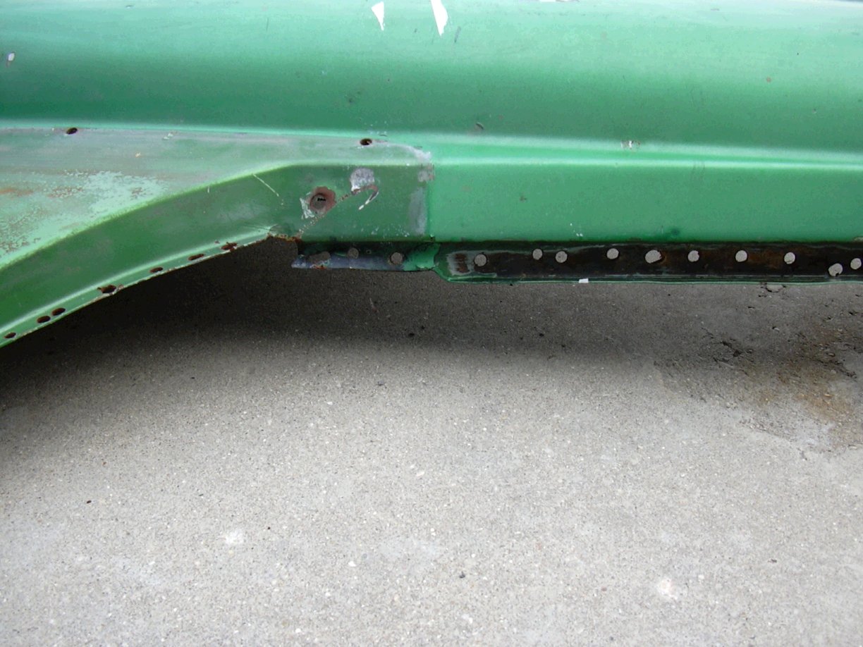

Okee dokee. This is a fender that another listmember sent to me for the Kafermeister Special. I've marked some of the pics with red lines in areas where I'm not too sure where the original Karmann fender stops and the rest of the tub starts.
The following images are 237k or less in size. I have full size images that arround 1mb each. I can get those to anyone who wants them. I can also take more detailed pictures of specific things if it would help.
Rick
Pic #1
kafermeister
post Feb 12 2004, 05:07 PM
Posts: 778
Joined: 20-January 03
From: Cincinnati/Northern KY
Member No.: 174
Pic #2
kafermeister
post Feb 12 2004, 05:08 PM
Posts: 778
Member No.: 174
Pic #3 of 15
kafermeister
post Feb 12 2004, 05:09 PM
Posts: 778
Member No.: 174
Pic #4 of 15
kafermeister
Posts: 778
Member No.: 174
Pic #5 of 15
kafermeister
post Feb 12 2004, 05:10 PM
Posts: 778
Member No.: 174
Pic #6 of 15
