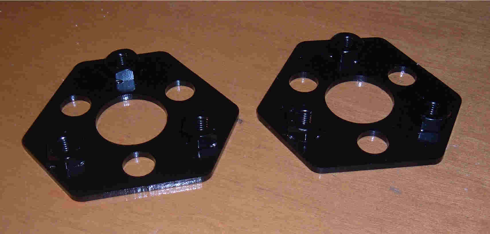

Please see http://engmanparts.com for details. Set of 2 - will work with up to a 31mm sway bar.

Can you explain a little?
I can see there's more meat to the plate it self, but what about the extra holes?

The 3 holes are to be puddle welded to the car, then weld the edges all around. This plate is almost 50 percent larger than the old ones - you will have to notch out more area to fit it in.

Whats the ID of the hole?

You can go up to a 31mm sway bar - largest I know of.

Whats the ID in inches?

These are sized at 1.24" currently - I *can* open up a set to 1.31" if you are interested.
