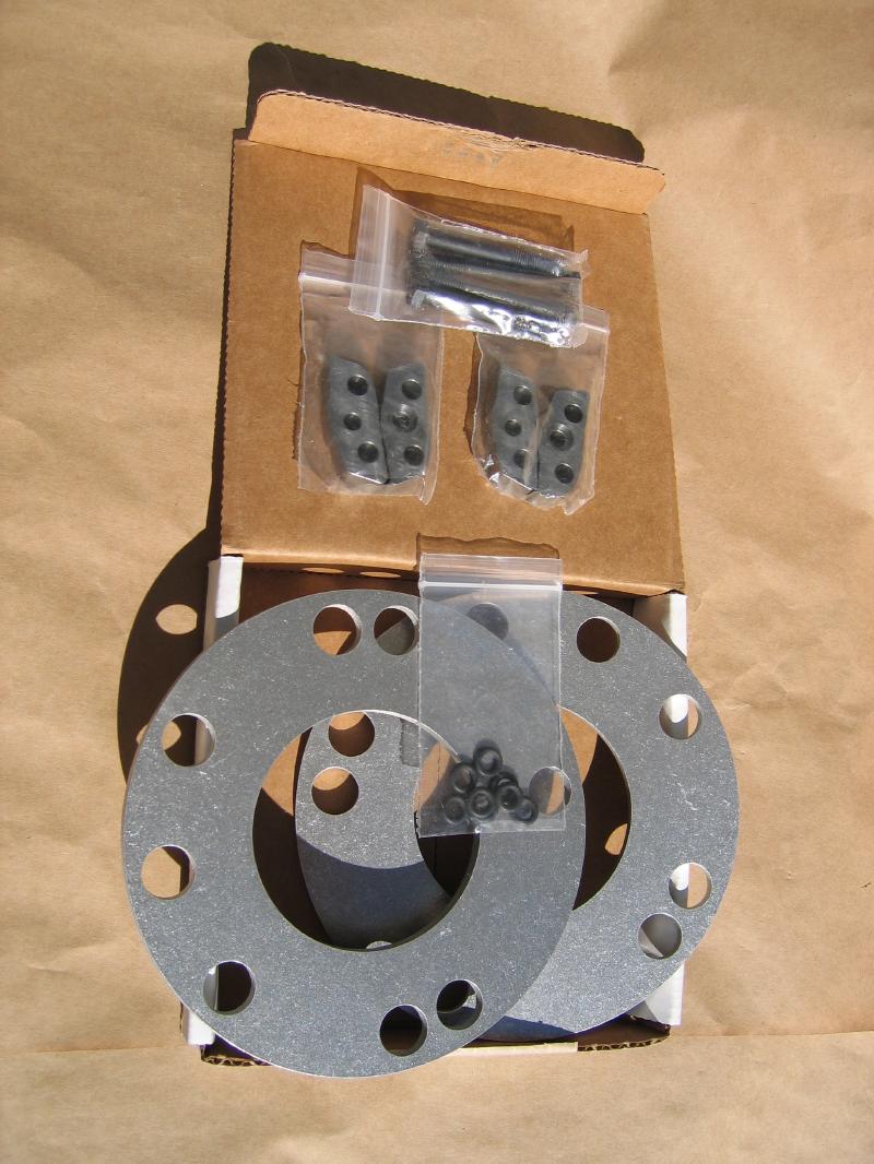

NEW V-CALIPERS ARE HERE!
The V-Caliper was designed to allow teeners the use of a vented rear rotor on their 4 or 5 lug cars (If you’re going to remain 4-lug you’ll need to have your rotors drilled for the 4 x130mm pattern). These are sold as completed calipers on an exchange basis and have all the features of our regular caliper rebuild service.
Here's what you get:
* Disassemble caliper
* Bead blast caliper to bare metal
* Replate with factory silver zinc plating.
* Hone the cylinders
* Polish Pistons
* Install piston and adjuster screw rebuild kits
* Lube and reassemble the caliper
* Install caliper spacers
* Special rotor spacer drilled for 4 or 5 lug applications
* Longer brake pad pins.
Pricing is $455.00 per pair plus core and shipping. I only sell these in pairs (obviously). Shipping is a flat $9.30 for Priority Mail to anywhere in the continental United States. For international orders you can still use the USPS link. Boxed weight is 17lbs. You can calculate postage from 84092 using this site USPS Shipping Calculator
This application will now use the standard 1970-1977 vented rear rotor. The vented rotor will need 4mm turned off the outside edge (8mm total) to work with the V-Caliper. We can supply new Zimmerman rotors for $75.00 each plus shipping.

NEW V-CALIPER KITS ARE HERE!
The V-Caliper kit was designed to allow teeners the use of a vented rear rotor on their 4 or 5 lug cars (If you’re going to remain 4-lug you’ll need to have your rotors drilled for the 4 x130mm pattern). If you’re mechanically inclined and you want to rebuild your own calipers, here’s your money saving alternative.
These kits are designed to work on the 1973 through 1976 (late) calipers that use the machined caliper nose and hex bolts. The early through bolt hardware is no longer available in the States and would be cost prohibitive. Everything in this kit will work on an early caliper with the exception of the hardware.
The kit includes:
* (4) Caliper spacers (enough for two rear calipers)
* (8) Longer 11mm hex bolts.
* (8) Caliper seals.
* (4) Longer brake pad pins.
* (2) Rotor spacers drilled for 4 or 5-lug applications (vented rotors need to be drilled for 4-lug applications.)
Pricing is $225.00 per set plus shipping. Shipping is a flat $9.30 for Priority Mail to anywhere in the continental United States. For international orders you can still use the USPS link. Boxed weight is 1lbs. You can calculate postage from 84092 using this site USPS Shipping Calculator.
This application will now use the standard 1970-1977 vented rear rotor. The vented rotor will need 4mm turned off the outside edge (8mm total). We can supply new Zimmerman rotors for $75.00 each plus shipping.

Now... regarding the washers: These kits come with rotor spacers (shown prominently above in each picture) that move the rotor out 4.88mm to center it in the now widened slot. We've had customers put the rotor spacers "on top" of the rotor vs. "underneath" the rotor where it is meant to go. This may be what happened. The proper mounting procedure is:
1. 5-lug hub
2. Rotor spacer on hub
3. Rotor on top of rotor spacer
There are two methods to align a rotor in a widened caliper; You either need to space the rotor out with the supplied spacers or you need to space the caliper back with washers or mounting ear spacers. I don't recommend the washers ear spacers because of clearance issues with these calipers (as you now know). Others have done them with no modifications needed.
From your comments above I can only assume that the rotor spacers were not used. That being the case, you would "have" to shim the caliper back 5mm hence the "bunch of washers" and hence the clearance problem with the control arm.
Mike's a smart cookie so I'm guessing that the extra 5mm under your rotor might have caused clearance issues with your wheel/tire combo necessitating the "other" method of spacing the caliper back. (IMG:style_emoticons/default/wink.gif)

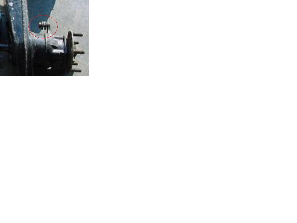

1. Hub offset vs. a 914 hub. I can almost see it in that picture in the link. Those hubs are laying very flat but... that's a picture and I may be reading into it. Are they the later hubs with centering rings? I can't seem to make that out in the picture. If so, this is your problem. You'll find some threads here about 5mm spacers that have been manufactured to make them work. This would be my "first" guess. Later hubs need spacers to bring them out... otherwise you will have the problem you have.
2. If the hubs are correct I would then look at the rotors. Are we sure they are 911 rotors? They could be 944 rotors. They look identical to 911 rotors but are shallower making it necessary to space the rotor out and the caliper back.
Your opportunity (not a problem) is hiding in one of those two areas... (IMG:style_emoticons/default/wink.gif)

I looked at the eBay picture again and I would almost bet on the hubs. In the picture you can see a bolt with washers strewn along the shaft. I'm betting the previous owner had the same problem.
