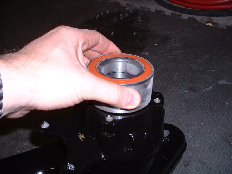

Step 4 – Install your now frozen bearings. I’ve seen these range from a virtual “drop in” fit to a “press in” fit. Porsche says use “special tool P302”. P302 is described as a ”thrust piece”. My “thrust piece” is an old bearing housing. I use a piece of flat steel on top of the old bearing and lightly tap the new bearing in. You must make sure the bearing is going in straight, if it goes in at an angle you’ll ruin the bearing and possibly the control arm. Be patient and tap lightly. As the bearing gets further down in the pocket you can begin to assert more force. Some may need to be pressed in the last few millimeter’s.

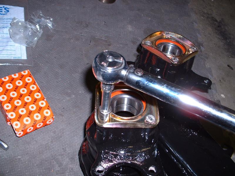

Step 5 – Once the bearings are in, install the bearing caps. Torque the bolts to 18-ft lbs.

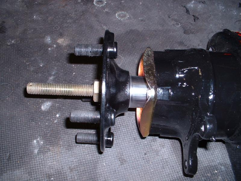

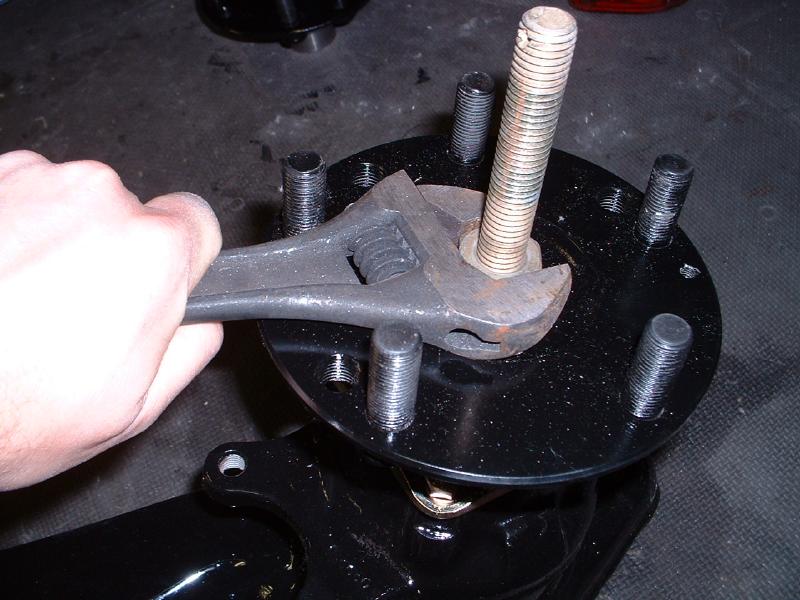

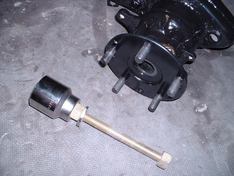

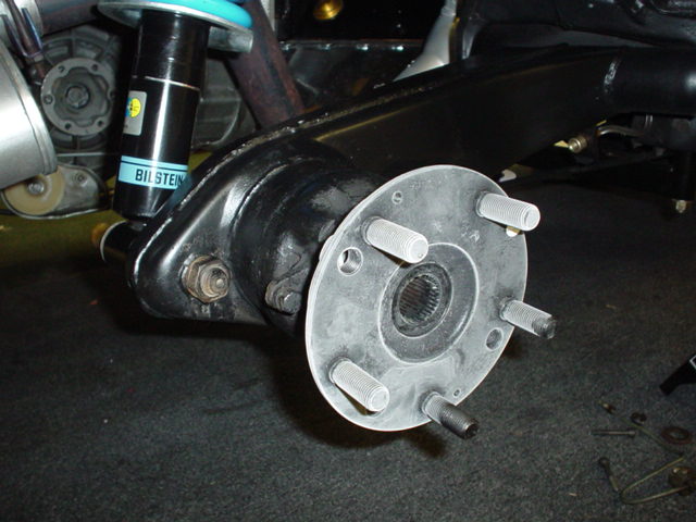

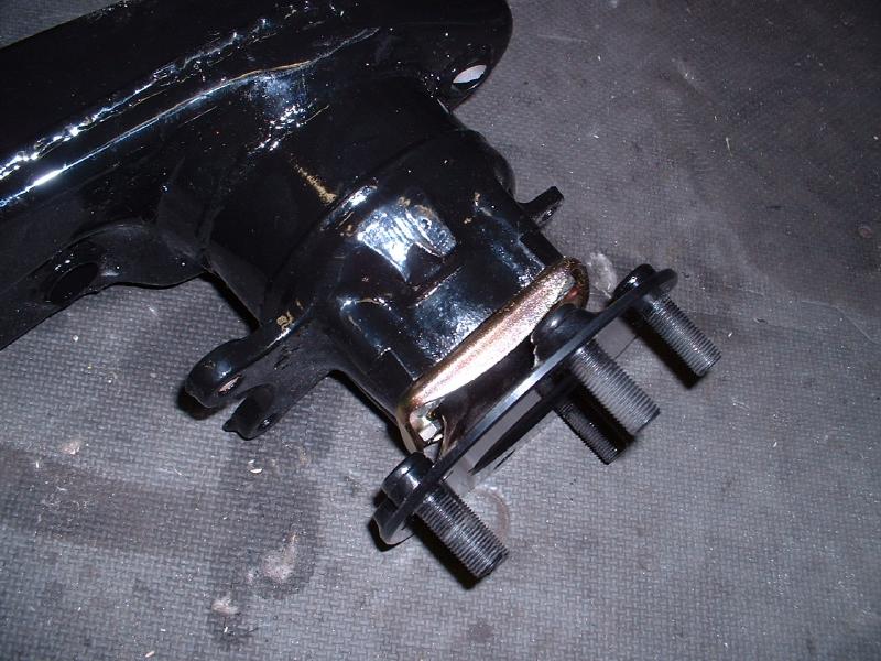

Step 6 – Now it’s the time to reinstall the hub. Porsche says use the P298b assemble fixture. Most searches on the site give the answer to this factory tool dilemma. Use the stub axle. Slide the stub axle through the bearing from the backside and slip the hub over top it. Use the castle nut “upside down” to grab the first few threads on the stub axle. Once you get it started you can turn the castle nut over and finish the job. I only had 914-6 stub axles lying around and this set of control arms is for a regular 914 stub axle. I built a tool to draw the hub into the bearing. This consisted of a threaded rod and a few nuts and suitable sockets and washers. The main thing when performing this step is getting the hub in “straight” just as we did the bearings. You don’t want the hub pulled in at any exaggerated angle. Slowly crank it in.
You’re done. Put’em back on and enjoy the ride.

Getting started...

Getting closer...

The install tool...

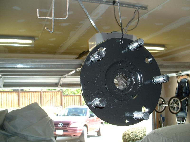

John2kx
post May 17 2004, 04:04 PM
Posts: 502
Joined: 22-August 03
From: Augusta, Ga.
Member No.: 1,066
Eric,
Great job on the procedure you used. Exactly how I did it with one exception. I froze the hub and allowed bearings to reach room temperature (actually overnight) before pressing frozen hub through bearing. Used a similar tool and found it real easy to drive home.
John
Eric_Shea
post May 17 2004, 04:33 PM
PMB Performance
Posts: 19,304
Joined: 3-September 03
From: Salt Lake City, UT
Member No.: 1,110
Look at that frozen hub... great idea! (IMG:style_emoticons/default/smilie_pokal.gif)
