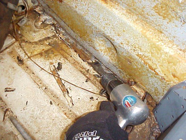

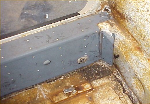

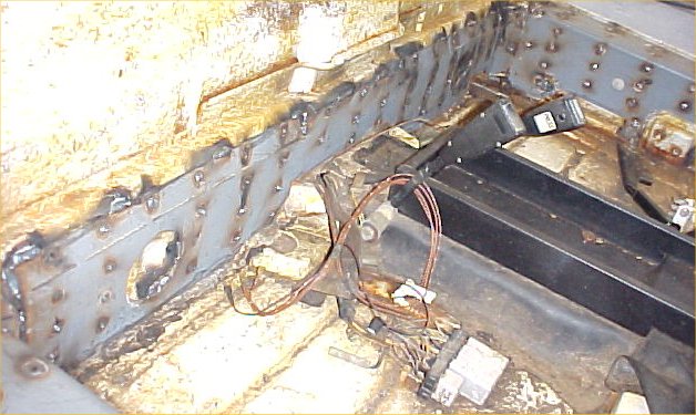

O.K. folks, here it is from start to finish:

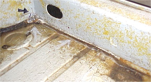

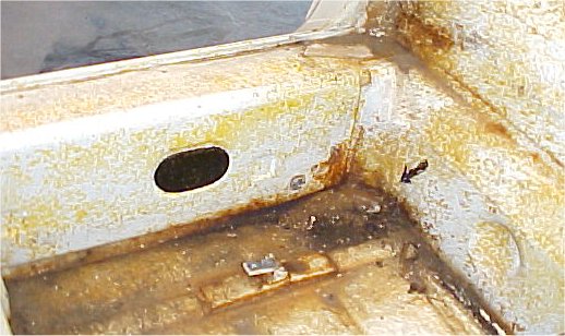

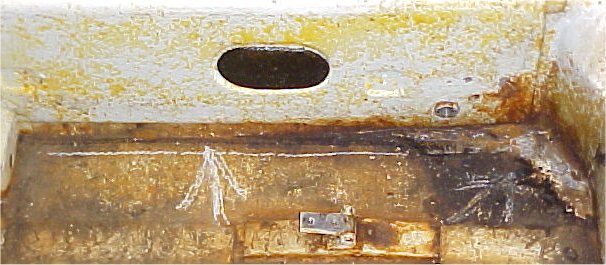

First you must remove the seam sealer and body tar from the inside corner of the longs.
trekkor   Inner long Chassis Stiff Kit install   Jul 18 2004, 11:44 PM

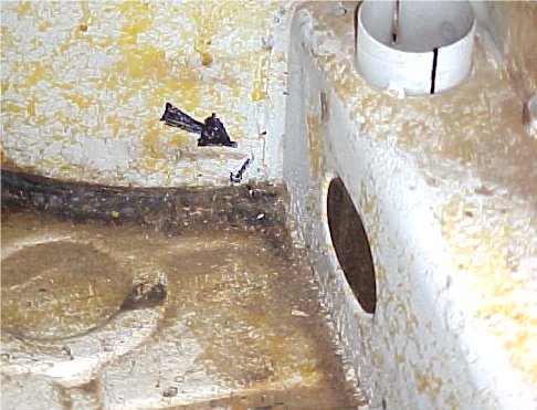

trekkor   It is very thick in the corners.   Jul 18 2004, 11:45 PM

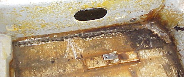

trekkor   notice the bead of seam sealer that must come out ...   Jul 18 2004, 11:48 PM
trekkor   another   Jul 18 2004, 11:49 PM

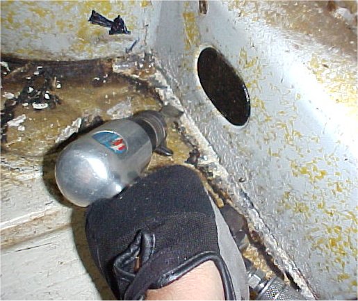

trekkor   an air chisel works very well to remove the materi...   Jul 18 2004, 11:51 PM
trekkor   the width of the chisel point using careful, short...   Jul 18 2004, 11:53 PM
trekkor   tar out   Jul 18 2004, 11:54 PM

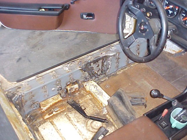

trekkor   without removal of the seam sealer and tar the she...   Jul 18 2004, 11:56 PM

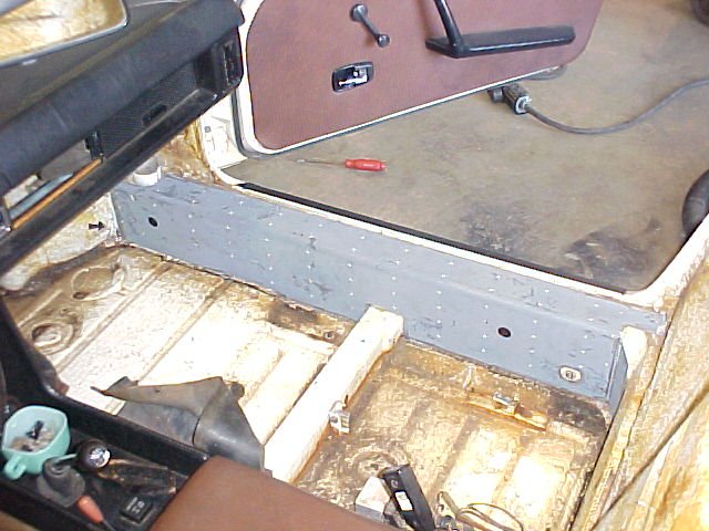

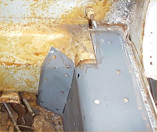

trekkor   passenger side drops right in.   Jul 18 2004, 11:57 PM

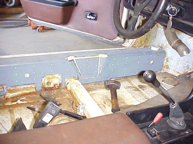

trekkor   driver side in. the area around the e-brake handle...   Jul 18 2004, 11:59 PM

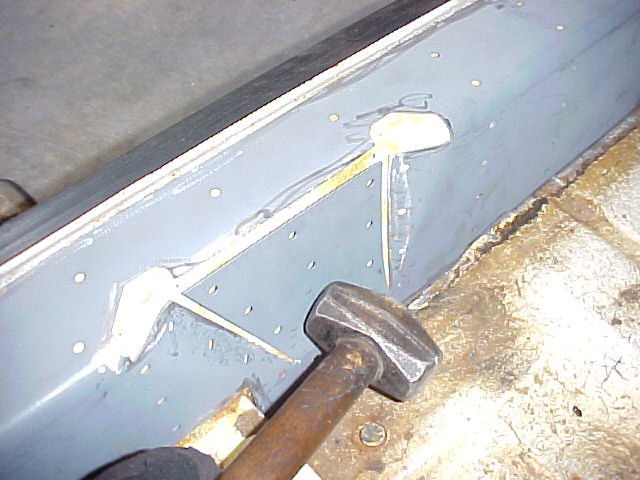

trekkor   more :smash: I like to grind the edges for a goo...   Jul 19 2004, 12:01 AM
trekkor   the inside corners need to be bent and worked into...   Jul 19 2004, 12:03 AM
trekkor   other side   Jul 19 2004, 12:04 AM

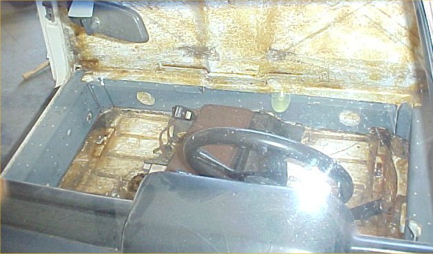

trekkor   back piece in . 3 sided dry fitment. Make sure it ...   Jul 19 2004, 12:06 AM

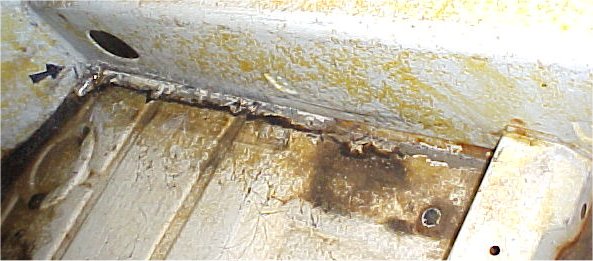

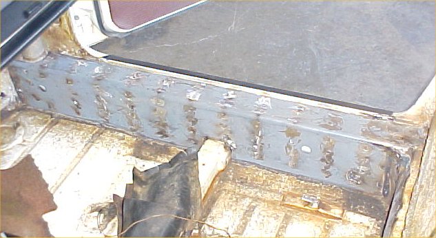

trekkor   :welder: put the weld in the hole and burn into t...   Jul 19 2004, 12:11 AM
trekkor   mask off the interior and windows so as not to dam...   Jul 19 2004, 12:13 AM
jgiroux67   What are the black ovals for that are on the passe...   Jul 19 2004, 12:13 AM
trekkor   driver side and ground down   Jul 19 2004, 12:17 AM
trekkor   back plate   Jul 19 2004, 12:18 AM
trekkor   all three sides tied in :welder:   Jul 19 2004, 12:20 AM
trekkor   corner detail shot   Jul 19 2004, 12:21 AM
trekkor   ready for paint   Jul 19 2004, 12:23 AM
trekkor   paint   Jul 19 2004, 12:24 AM
trekkor   rattle can , daddy :shades:   Jul 19 2004, 12:26 AM
trekkor   spray it   Jul 19 2004, 12:27 AM
trekkor   bird's eye   Jul 19 2004, 12:28 AM
trekkor   The black ovals are tar pieces that cover access h...   Jul 19 2004, 12:40 AM

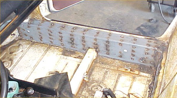

RON S.   Great job, :trophy: That is a great documentary o...   Jul 19 2004, 04:58 AM
sgomes   Awesome job both with the welding and the pictoria...   Jul 19 2004, 06:38 AM

trekkor   Miller wire feeder mig welder. When the wire hits...   Jul 19 2004, 05:26 PM
trekkor   The secret to good welds on thin material is low v...   Jul 19 2004, 05:32 PM

Qarl   I have a question... Is there a reason why you di...   Jul 19 2004, 05:46 PM
trekkor   Good question. :idea: My understanding is that a...   Jul 19 2004, 06:11 PM

trekkor   You could use silicone. I'm going to do that,...   Jul 19 2004, 06:35 PM
