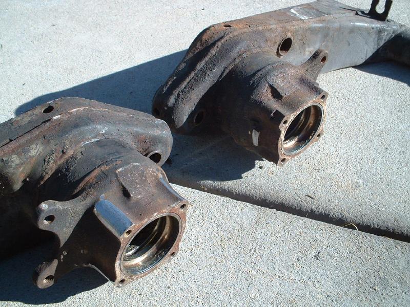

Control Arms off the car. Hand brake cable mount was cut off. Rear shield mount ground off. 2mm ground off the extensions on the rear bearing housing. 911 hand brake assemblies rebuilt. All parts glass bead blasted. Hard parts painted with POR-15. Mechanicals replated in silver zinc. Reassebmled and test fit to the 914 control arms.

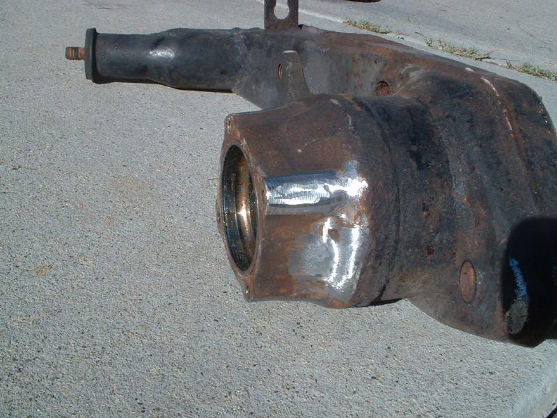

Shield tab ground off...

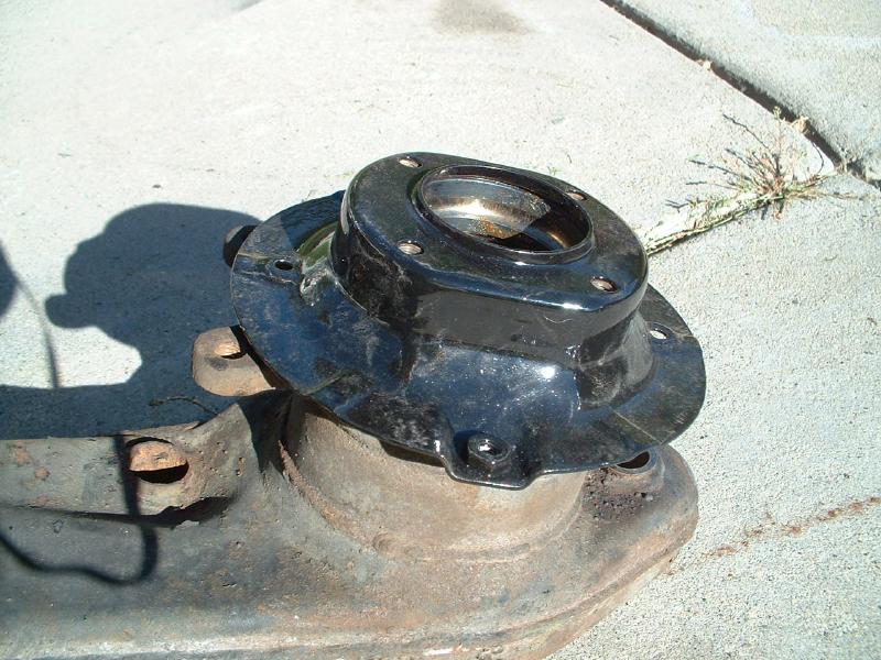

Backing plate test fit...

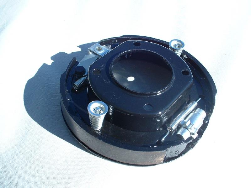

Rebuilt 911 hand brake assembly...

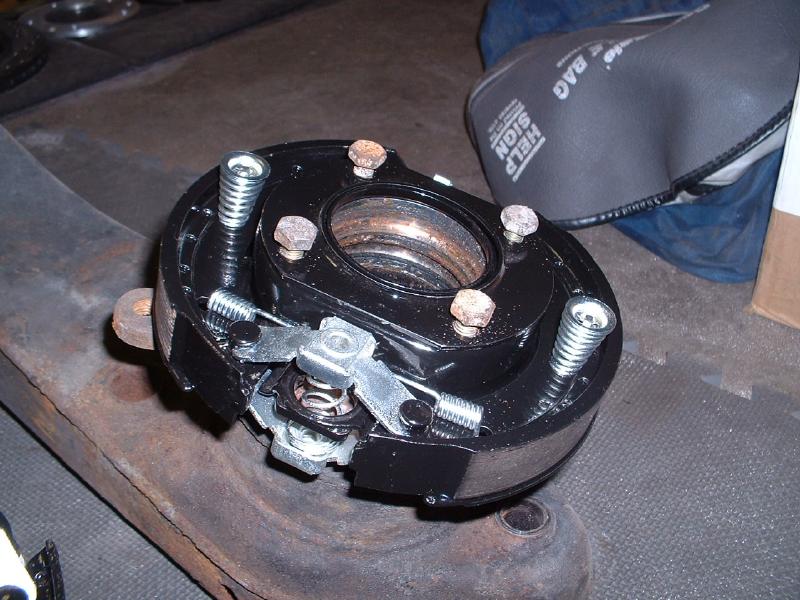

Test fit of the complete assembly. Next the control arms go off to the sand blaster.
I'll keep you posted!
