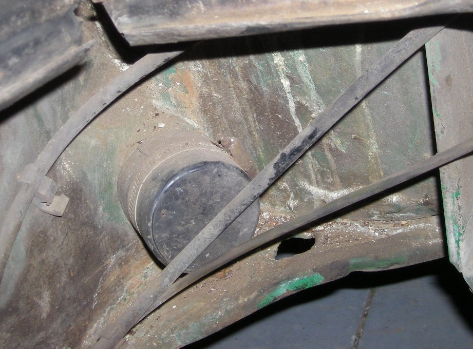

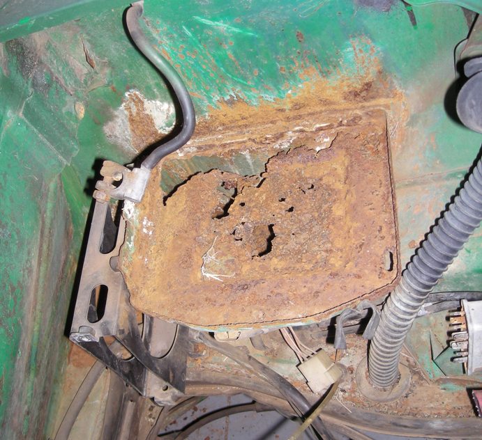

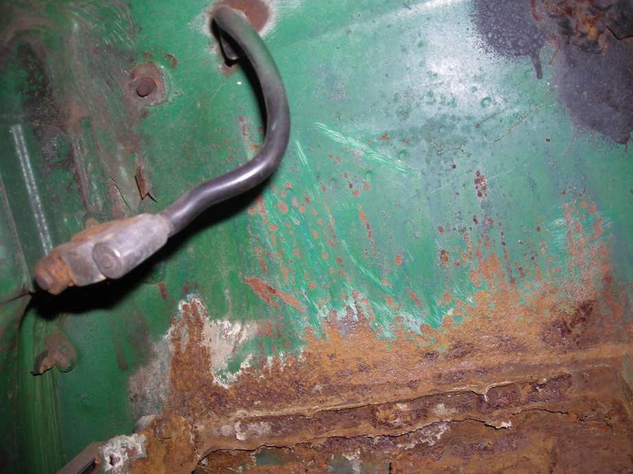

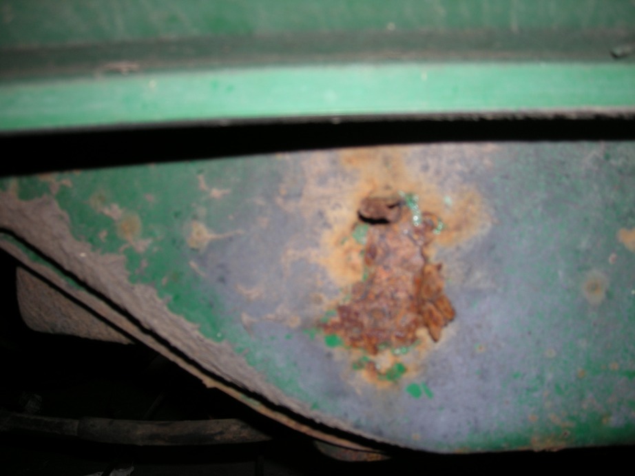

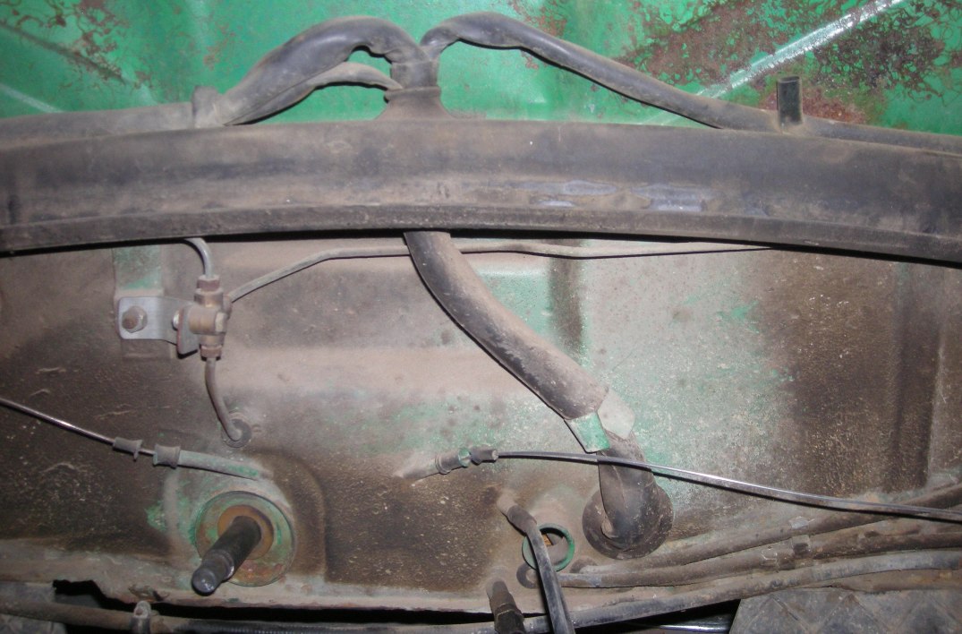

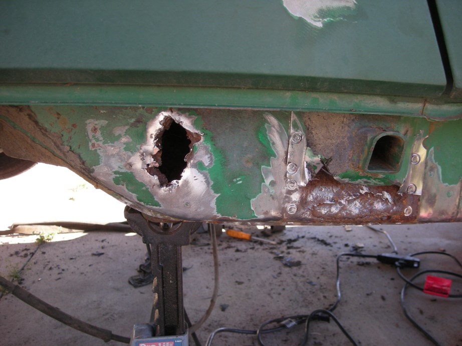

Got the car out this afternoon and Mel and I double-teamed it. She worked on getting the rest of the tarboard out while I worked under the car and in the engine bay. Some things found: The outer firewall is rusted to the point where a screwdriver goes through in several small places. The rust spot on the passenger long is actually a hole about 3-3.5" tall and 2" or so inches wide. Removed the seat belts and the trim in the back. Was going to cut out the battery tray but realized that I smelled gas. This made me rethink throwing sparks around. I don't think there's anything in the tank, but I'll go to drain it just in case the next time we have it out. Struck by DWS, I realized that I'm not far from a tub. The car could use some paint... Somehow Mel agrees with me that since we're close to having it stripped down, why not get it painted.. Why not indeed.. (Of course there's the cost, but hey, worth looking into..) Pictures

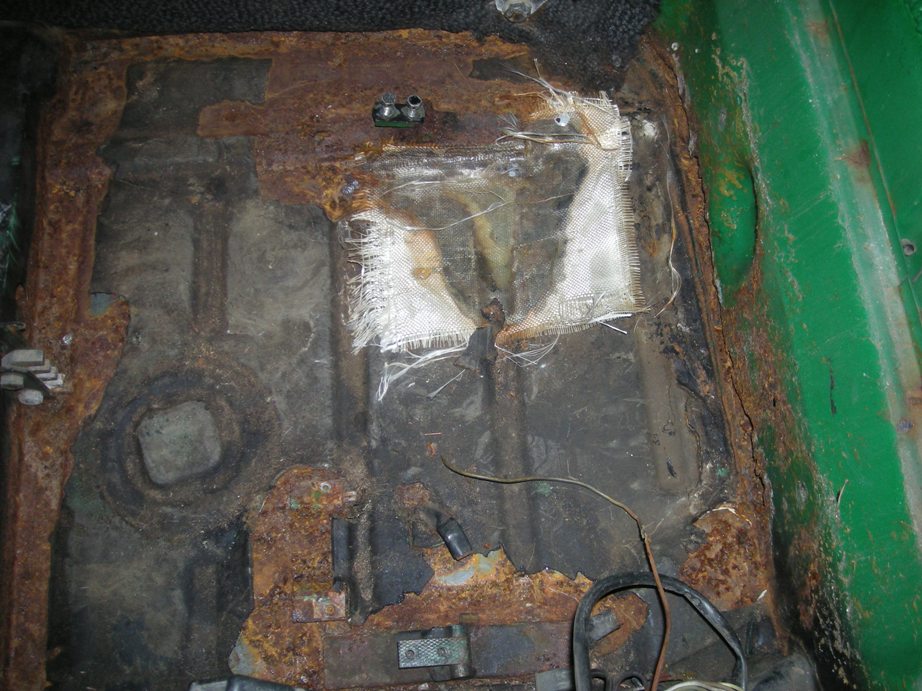

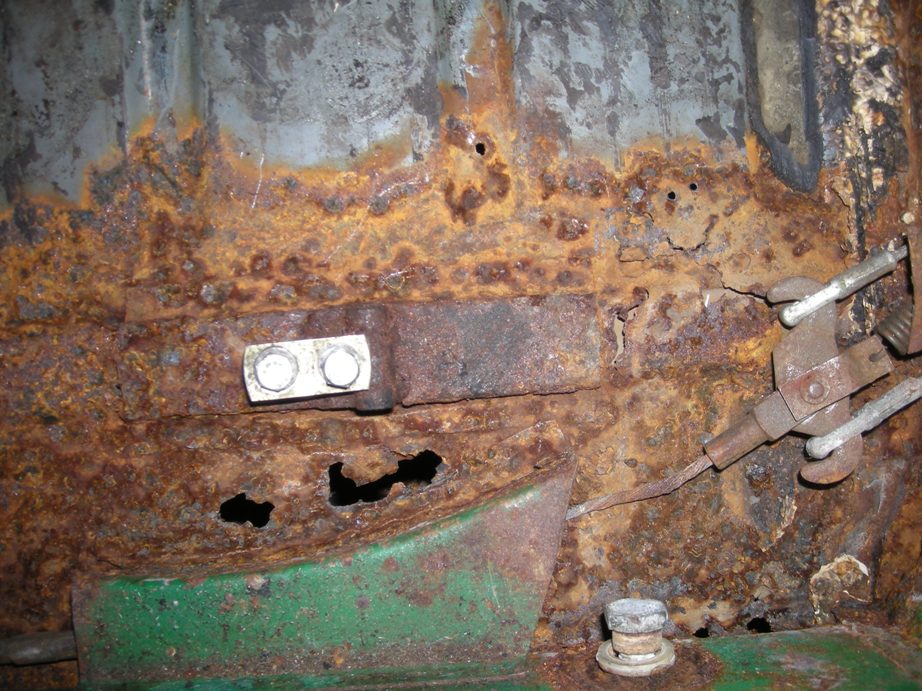

Since the weather was so nice yesterday, I took the day off to work on the car. Turns out I wound up doing other stuff for most of the day, but still got in a couple of hours or work. Cleaned the bottom of the floor pans with a twisted wire wheel on the grinder so I could see / access the spot welds. The cutter came in last night - I got a 3/8", but looks like I could go for a smaller bit... Dug into the rust spot on the passenger long - it's a bit of a mess, going through a bit of metal (1/8" maybe) i went to take a picture, but the batteries in the camera were dead. So the next time I have it out, I'll be drilling spot welds and cutting to good metal on the inner firewall. Should have some money inbound, so I'll be able to order parts that I need. The seat hinge mounts were paper-thin. Will be looking at the package from RD for the pan, mounts, reinforcements, ect. Also, since I'll have the engine out and the pan off, might as well replace the tunnel fuel lines. I'd thought to put that off until later, but hey, while I'm there. I have plans to get the car painted, perhaps at the end of the year, but since I've nearly got everything apart in the engine bay, I'll just take it to metal and get that nice and clean and painted as well. This weekend doesn't look condusive to working on the car outside, so may be next week before I get do anything... Will watch the weather and see..
No work done on car, but got order in on some spot weld cutters and replacement bits. Those will be in next week and I'll start cutting stuff then. If the weather clears up, I'll push the car out of the garage and start working on the underside . Need to do a few more searches and see how to get the steering coupler de-coupled and remove the last piece of carpet.

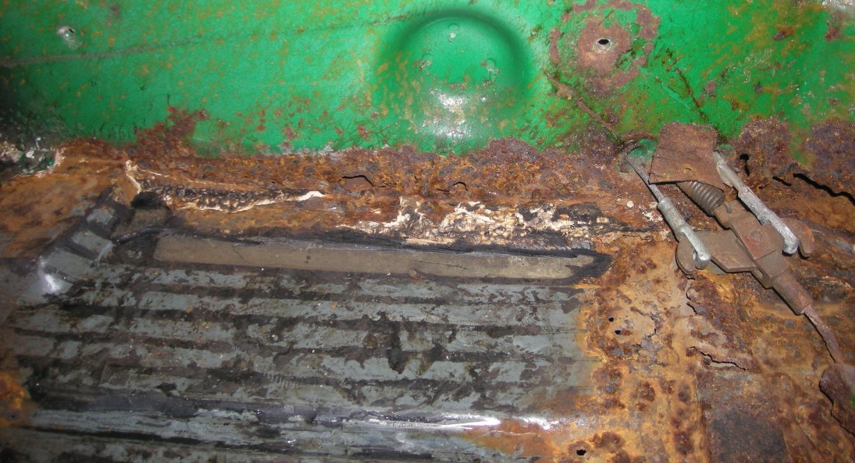

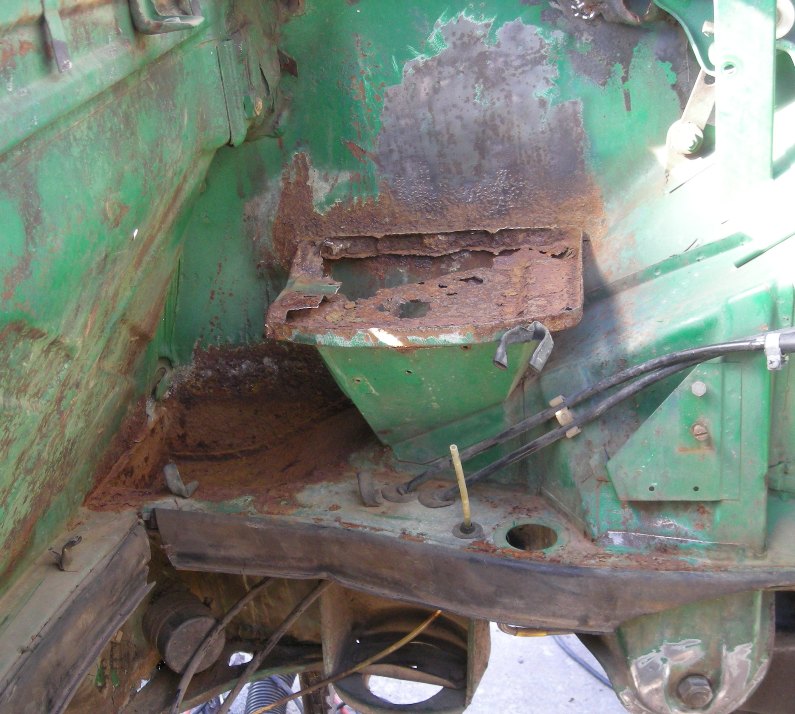

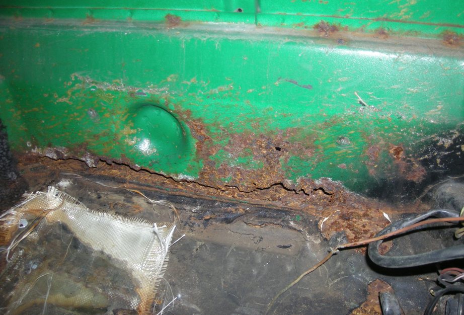

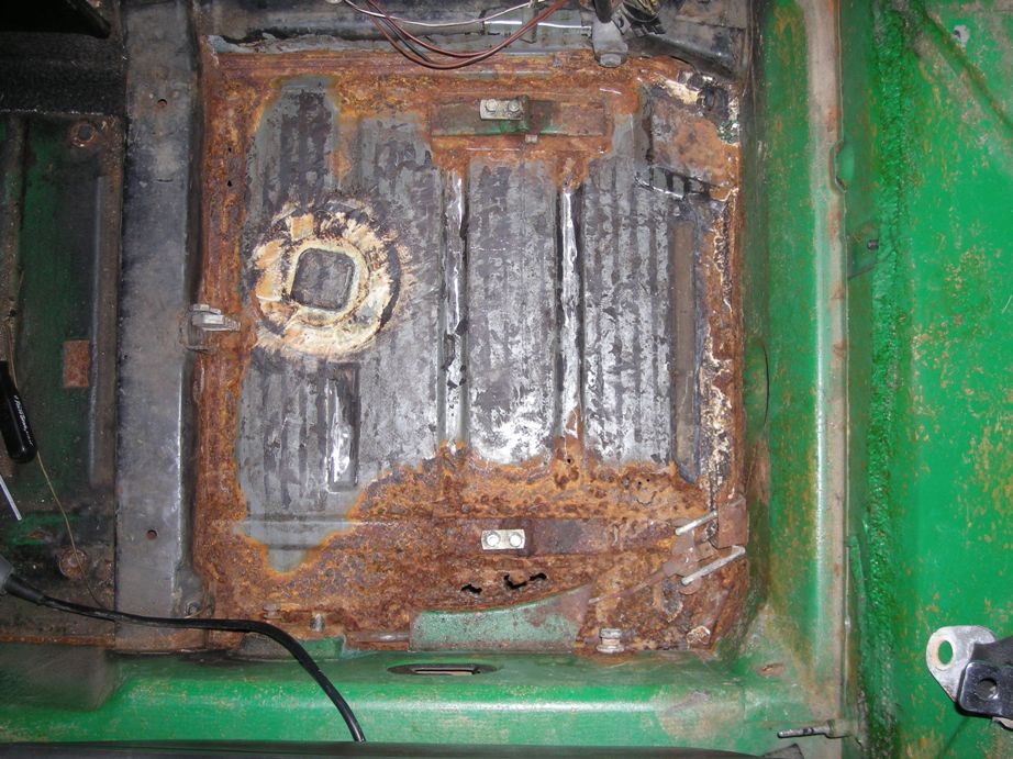

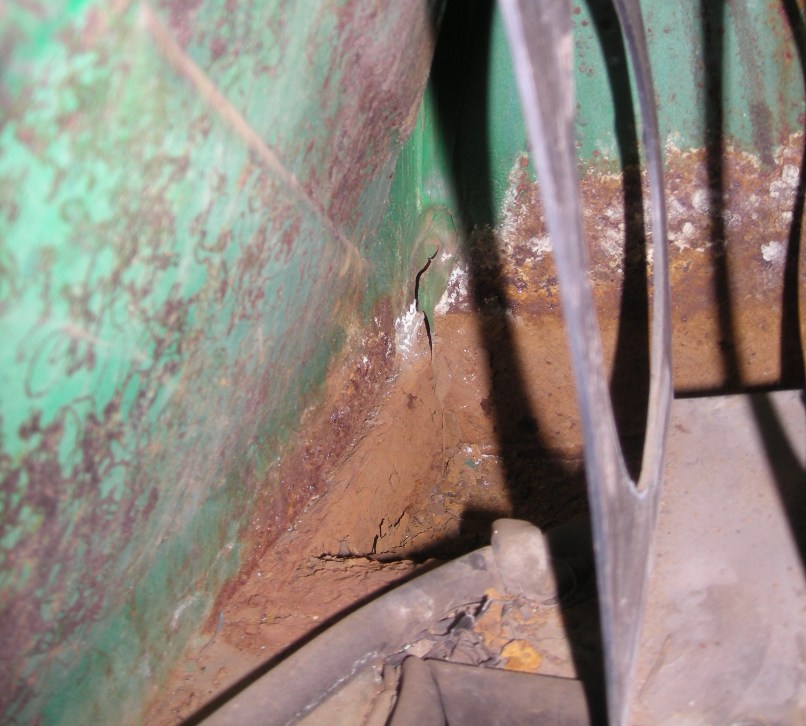

Pushed the 914 outside and spent some time getting more tar out of the floor pans. A friend of mine came over to see the car firsthand and determine what sort of assistance he could offer. So, once I have the car ready, he's up for coming to get it and helping me weld up the (soon to be) missing bits. Such as floor pan, inner firewall and battery tray / support. Found some more rust at the cowl junction on the underside of the panel. I'll mark that for clearing come winter, along with the rear trunk pan. With everything taken out of the car, the garage is now unusable again, so I sort of need to push it in and out to get anything done. Not so bad though...

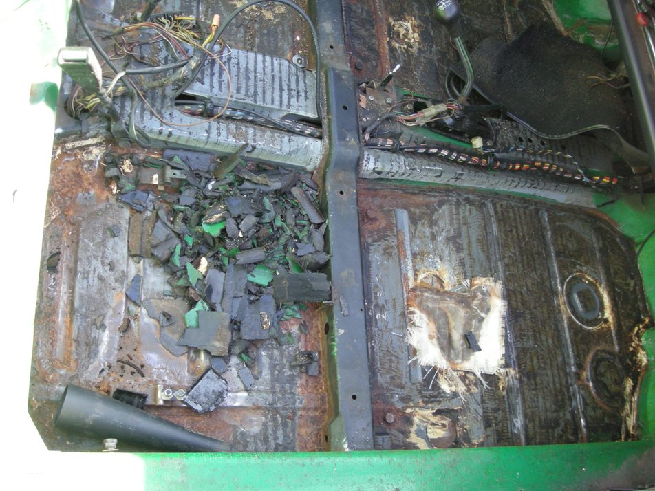

While I have no pictures to stick up, I did go out last night and spend another 20 minutes or so with the vibrating multi-tool and the tar. There's a bit of rust in the front floor pan as well. Once I get it all up I'll know if I need a full replacement or if it can just be welded up. A friend of mine is coming over Thursday to look at what I've got and see if he can help me get the welding done once I'm ready to do it. Another friend of mine is coming over Wednesday night and I'll have him give me a hand getting the engine on the stand so I can play with a couple of things.
