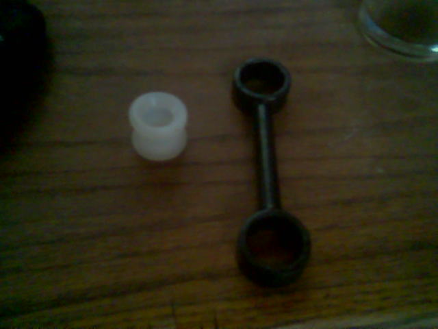

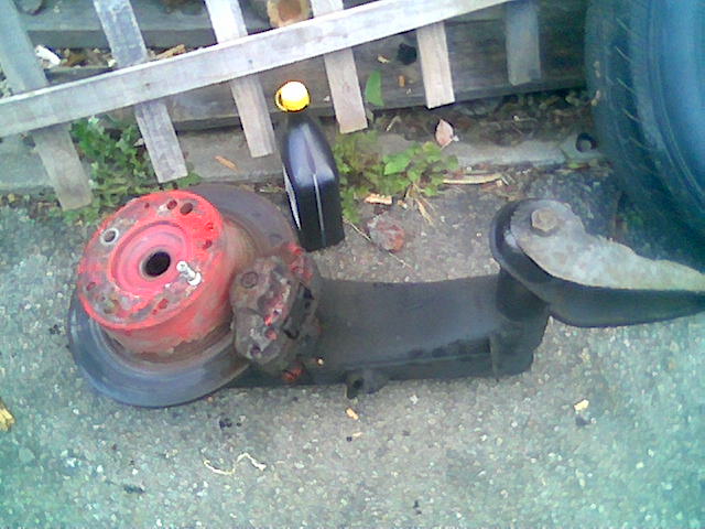

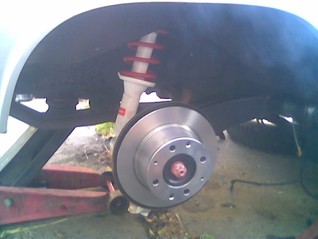

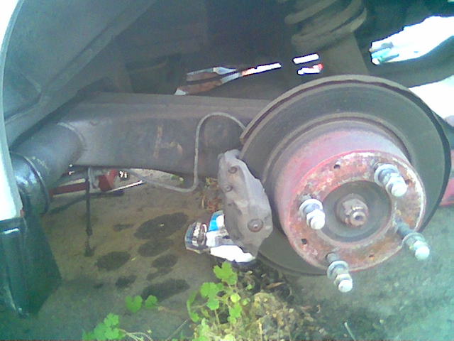

Removed rear swing arms from car put them in storage for a later day. New swing arms have been sandblasted and painted and bearings have been pressed in luckily I have a huge press at my desposal. We had to set fire to the swing arm bushings to get them out cut swirl liness in the new polybushings for lube properties.
Greased em up and they slid right in.

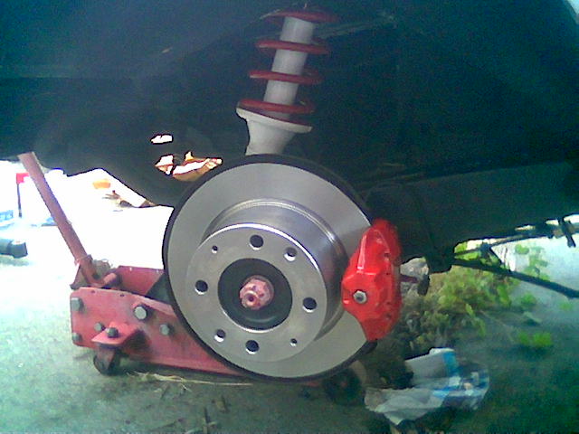

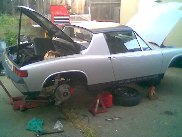

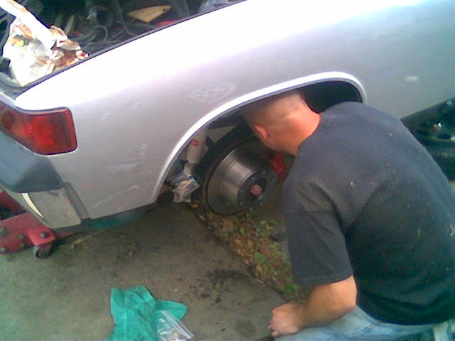

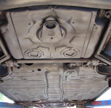

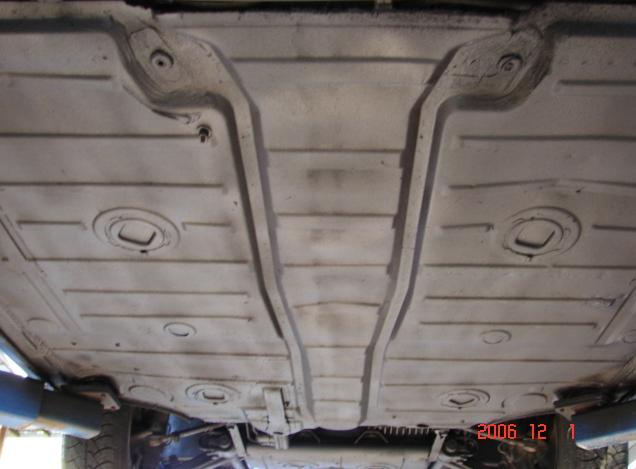

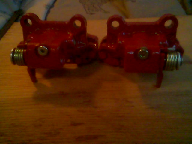

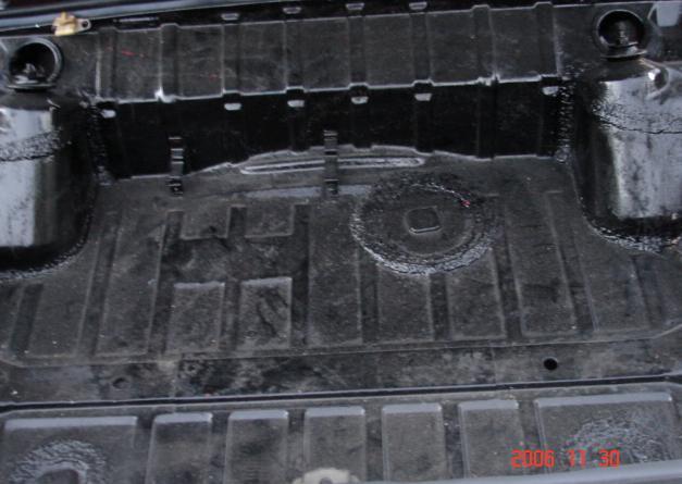

We put in new stainless braided brake lines and did a little under cleaning it was a frickin mess on one side due to a leaky rear caliper. There are some pictures of the old swings and the new ones bolted up. I keep forgetting to take more pictures untill after most stuff is done ohh well Its my first blog and I will get better the more we do.

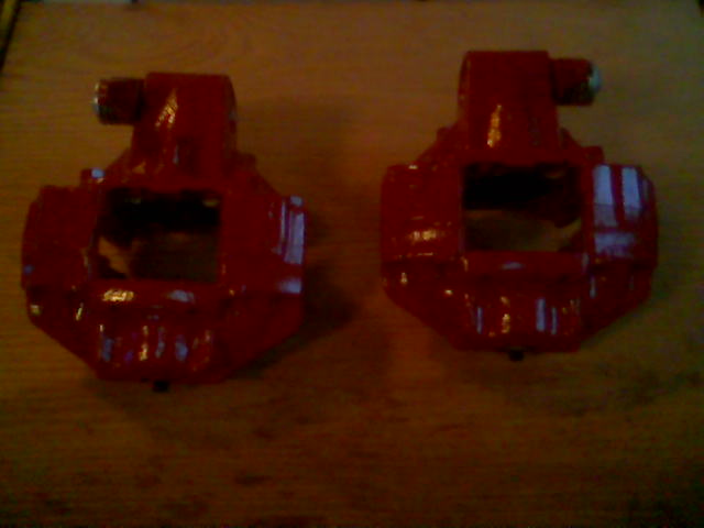

The EBC brake pads were great but we had to ream out one side for the PINS to go through. So we put them in a vice and went to work. It was loads of fun.
