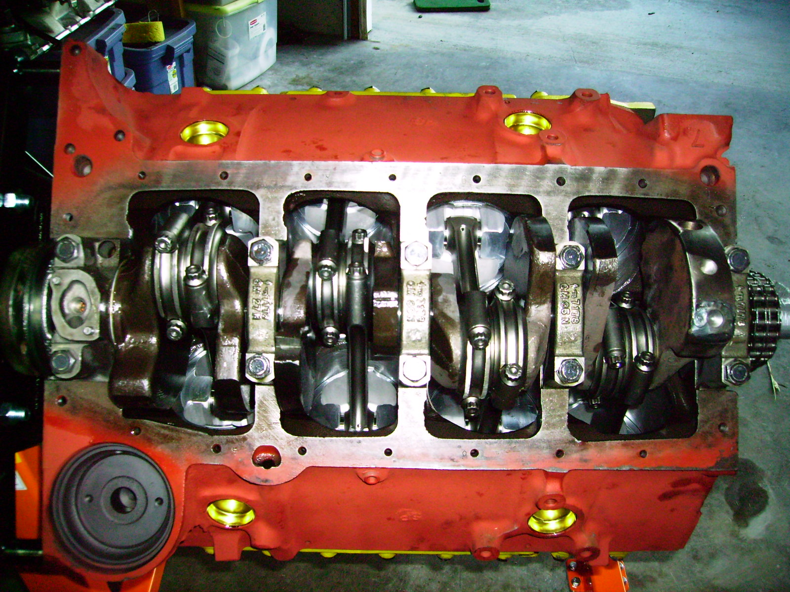

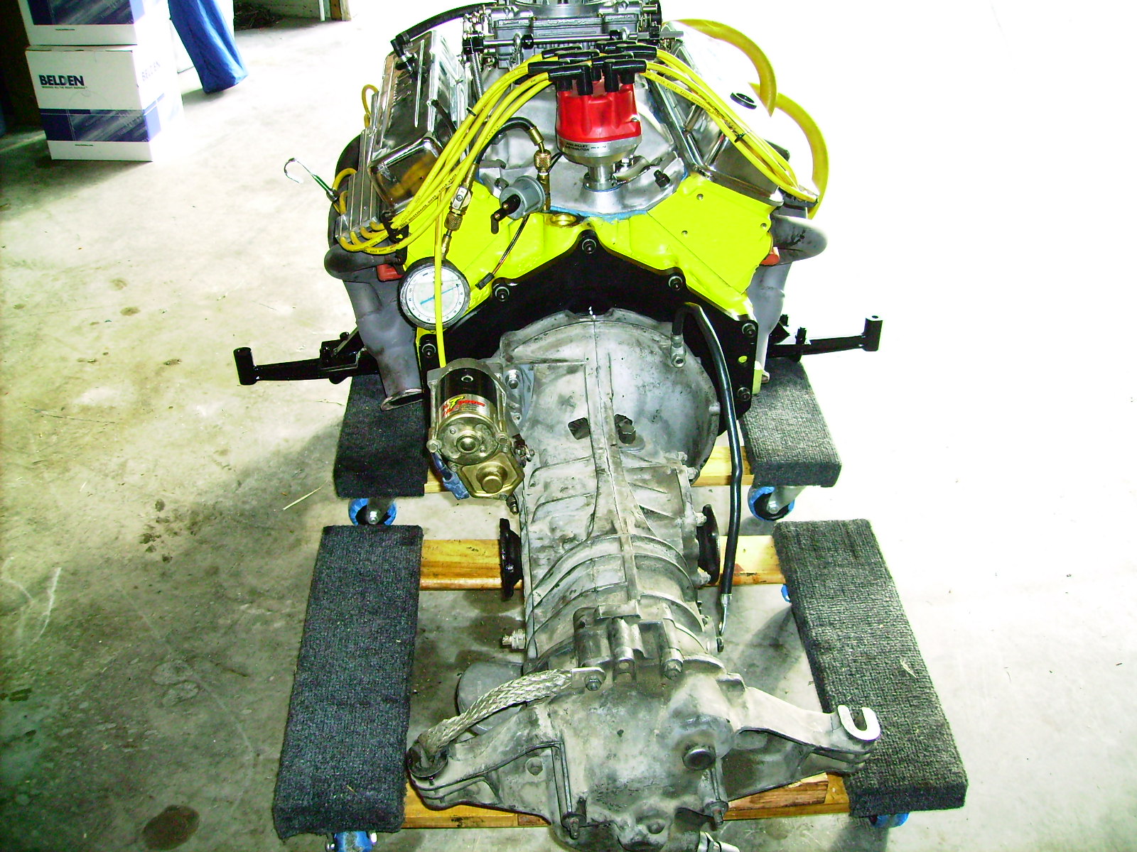

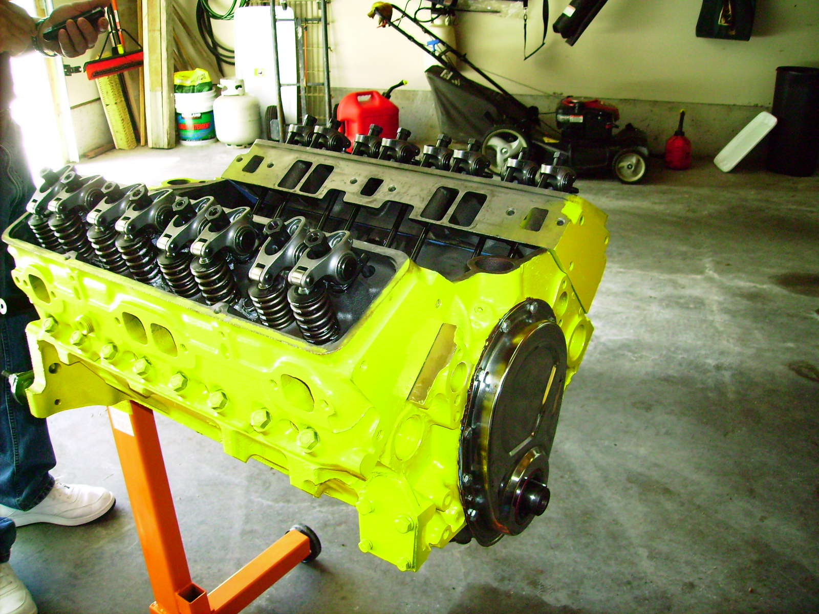

Here are a few pictures of my engine rebuild. What I was told It was a 350. What I found out was it is a 67 327 block with a 283 crank to make a 302 Short stroke high reving. I added a roller cam with roller lifters, had to re sleave 3 cyclinders, new rings, bearings, oil pump.
