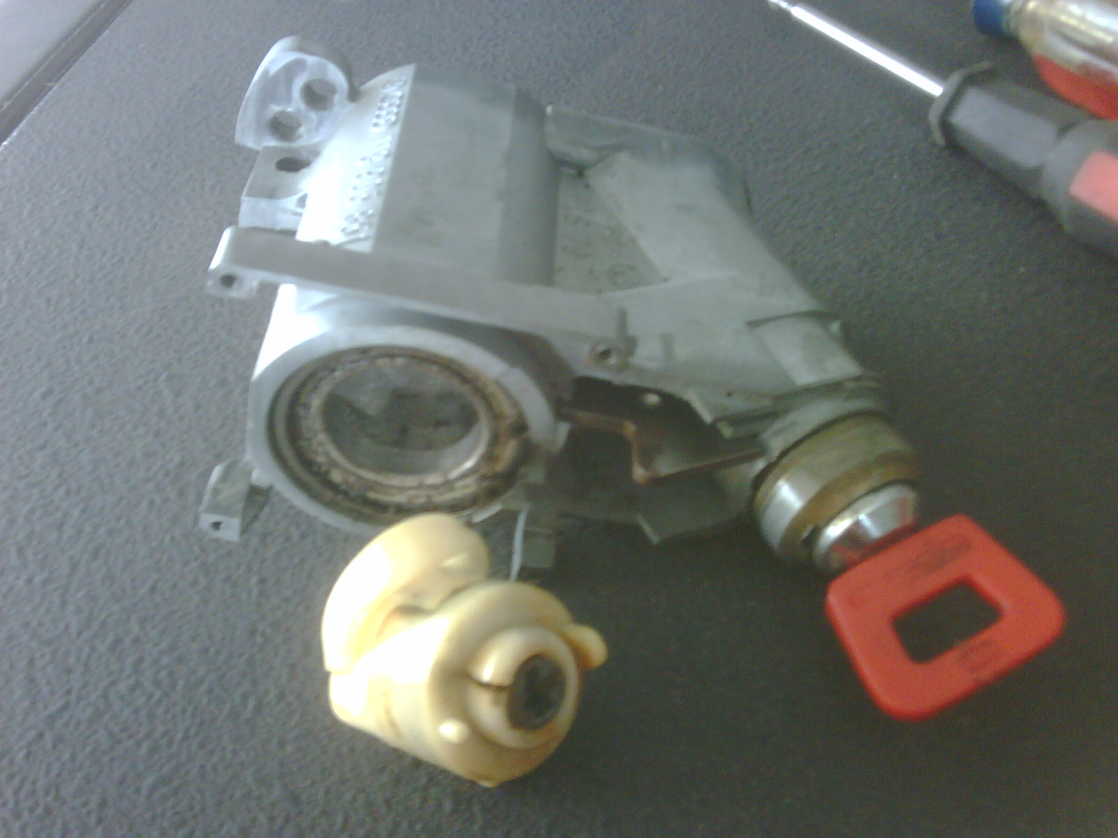

Ok....I pulled it into the garage and it was running fine and shut it off with the key. Would not re-start. Traced it down to no spark in the distributor. I threw parts at it such as condesor and coil. Didn't fix it. It ended up being the ignition switch cracked. I ordered the switch from George at AA and also ordered a replacemnt bearing for the steering column to get rid of the wobble in the steering wheel. Got it all put back together and now it starts but runs horrible. Need to chase down what I did wrong in the distributor. Always something!
