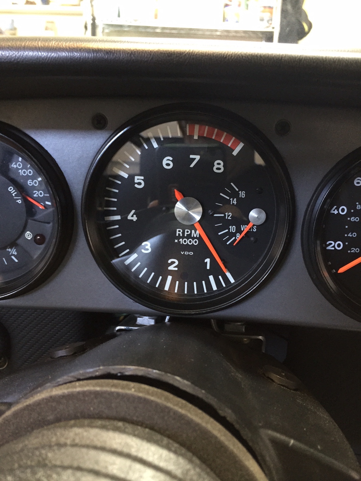

That was my understanding also, and to be fair the tach did work, but very slow to react. However my 3.6 has a light flywheel and revs up very quick. The tach pictured was built for me by NHSpeedo and required a 964 movement.... an expensive proposition. This conversion took significant time and energy as NHSpeedo had to do what they call the "Singer" modification.
