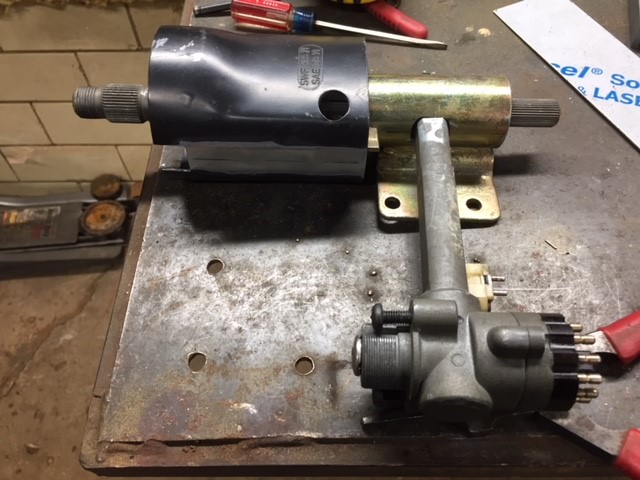

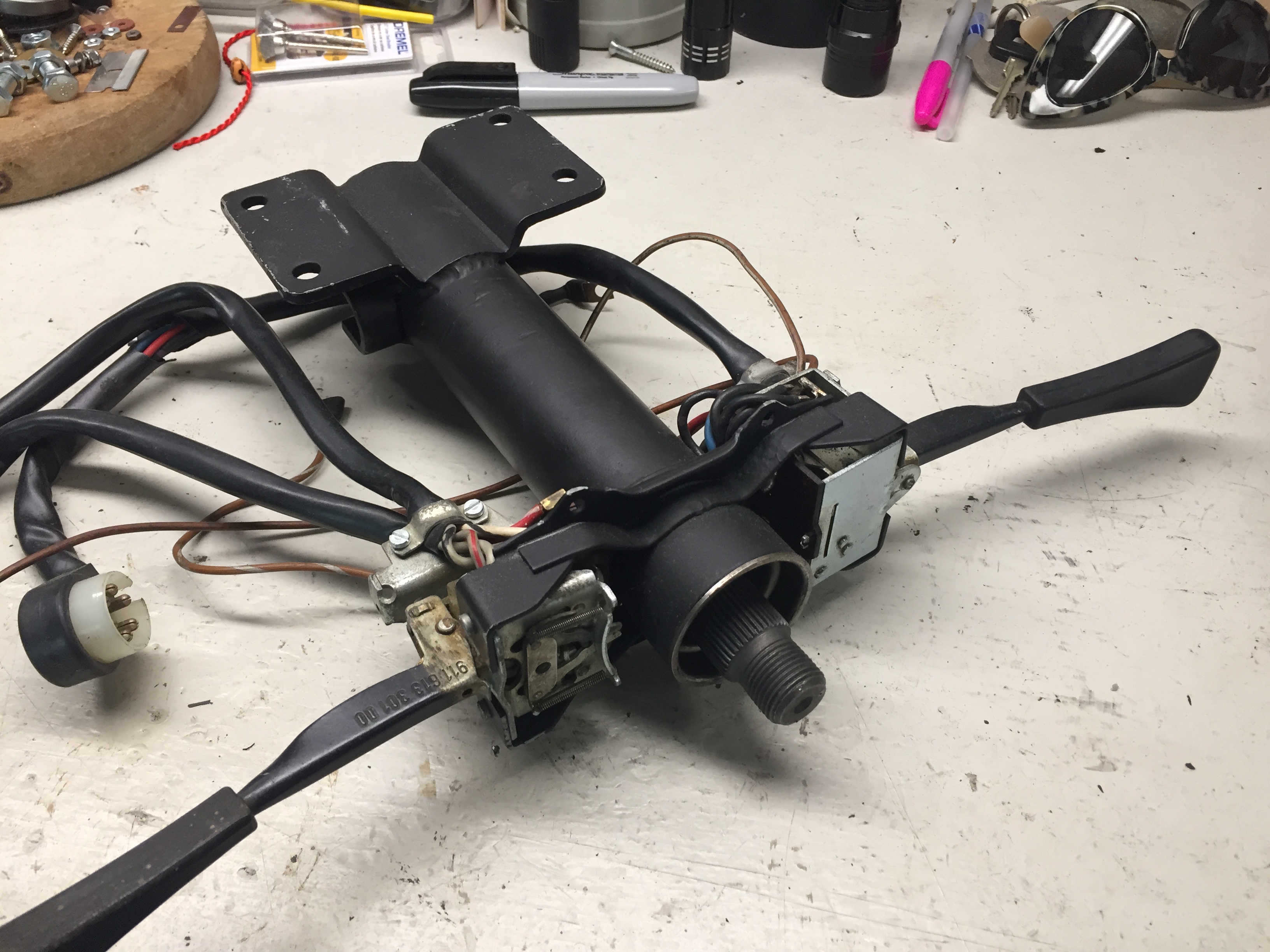

I am considering an alternate plan for a left side ignition switch conversion. My plan is to alter a standard 914-4 steering column to accept a left side 911 ignition switch including the locking feature.
I would remove the right hand ignition switch and possibly fill in the area like some others have done. The other option would be to insert a push button switch instead of the key tumbler and use it to energize a windshield washer pump motor.
I will need to get some dimensions shown on the photo so I know how to modify the standard 914-4 column to accept the 911 ignition switch. It would be very helpful if someone can help with these dimensions.

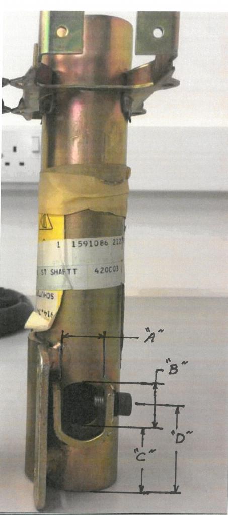

Jeff, I should be able to get the dims for you off my column
Might not be until the end of the weekend though if that ok

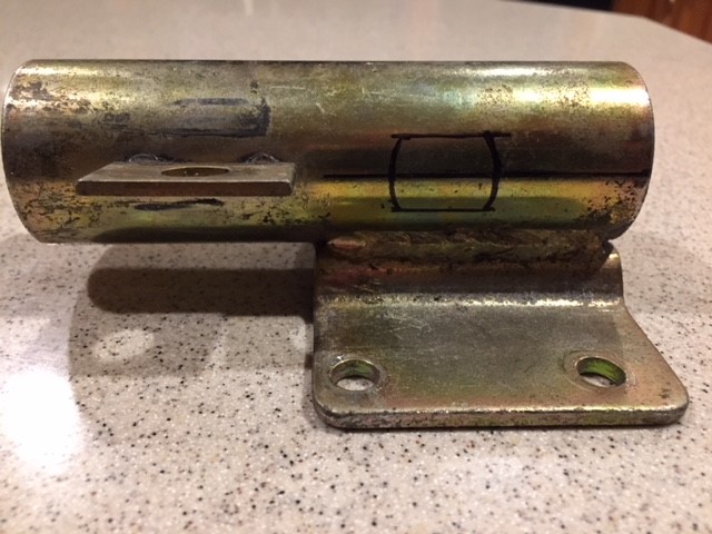

Hi Jeff, 1st off apologies for the delay, work and family has been crazy
Anyway here are the dimensions all in mm, plus a few more in case they help
A = 16.1
B = 20.1
C = 32.2
D1 = 42 to centre of hole slot
D2 = 46 to centre of M6 hole
Looking at the hole I would say the curved radius would match a 20 round hole, simply chop off the sides so it is 16 wide
Overall length of welded on U = 25.2 (material thickness 4)
Width of U externally at the widest part (open end) = 27 / it does narrow slightly down to 18 internally)
Open end of the U is 52 from the end of the column tube
U shape maximum depth (sticking out from the tube it is shaped into the curve of the tube at the closed end) = 16
M6 hole from the external corner at the open end of the U (both x and y) = 6
I'll link to this from the left side ignition thread in case it's useful
Anything else let me know

I have restarted working on this project again this week. It was delayed since I had finish so many home projects that I put on hold to finish my 914-6 GT clone last year.
http://www.914world.com/bbs2/index.php?sho...9197&st=120
The object of this conversion is to convert a 914-4 steering column to accept a 911 ignition switch on the left side while looking as factory correct as possible. This cuts the conversion cost considerable and makes the wiring modification much easier. When completed it will have a functional steering lock and use the heavier duty 911 ignition switch. Oh, forgot to mention the cool factor too!
After some research and some very helpful dimensional information from SixerJ it was time to proceed with modifying my steering column. The project is going to require several steps to accomplish:
1. Steering housing-cut off existing ignition switch protrusion then machine housing and fabricate filler plate.
2. Steering housing tube-machine window to accept 911 ignition switch and fabricate horseshoe bracket to clamp 911 ignition switch
3. Steering shaft-cut off ignition switch locking tabs and move them three inches down the shaft
4. Dashboard-cut out left switch hole and weld in new 911 ignition switch mounting
5. Modify 914-4 ignition switch wiring to accept 911 ignition switch.

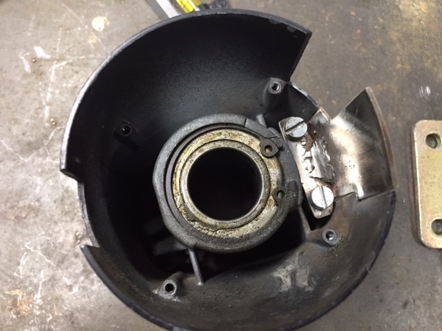

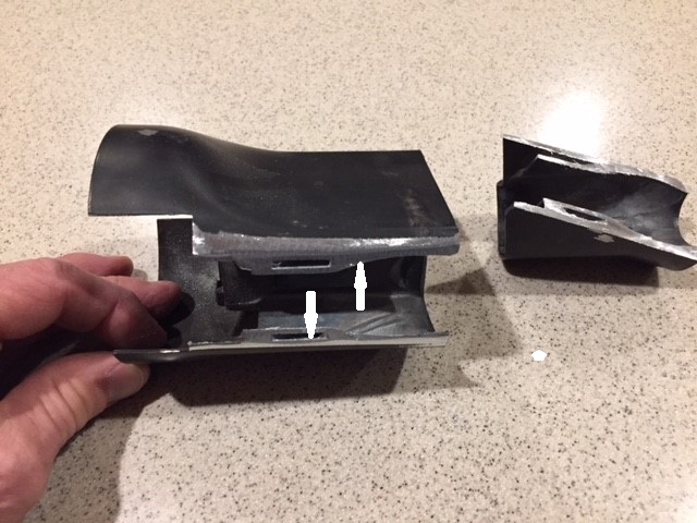

The first step was to cut off the ignition switch protrusion from the side of the housing. This was rather easy to do with a cutoff wheel.
Then I set the housing up in a mill and machined about .08 deep ledge that goes up to where the arrows are pointing.
The machined ledge supports the slightly curved piece of stainless steel the fills in the gap where the ignition switch used to be.

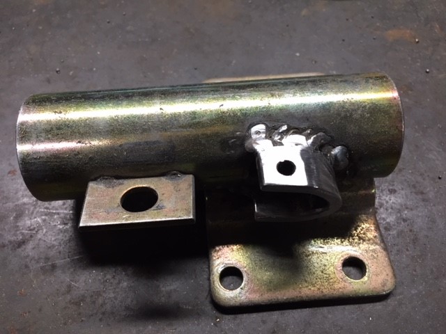

I welded a tab to the stainless and used the existing holes from the old ignition switch housing to mount the filler plate. I still need to paint or powder coat the housing black.

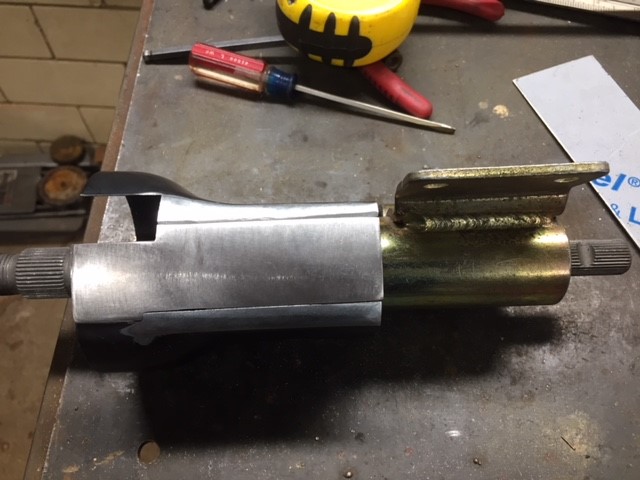

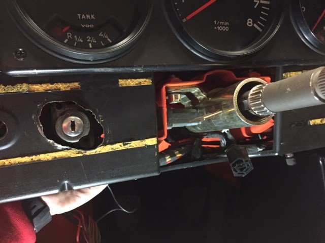

The next step is to machine window to accept 911 ignition switch and fabricate a horseshoe bracket to clamp the 911 ignition switch.
Below shows a test fit up of the ignition switch.
I still have a lot more work to go but I actually think this is going to work.
Jeff B

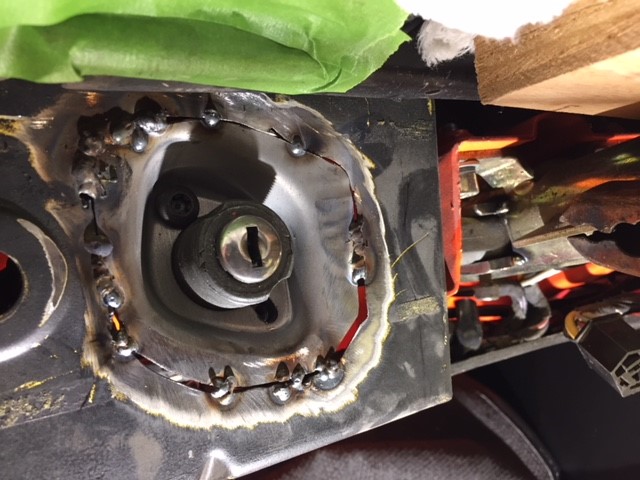

I made some substantial progress this weekend.

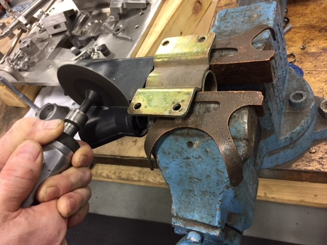

I fabricated the horseshoe clamping bracket by using some 3/16 x 5/8 bar stock. I heated the steel up and bent it around a .71 diameter socket extension. I trimmed off the excess length and ground it to fit to the curved steering tube. During the fit up further down I tack welded the horseshoe bracket and then finish welding it out of the car.

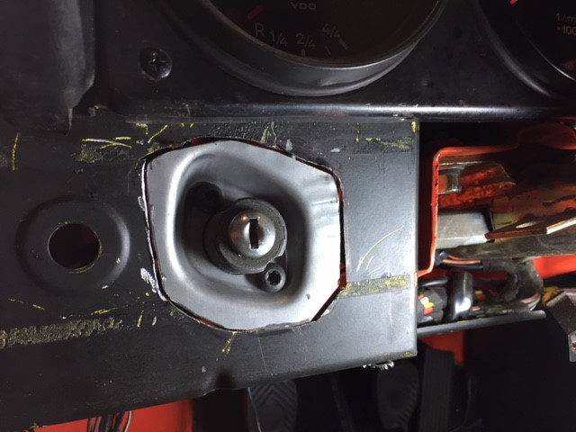

The next step is to locate the ignition switch mounting sheet metal from R&D

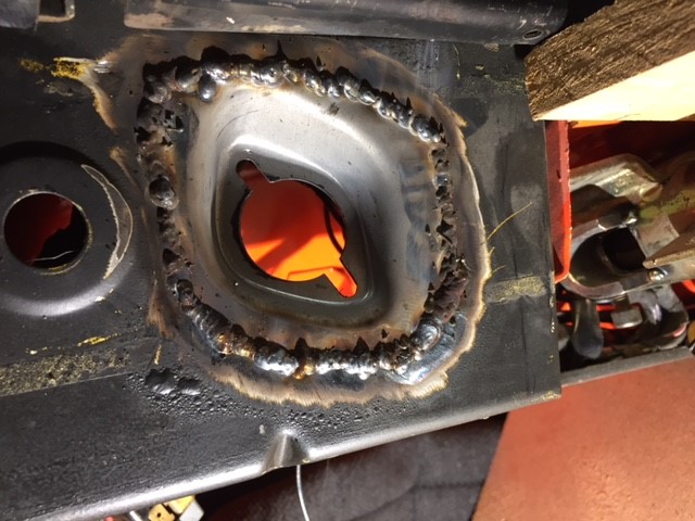

I opened up the existing hole in the dash that was originally for the emergency flashers. Then I mounted the 911 ignition switch.
I trimmed the switch sheet metal to a rough size and then bolted the sheet metal to the ignition switch to determine where to cut the dash hole.
Once the hole was cut open I cleaned up the surrounding metal and then tack welded everything together.
Next came the final welding which was a little rough but it finished up with a little grinding and paint.

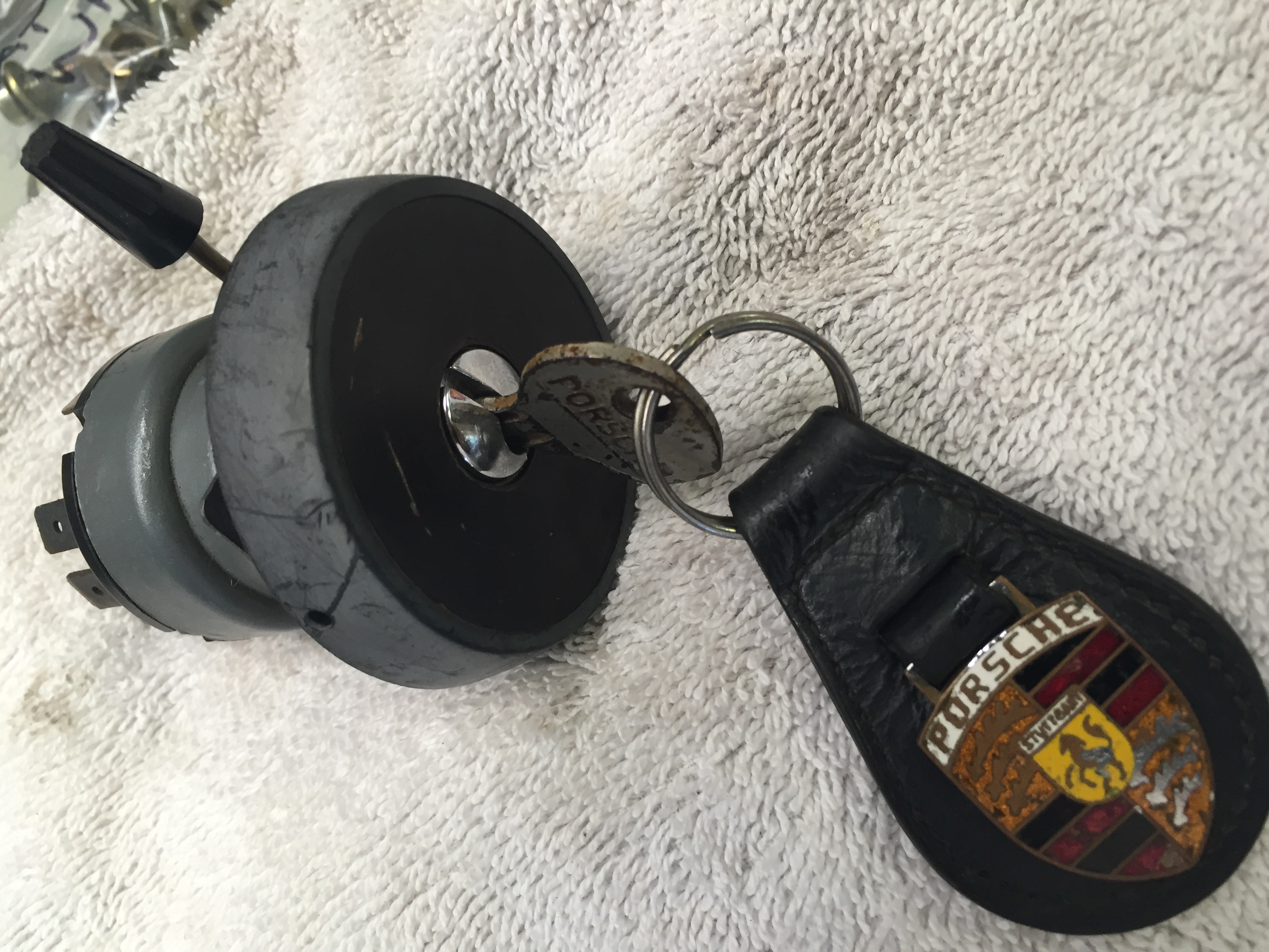

The part that will be difficult with using the 911 steering column is Integrating the electrical connections for the different turn signal and wiper switches. The non-locking 911 ignition switch should be electrically the same as what I am going to be doing.
I am not sure how the non-locking 911 ignition switch mounts into the dash. Does it use the same special angled mounting plate or is it just a straight hole though the dash?
Jeff B

My switch is early 911/912, straight into dash. The smaller 914 style bezel fits this switch too.
As for wiring the column switches, I will most likely forgo the plug ends and do point to point.
