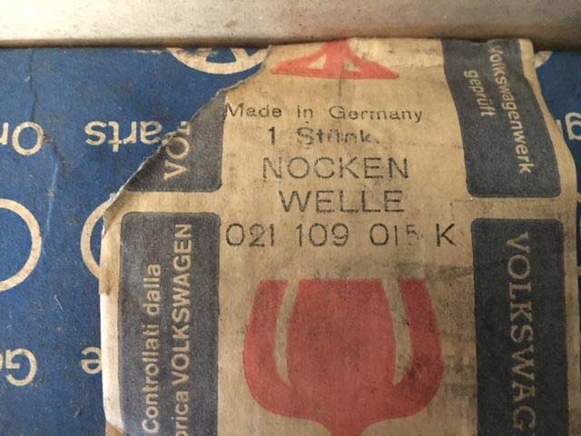

The cam I bought is stamped with VW part 021.109.101K. One pink paint stripe. One 1/2 ring cast on the cam to the right of the center bearing surface.
Porsche part number on the box is 021.109.015K but there is no way to tell for sure if this is the proper box for the NOS cam I received since the box wasn't sealed. Boxes often get shuffled and/or simply used as safe place to store parts. If you think about it, it is pretty amazing that 40 odd years later we can still find any NOS parts!
I suspect my box wasn't original to the cam I purchased since the drive gear on my NOS cam is a "0" pitch offset which should be 021.109.021M according to PET. 021.109.015M is supposed to be a "-3" pitch offset but would be the same cam profile, just a different drive gear. Really doesn't matter since I only care what the camshaft actually is - not the box. However, it all adds up to another source for confusion. Given that there are other known errors in PET, I don't even fully trust that!
PET indicates that suffix(s) of the latest part is "M". Despite much searching on the net, I could never find a firm tie between the VW part numbers, the Porsche PET part numbers, or any parts that end in suffix "K" vs. "M".

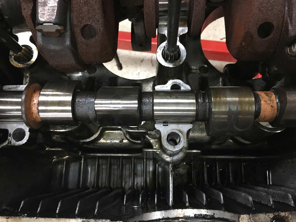

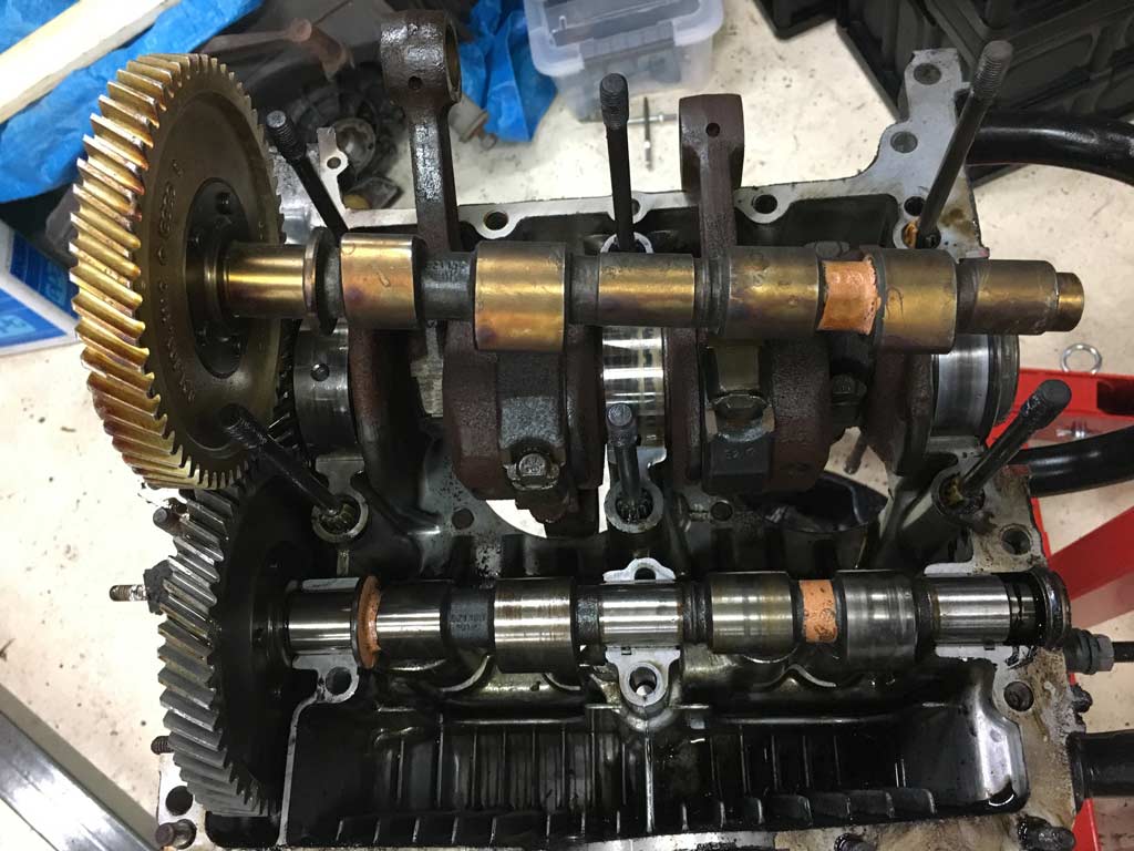

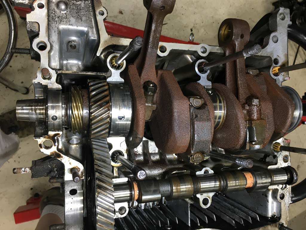

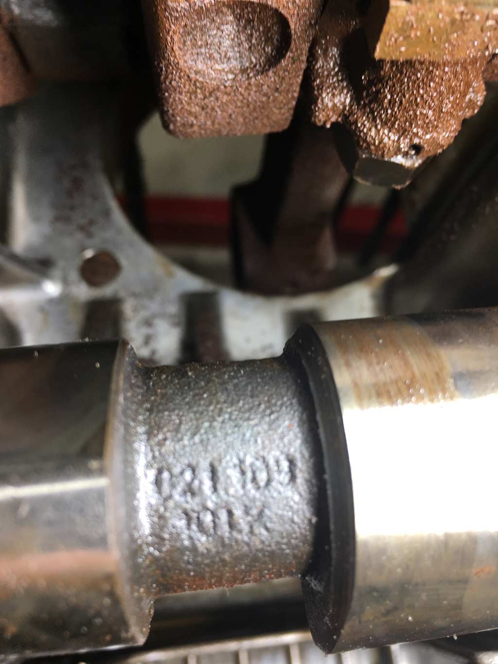

In splitting the case of GA000099 you can see that the stock cam is marked with two pink stripes.
along with VW part number 021.109.101k
the cam has 1/2 band cast into it .
Not sure why this cam has two pink stripes vs. my NOS cam with only one pink stripe but suspect that it may be due to the difference in the drive gear. My NOS drive gear is a "C" suffix with "0" pitch offset. The drive gear on the GA000099 is a "B" which indicates "-3" pitch offset. Different levels of variation in gear pitch diameter allowed for select fit of the cam to crank gear to minimize cam backlash as part of factory build.
