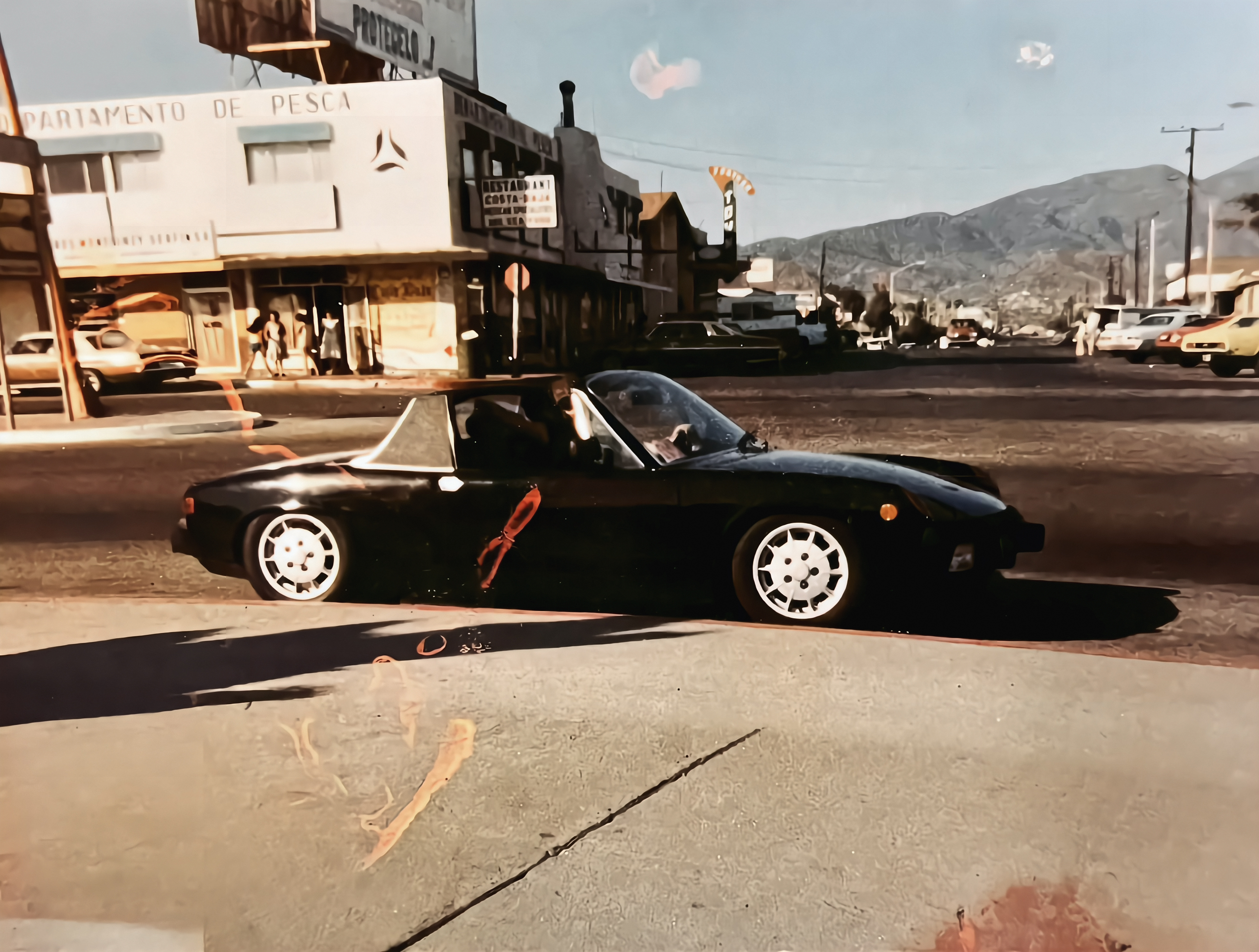

Shown was my 74 I put a fresh 1978 911SC full front suspension in it that was almost new. This had the under-sway bar. I ran it that way for a while with a turbo 2.0 T4 Eng and with the real gas burners and P6 tires as shown, it handled great and felt really good over the bumps. All I can say are great things about it. I loved that car! This crappie picture was in Ensenada Mexico when I took a trip with two friends and from Los Angeles. She sat in the middle.
This picture was from 1981 or so the 78sc front end had Bilstein struts
Best Bob B
