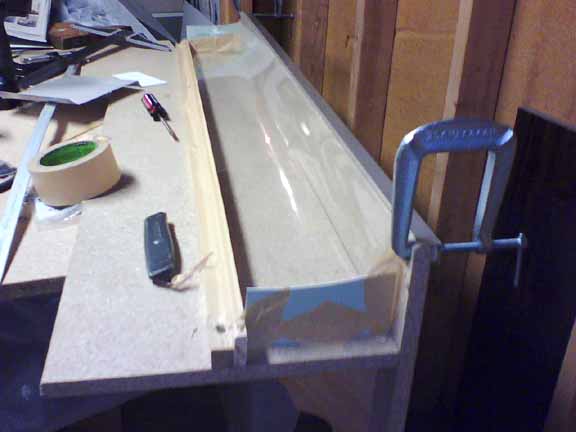

I built a form with polycarbonate sheet in wood:
neo914-6
post Sep 21 2006, 02:33 AM
neo life
Posts: 5,086
Joined: 16-January 03
From: Willow Glen (San Jose)
Member No.: 159
It's hard to see with my camera phone pic, but the surface is near perfect.
on to the fender transitions...
