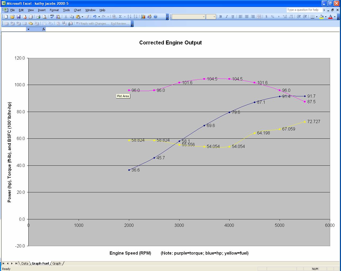

post Dec 18 2005, 12:44 AM
914 Freak!
Posts: 20,180
Joined: 13-March 03
From: Grand Rapids, MI
Member No.: 419
This is Jake's dyno graph of a carbed 1911. See for yourself. (IMG:http://www.914world.com/bbs2/html/emoticons/wink.gif)

Brando
post Dec 18 2005, 03:41 AM
BUY MY SPARE KIDNEY!!!
Posts: 3,935
Joined: 29-August 04
From: Santa Ana, CA
Member No.: 2,648
Wow... 104.5 torque on a 191... nice.
