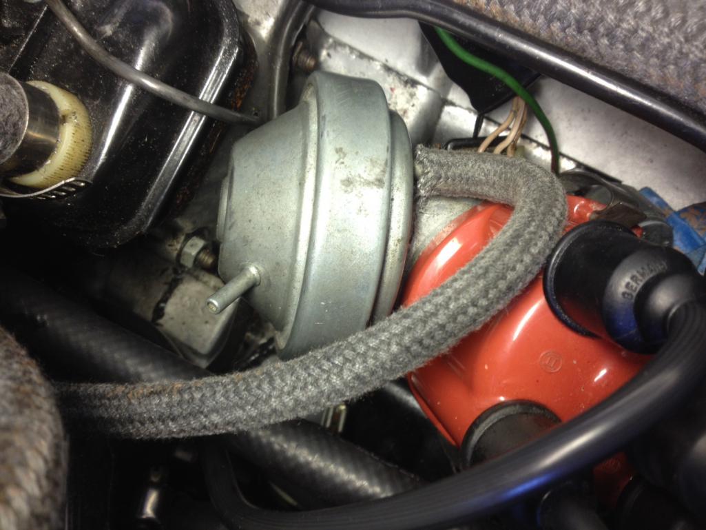

Ok 73 2.0 built to a 2056. Currently running points. Checked dwell and set to specs. I was setting the timing and I have a timing light that you can set in the advance.
1st question: Can you use the advance setting on the timing light instead of the 27 at 3500 rpm? 2nd question: My dizzy has 2 vacuum ports. One is advance and one is retard. My throttel body only has one vacumm port for the dizzy. Do I need both hooked up? 3rd Question: Do I have the vacuum line on the correct (advance) side? 4th Question: when I check the timing (just for fun) with the vacuum hose hooked up as shown the timing is not anywhere close to 27 at any rpm. That seems odd. |

So we have a couple of differing opinions on the correctness of the vacuum advance hose connection.
After setting the timing and connecting the vacuum hose as shown, the engine speed decreases greatly. Which to me says that port is retarding the timing. When I switch sides, the engine speed increases. Anyone have a definitive answer as to which side of the dizzy is advance and which is retard? |

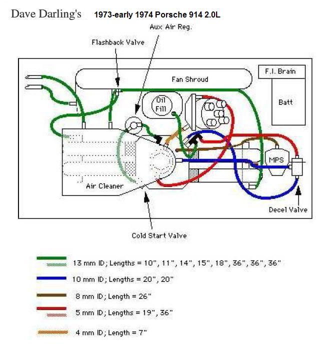

Bleyseng is correct and every hose diagram I've seen shows it that way.....
This diagram shows both lines hooked up but the advance hose shown isn't used by most people as the throttle body only has the one port, just leave it hanging open to the air. ![]() |

Advanced Member ![]() ![]() ![]() ![]() Group: Members Posts: 3,033 Joined: 28-January 13 From: Knoxville Tn Member No.: 15,438 Region Association: South East States |
Ok so I removed the hose from the regard side and switched it to the advance side. it runs much better. But if I read the posted link it seems that nothing should be hooked up to the advance side? That seems odd. I always remember at least one hose being attached to the advance side.
