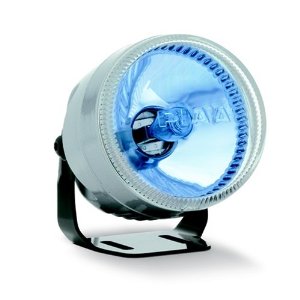

Krieger   So this may be a dumb question. These Piaa lights...   Jul 9 2012, 12:38 PM
mikey63   I'd say that you would be safe running those l...   Jul 9 2012, 01:54 PM
Krieger   Hey Mike! Ha, legal in Sonoma county, but not...   Jul 9 2012, 04:46 PM
mikey63   Hey Andy, I'll be there!!   Jul 10 2012, 09:58 AM
Krieger   Cool Mike! I spoke with the PIAA guys today. ...   Jul 10 2012, 06:12 PM
Krieger   oops double post   Jul 10 2012, 06:21 PM

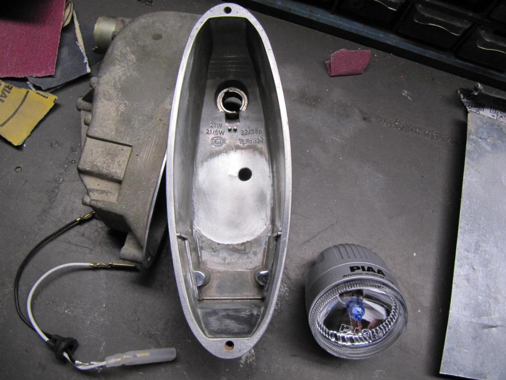

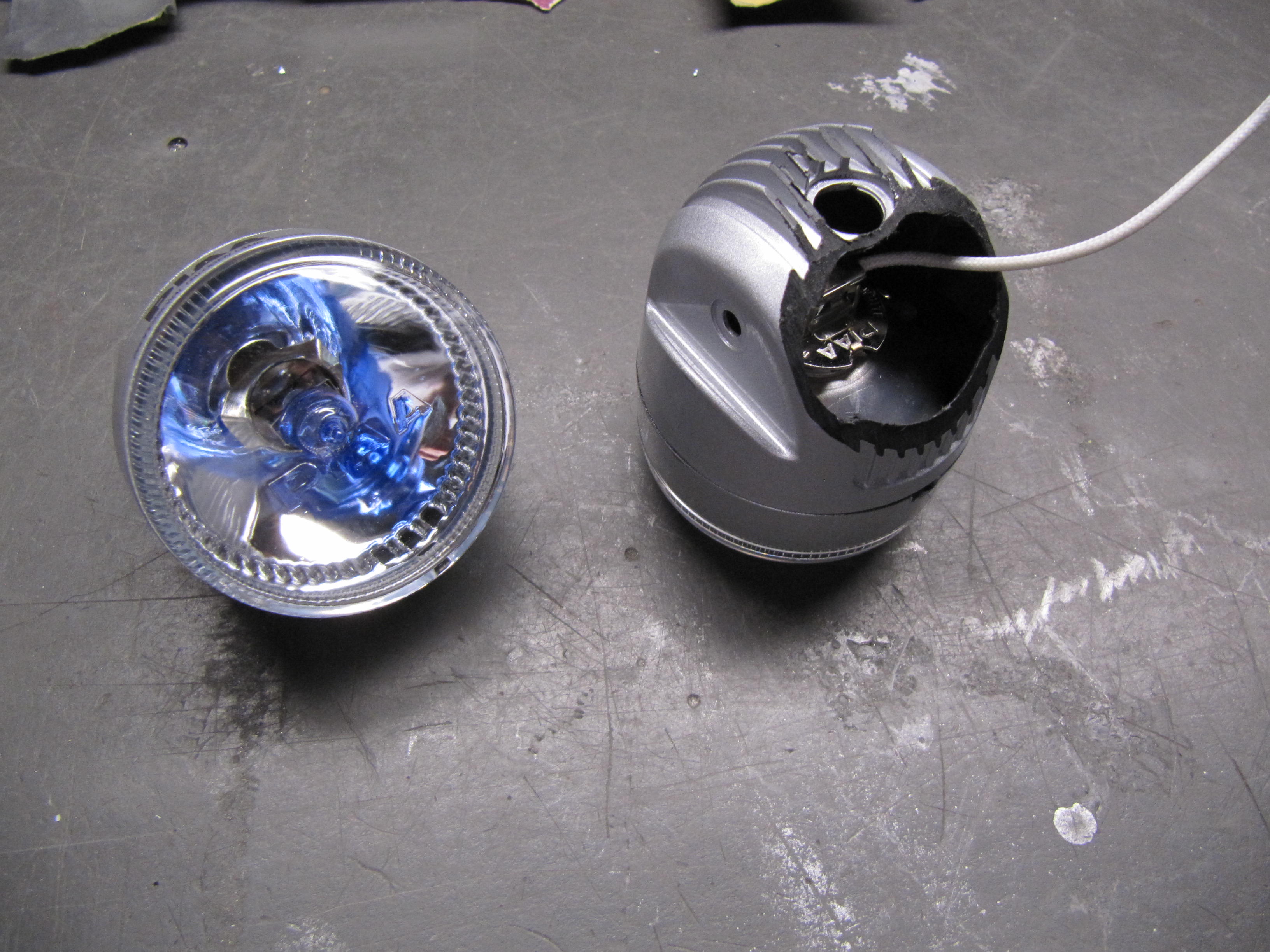

Krieger   I got my light and trimmed the plastic housing on ...   Jul 17 2012, 08:49 PM
Black22   Where's the pic of the light IN the turn bucke...   Jul 17 2012, 08:51 PM
Krieger   I ground off 6 protrusions (they look like tits on...   Jul 17 2012, 08:56 PM
Krieger   I ground down the back side just enough so that it...   Jul 17 2012, 09:01 PM

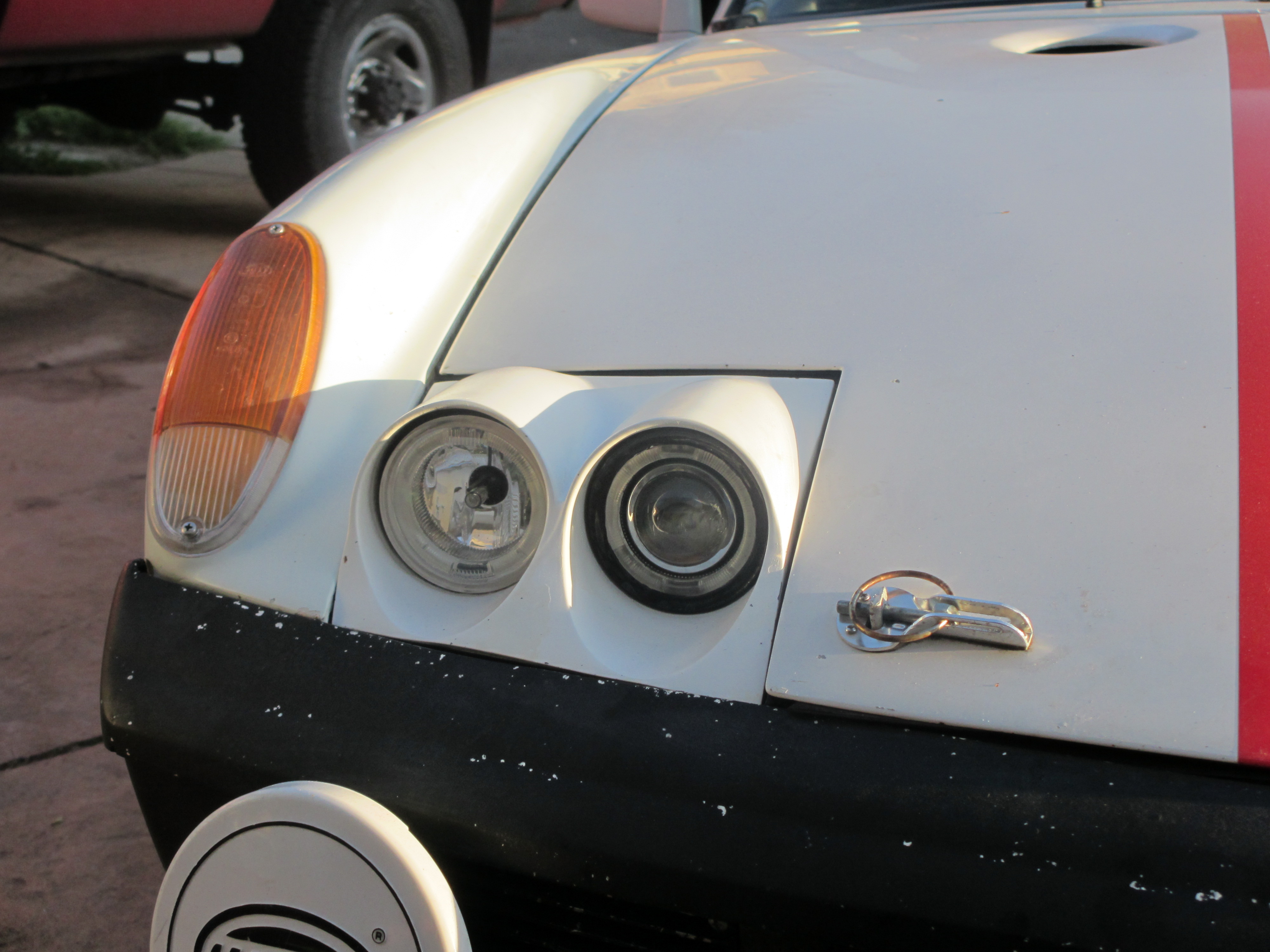

Krieger   This has been done for a while. Buckets polished ...   Nov 29 2012, 08:23 PM
Krieger   The headlight is snug in there. If I wanted it to ...   Nov 29 2012, 08:31 PM
Krieger   Flat Lexan cover, cut on band saw. Belt and hand ...   Nov 29 2012, 08:33 PM
Krieger   Oops double post. :beer3:   Nov 29 2012, 08:41 PM
Krieger   I used the rubber grommet from the PIAA lights on ...   Nov 29 2012, 08:44 PM
Krieger   I put some of the original PIAA plastic tubing and...   Nov 29 2012, 08:45 PM

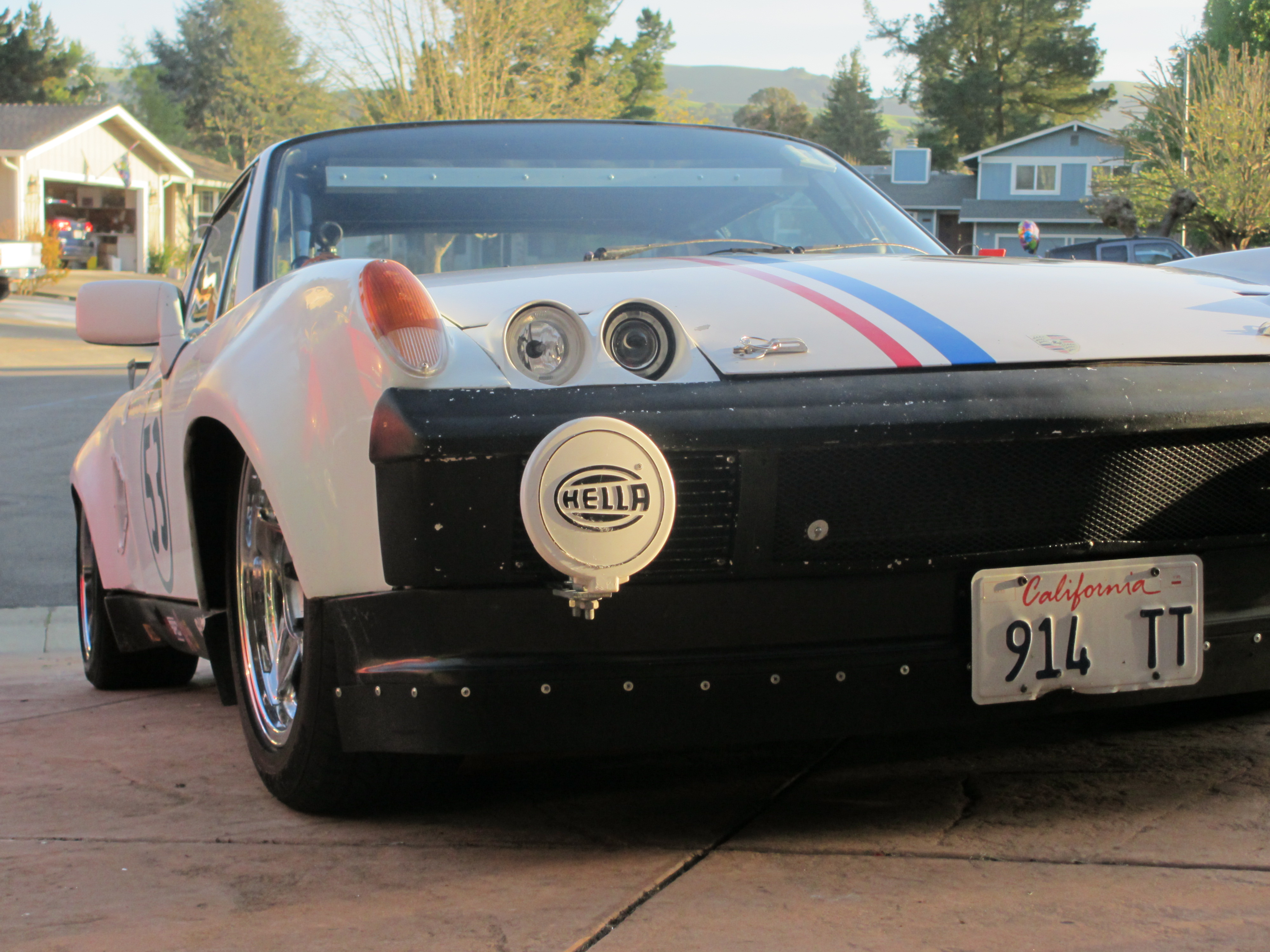

Krieger   The front!   Nov 29 2012, 09:01 PM
Krieger   Look out!! :Qarl: :Qarl:   Nov 29 2012, 09:02 PM
euro911   Look out!! :Qarl: :Qarl:I love it. Oth...   Nov 30 2012, 04:38 PM
Dasnowman   Look out!! :Qarl: :Qarl: Like your s...   Dec 1 2012, 12:20 AM
kg6dxn   Are the lights bolted or just wedged into the hous...   Nov 29 2012, 09:07 PM
Krieger   They couldn't go very far they would hit the o...   Nov 29 2012, 09:18 PM

Krieger   You need lights to legally drive on the road. I m...   Nov 29 2012, 09:39 PM
Cap'n Krusty   You need lights to legally drive on the road. I ...   Dec 1 2012, 11:23 AM

Krieger   What I am trying for is to appear to meet the requ...   Dec 1 2012, 01:26 PM
euro911   DOT or NOT, I think you'll be fine, since CA d...   Dec 1 2012, 02:08 PM
Cap'n Krusty   DOT or NOT, I think you'll be fine, since CA ...   Dec 3 2012, 06:09 PM
