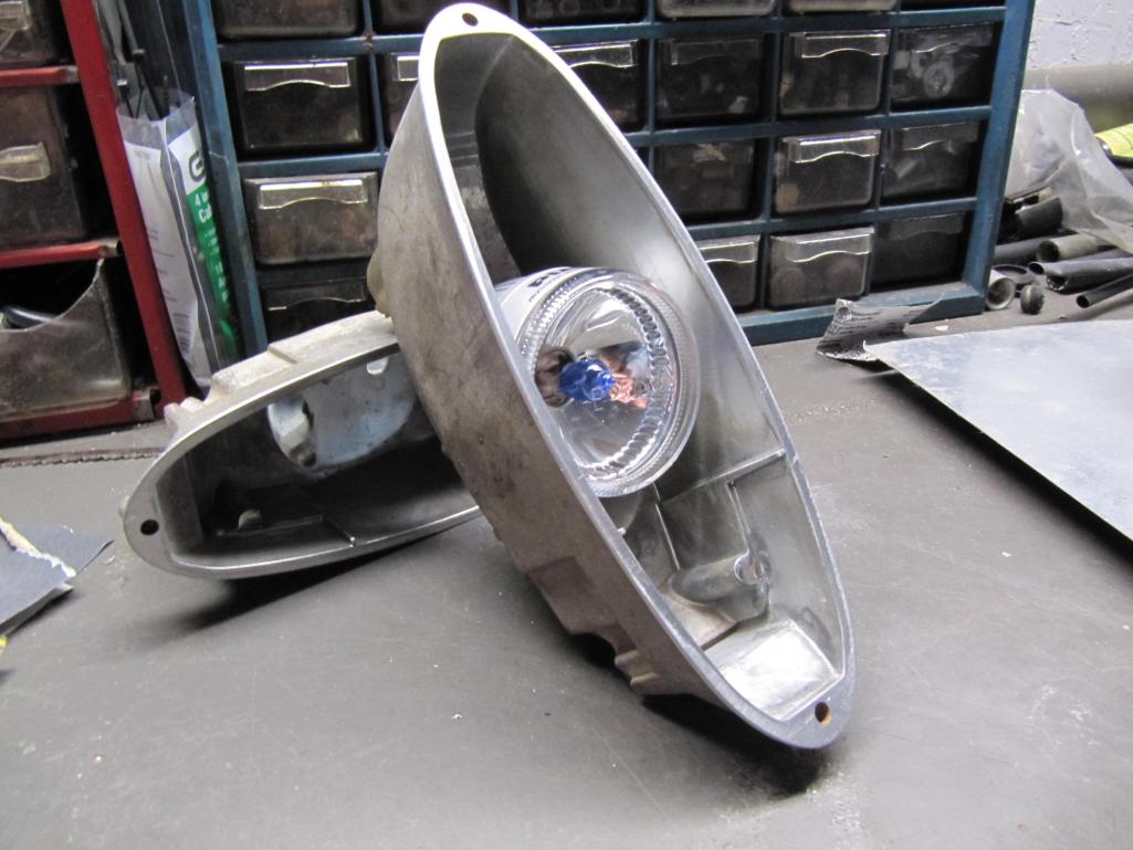

I ground down the back side just enough so that it barely sticks out past the horizontal plane of the outside of the bucket. Yes flat lexan will be coming my way. They are snug in there.

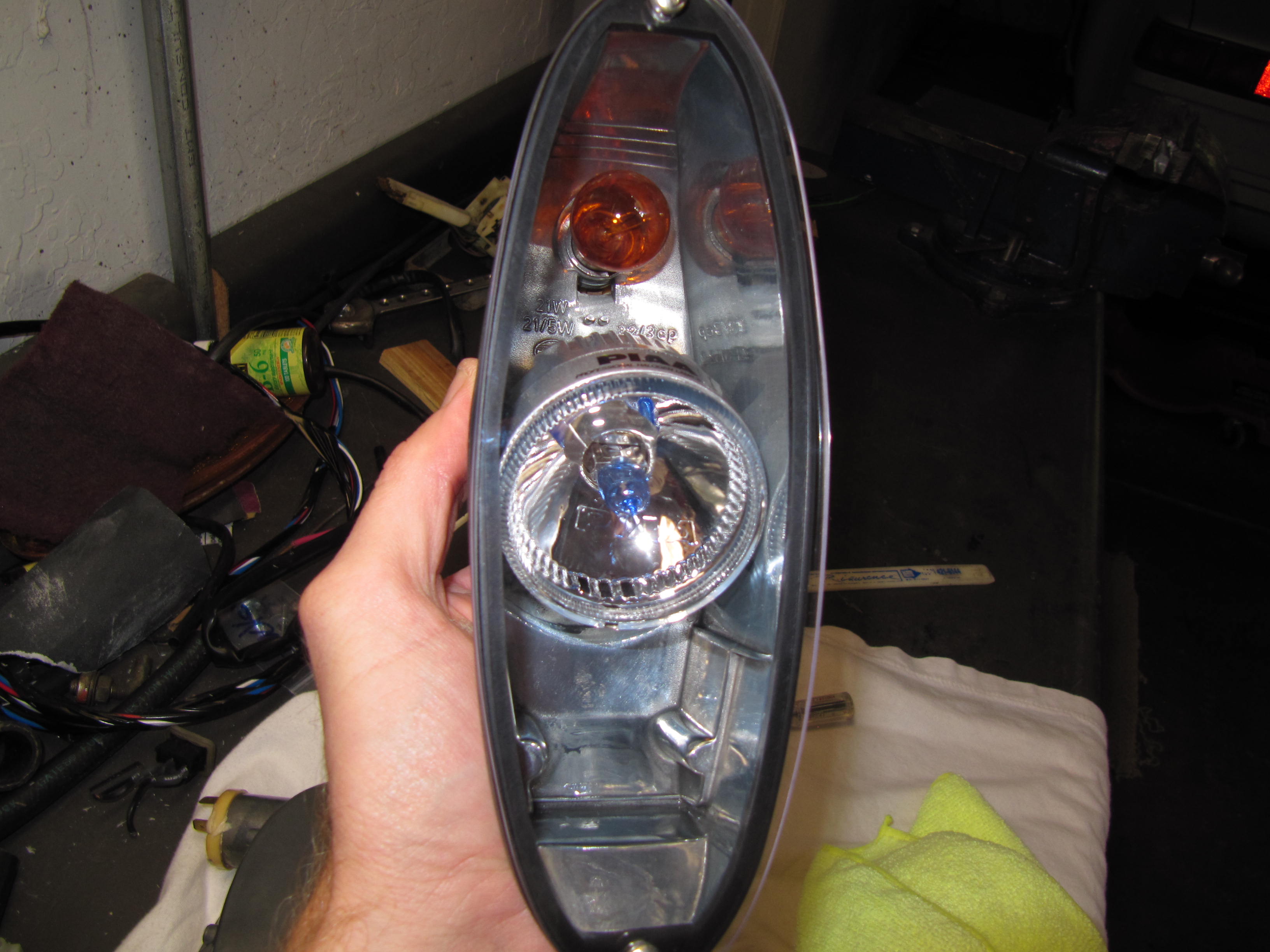

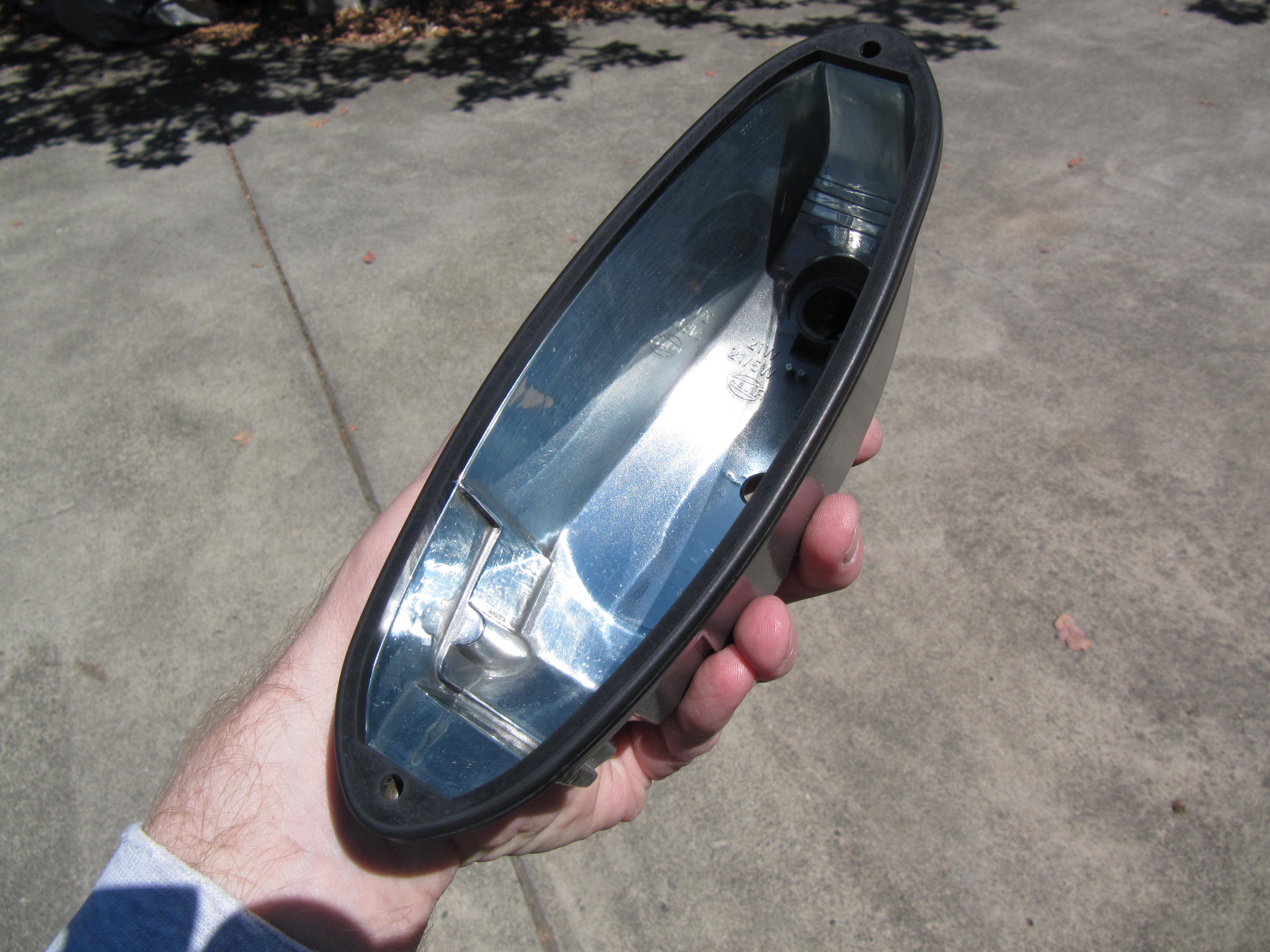

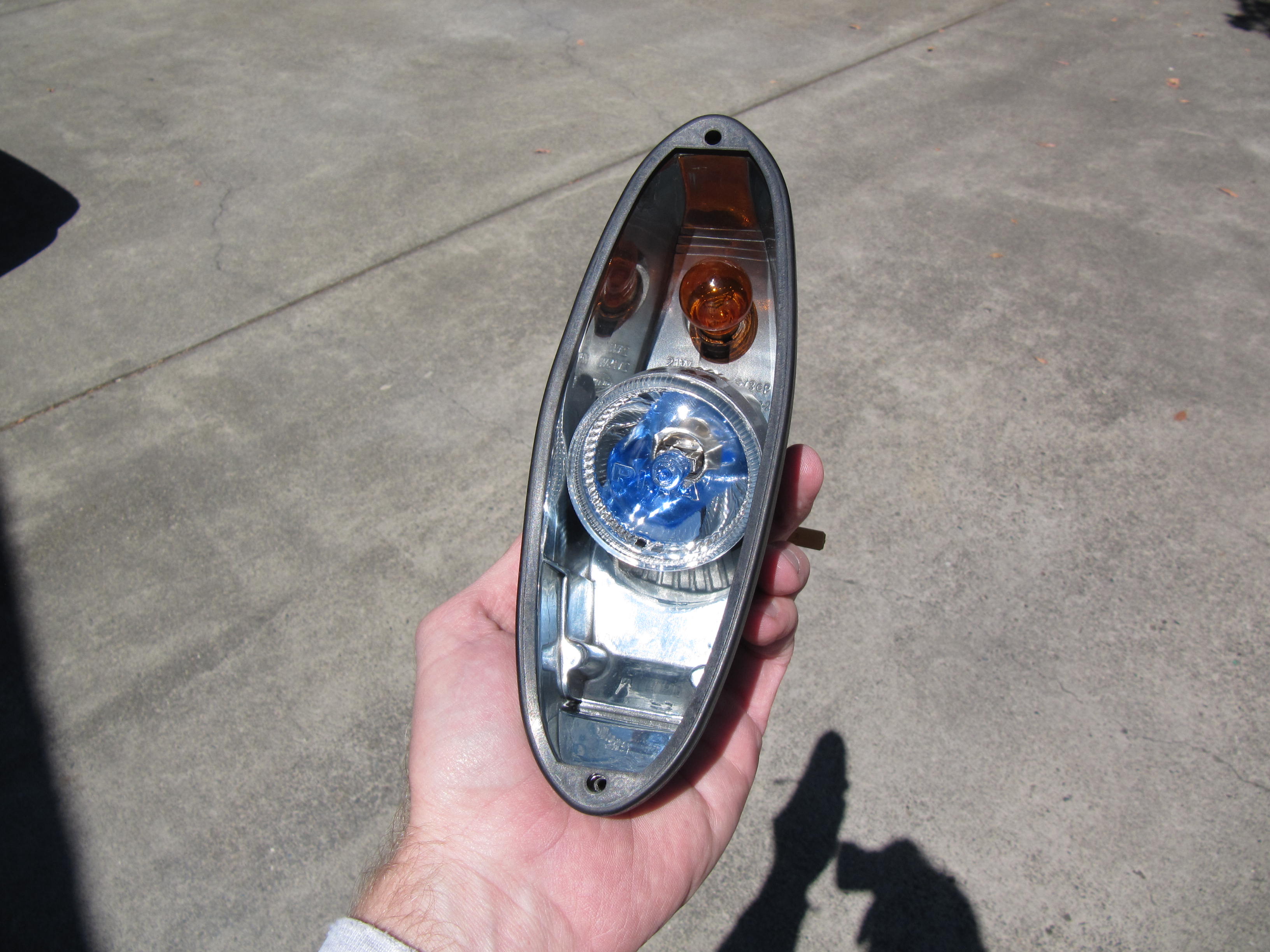

This has been done for a while. Buckets polished out and clear coated with a POR 15 Glisten PC clearcoat.

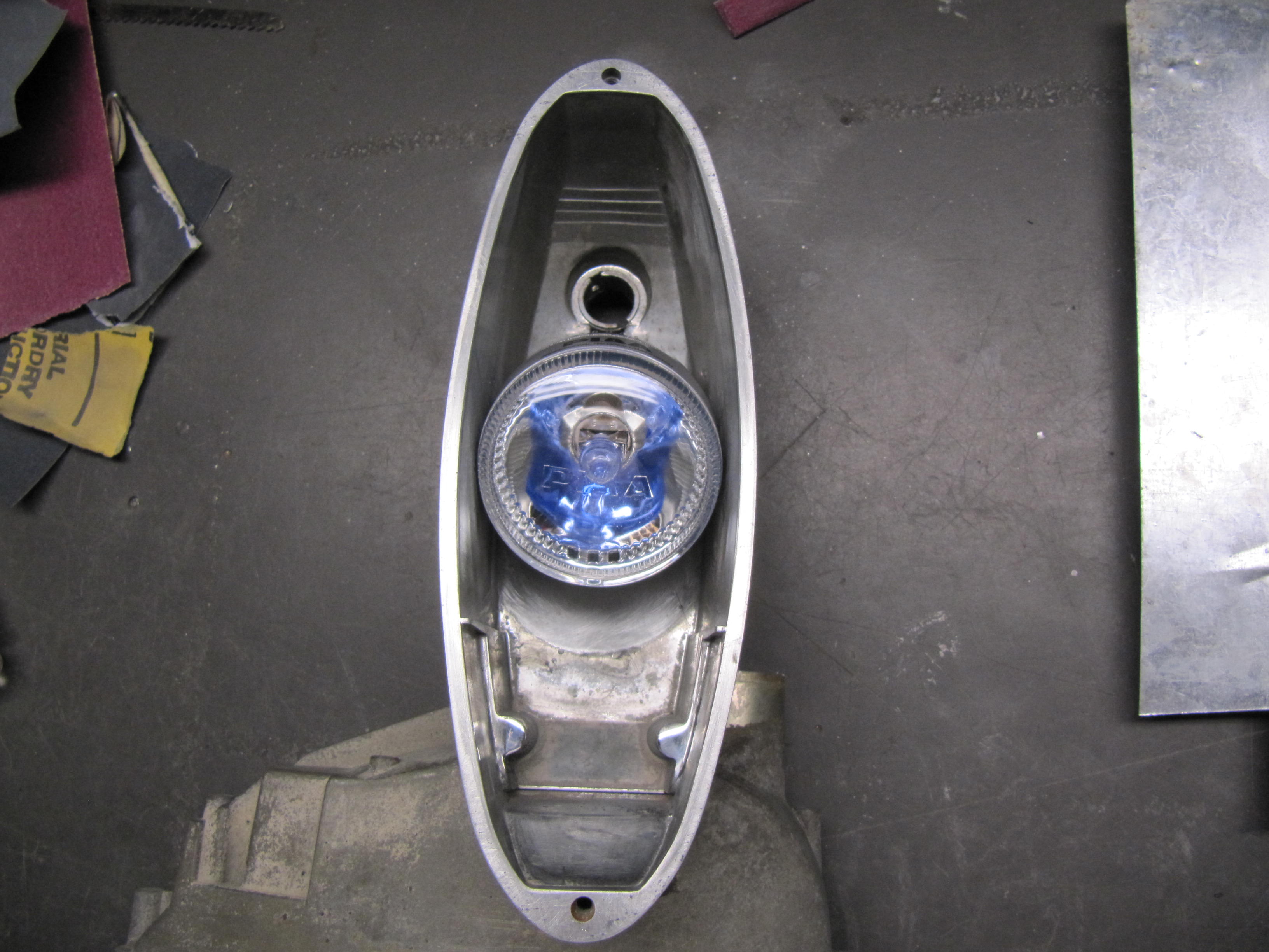

The headlight is snug in there. If I wanted it to adjust I could drill a hole through both housings with a long screw from outside and two nuts on the lens assembly. NAPA autoparts orange bulb.

Flat Lexan cover, cut on band saw. Belt and hand sanded for final shape. One of AA repro seal. It's a nice fit and reasonably priced, just like the repro rubber elbo for the backside.

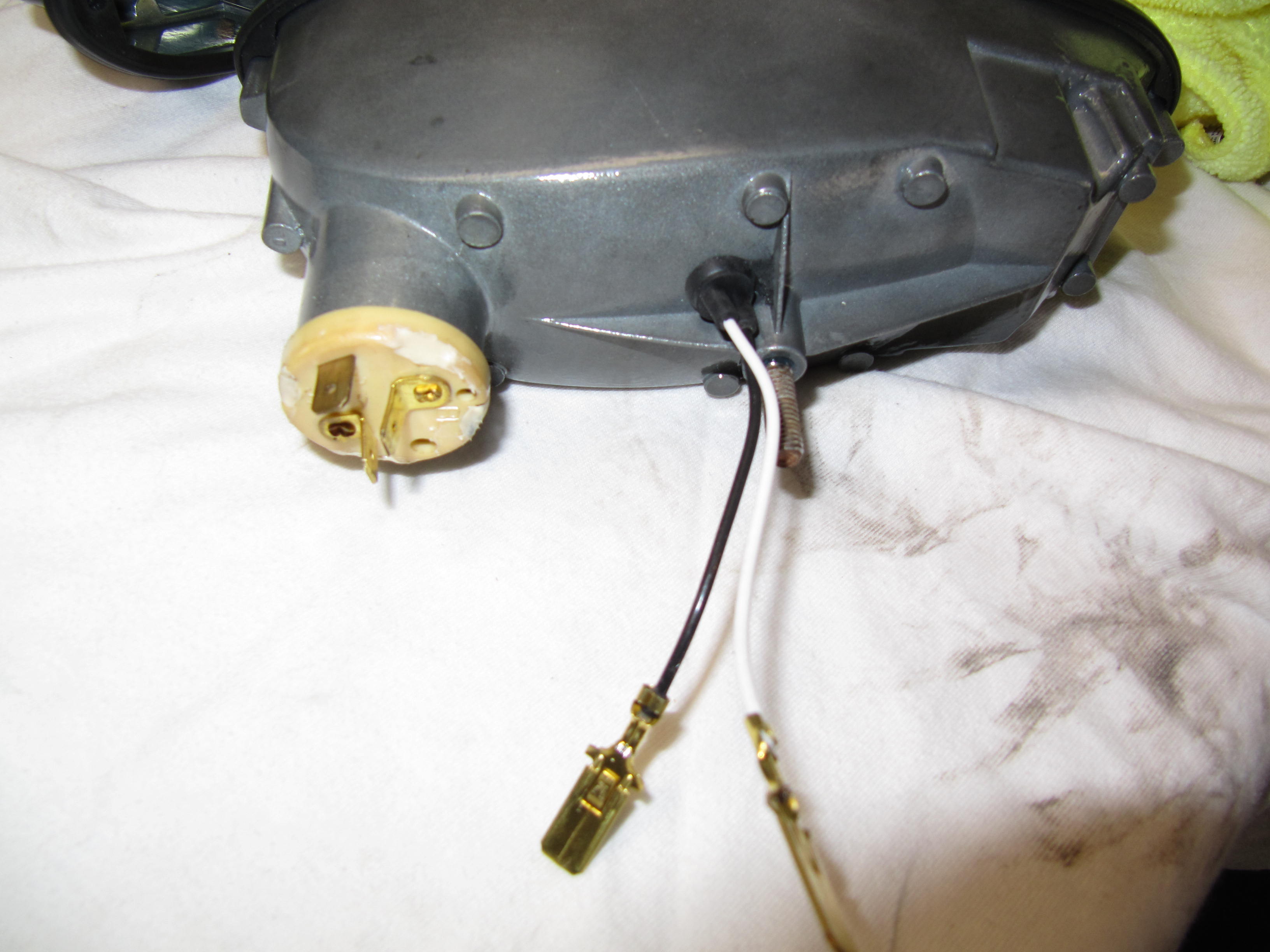

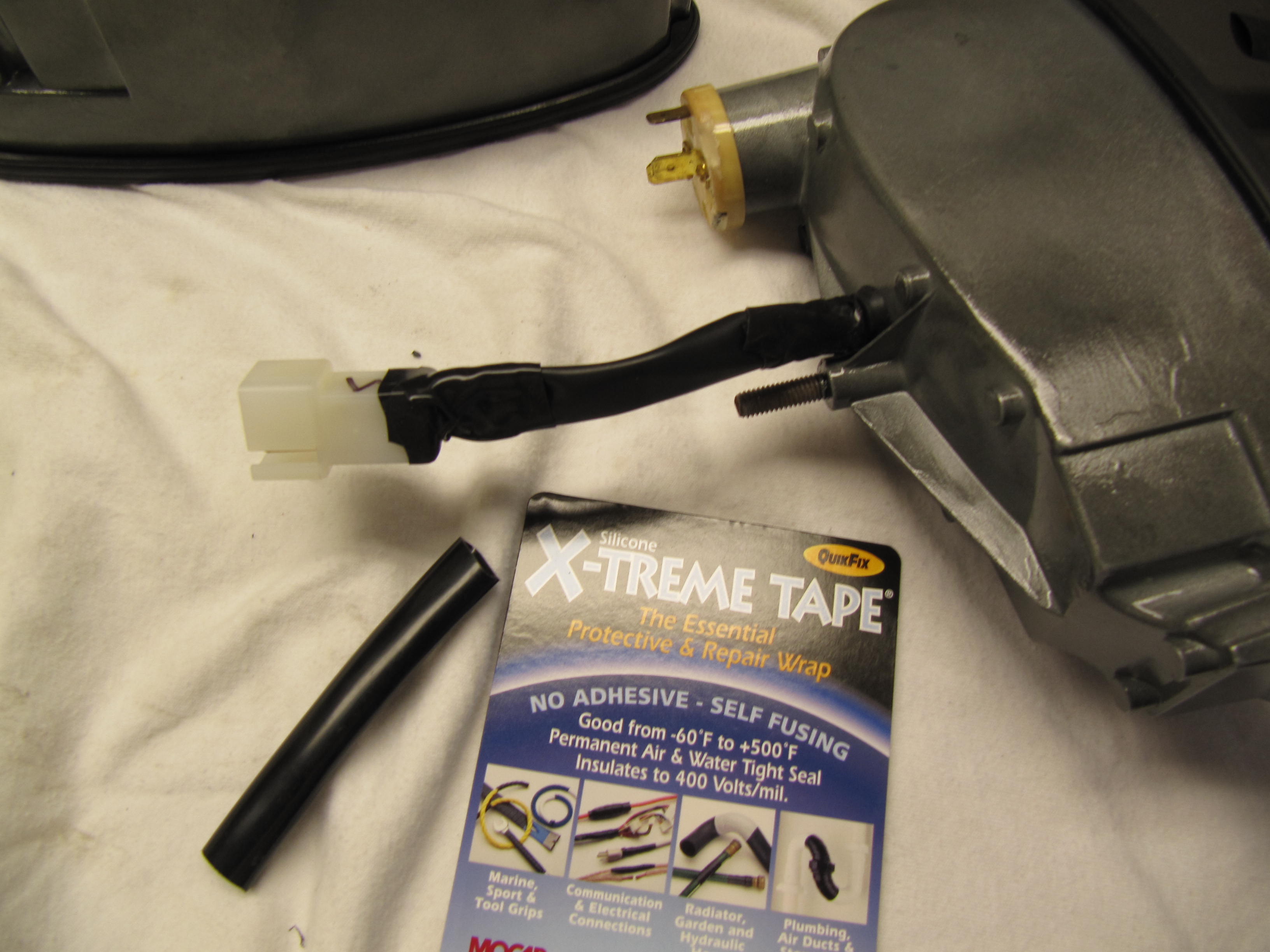

I used the rubber grommet from the PIAA lights on the back of the turn bucket. I glued the electric covers back on with 3M seam sealer.
Krieger
post Nov 29 2012, 08:45 PM
Posts: 4,869
Joined: 24-May 04
From: Santa Rosa CA
Member No.: 2,104
I put some of the original PIAA plastic tubing and plug back on the wire ends and wrapped it with silicon tape.

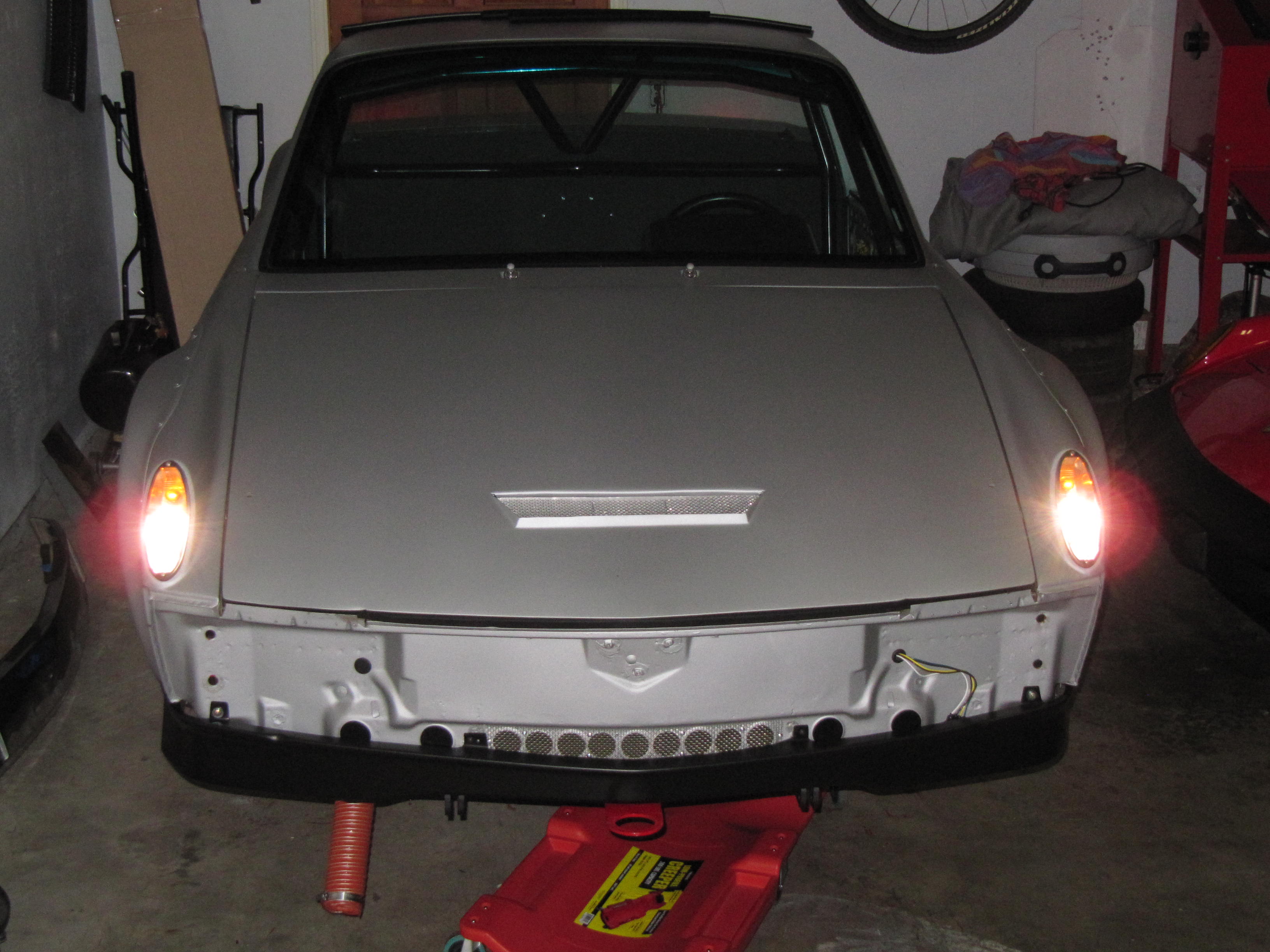

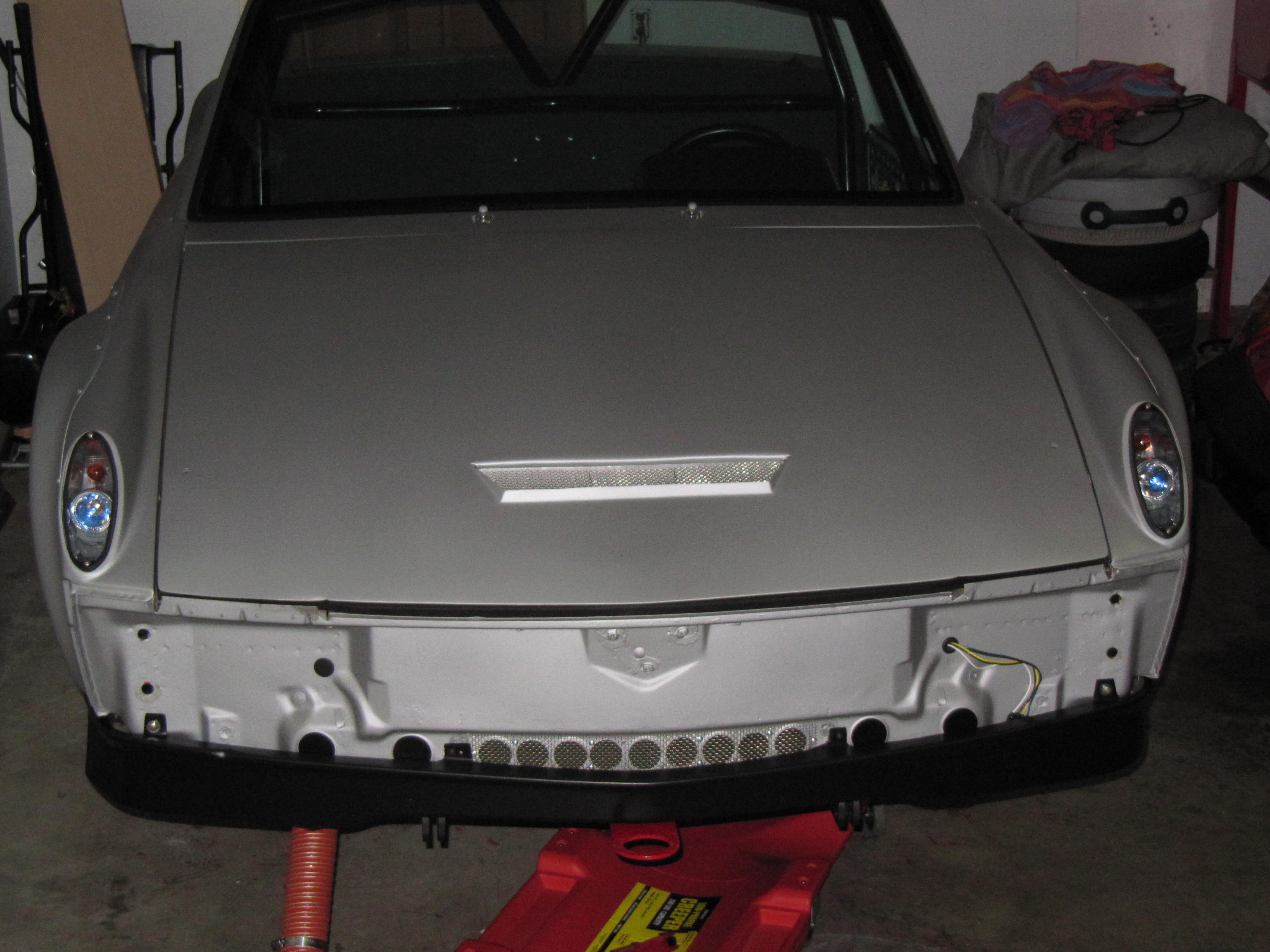

The front!

Look out!! (IMG:style_emoticons/default/piratenanner.gif) (IMG:style_emoticons/default/piratenanner.gif)
post Nov 29 2012, 09:07 PM
Post #36
Resident Electrician
Posts: 8,348
Joined: 22-June 09
From: Midlothian TX
Member No.: 10,496
Are the lights bolted or just wedged into the housing? A few miles down the road they may be pointing at the sky... (IMG:style_emoticons/default/sad.gif)
Krieger
post Nov 29 2012, 09:18 PM
Post #37
Posts: 4,869
Joined: 24-May 04
From: Santa Rosa CA
Member No.: 2,104
They couldn't go very far they would hit the outer cover. I do not plan on driving this at night.

Q. Are they bolted in or just wedged into the housing?
A. They couldn't go very far they would hit the outer cover. I do not plan on driving this at night.
I guess I missed the point. How are they mounted / adjusted?

You need lights to legally drive on the road. I meet that requirement. I mentioned in a previous post that with a little more work they could be made to adjust with a long thin screw through both housings and a nut on either side of the PIAA. I got tired of this project and it is enough for now and can be revisited later.

Vent the lamp housing with a 1/16th inch hole at the lower rear of the bucket. It will keep the lexan lense from leaking and heat crazing.
