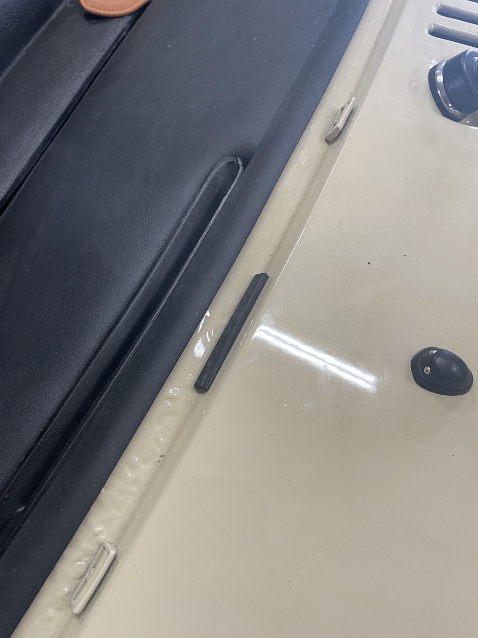

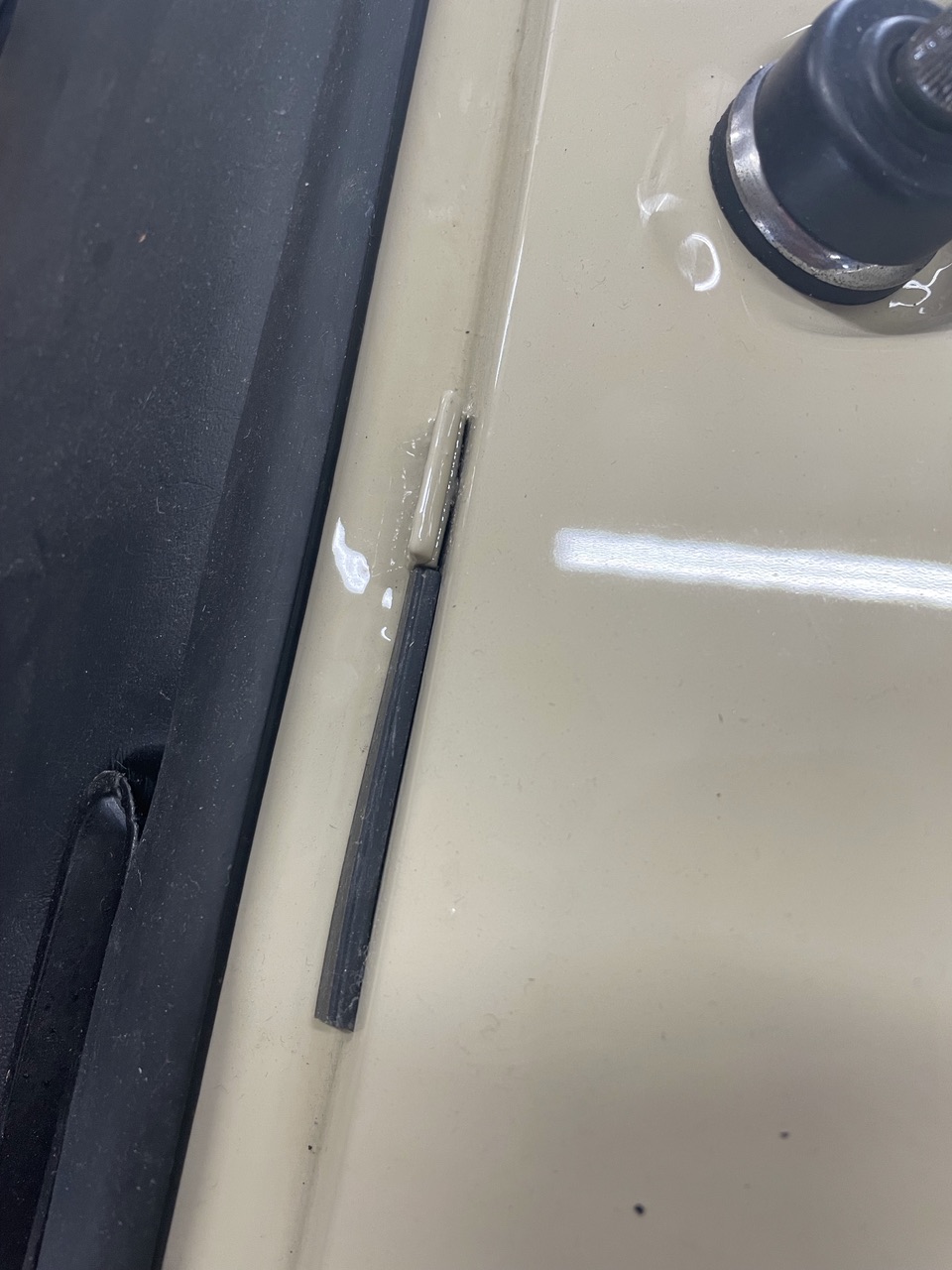

East coaster
post Apr 13 2024, 05:11 PM
Posts: 1,902
Joined: 28-March 03
From: Millville, NJ
Member No.: 487
A couple pics…….I guess I don’t understand their purpose if the windshield is going to bottom out against the trim clips before it ever touches the spacer. It seems to be from the Dept of redundancy Dept.
Here’s the spacers butted up against the clip and you can see it’s lower than the clip.
bkrantz
post Apr 13 2024, 09:19 PM
Posts: 8,554
Joined: 3-August 19
From: SW Colorado
Member No.: 23,343
When I did mine, the glass also sat too low with the thinner rubber spacers. I doubled them so the glass sat more centered top to bottom.
Can-Am
post Apr 13 2024, 09:20 PM
Posts: 37
Joined: 20-November 07
From: Scottsdale, AZ
Member No.: 8,360
You don't want the glass resting on the clip. The clip needs to flex a little to allow the molding to snap into place. The glass can slide down too far without an appropriate spacer. I don't really like the spacer you've got.
76-914
post Apr 14 2024, 07:01 AM
Posts: 13,828
Joined: 23-January 09
From: Temecula, CA
Member No.: 9,964
I believe that dimension is detailed within this manual-(Chassis). IIRC this gives the exact dimensions and IIRC the material is wood. You could mill them from plasticI suppose. I threw away the rubber strips and used wood pieces from a yardstick. http://p914-6info.net/PDFs/Group%208%20Body.pdf
