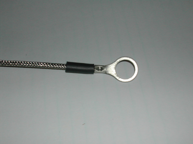

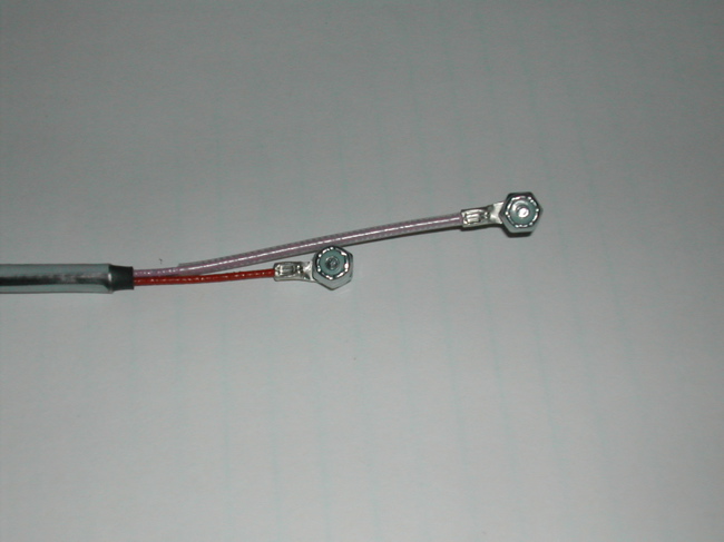

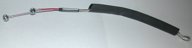

Sender
You will need to buy the appropriate probe/sender for your application. A standard Type IV spark plug is 14 mm. The smaller plugs that Len is using is a 12 mm motorcycle spark plug. I can't vouch for which sender should be used for this application. The sender only comes with about 12" of wire. You will need to purchase an extension lead (see below). The sender comes with a section of heat shrink tubing to protect the screw connections between the sender and the extension leads. The section of wire close to the heat source is protected by a braided wire exterior. This is a very nice feature. (IMG:style_emoticons/default/biggrin.gif)

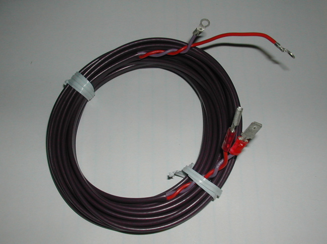

Extension Leads
You will need to purchase either the 7' or the 15' CHT extension lead (make sure you don't accidentally get the EGT leads). These are special wires. You can not use normal copper wire to extend the wires. The wires come pre-crimped with the appropriate connections. So it's a simple plug in installation. I purchased the 15' kit for my 914 as I suspect the 7' is too short, unless you're doing something unique.
