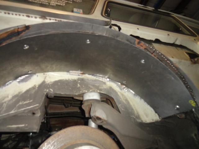

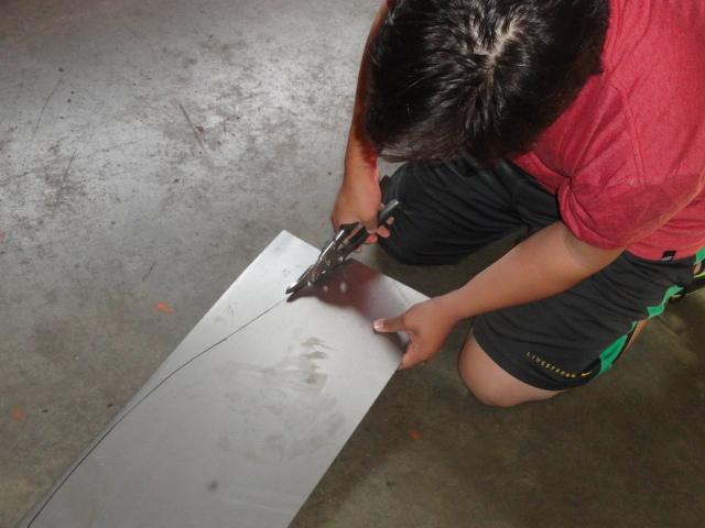

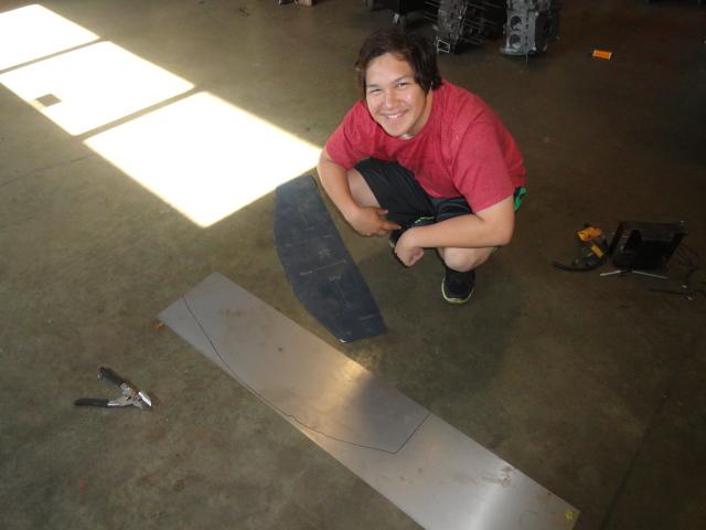

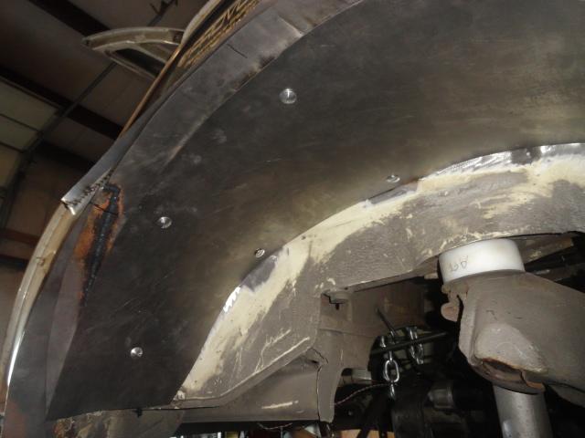

I had Josh trace out and cut the second inner fender well panel for the Squarsche today. He'll be doing a mirror image of what he watched me do yesterday on the passenger side.
(IMG:http://www.914world.com/bbs2/uploads_offsite/images.thesamba.com-9730-1405528487.1.jpg)
(IMG:http://www.914world.com/bbs2/uploads_offsite/images.thesamba.com-9730-1405528488.2.jpg)
On the passenger side I marked and welded in the dzus anchors I bought from Speed Mart into the OEM inner fender well. This will act as an air duct to bring cooling air from the NACA ducts fwd of the rear wheel, over the rear wheel and straight into the OEM cool air duct at the back of the car. This will help to force-feed the fan at speed. I went this route rather than just switch to the later fender grills and *hope* enough air would find its way into the fan.
Since we're running at Bonneville, we had better be able to clean the ducts out after racing, so they are being held in with dzus fasteners. Here's my side:

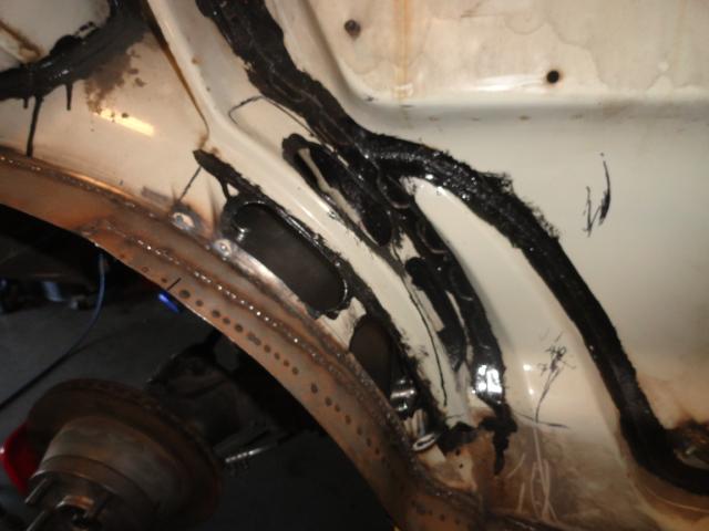

(IMG:http://www.914world.com/bbs2/uploads_offsite/images.thesamba.com-9730-1405528488.3.jpg)
(IMG:http://www.914world.com/bbs2/uploads_offsite/images.thesamba.com-9730-1405528488.4.jpg)
(IMG:http://www.914world.com/bbs2/uploads_offsite/images.thesamba.com-9730-1405528488.5.jpg)

1. I got the inner fenders sealed for the NACA ducts to bring cooling air to the engine. This was huge. Originally, I had grandiose schemes of ducting from the NACA ducts to the inner fenders, however I had grossly over thought this. All I needed to do was to prevent air from traveling from the NACA ducts to the rear section of the fenders and attempted a fiberglass ducting system to make this happen. . . I lost a n entire day on this fiasco. A simple 6" wall prevents this and the "lazy air" will have no choice but to go down the duct over the rear tire and into the engine. Woohoo!! A HUGE burden has been lifted off my shoulders. . .

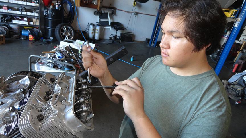

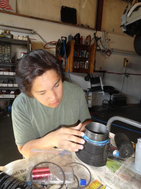

After weeks of delays due to shop and family commitments as well as part incompatibility issues, Josh was finally able to finish the engine build that he started several weeks ago. None too soon I might add since it is getting down to the wire on this project!!

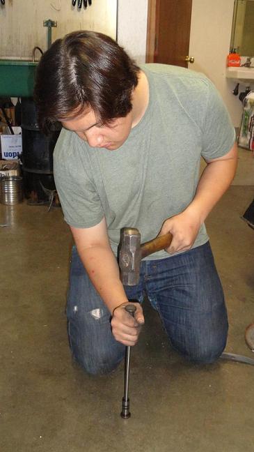

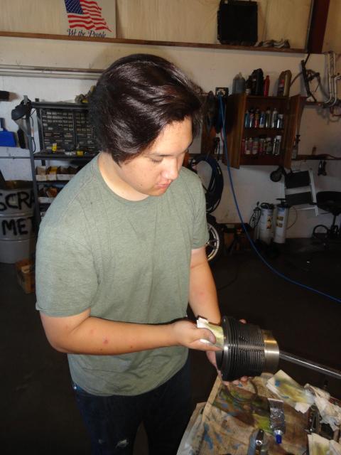

One of the issues we had was when I ordered a ring set, TWICE, I was sent the wrong oil control rings. Each time, causing a week or more in delays. . . Man was it nice to get those cylinders on and the motor finished. Here are a few shots of Josh back at it getting the cylinders prepped and heads on and torqued.
(IMG:http://www.914world.com/bbs2/uploads_offsite/images.thesamba.com-9730-1407385066.1.jpg)
(IMG:http://www.914world.com/bbs2/uploads_offsite/images.thesamba.com-9730-1407385067.2.jpg)
(IMG:http://www.914world.com/bbs2/uploads_offsite/images.thesamba.com-9730-1407385067.3.jpg)
(IMG:http://www.914world.com/bbs2/uploads_offsite/images.thesamba.com-9730-1407385068.4.jpg)
(IMG:http://www.914world.com/bbs2/uploads_offsite/images.thesamba.com-9730-1407385068.5.jpg)

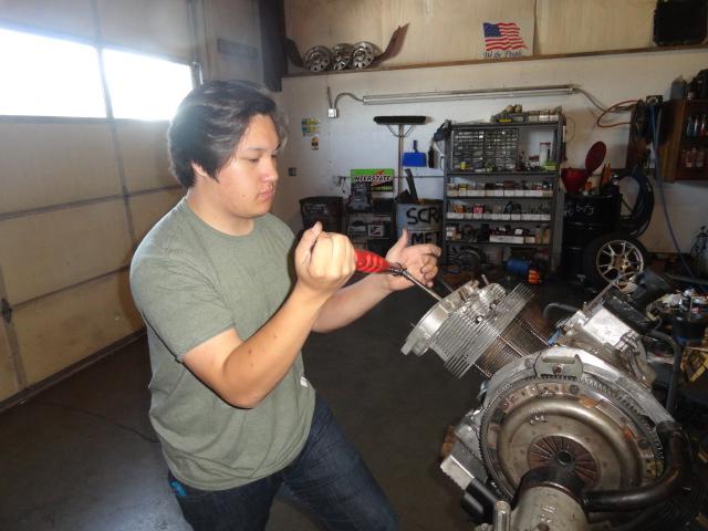

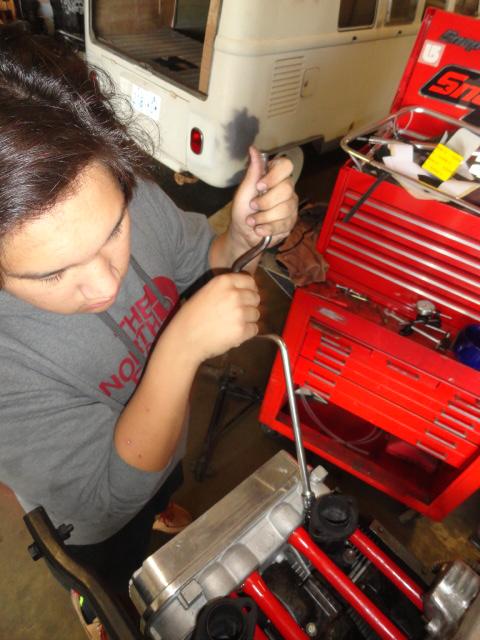

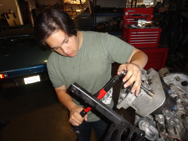

After we determined our rocker geometry and made adjustments via shims and push rod length, Josh got down to making the custom length chromoly push rods. He did a fantastic job!!
(IMG:http://www.914world.com/bbs2/uploads_offsite/images.thesamba.com-9730-1407385069.6.jpg)
(IMG:http://www.914world.com/bbs2/uploads_offsite/images.thesamba.com-9730-1407385069.7.jpg)
He then was able to get the modified 1.7L rockers w/ OEM Porsche 911 adjusters installed and the valves adjusted.
(IMG:http://www.914world.com/bbs2/uploads_offsite/images.thesamba.com-9730-1407385069.8.jpg)

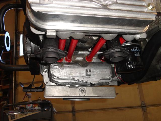

Before the engine tins went on, we set the air gap at the hall sensor and 36-1 trigger wheel to 3mm and verified a good signal with a multimeter. We wanted to do this now since getting at it later will be “fun”.
Then began the job of the engine tins. We robbed these off the old 2056cc and cleaned them-up.
(IMG:http://www.914world.com/bbs2/uploads_offsite/images.thesamba.com-9730-1407385071.10.jpg)

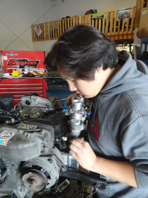

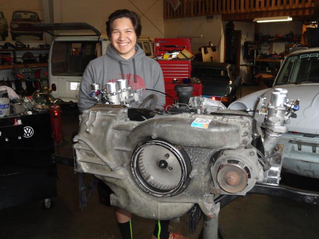

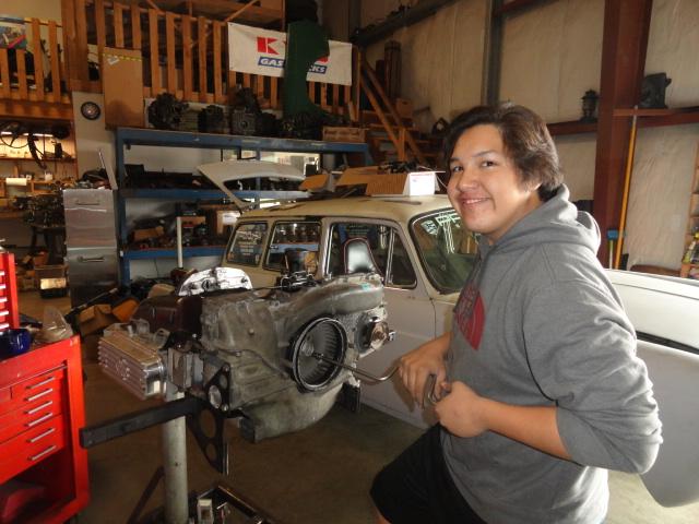

After that, we mounted the ITBs and synced the linkage, which only took about 30 seconds (try syncing any other type of linkage that fast).
(IMG:http://www.914world.com/bbs2/uploads_offsite/images.thesamba.com-9730-1407385071.11.jpg)

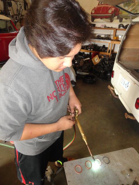

Then I had Josh break out the torch and anneal the copper exhaust gaskets so they would be butter-soft for good stub sealing.
(IMG:http://www.914world.com/bbs2/uploads_offsite/images.thesamba.com-9730-1407385072.12.jpg)
After they cooled, he installed them into the ports, anti-seized the studs and mounted the custom stubs using OEM Porsche 914 2.0L exhaust nuts.
(IMG:http://www.914world.com/bbs2/uploads_offsite/images.thesamba.com-9730-1407385072.13.jpg)
(IMG:http://www.914world.com/bbs2/uploads_offsite/images.thesamba.com-9730-1407385073.14.jpg)

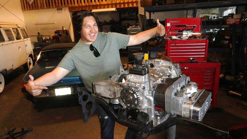

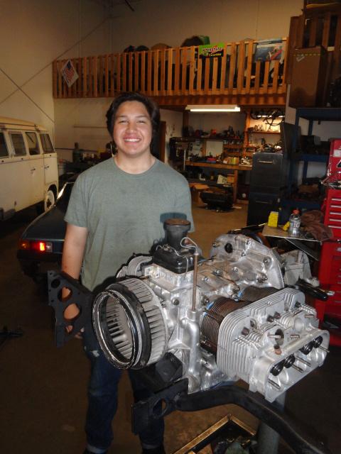

Below is a shot of Josh and his first motor build. I’m really proud of him and what he has created here.
(IMG:http://www.914world.com/bbs2/uploads_offsite/images.thesamba.com-9730-1407385073.15.jpg)

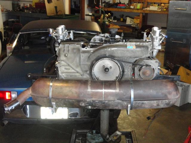

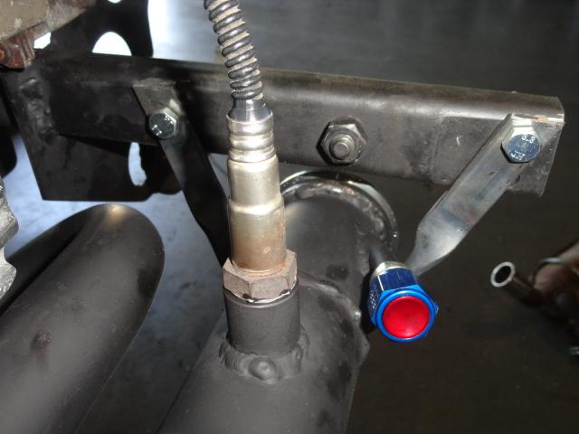

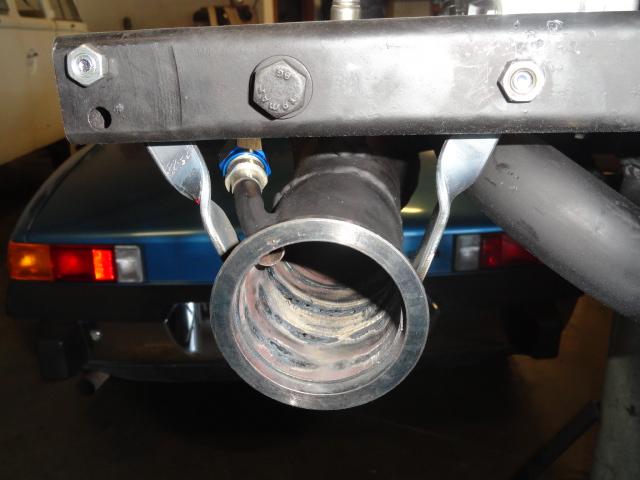

Today, I had to make an exhaust hanger just before the V-band. With the 911 muffler, this is not needed, but if I run a straight pipe, it will need to be supported. This is what I came up with.
(IMG:http://www.914world.com/bbs2/uploads_offsite/images.thesamba.com-9730-1407385074.16.jpg)
(IMG:http://www.914world.com/bbs2/uploads_offsite/images.thesamba.com-9730-1407385074.17.jpg)
Then we got the header on and the muffler installed.
(IMG:http://www.914world.com/bbs2/uploads_offsite/images.thesamba.com-9730-1407385074.18.jpg)
(IMG:http://www.914world.com/bbs2/uploads_offsite/images.thesamba.com-9730-1407385075.19.jpg)

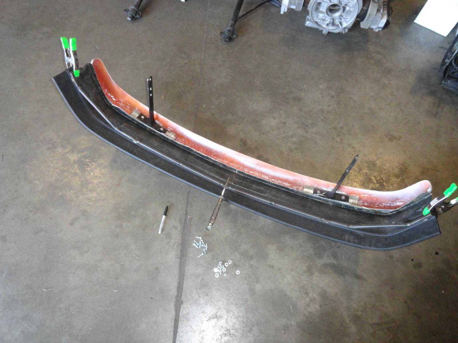

I made some more progress yesterday. I modified the tank (via BAH (IMG:style_emoticons/default/laugh.gif) ) and got it mounted. That enabled me to be able to finalize the front strut bar and weld-in the studs for it.
(IMG:http://images.thesamba.com/vw/gallery/pix/1241954.jpg)
This is the first front stiffener to go in. I'm going to be doing some testing in the months to come to see if more will be needed.
I also made the spoiler stiffener support and mounted it to the inside of the spoiler. This is necessary because all the force of the air at high speeds will eventually break the mounts for the bumper since they are just fiberglassed in place. This will support the bottom really nicely and make it solid at high speeds. I still need to make the strut bars that tie it to the front suspension, Since I ran out of materials.
