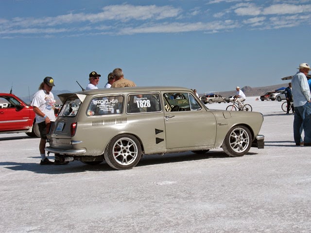

Friday:
We got on the salt by 11:30. Spent about 3 hours getting out pits set-up. Most of the air-cooled VWs are together in a long row. We're next to the Appletree guys.
Breezed through tech with no issues. One minor rule they added literally while I was in line was taping the headlights, so we did that and it was a done deal.
Saturday:
We arrived late and missed the drivers meeting. No big deal as it's pretty straight forward. Right about 9:30 we got in the 130-club line on the short course. Soon after that, racing was stopped because a gal driving a streamliner motorcycle (250+mph) crashed and the only ambulance at the flats had to take her to the hospital to get checked out. Around 1pm racing resumed. The VERY NEXT car on the long course was a steam powered streamliner. It too crashed and racing stopped again until about 3pm.
By about 4pm I was able to make my qualifying run(!). It went off without a hitch. The car is running very rich due to the high altitude (4200ft) so I'll have to address that in the morning by adjusting the altitude compensation % in the ECU. Because of this the the motor was really lazy feeling , 5th gear was basically useless. It just couldn't pull in high gear. Shifting at a conservative 5K, we held 90mph through the speed traps. We were limited to no more than 100mph on the qualifying run so we could feel-out the car. The car is absolutely rock solid. Not a wiggle or shake or wander to be had. I couldn't be happier with how it drove.
We were able to officially be the first type-3 to ever compete at Bonneville and we bested the current type-3 top speed by 15 mph on the speed limited qualifying run. Once I get the AFRs leaned out to where they are at sea level, this thing should really fly.
After we got to the pits Cap'n Krusty walked up with his friend and we spent the better part of the afternoon chatting and watching the car fly by at the 3 mile marker on the long course.
More to follow. . .

post Sep 7 2014, 12:13 AM
Post #300
The Aircooledtech Guy
Posts: 1,966
Joined: 8-November 08
From: Anacortes, WA
Member No.: 9,730
During the marathon wait in the staging lanes. . .
I'll post more tomorrow evening. I'm spent for today.
