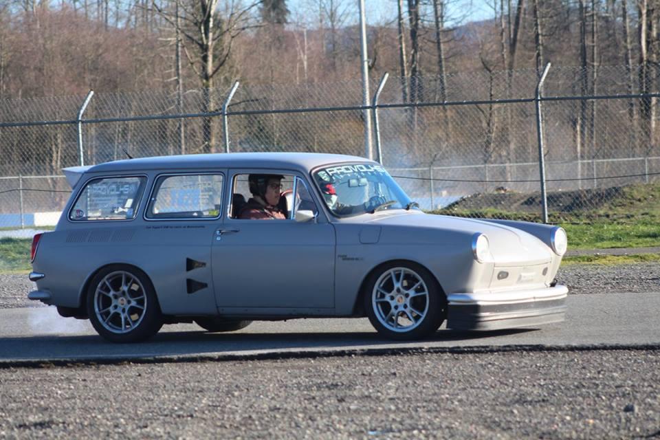

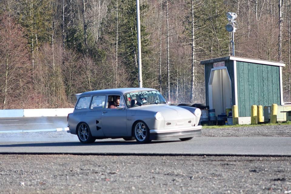

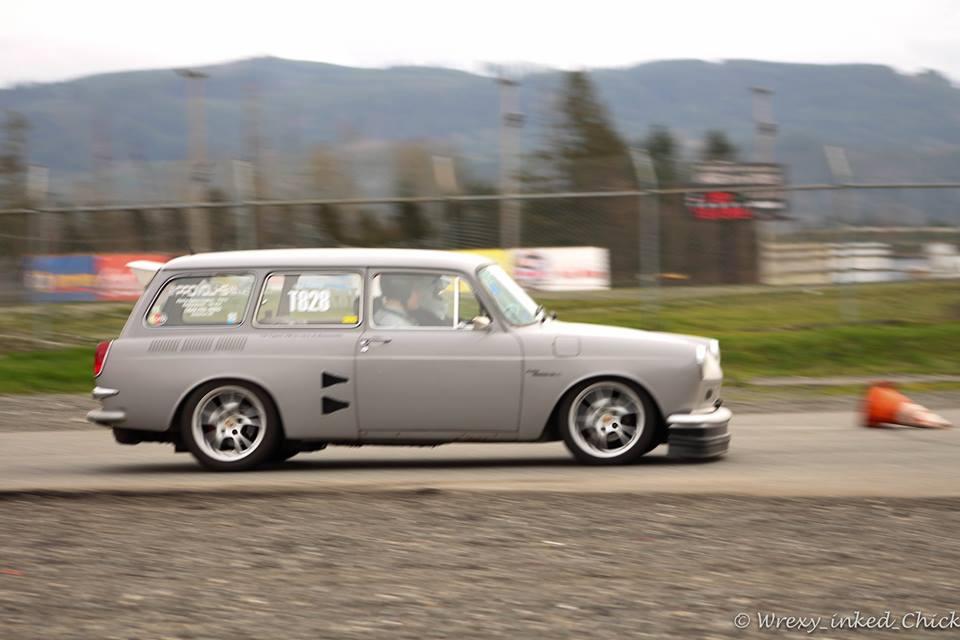

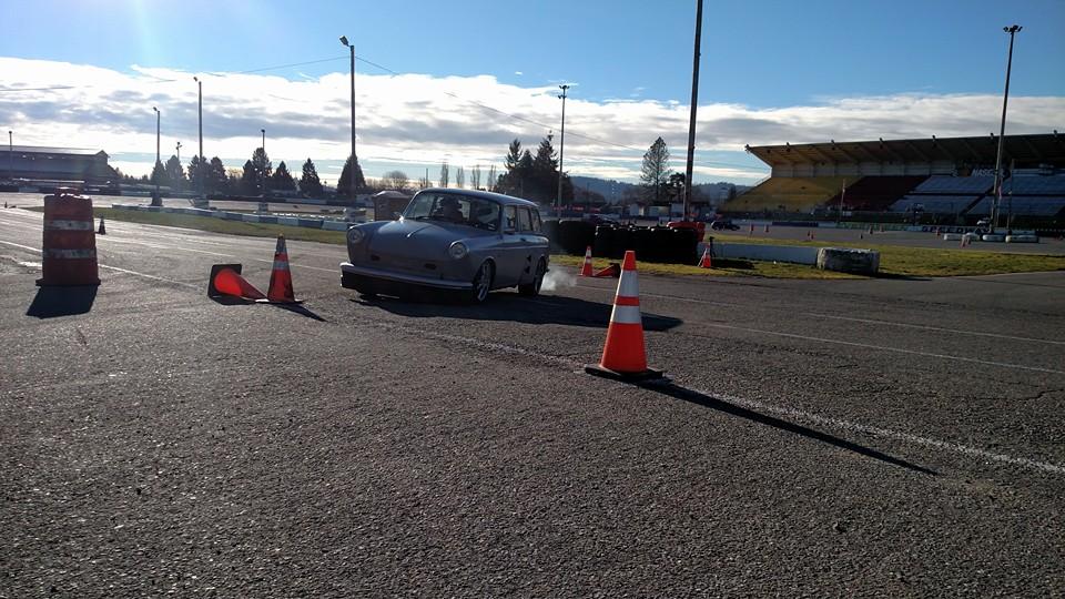

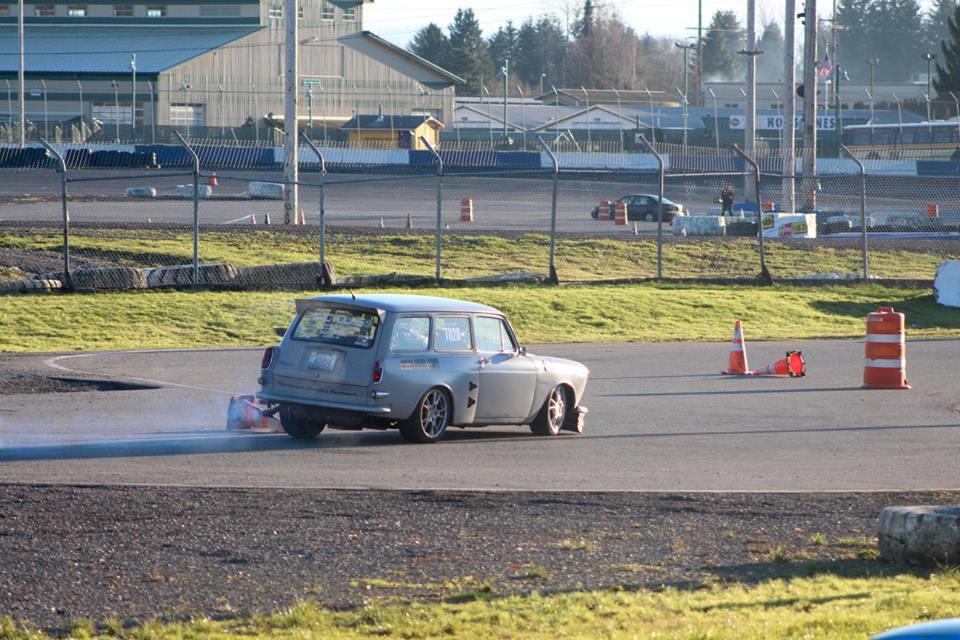

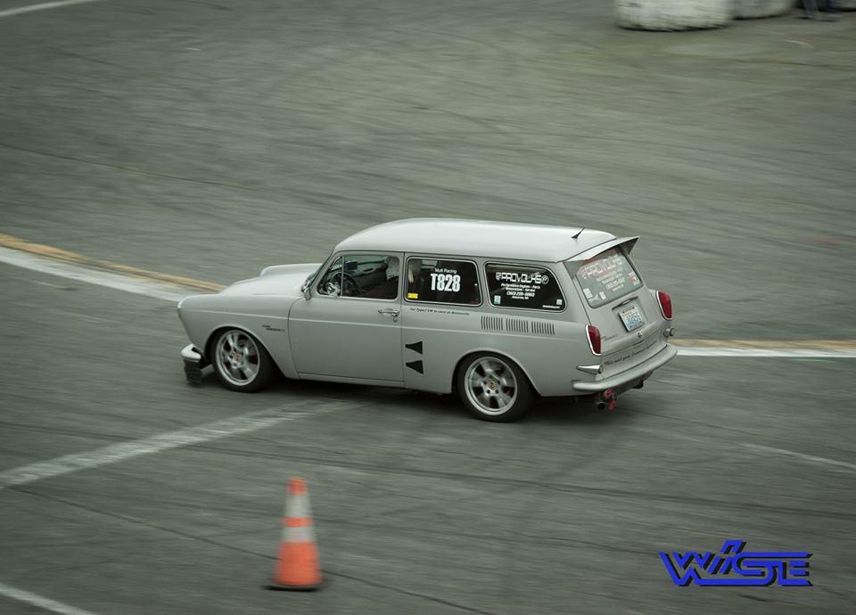

January 9th, Josh & I headed down to Evergreen speedway to test & tune at the Auto-X. This was to be our maiden outing with the new motor that Josh built and the stable of extra ponies it has. Other than my poor driving skills, the car performed great and while cold (mid-40s), the weather was PERFECT and sunny. The day was not without it's minor issues though. . .
1. I haven't driven the car in almost 2 months because of the really cold weather and the car currently has no heat. So I forgot to re-adjust the shift linkage and it was a bit sticky going from 2nd to 3rd making it easy to accidentally shift into 5th. This made coming out onto the front straight at the end rather tricky and several shifts there were missed there throughout the day which really effected the lap times. My fault; not the car. Compared to the last time though, my speeds through the start/stop line at the end went up by 15mph with the new motor, so the acceleration is really improved.
2. I do much of my "tuning runs" at night since they are not exactly legal. I found out today in the light of day that above 4.5-5K rpms, my exhaust vacuum breather system pulls a lot of oil vapor directly into my muffler. It's like flipping on the "007 smoke screen". . . :evil: Embarrassing, but not a big deal and a simple fix. I never noticed that was happening until I drove it hard in the day light. (IMG:style_emoticons/default/laugh.gif) Later in the day, I removed and capped the exhaust vent, and Viola!! No smoke. :roll: :wink:
3. I have got to migrate more weight to the front and put this gal on a diet in the rear. My Lexan windows are going in. I also need to add front camber and a new set of front tires. I found that stiffening the front made under-steer worse, so I softened-up the Konis in the front and she began to hook better in the corners.
I did have a couple incidents that were a bit scary. The R-rear tire drifted out on a corner on one run when Mario Velotta from the dubshop.net was riding with me and it hit a massive pot-hole on the edge of the track. At first I thought I had blown a tire or at the least bent a rim with the impact. Luckily no damage to anything. #-o If you want to see his video he shot of the run, check out The Dub Shop facebook page. . . :oops: The other incident was on the next run and I was giving Rob a ride. Apparently I need to add a handle for passengers to hold onto. He thought the red strap on the door would be a good place to hold on. He quickly opened the door while going through the slalom section. So every left-hander, the door would fly open with him holding onto the loop wondering what was going on. I had a short straight after a 90degree right-hander and told him "let go of the strap" while leaning over and shutting the door. (IMG:style_emoticons/default/laugh.gif) We laughed our asses off about that the rest of the run!!
Here's a few shots from the day with videos to follow. . .

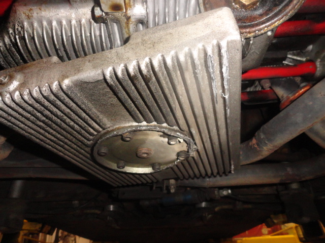

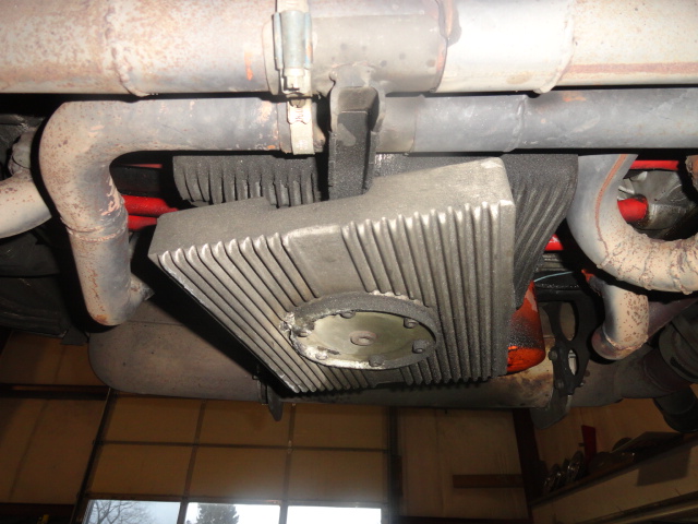

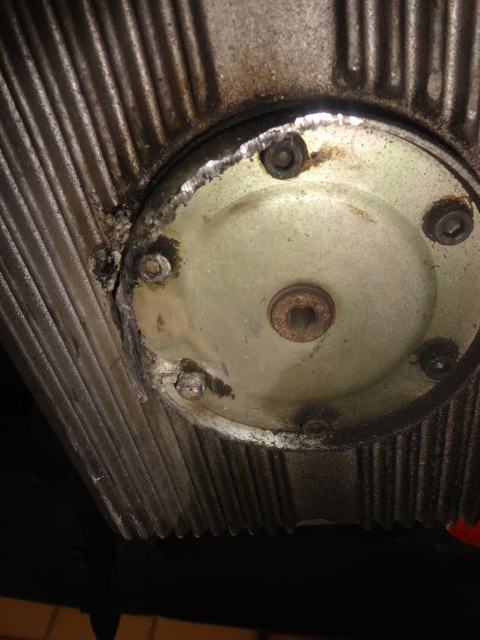

I don't think it gets any closer than this. . . When I drifted the R-rear off the track, I took a hit to the deep sump and spun it about 15 degrees!! I am freakin' AMAZED that this thing did not/is not leaking!!! The wheel faired just fine in the ordeal. A skid plate may be in order or fast-tracking the dry sump system!!
Here's a short video. The rear view in the middle is the run I drifted into the hole at the track edge. . .
https://www.youtube.com/watch?v=wTaFLv9bKuU
Here's the damage. I dodged a bullet on that one!!

(IMG:http://www.914world.com/bbs2/uploads_offsite/images.thesamba.com-9730-1452456966.5.jpg)
Nate, I love the wagon and enjoy updates on your build. However, I think you might need a stiffer front anti-sway bar... looks like you're about to rub the door handle off! (IMG:style_emoticons/default/blink.gif)

QUOTE(strawman @ Jan 17 2016, 06:57 PM) *
The sway bar I have is a 1" hollow bar with 28 way adjust-ability. Currently it's about in the middle. I will be using a slightly stiffer setting next time. There is a balance though between stiff/soft and under/over steer.

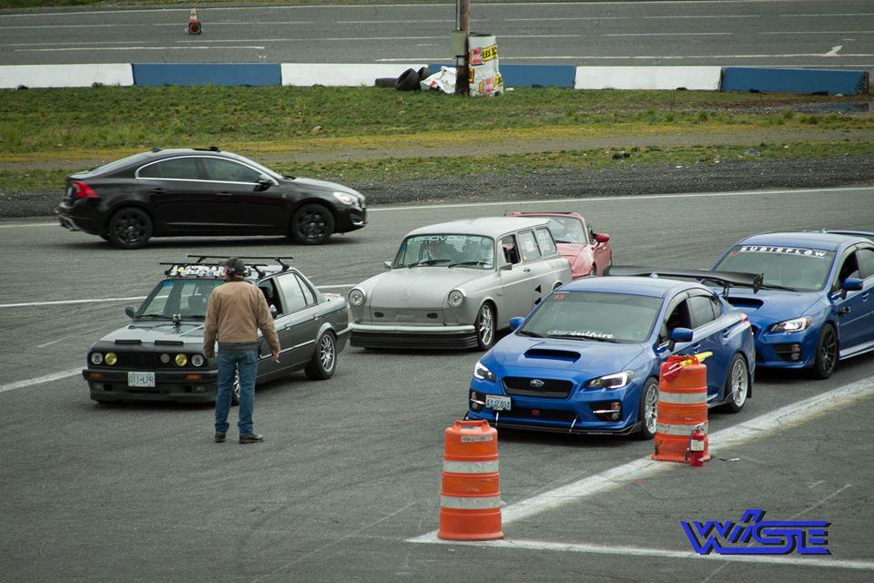

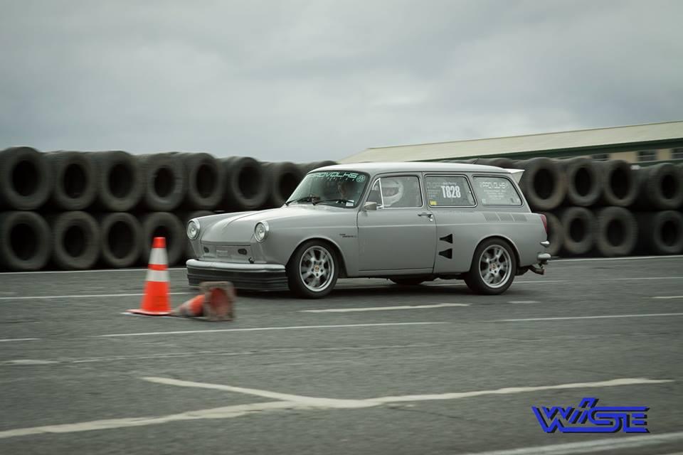

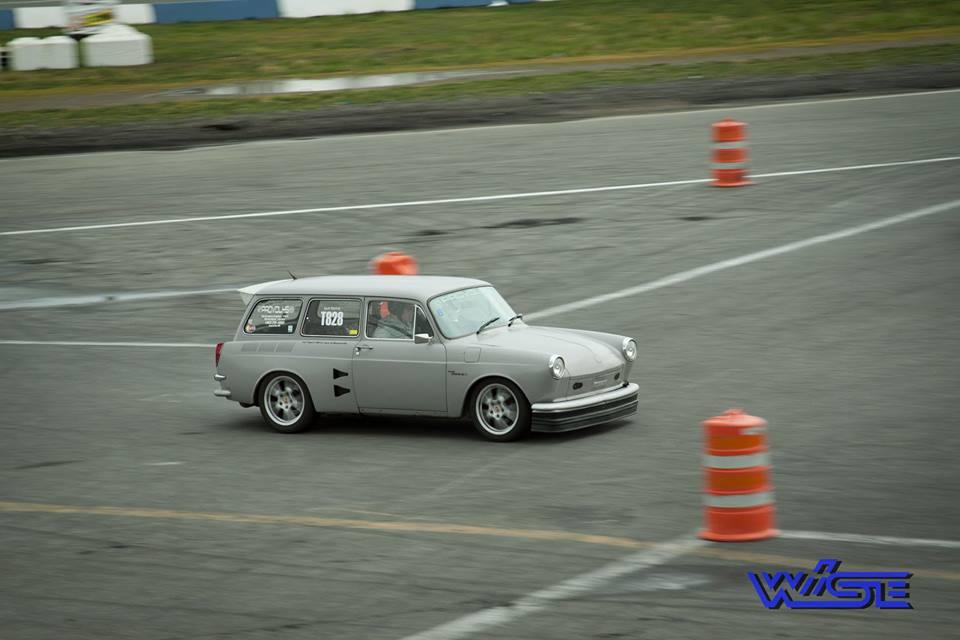

Spent another fun and exciting day at the track auto-X'ing the Squarsche. For those of you PNW guys who actually *DRIVE* your cars, this is a great place to learn car control and it's only $50!! Since my last outing I had repaired the sump, changed over to Mobil-1 full synthetic oil, moved the rev-limiter up from 5.6K to 6.5K, added 2 degrees of camber and re-set the toe on the front and beefed-up my left rear engine mount area since it had begun to crack like the right side did earlier (I knew that was coming).
These mods (mainly the camber/toe adjustments and the rev limiter) helped shave almost 2 seconds off my times. The track was similar, but they changed the gates through the slalom section which tested my sight/muscle memory/control a lot. Read that: I blew a lot of gates in the morning getting my rhythm on the course. It never rained, but was cool (mid 40F low 50s) and was clear by the end of the event; PERFECT!!
With a real set of sticky tires, I could probably shave another 2-3 seconds off my times easy. The tires I have now are almost bald on the fronts (maybe a 1/16"<) and just need to be wider & stickier to keep the rear-end under control. I never thought 235/40s would not be enough, but I think I'm going to have to step-up to 225/45 & 255/40s when I buy the sticky set. But better tire$ will have to wait unfortunately. I love going to Evergreen Speedway for these events. We had 71 cars show-up in total and i still got 17 runs. It's all about the seat-time. :twisted: Here's a couple shots from Saturday's action.
