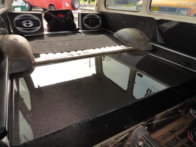

I doubt that the rear seat will ever go back in. Nobody ever sat back there and you really needed to be either under 5y/o or a double amputee above the knee to fit anyway. . . So I boxed it in.
(IMG:http://www.914world.com/bbs2/uploads_offsite/images.thesamba.com-9730-1461267498.1.jpg)
I had enough extra carbon fiber from my door panels to make a matching box. I used 1/2" foam core to give it rigidity and still keep it light. I think the whole box weighs around 6#. Compare that to the seats which are somewhere in the 40-50#+ range.
It's actually not finished yet. I plan to cut about 6' from each side and hinge the middle from the rear to access everything underneath. I have it all one piece for now since I won't have that finished before Springmeet on Sunday.
