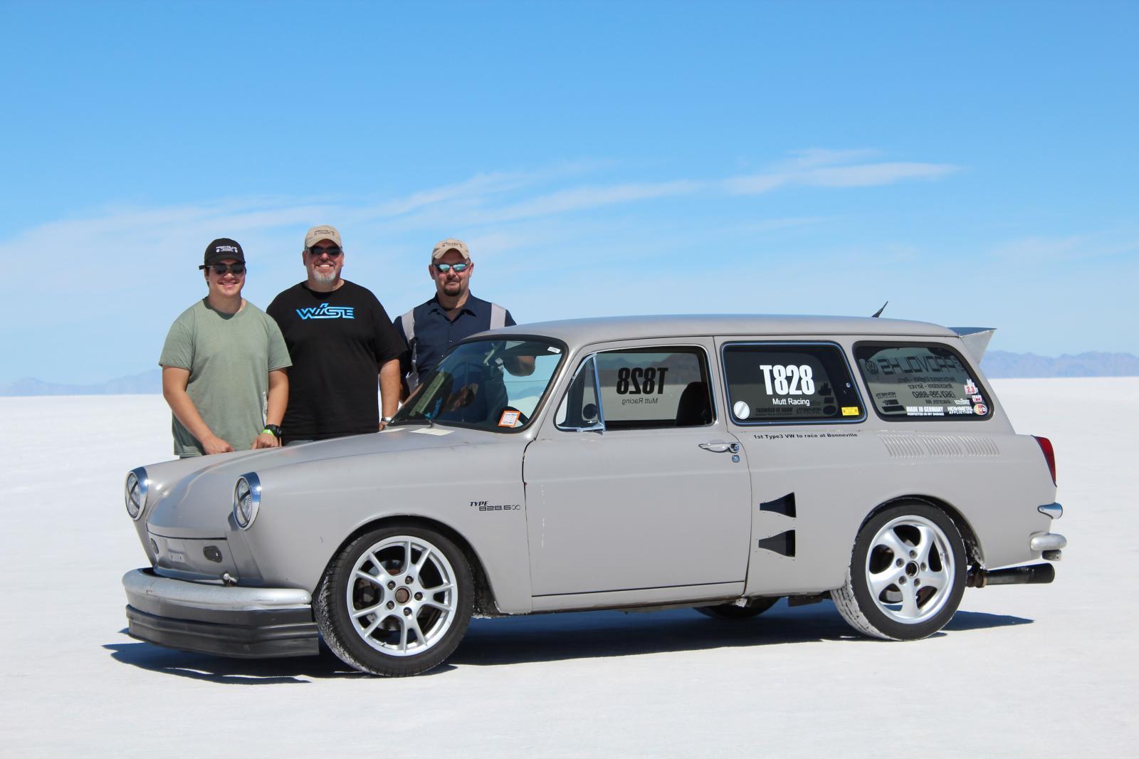

We made it back down for round 2 @ Bonneville. This year we have the motor we should have had back in 2014. Also, my son Josh will also be driving the car too!! He literally picked-up his drivers license 4 days ago (Tuesday) and will be making his racing debut today out on the black line on the short course. If there's time, we'll re-tech, re-number the car and I'll take a crack at it
Going through tech
(IMG:http://www.914world.com/bbs2/uploads_offsite/images.thesamba.com-9730-1473503055.1.jpg)
Josh pre-race photos
(IMG:http://www.914world.com/bbs2/uploads_offsite/images.thesamba.com-9730-1473503056.2.jpg)
This years crew- Josh, me & Robert
(IMG:http://www.914world.com/bbs2/uploads_offsite/images.thesamba.com-9730-1473503057.3.jpg)

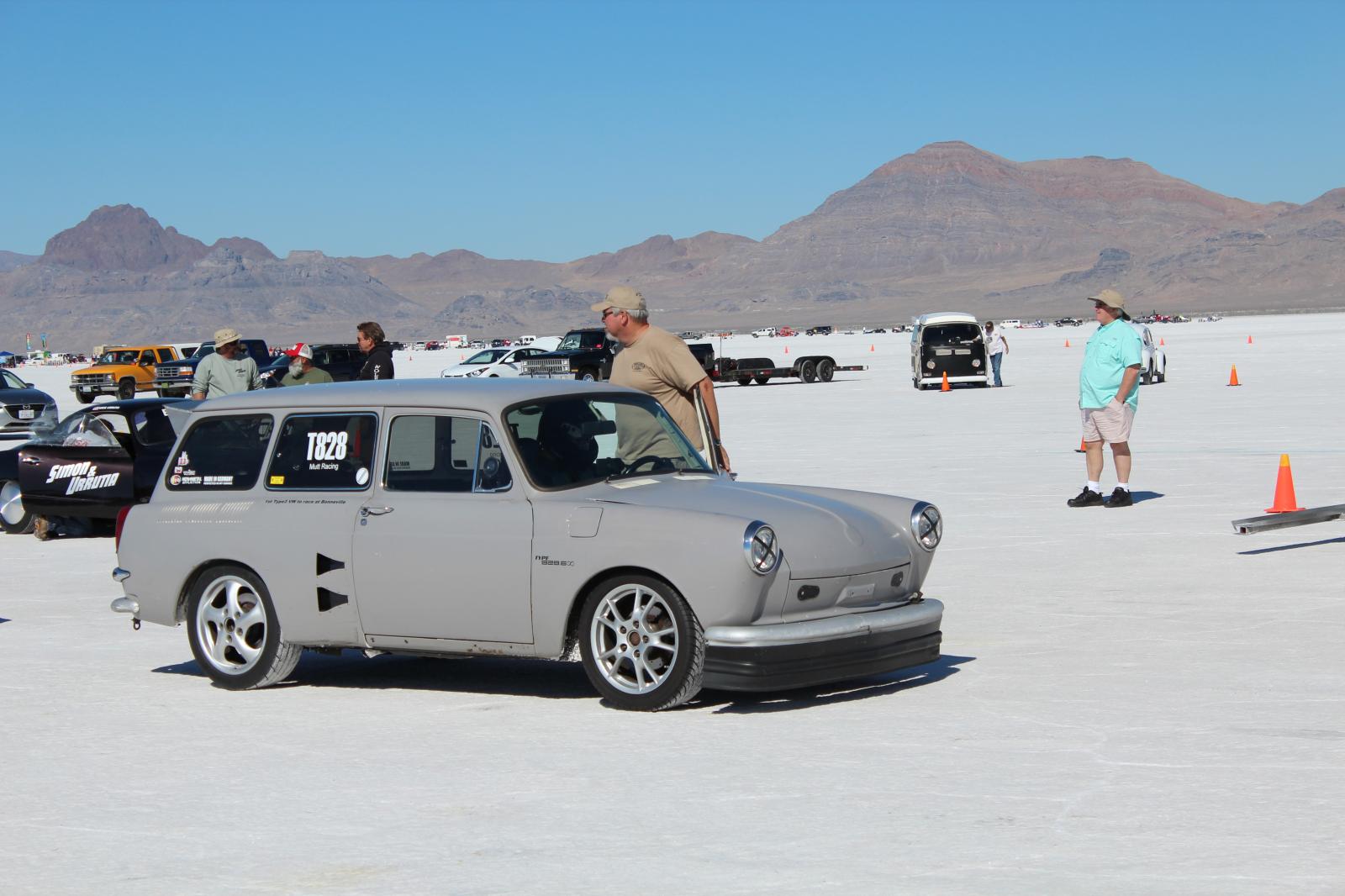

Today was the first day of racing. Josh kicked @$$!! I'm one super proud dad!!
On his first run (the qualifying run), he sandbagged it in 4th gear and ran a 104mph revealing me of my previous 2014 VW Challenge record. It wasn't a clean run, but it was good enough with the new motor.
His second run was mostly clean and the fastest of the day @ 115.4mph!! He's definitely raised the bar. What makes this even better is that he only recieved his drivers license 4 days ago and this was literally the first time he drove any car on his own w/o either me or his mom in the car with him!! I'm super proud of him!!
We're running just a little rich which will hurt power, so I e-mailed a datalog and tune to Mario from thedubshop.net and he's making positive changes to the tune. So tomorrow we should be even better. You just gotta love technology.
I ran my fastest w/o the front air dam and bumper assembly back in 2014, so we're going to run it removed and see how if that helps. We're also going to be taping all the seams and vents with duct tape too. :wink:
Getting ready to run getting last minute advise from Dad:
(IMG:http://www.914world.com/bbs2/uploads_offsite/images.thesamba.com-9730-1473554103.1.jpg)
Carlos Wheeldon checking his belts and safety gear before his first run:
(IMG:http://www.914world.com/bbs2/uploads_offsite/images.thesamba.com-9730-1473554104.2.jpg)
Away he goes. . .
(IMG:http://www.914world.com/bbs2/uploads_offsite/images.thesamba.com-9730-1473554104.3.jpg)
(IMG:http://www.914world.com/bbs2/uploads_offsite/images.thesamba.com-9730-1473554104.4.jpg)
(IMG:http://www.914world.com/bbs2/uploads_offsite/images.thesamba.com-9730-1473554105.5.jpg)
