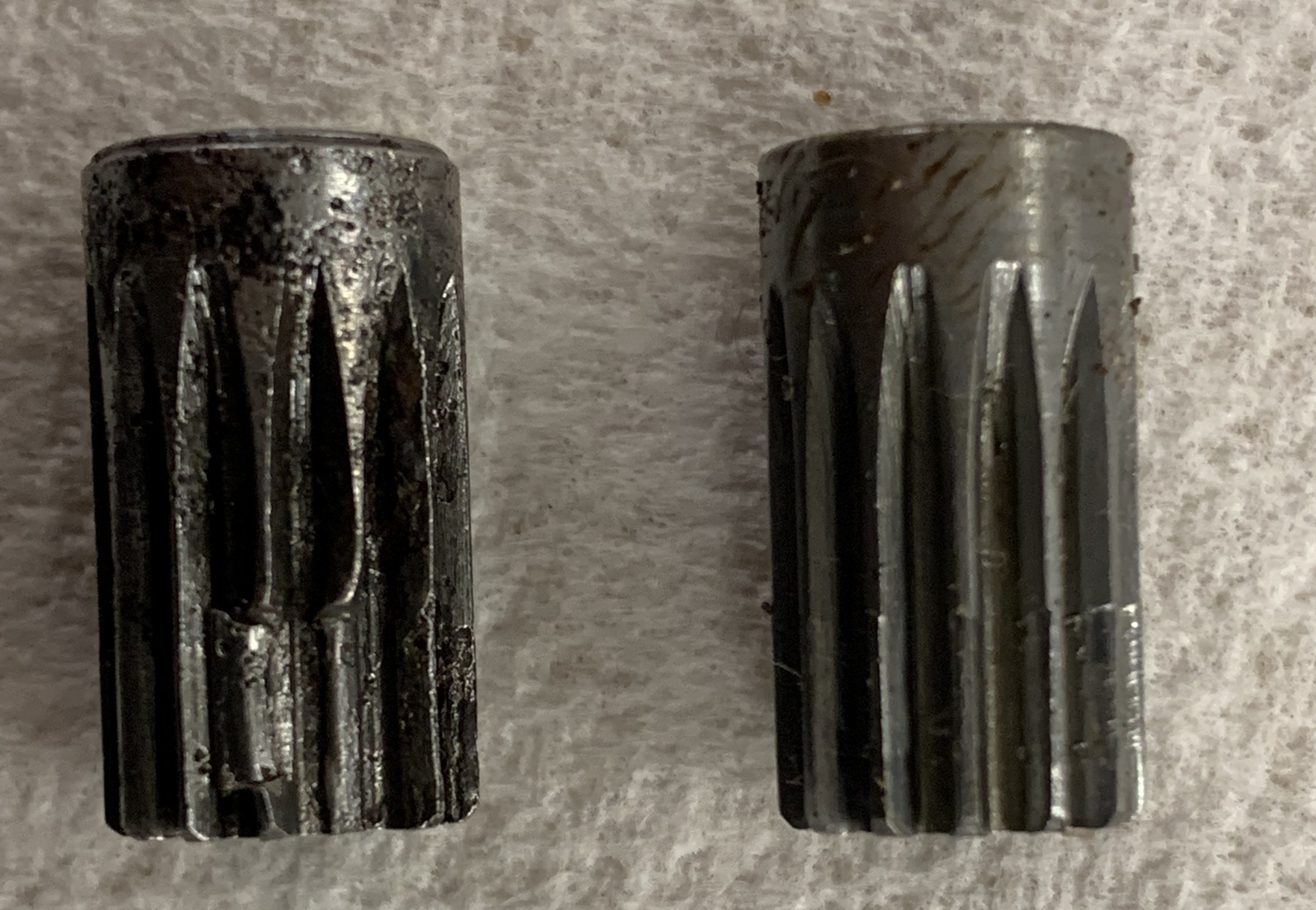

And for those who might be intested in what a dead inner adjuster looks like:
The adjuster on the left is now a very small paper weight, because it's too small to be a boat anchor. The other looks pretty good, at least to me, even though it does show signs of wear.
