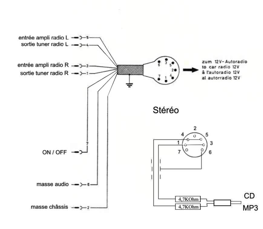

It's a 2-pin inline DIN connector, e.g. http://www.rpelectronics.com/358-120-1-din...pin-inline.html
Any good electronics supply shop will have them.

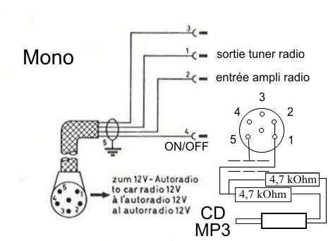

As for the AUX input, you can make your own adapter like I did, following the diagrams below (stereo or mono depending on what type of Frankfurt you have). Or there are some eBay sellers offering adapters.

Thanks for the help! I don't see a spot for the flat part of the connector, but I will recheck. The DIN connector should allow me to attach an iPod to the radio, which should bring it into the current century while still keeping the vintage look.
