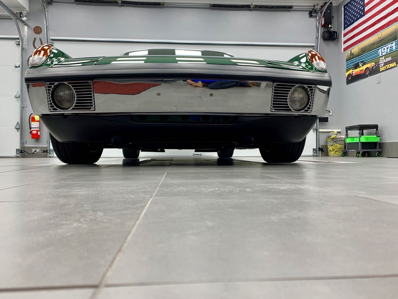

Finally started mocking up the GT bumper and valance.. Needs plenty of love but maybe able to make a kit. Attached Image

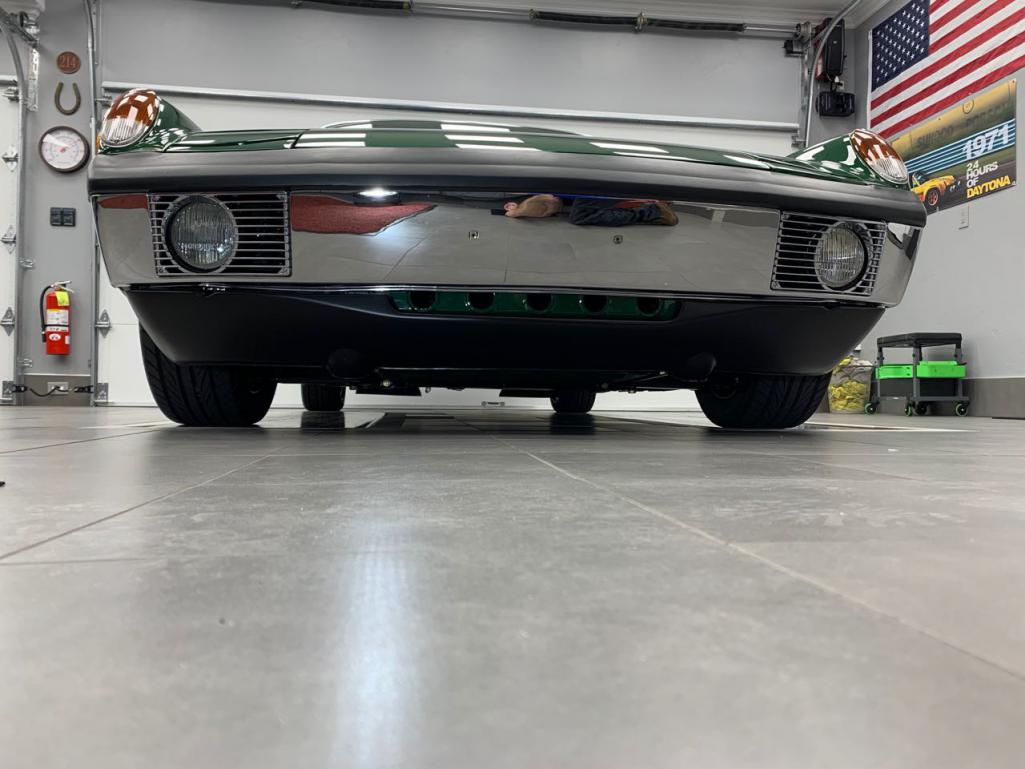

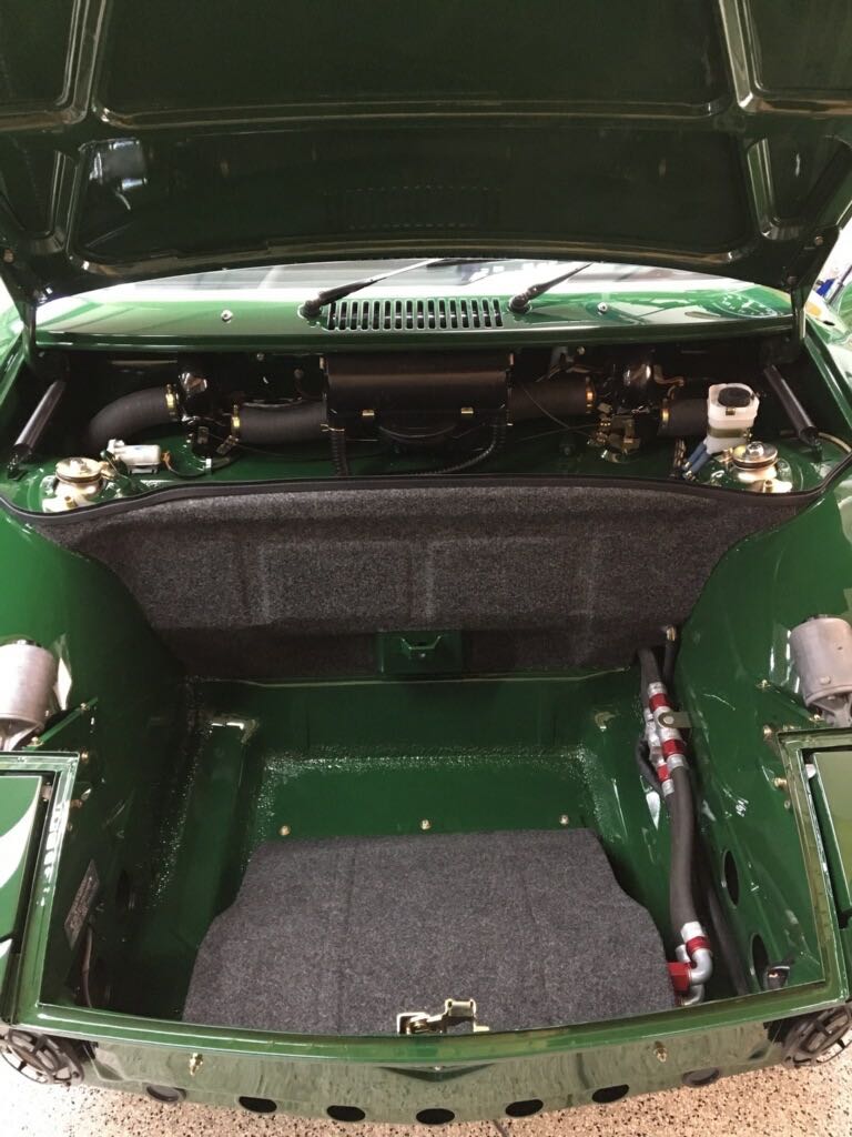

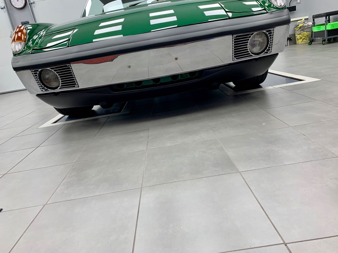

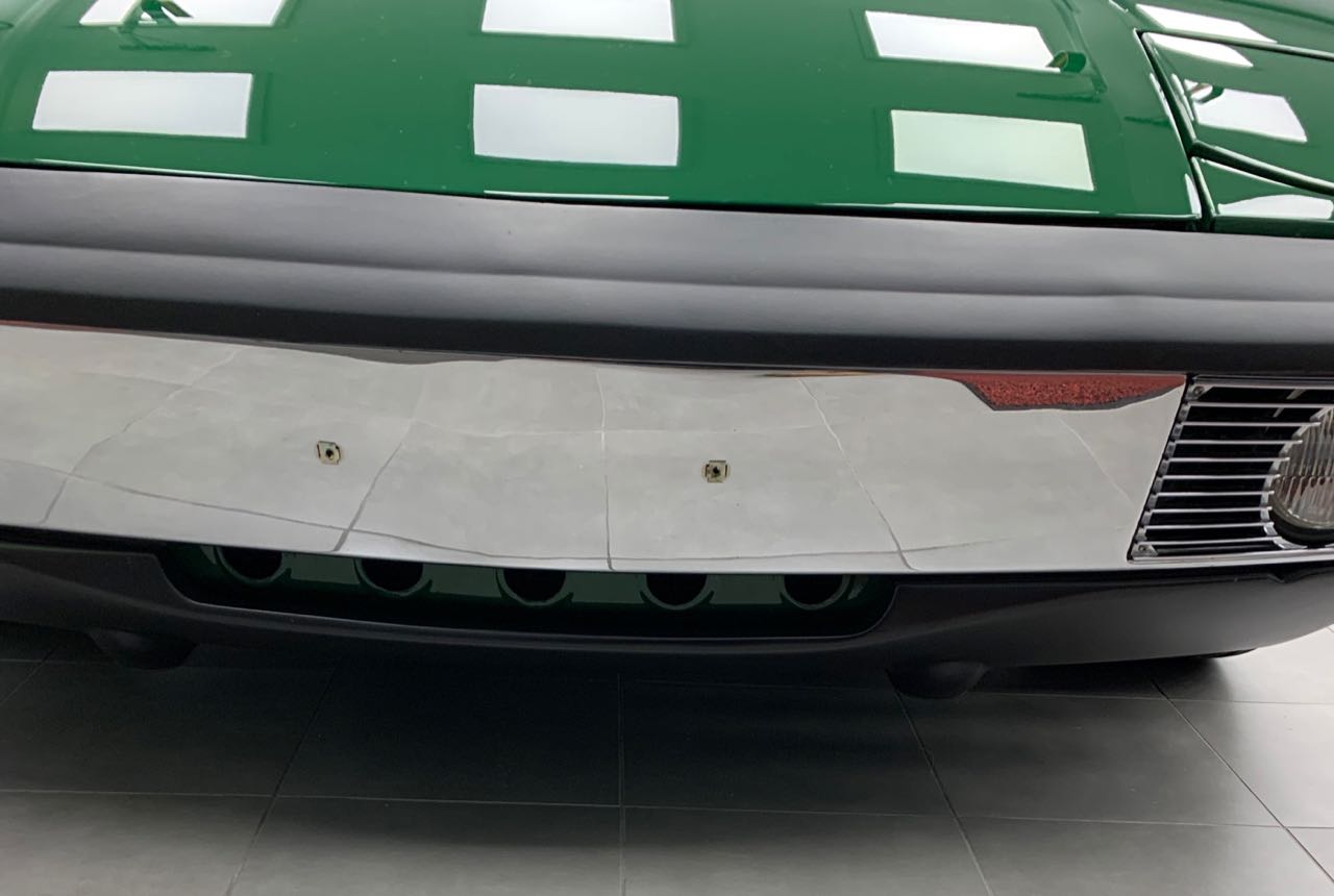

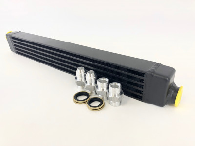

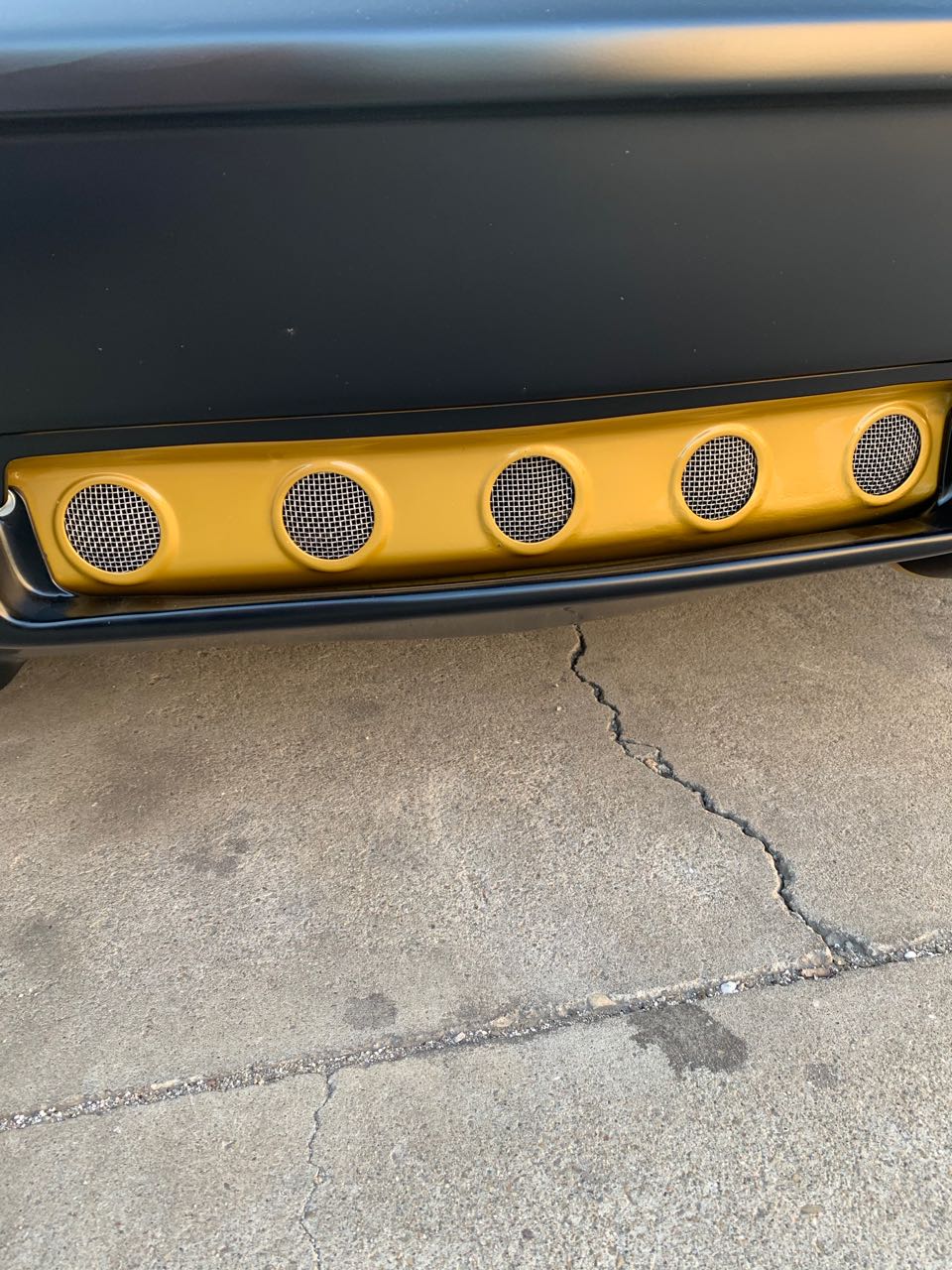

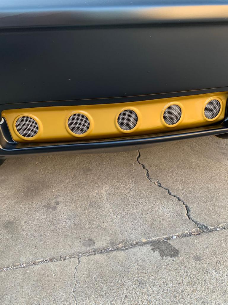

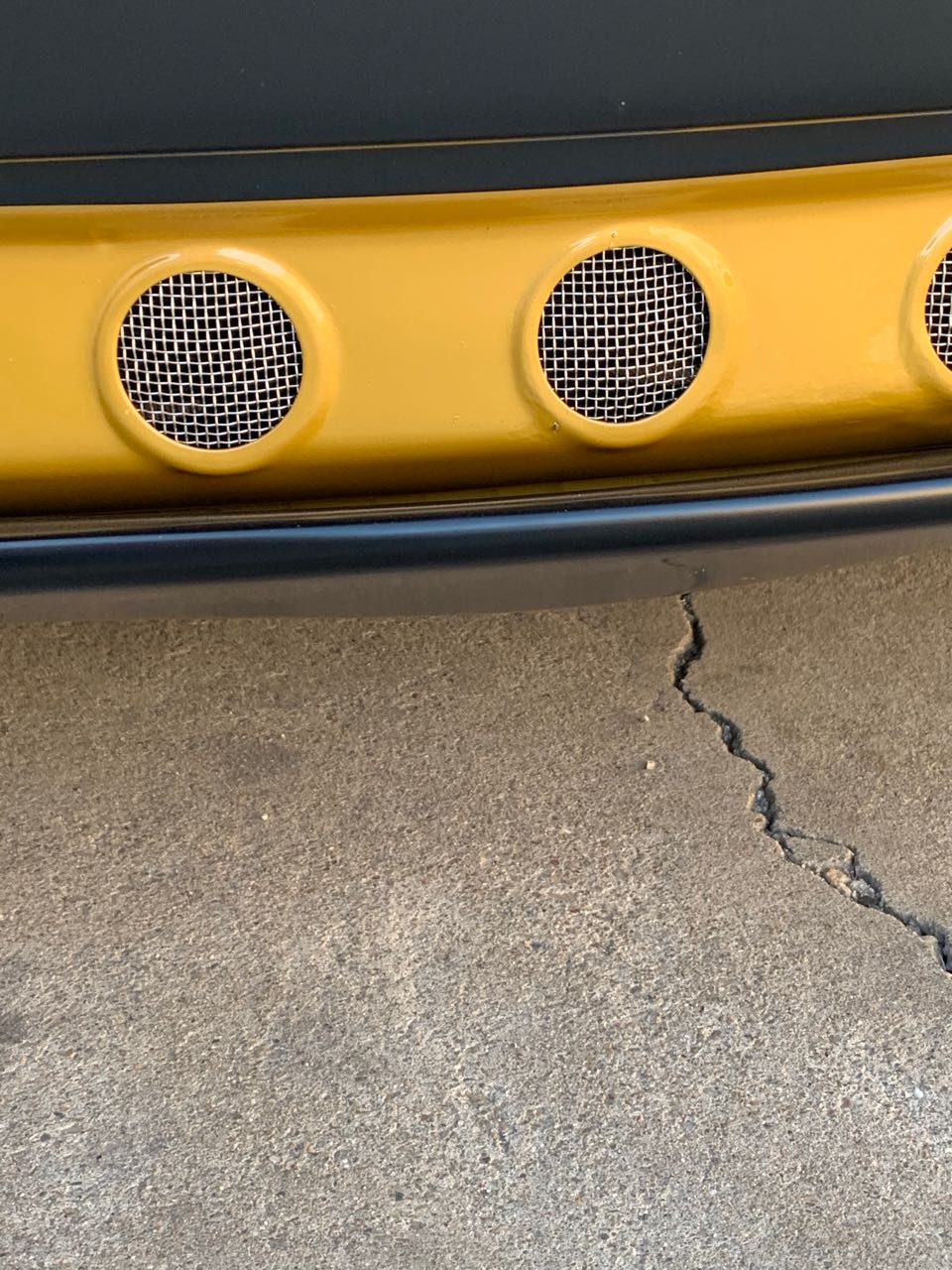

Hi Ben @mb911 - Here are a couple shots of my oil cooler opening: As you can see we did not opt for the bumper cutout. I am happy to report with just the 5 front body plugs open my car stays nice and cool. In the heat of the summer, when it was 105-110 degrees outside, my car was consistently showing about 195 degrees and if I sat in traffic, it would maybe get to 210. Then as soon as I got rolling, within 1 mile, it would be back at the 195 reading. Though I love the opening in the bumper to match the valance, I wanted to stay a little more stealthy with that mod.
The only thing I wish we had done was do a screen over the holes to keep rocks from damaging the cooler. This '70 that recently sold had the nicest screening I have seen and I would like to do this to my car. See last 2 pictures:

Totally get that.. I did that on my last 914-6 .. My car is a GT style tribute.. So needs to be authentic.. And the fiberglass options stink and fit poorly.. I have done 50 bumper mods to date and this is the prototype valance matched with my bumper that will get sent out for chroming at some point.
Really just trying to give options to others

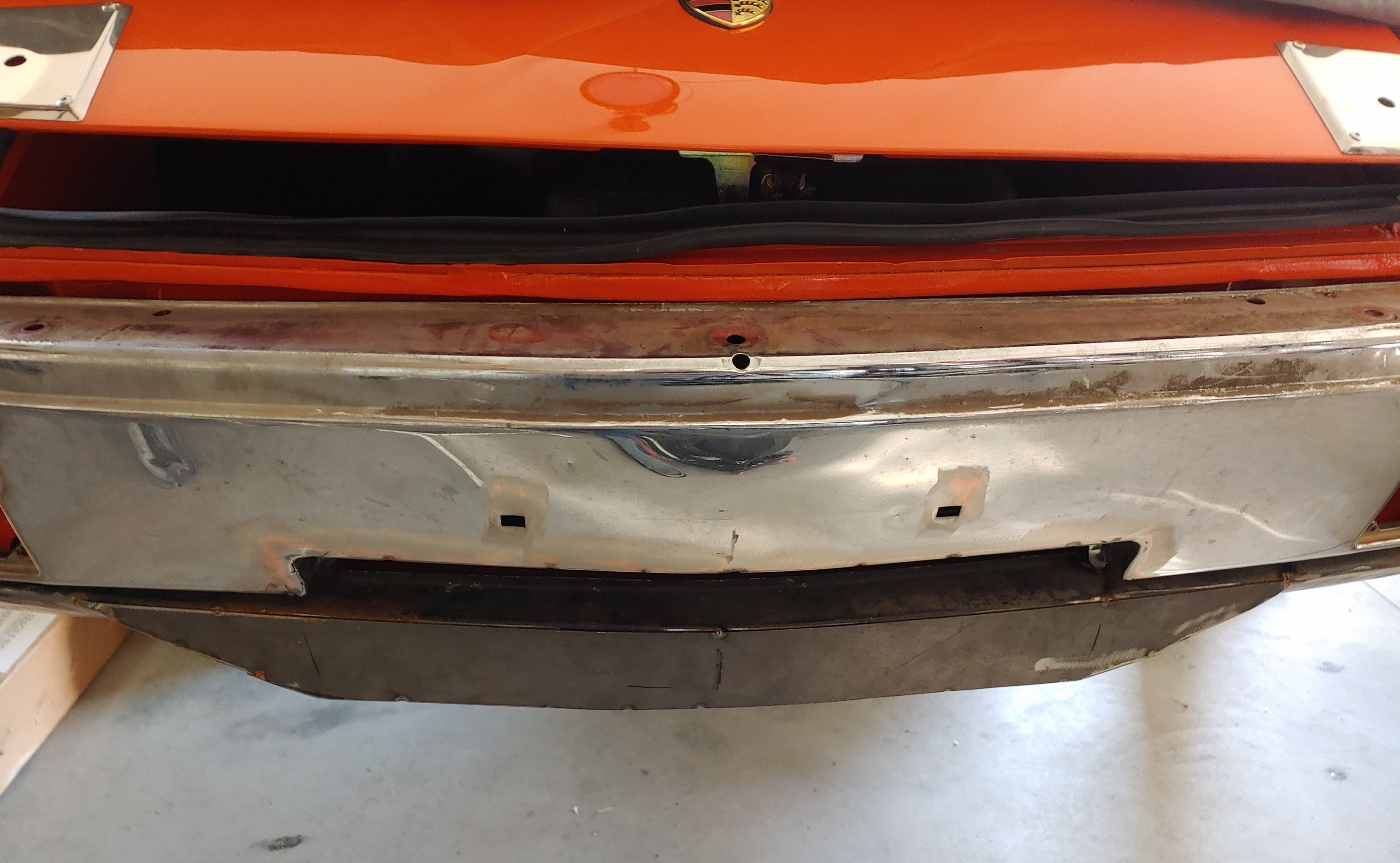

On mine, I cut out the bumper mod and tig'd stainless in for the bends. Used stainless rod. After grinding and smoothing, you can barely tell it was welded. Slight loss of chrome, but silver paint touch up makes it barely visible. Why steel for the valence?

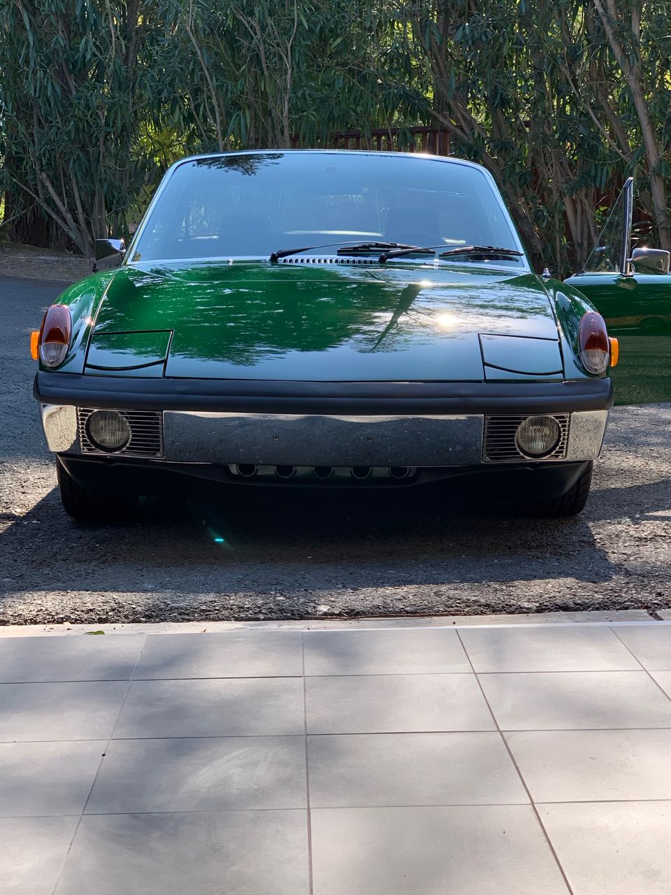

@Cairo94507 Do you have a picture of the front of your car from 5-10 feet away? Would like to see the big picture. Your front valence looks great!

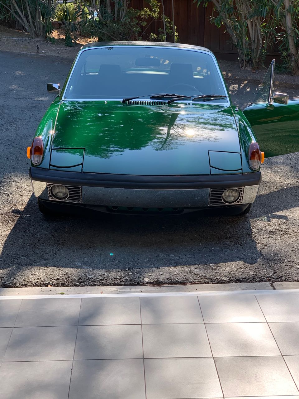

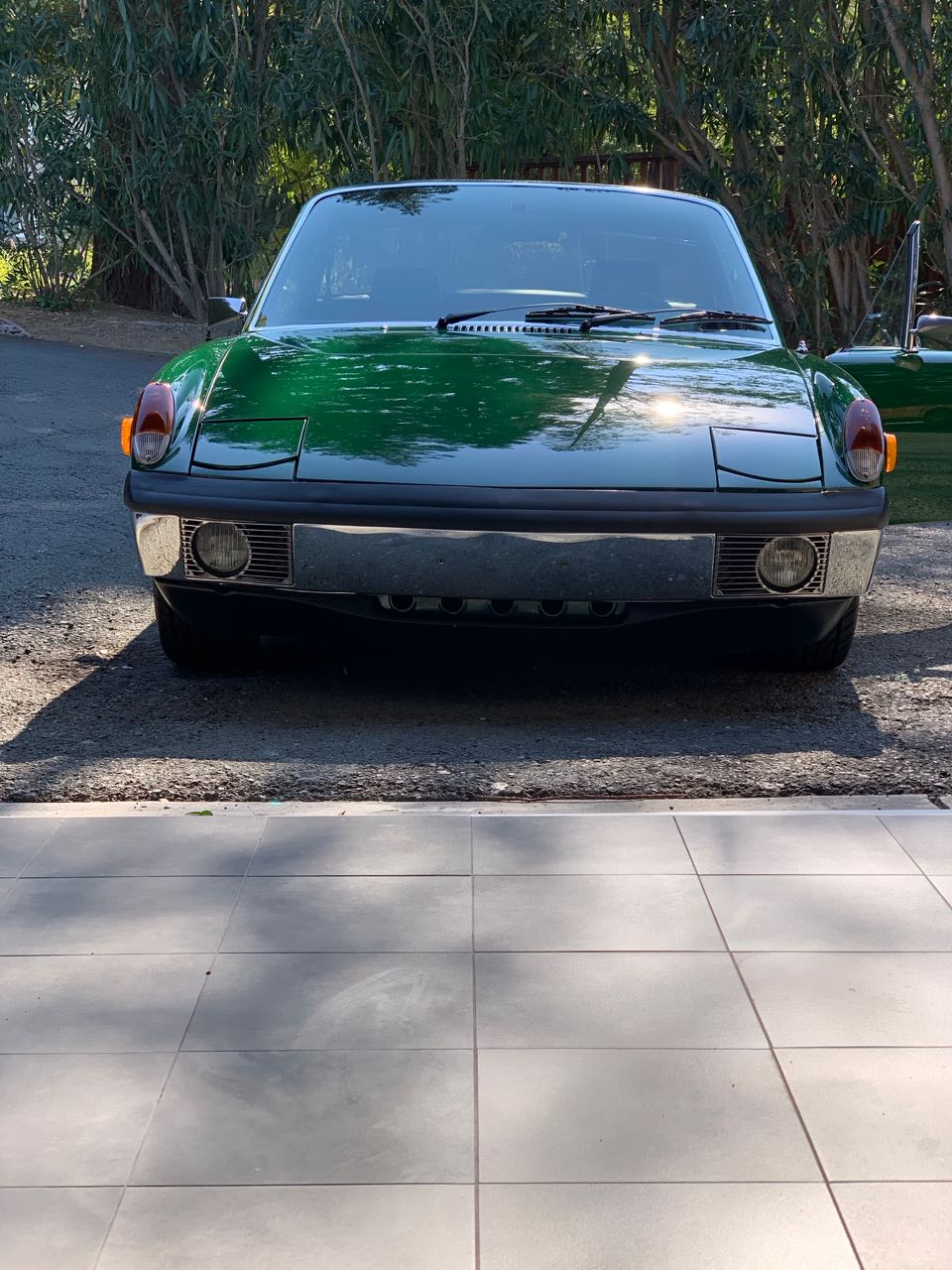

OK, here you go. This was about 8' back. OK, those came out terrible- you can't even see the valance. I will take some good ones on the weekend and post them. Sorry. (IMG:style_emoticons/default/beerchug.gif)

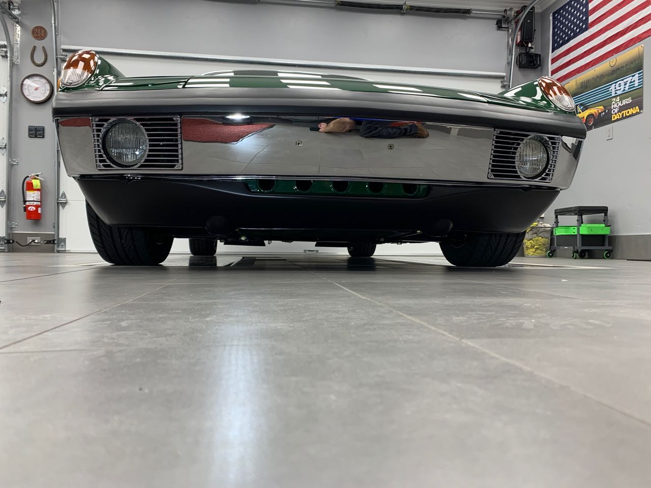

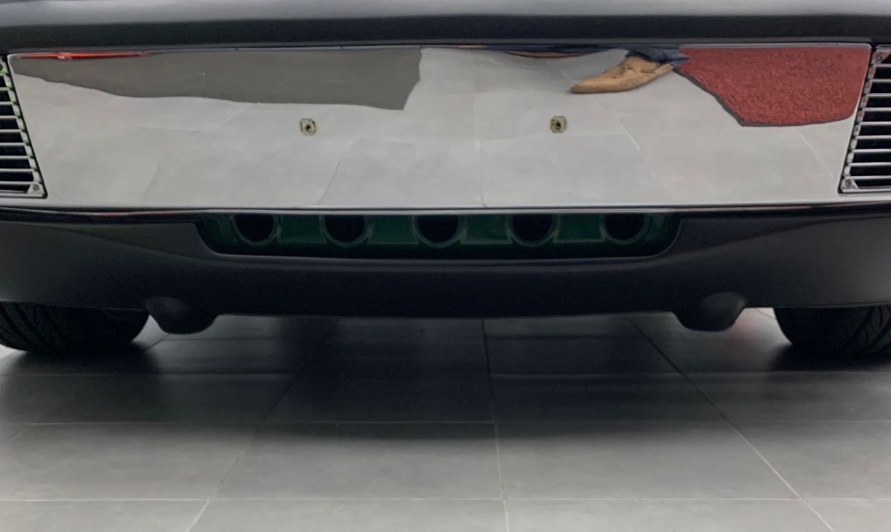

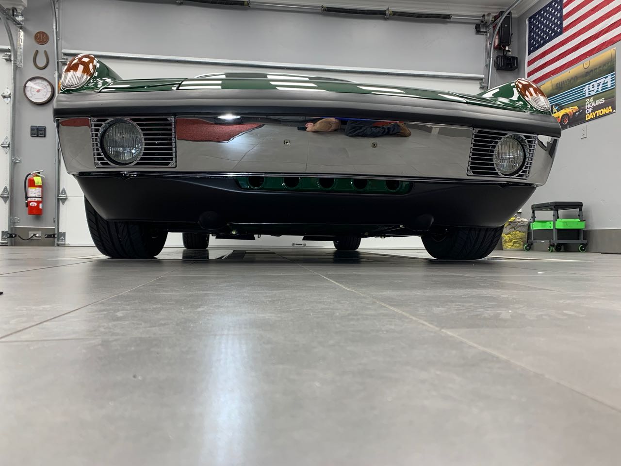

OK, sorry, got busy. Here are some additional photos of the front valance. It is tough to get any photos of it as it is satin black. I even used an alternate light source to try to get a better photo. Hope this helps.

I like that you didn’t cut the bumper although a well done cut bumper looks great. Do you get enough cooling with only the opened up valance and holes in the front bulkhead. Like you, I have a real -6 and don’t want to cut holes in it if at all possible. My plan is to have a small hot 6 so as to not need a cooler but if need be, does yours work?

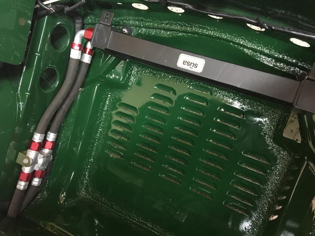

Mine works fine and it’s set up like Cairo’s. I took out the plugs at the back of the trunk so no cutting was involved. I don’t have a cooler on the 3.2 engine. Just a large 20 row Setrab cooler in the front with a fan pack.
My GT car will have one of Ben’s front bumper and valances. I love the GT look.

I can see easily see wanting one of these in steel for my narrow body car...especially if there's a way to do a small/thin oil cooler that could dump into a variation of the composite exit air ducts that dumps to the wheel wells we've seen…which might allow for the full-size spare to stay in place? Frankly, maybe even a 911 SC trombone-style loop cooler that simply went from one fender to the other with the pipe "blown on" in the middle through this valance might be enough for a lot of cars.

I have a 3.2 with Motronic injection and the PMS front oil cooler with the GT lines and a thermostat I believe we determined opens at 180 degrees. In the heat of the summer I climbed the Grapevine and my car got to 200 degrees. As soon as I got into open air the engine cooled right down to about 185 which is where it typically runs. I only have the 5 back plastic plugs puled out in the front panel and then the louvered panel in the trunk floor with the shroud that seals it all up nicely to force the air out the louvers. My plan was to start with this and if it was not enough, then have the front bumper cut/modified to open it up more. So far, after driving it this summer, not necessary.

The GT setups make a lot of sense to me for competition cars, but delete the full-size spare tire as an integral safety feature and eat into front luggage space. If I was going with a big engine, I'd probably go that way anyway for the obvious reasons.
When I see Ben's setup, what I think about is a very small oil cooler behind that valance with very tight exhaust venting that maybe leads to two large ducts or hoses aiming air into the front wheel wells (and brakes?). Or maybe a 911-style "loop" cooler that starts in one front fender and goes over to the other without need for the ducting (just being blown on through the hole in the valance), adding more oil capacity and a bit of extra air cooling thanks to the hole in the valance.
Anyways, this valance has me rethinking my LE spoiler in the long run. A cooler setup for less than 3.6 liters designed to work with it might be pretty cool...

Both Ben and Cairo have a vertical spare so that might be better than nothing. Ben also runs a big cooler since he also leaves out the engine mounted oil cooler.

I think the front valence looks great and love the louvered frunk floor.
That car is beautiful and provides a lot of inspiration!!
