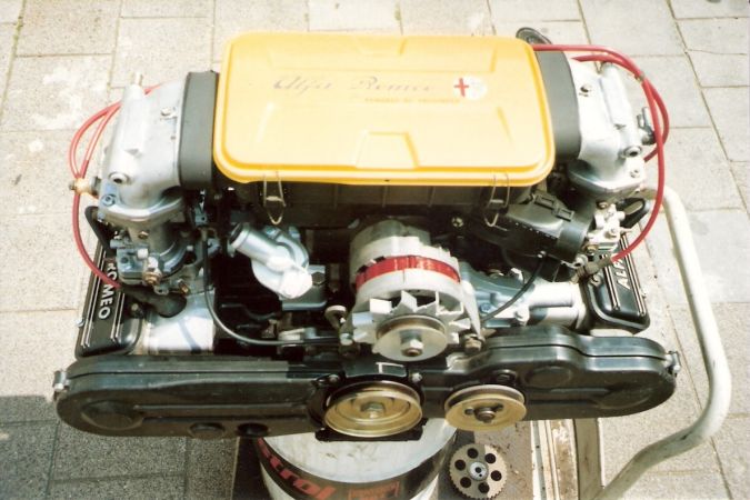

Always like the Alfa setup for Dellorto's and Webers on the early carb cars no reason it won't work on a T4 without simple mods.

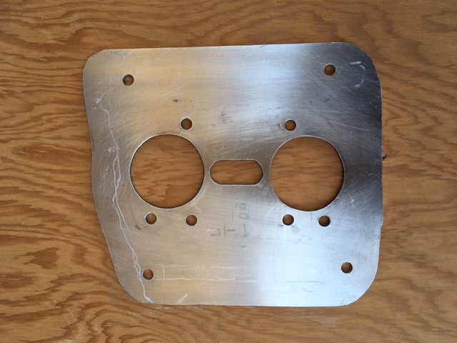

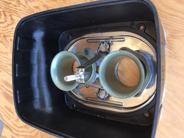

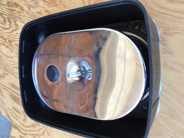

I just finished with the same mod and couldn't be happier. Cost of the filter boxes off eBay was $24 each including shipping and I used 85 Gold Wing Aspencade 1200cc boxes. I've driven about 10 miles and did not notice any changes in A/F, idle speed or power. I did notice a HUGE reduction of intake noise and now I can hear the exhaust. The ultimate test is driving up an incline on the highway with the windows up which I will attempt sometime before WCR. Below are a few pictures of how it goes together...basically as RonD describes. And thanks to Keith914 who gave me his lessons learned.
Mounting plate made from 1/8" aluminum:
Before installing the old K&N-type filter. You can't see it here but I had to grind off the ends of the chrome bottom plate to fit the GW air box opening.
With filter cover installed...I had to weld in a longer 1/4-20 bolt for the wing nut and dimple the top of the chrome top to make it all fit properly:
