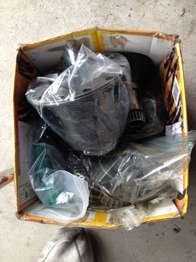

Hello,
I started collecting parts of this project 30 years ago and the last parts have fallen into place.
In this post I hope to clear up some confusion and convey some of what I found trying to complete this project.

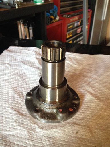

First piece
purchased form PAR in Yonkers NY 1986 914.332.209.00 casting number 51D
The LSD found its way to me in 2013 from the venerable Cap'n Krusty

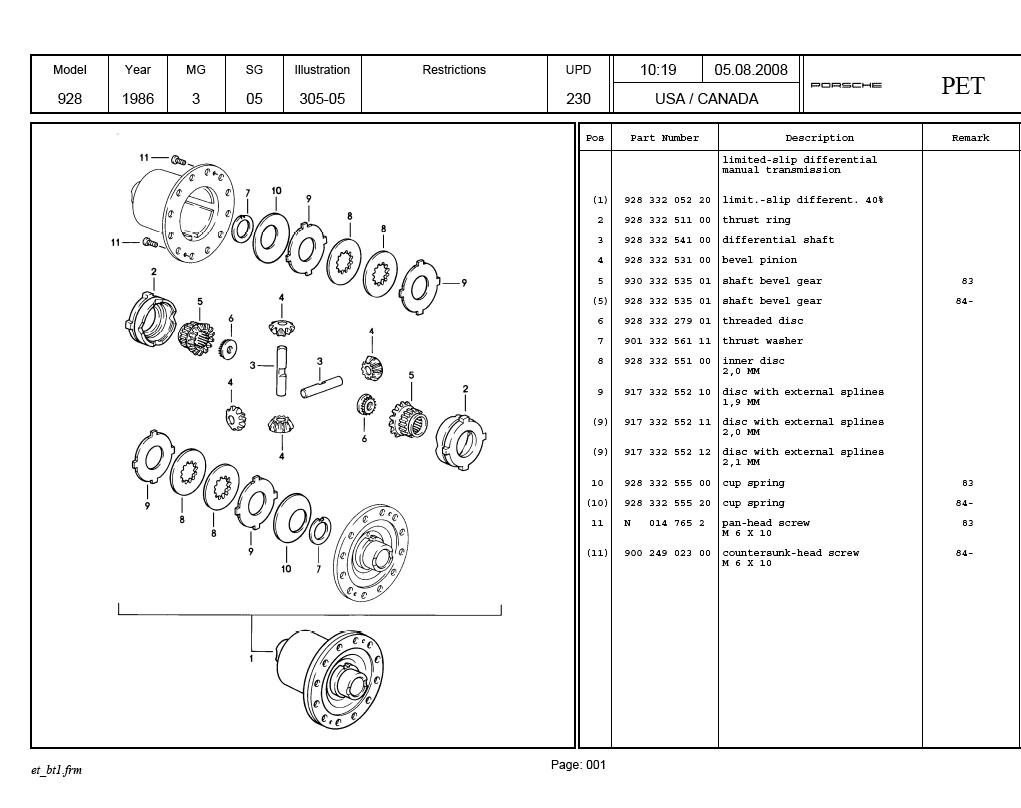

The diff needed some work as it was missing internal spring plates which are NLA.
Item number 4 in this factory illustration.
This part places tension on the clutch pack which is measured as drag.
The factory spec on this is 29 - 58 ft. lbs
This item can be replaced by what is now called a "cup" spring from and early 928
part no. 928.332.555.00
seen here as item number 10
As for the internal wear parts, the 914 parts are NLA but, get this they are replaced by mostly 917 parts! WAY COOL.

The late 901 ZF LSD which I will call the 914 from here on require a different transmission drive flange from stock. The 914.332.209.00 which has a longer output shaft than the standard flange 914.332.209.10, about 63 mm long, about 5 mm longer than the stock flange.
Here is a picture showing that dimension.
This image is the 901.332.209.21 it has the same shaft but the flange takes a larger cv joint about 110 mm, this is a good upgrade if power is on your mind.
At this point I have to mention that there are a number of output flanges out there but they don't fit.
There is one for sale on Ebay part number 914.332.209.00/10 it has the correct length shaft but it has 2 flaws.
Looks pretty good but looks can be deceiving. The land for the oil seal is 5 mm longer than necessary so this negates the longer shaft. Additionally the shaft itself is almost 2 mm thinner than the 914.332.209.00.
I bought one to see if it was possible to use. I took it to a machine shop to see if it could be modified. The answer is basically no. The flange is hardened steel, so all of the steel lathe tools would bounce off the piece not cutting it, I would have to try a machine shop that specialized in grinding as stones may be able to cut the material, but that still left the 2 mm difference in the shaft, which I am sure, after time would begin to vibrate and shake itself loose. Not a pleasant thought.
I've had one of the drive flanges on my shelf for years and I had to search for another, that was not easy. I searched the web and found a few sites with the part number but each time I ordered I received either a stock flange or some other incorrect number that looked good to someone else ie: 914.332.109.02 This is exactly the same dimensions as the stock unit but I can not find any parts catalog with this number.
So here is the biggest problem with using this LSD the drive flanges are rare as hens teeth. And the /6 guys think they have it tough finding parts.

The 901 332 209 21 flange was used for the early 1969 model year 911/912 with an aluminum case transmission. In the middle of the 1969 model year, Porsche changed to the magnesium case transmission and the axle flange used was 901 332 209 22.
The aluminum case transmissions used an inch size differential carrier bearing with an ID of about 43.xx mm. The magnesium case used a metric size bearing with a 50mm ID. In addition, the magnesium case differential carrier carrier is 11mm wider than for the AL case. (120mm vs 109mm)
Also, the distance between the axle flange faces was the same (260mm) for both the AL and magnesium case transmissions which allowed the transmissions to be switched with no changes to the axles.
The 901 332 209 21 flange has a total length of 110mm. The end that fits into the differential is 57mm long and and 34mm diameter.
The 901 332 209 22 flange is 105mm long. The differential end is 57mm long and 35mm diameter.

I decided to inventory my flange collection and provide part numbers and some better dimensions. The attached picture shows 6 flange pairs. From left to right they are:
1. 901 332 209 15/21 used in the early 1969 911 with Aluminum case. Total length 109mm. Length of extension into differential is 56.5mm. Diameter 34mm.
2. 901 332 209 22 used in 911 with magnesium case from mid 1969 to 1971. Total length 105mm. Extension 56.5mm. Diameter 35mm.
3. 914 Flange. Total length 99.5mm. Extension 56.5mm. Diameter 35mm.
4. 901 332 220 915/21 used for mag case 911/915 with LSD. Total length 109mm. extension 61mm. Diameter 35mm.
5. 923 332 209 02 small flange used in 911SC after about 1981. Total length 109mm. Extension 56.5mm. Diameter 35mm.
6. 923 332 209 04/05 used in early 915 transmission. Same as 901 332 209 22 except total length is 106mm.
Then I stuck the flanges into the matching differential carriers and measured the flange to flange spacing. The 901 and 911 were 260mm. The 915 was 262mm and the 914 was 250mm.
The last picture compares the LSD flange to 901 332 209 22. Looks like there is enough metal there to allow the flange to be ground down to fit a LSD differential. Total length of the modified flange would be 4mm less than the original but that should not make a difference.Attached Image Attached ImageAttached ImageAttached Image

Hey oldie914 thanks, I was hoping you could help with a question.
I would like to know the correct procedure to prepare a used drive flange to accept a new oil seal?
For that matter is there a prep procedure for installing a new flange?
I have heard mixed comments on this subject, you seem to know more about these flanges than anyone I've meet.

When installing a new seal, clean the rust off the flange with a wire wheel. Check the seal location on the flange with your fingernail to see if there is a groove. You can live with a little wear but not much.
Make sure the new seal is at full depth in the case so the seal is running on clean metal. You can check the seal contact location by smearing a light coat of grease on the flange and putting in in place. Pull it back out and you can see where the seal lip makes contact.
It is amazing the number of different axle flanges Porsche used. There were 4 or 5 additional types used during the 1965-68 model years.
They also tried 3 different methods for securing the differential gear shaft from 1965-70. Finally settled on the block and retaining pin system for the 914 and the 1970 model year 911.

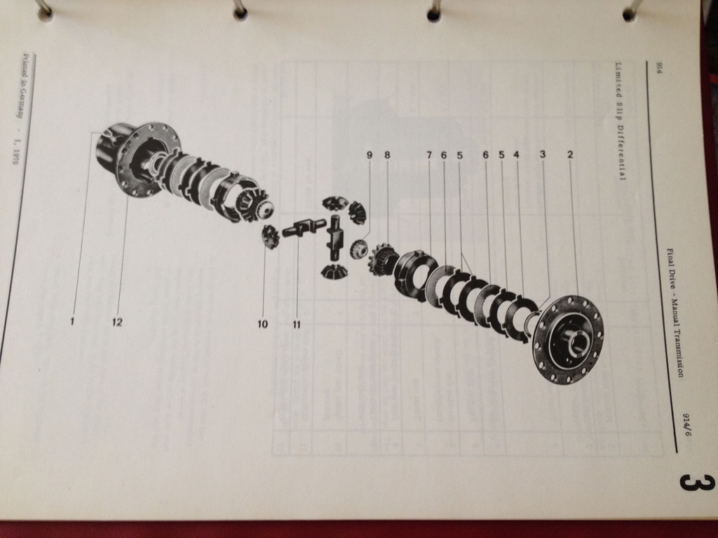

OK so at this point I though I should get some refernence material on the ZF LSD, web searches for the 914 version brought up little material. I found some references mostly pointing back to the factory repair manual, which is a little behind the times as for replacement parts.
So what I looked for were similar diffs ZF 904 and 915
Here is a rebuild and modification done by a fellow who calls himself Gears on the Samba board.
915 mod
Additionally I used a 904 rebuild as reference also from Gears on the Samba board.
904 rebuild
So with this info in hand I now had a procedure to approach my rebuild.
