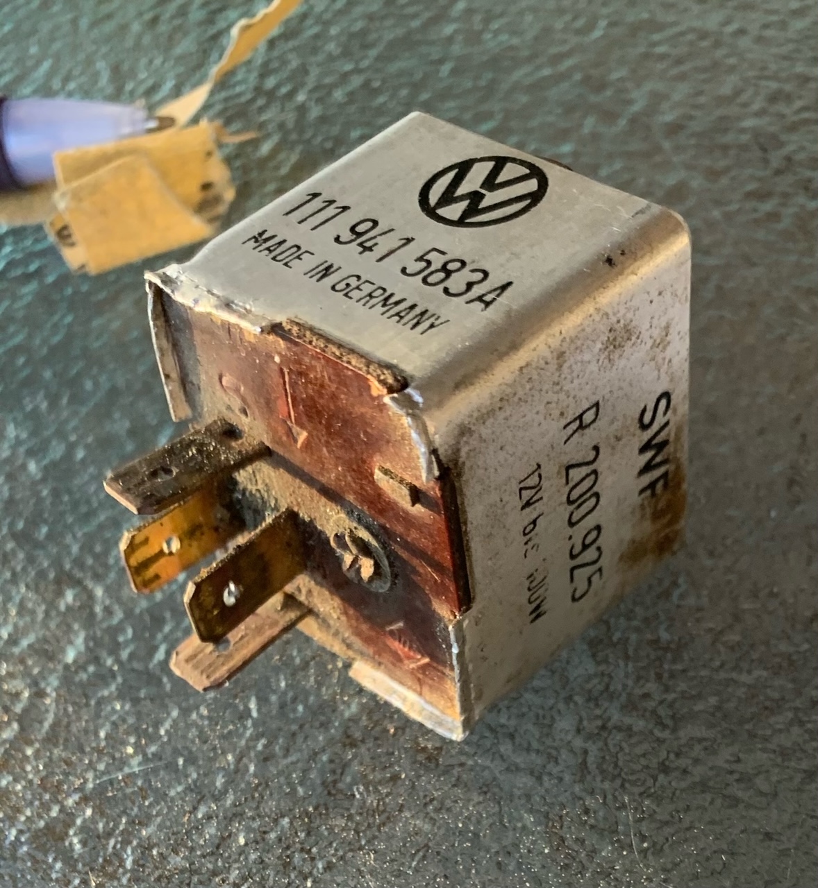

During a headlight check before a sanity drive a couple of weeks ago, I found that our car's headlights would not light up at all. The fuses checked good, but I couldn't hear the relay click and there was no power to the fuses themselves.

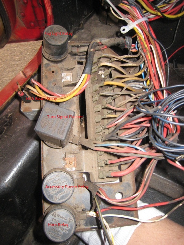

The relay sits on top of the fuse panel:
(picture courtesy of malcolm2 in this thread: http://www.914world.com/bbs2/index.php?showtopic=339629)
Our car is a 1972 914/4 and uses a 4-pin headlight/combination relay. Because it can be accessed more easily than the column switch, I decided to check the relay first.
In addition to all the schmutz, this picture shows the 4 pins/terminals: "56" (+ from 56 on the headlight switch), "S" (momentary ground "signal" when the steering column switch is pulled back), "56a" (switched + to fuses 3 and 4 for low beams), and "F" (switched + to fuses 1 and 2 for high beams). If this relay is working, it stays ("latches") in one position until it is momentarily "signaled," then it switches--and stays--in the new position until it is signaled a second time.

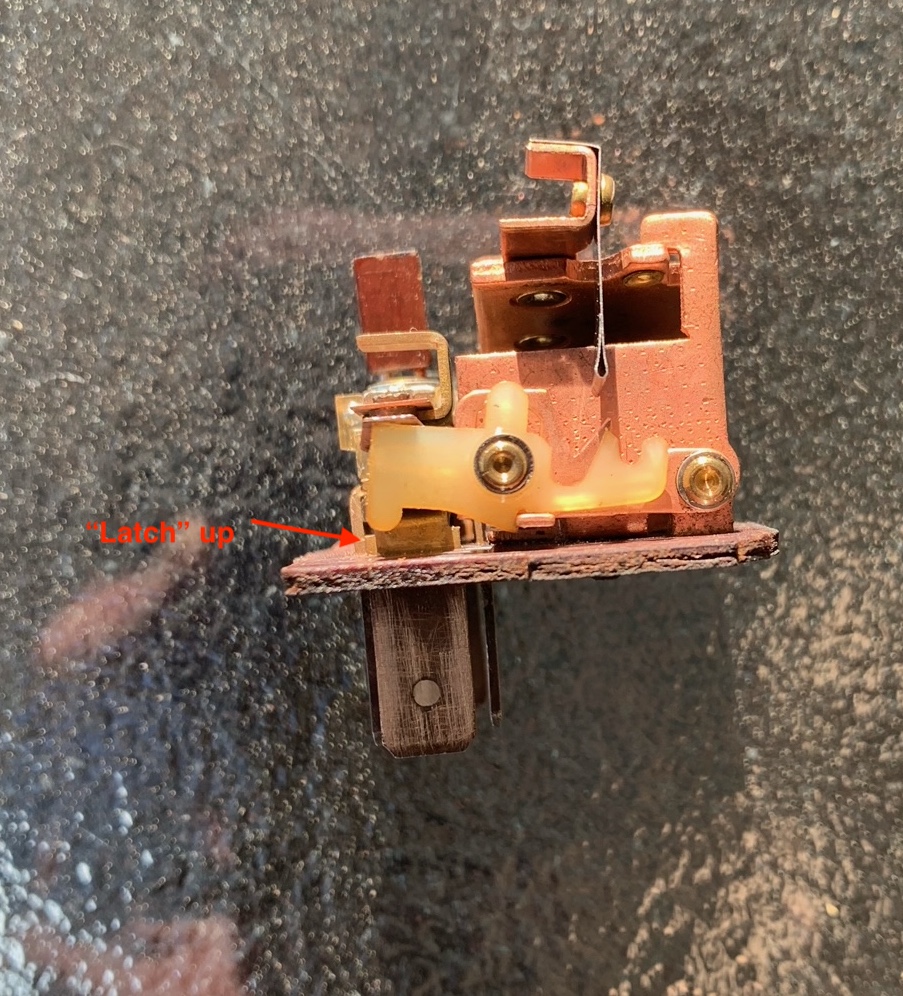

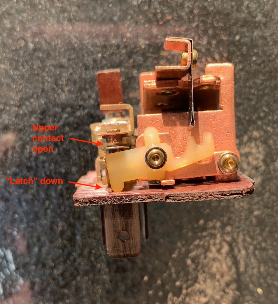

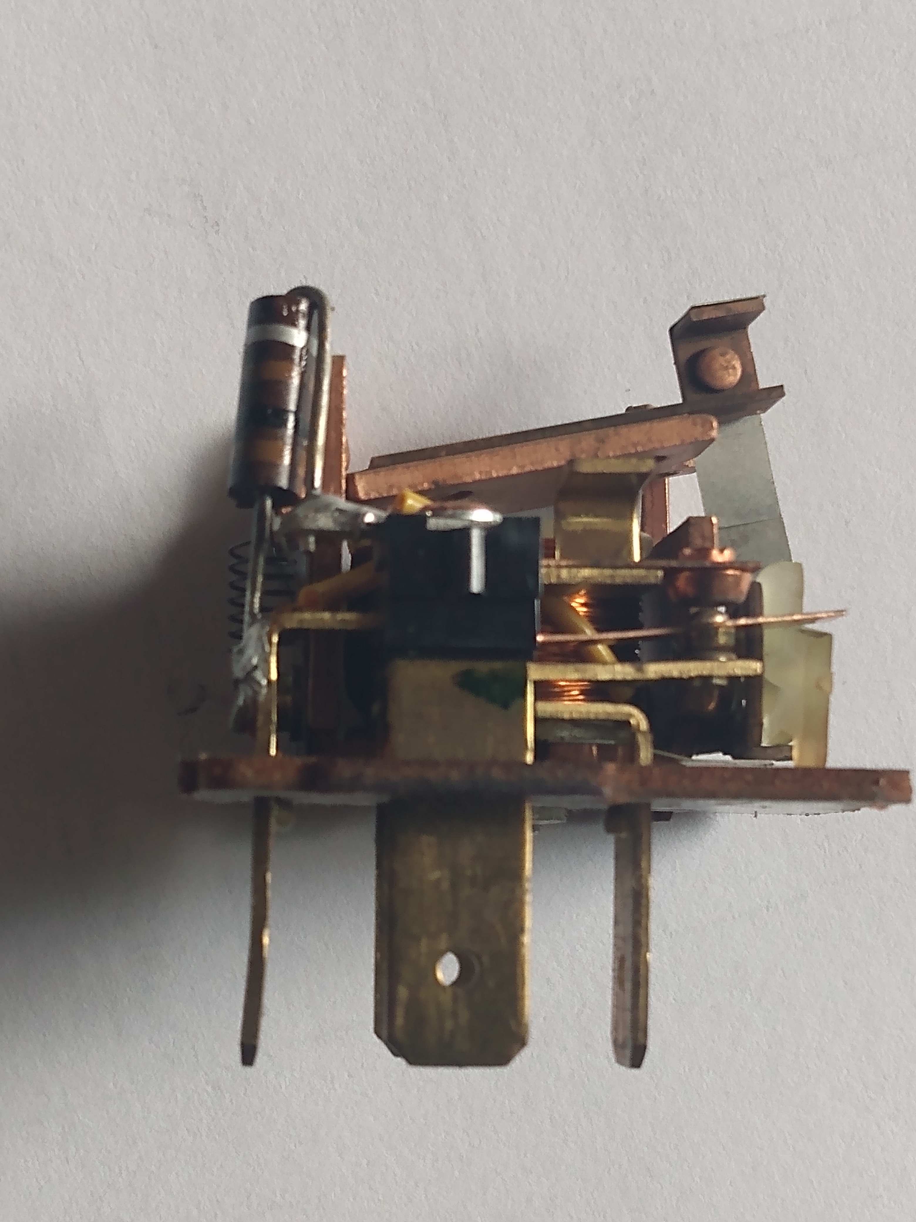

If the relay doesn't work, it's time to open it up. Note where the terminals are in relation to the cover, then peel back the cover's bottom edges. Gently withdraw the guts and take a look:
This picture shows the relay latched in the "up" position.
When energized/signaled, the silver loopy thing is pulled down and latches the relay in the "down" position, opening the upper contacts:

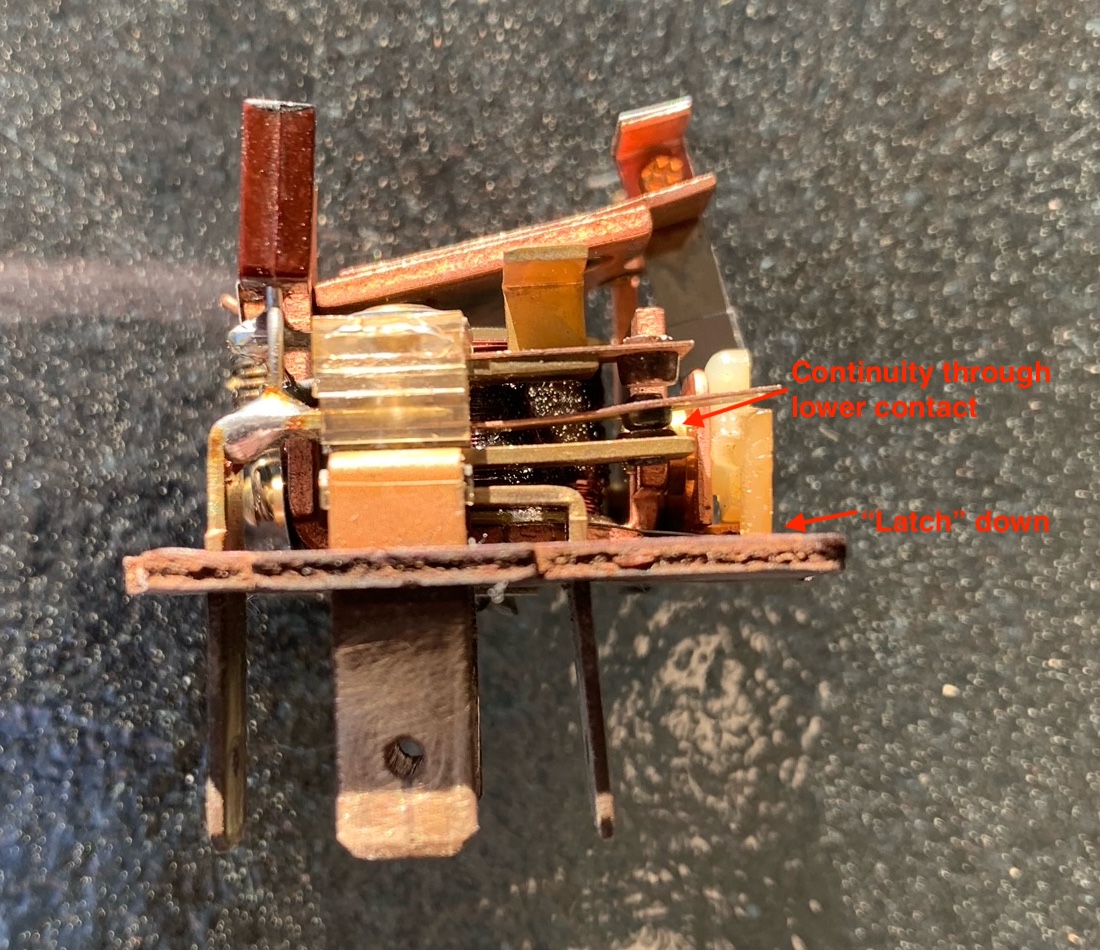

Looking at it from the side, you can see how the lower set of contacts are closed when the latch is down.
There should be continuity between 56 and 56a when the relay is in this position...but none in my case. Dressing up the contacts with a tiny piece of wet-or-dry sandpaper fixed mine.

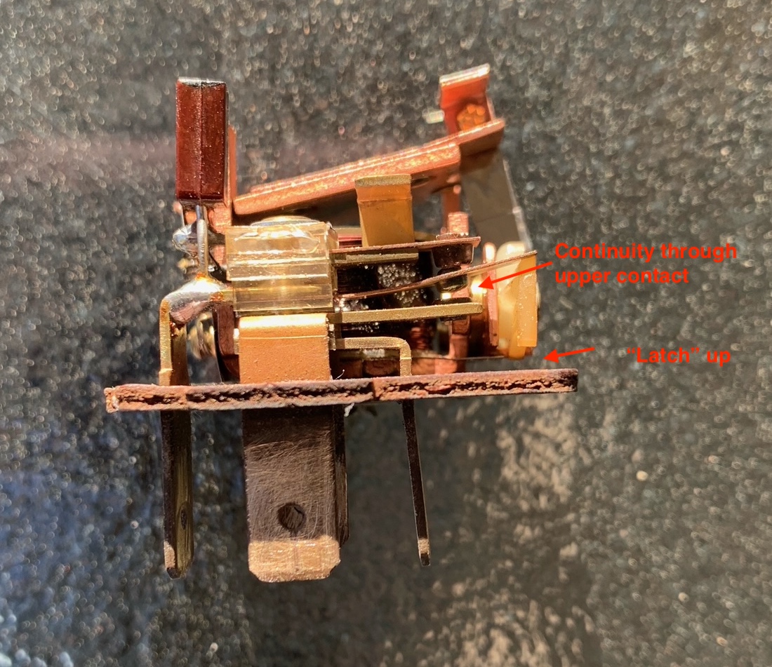

When the relay's latch is up, you'll have a similar view, except now the upper contacts are closed:
There should be continuity between 56 and F...but once again, none in my case. Another gentle application of wet-or-dry sandpaper and it was OK.

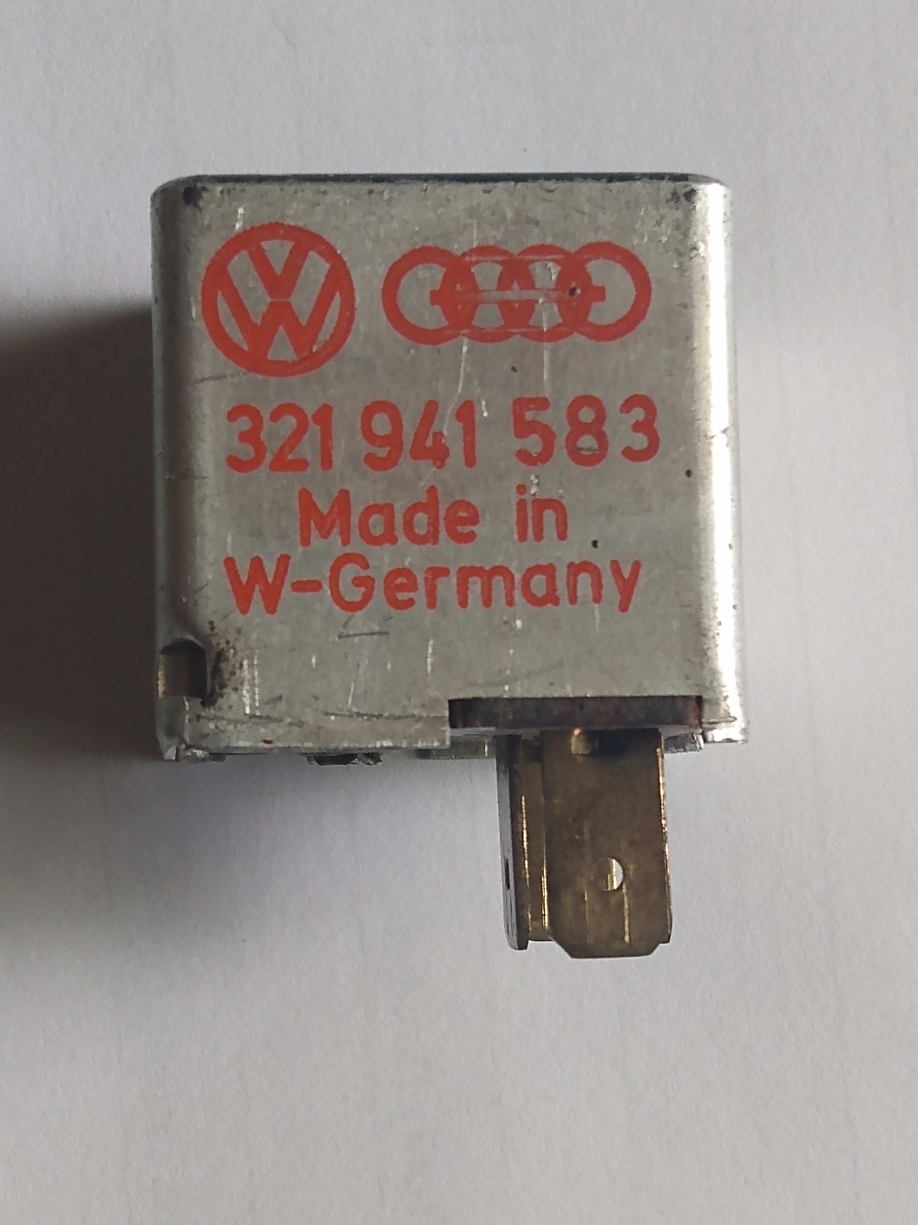

Well you just solved a mystery for me (I think). I've had some assorted relays in my parts box for 30+ years, one of them is a silver cube about 3 cm on a side. the part number on it is 321 941 583 whici I think means it came out of a VW Type 3 (I used to have a bunch of them). Pin descriptions look the same, wonder if it would work as a replacement if needed.

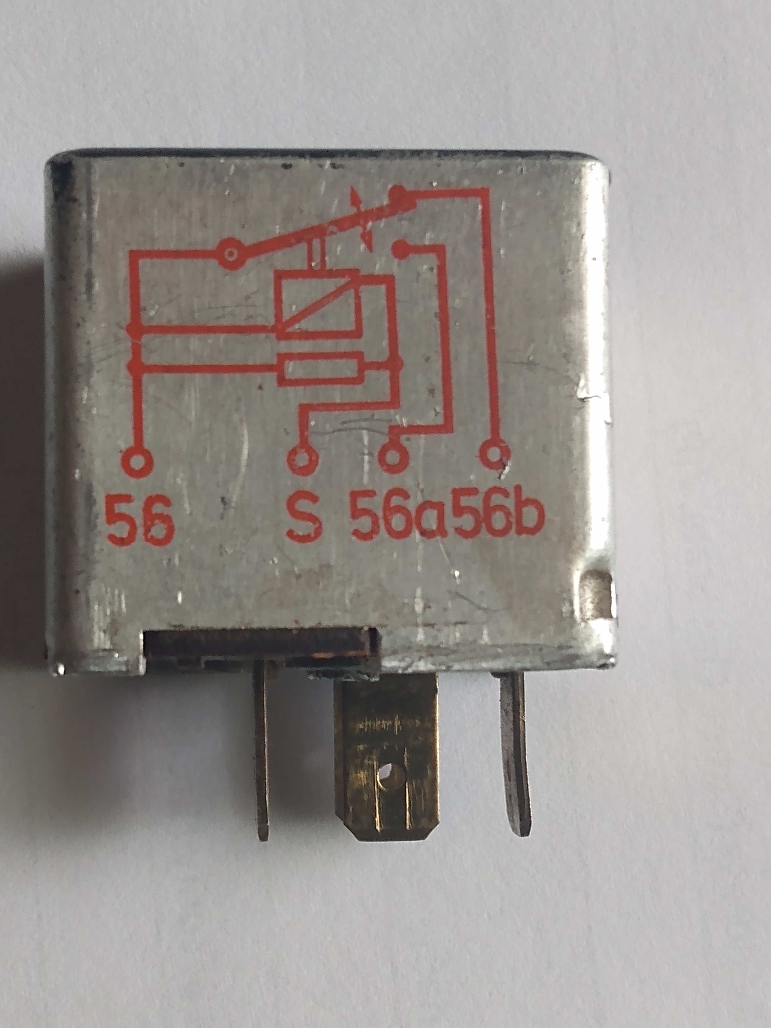

Well, maybe not. Read the description again and instead of an 'F' terminal, mine has a 56b. So most likely a 'standard' relay which is what the picture on the can seems to indicate. But WHY would they use the same number deignation for two seemlngly different style relays??

@fixer34 Can you post picture of p/n and the relay schematic on the can?
If the schematic is the same, it really doesn’t matter what the terminal nomenclature is.
My best guess is early vs late, or VW vs Porsche/Audi 924 relay maybe. Also could be European (with flash to pass) vs US without?

Adding wiring schematic to this thread. Attached Image

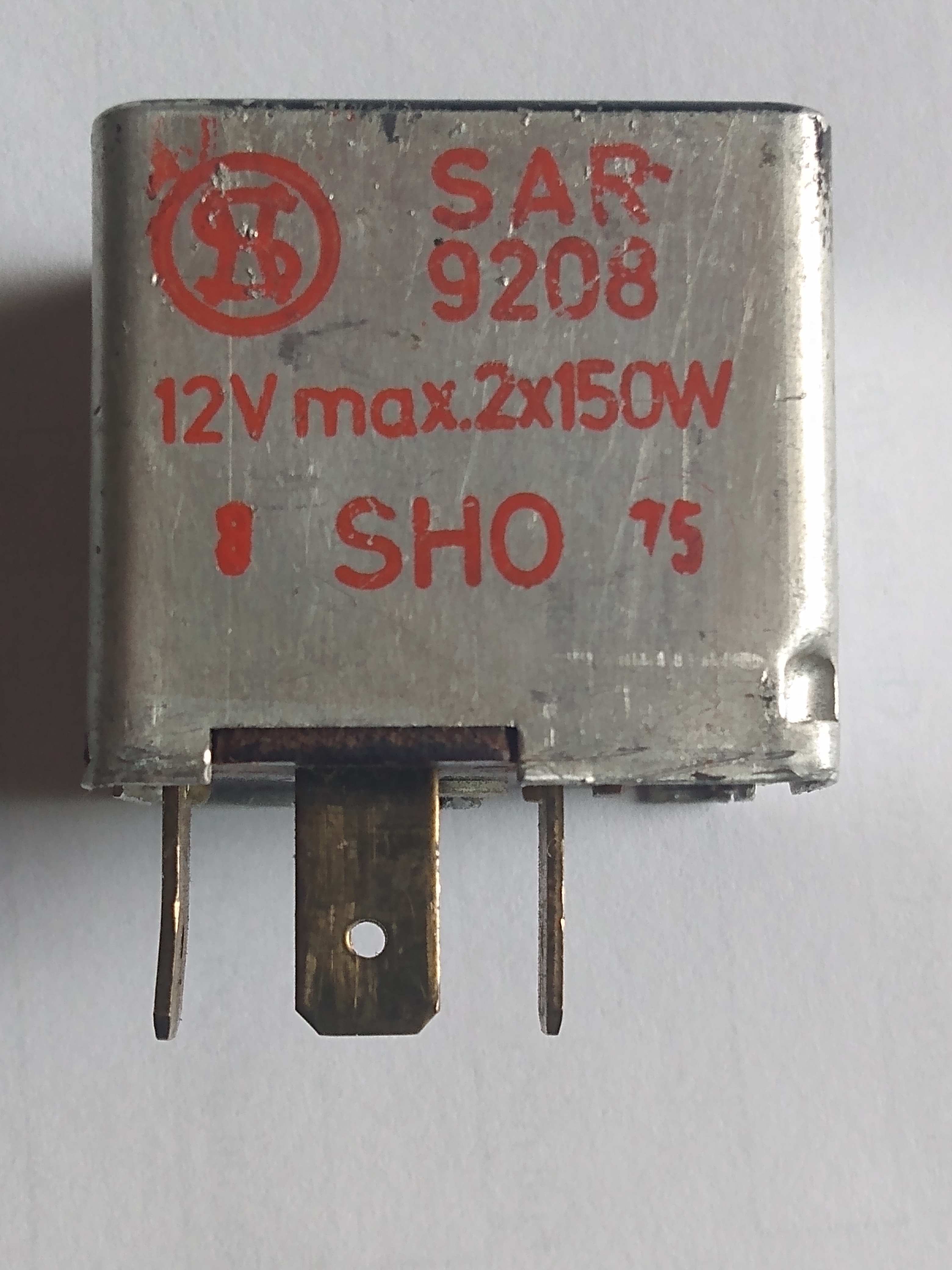

I saw in a followon thread that the old 'F' notation was possibly changed to 56B, so I pulled the can off mine to see what was actually inside. Appears to be a latching relay.
Attached Image Attached ImageAttached ImageAttached Image[attachmentid=919
Based on schematic on really that’s all it is, a labeling change.

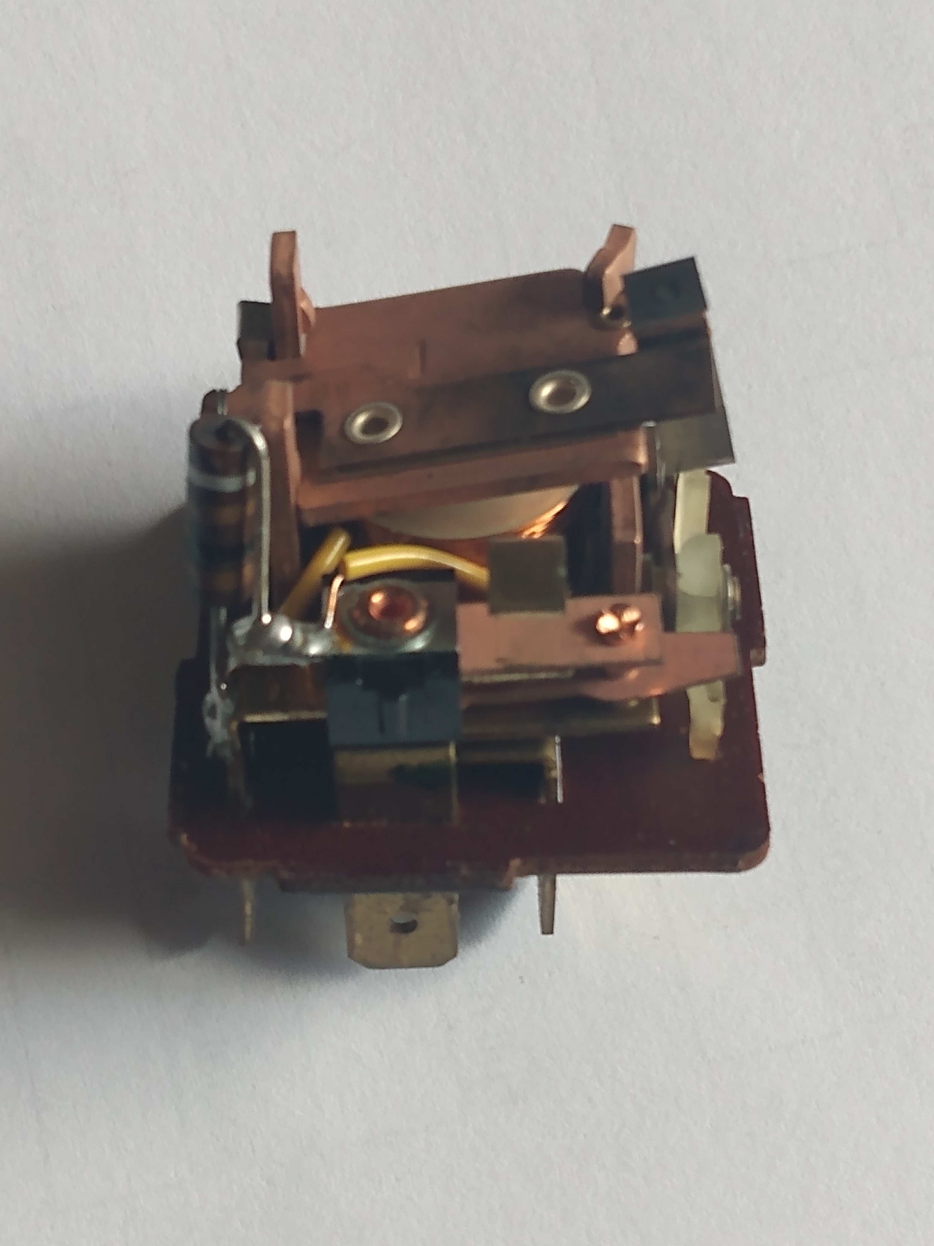

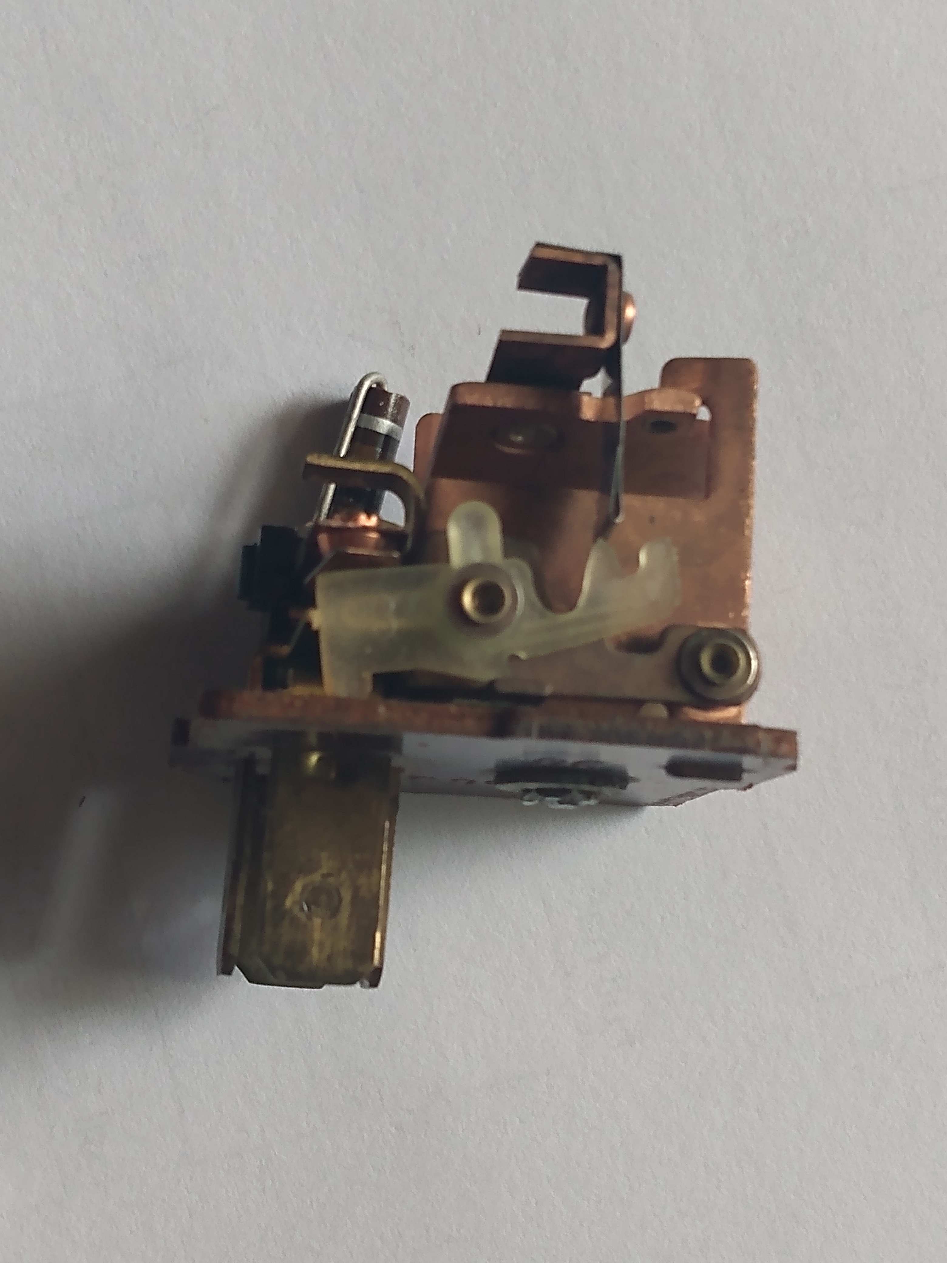

I removed the case on the old non-working relay. I’m not clear where you use the sandpaper
Can you add an arrow or pointer to show the exact area to sand.

I'm not good at marking up pictures so I'll try 'splainin'.
First, are we sure the non-working relay is due to bad contacts instead of a bad coil?
If it is a contact issue, we want to clean the little buttons on the strap piece. If you press down on the coil arm at the top, you will see the strap move, that's the one we are talking about. Ideally you want to use a 'points file' (remember those?) Thin metal strip with a very fine abrasive on it. We aren't looking to remove a lot, just buff off any corrosion/burnt surface.

Actually, the 5th and 6th pictures at the beginning of this thread show the contacts that need to be checked/cleaned.
