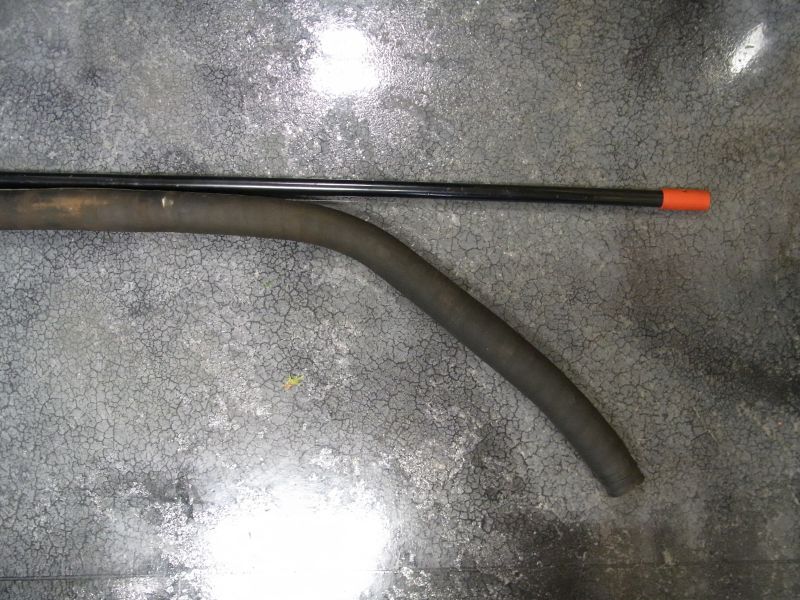

One step forward and two steps back today.
Great point is that I fished the tube through the tunnel. I buckled the mouth of the tube and taped it into a point. Add a bit of silicone spray and it went through pretty easily.
Bad news is that I was able to confirm just how little room I have behind the fuel tank to make the turn. It fits back there but not very well. Playing with the feasibility of pie cutting a 90deg bend to reduce the radius to make the fit a bit more comfortably.
It will work but is a lot more effort than I was planning to spend on the project.

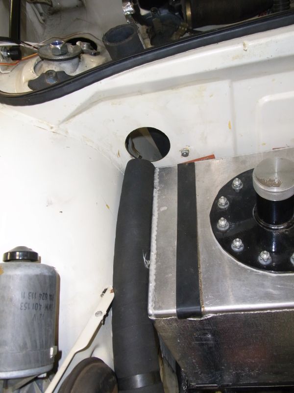

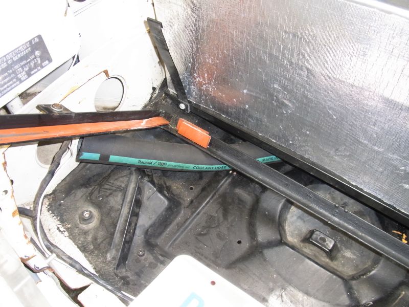

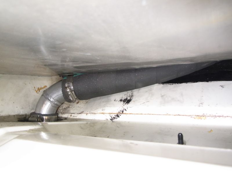

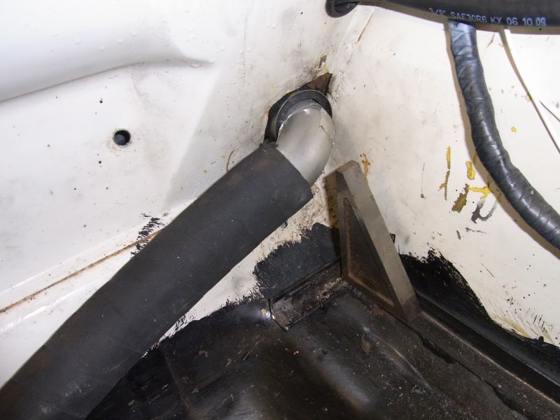

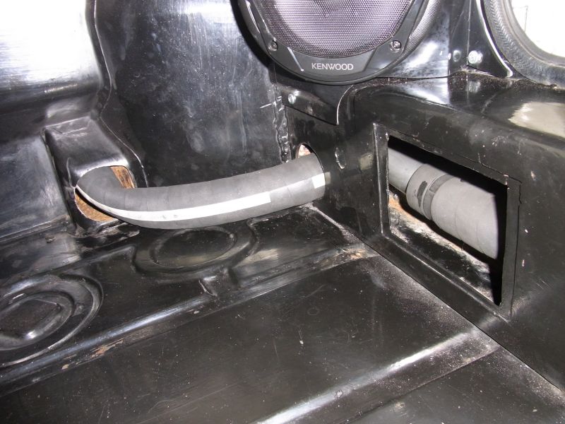

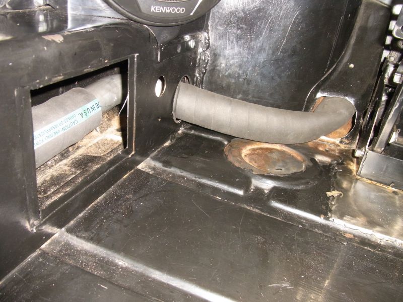

Had a great evening in the garage. Project "don't mess up a cooling system that is already rock solid" is progressing nicely. I look forward to its completion and a dramatic lack of change in functionality (IMG:style_emoticons/default/headbang.gif)
Passenger side routed over the steering rack hump.
Eventually it will run next to the fuel tank and into the top of the radiator.
I wanted to run it under the fuel tank but there just is not room. It will meet the requirement that it will be even or lower than the top of the radiator.
Driver side routed over the steering rack hump...
Behind...
and under fuel tank.
Entire suction side tube will be well below the majority of the volume of the radiator. This is the primary benefit of the project.
All that is remaining is to modify the radiator connections and fix the leak. I also need to install some low profile edge protection to keep the tube from chafing. Any suggestions?
Back on track to go Oktoberfest to Okteenerfest!!
Cheers,
Scott

Are you going to replace the bent/collapsed tube with steel? If not I recommend this..
I use another layer of tube to keep the tube from chafing. That and duct tape works surprisingly well in un-scene areas.
Have you test fit the gas tank in that area? Or is the silver tank you gas tank?

QUOTE(Andyrew @ Sep 6 2016, 11:54 PM) *
The tube is only lightly kinked. A bit of heat and pressure and it should pop out. The tubes I pulled out from the previous routing took a set with some pretty impressive permanent bends.
I ended up finding some really nice edge trim from Trim-lok. Comes in several sizes for different thicknesses of metal. Hopefully it is as bendable as advertised. Should look almost OEM!
Cheers,
Scott

QUOTE(Amenson @ Sep 6 2016, 08:18 PM) *
Behind...
Cheers,
Scott
1st, I agree with Andrew on the bends. There are spiral spring wraps to prevent that. FWIW, each 90 elbow has the parasitic drag value = to 12ft of tubing! What is the reasoning behind elevating or lowering the radiator hoses in relation to the radiator? (IMG:style_emoticons/default/beerchug.gif) Kent

QUOTE(Amenson @ Sep 7 2016, 06:28 AM) *
Cheers,
Scott
Radiator tubes dont work like that (IMG:style_emoticons/default/sad.gif) I suggest making some steel pipes for that or else those tubes will collapse every time they cool down and possibly not expand after some use.

QUOTE(76-914 @ Sep 7 2016, 07:00 AM) *
I believe this 100%. On my exhaust I have 3' straight pipe to a mandrel 90 (3" tube). The exhaust before the 90 barely gets warm, but the exhaust at the 90 is blueing. Note its stainless steel.
If anything your going to retain quite a bit of heat in those areas.
Im all for thinking outside the box, but whats really wrong with routing the hoses under the car? At this point you've done most of the work already but still.

QUOTE(Andyrew @ Sep 7 2016, 10:33 AM) *
Cheers,
Scott
Then how do you explain this?
I am fully prepared to fab up a nice section of aluminum tube for the areas if it does not go as planned but I really want to avoid hose clamped connections on a high temp, high pressure liquid in the cabin of the car.
Background for rerouting the lines:
-There are currently two hose clamped connections behind each speaker pod waiting to fail and kill me.
-Water pumps should have the "suction" side flooded so they do not actually have to suck. I am really surprised I have not had problems already. There must be enough water volume in the longs to keep the pump happy.
-Having the tubes as the highest point in the system makes it really hard to bleed.
-I did not like the way it looked.
Running the cooling lines under the car works perfectly well for many people but, in my not so humble opinion, is just a lazy way to do it that introduces unacceptable risk.
Cheers,
Scott

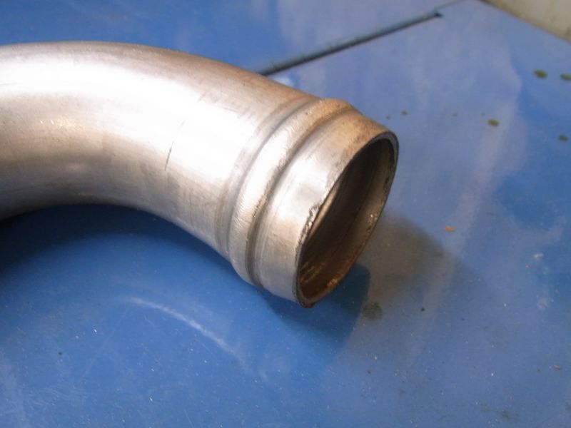

The the Parker beader is everything I hoped and dreamed it would be. Arms got a bit tired after a few but the results are excellent. Unfortunately the tubes were all installed before I got out the camera. I will take some pictures when I have it apart to install the edge trim.

Stephen...found a piece I had beaded but not used.
Puuurty (IMG:style_emoticons/default/beerchug.gif)
Nothing better than having the perfect tool for the job. Now come pry them out of my cold dead hands! (IMG:style_emoticons/default/bye1.gif)

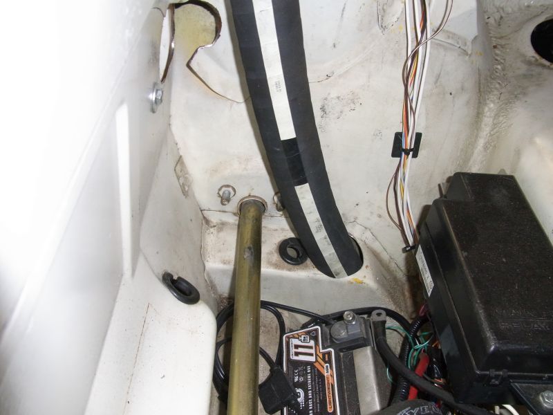

Hey Scott,
I see you, Chris and Kent all working on coolant line plumbing. Yours is the STI, not a 6, so I check yours first. I am again thinking about rerouting my 1.25 ID ~ 1.62OD lines from under the car to behind the kick panel and out side of the longs.
The hose would turn in sharply into the cabin, the same as yours. That turn, even before where yours kinked, is the problem area.
I had a 1/2 baked plan last year. Something like welding in a 1.75 guide tube and feed the hose thru... I try to revisit and work out the bugs again. A smaller hose would help. Kent may have found the small hose limit. What size coolant lines are you using?

(IMG:style_emoticons/default/hijacked.gif) Just wanted to make a quick point. I have absolutely no cooling problems with the 7/8 & 3/4 hoses since changing over to the Celica dual core. My only cooling problem happened with the Scirocco single core radiator, running 3500-4500rpm uphill for 5-10 mins, out of the desert 95F. That's asking a lot from that setup. I switched to dual core when I added AC as a precaution. If I didn't have a propensity to drive like a juvenile dare devil I might have keep the system as it was. (IMG:style_emoticons/default/confused24.gif) Regardless, the reason I am upsizing to 1.3/8" is some unfounded theory that I made up in my feeble mind which convinced me that with high rpm and restricted flow I increased the pressure on the system resulting in my head gasket failure. I plan on leaving the small hoses in the longs in case I change my mind again. (IMG:style_emoticons/default/lol-2.gif) Highjack over. (IMG:style_emoticons/default/beerchug.gif) Kent
Leave the hoses in the longs? All that extra weight (IMG:style_emoticons/default/shades.gif)
Yeah, as long as I'm experimenting it won't hurt anything to leave them in temporarily. I won't notice 5-8 extra lb's. You'll see soon enough. (IMG:style_emoticons/default/shades.gif) Besides, I'm used to running heavy. I usually run about a 1/2 ounce heavier than everyone else. (IMG:style_emoticons/default/rolleyes.gif)
