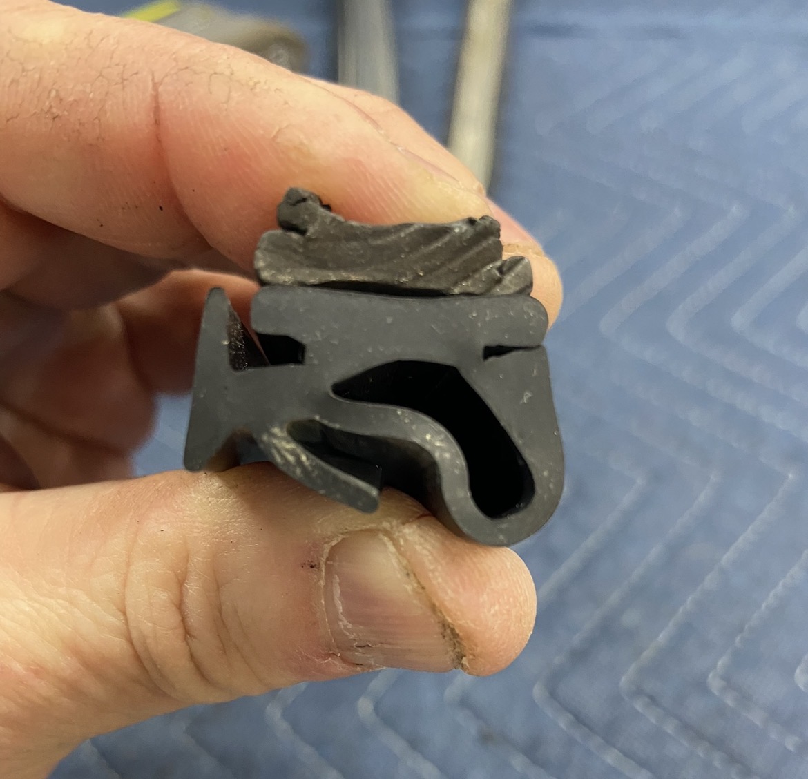

Agree with all issues JamesM noted - purchased whole car seal kit in 2018 era
Need to stop assuming so much rubber shrinkage and upsizing seals way beyond what OEM was.
Here is example of window seal of what I’m talking about.
OEM On top (torn - base only that goes into extruded aluminum channel)
Reproduction below note width and section thickness differences.
You are spot on about what was previously OK for a $2500 car no longer being acceptable when cars are trading hands at $20k+.
I don’t want to come across as ungrateful, having some part is better than no part but there are a lot of seals in my kit that don’t fit, had wrong durometer, or wrong profile / size vs OEM.

I don't take it as ungrateful at all. We all want things better now. At the time the process was a community development process, with the community suggesting the parts and testing them. So one person's version of good vs the next person's was not a great development standard then, but it is what it took to try and figure out all of the variations. What was really interesting was that when I came on in 2014, the general consensus was that there were "Early" and "Late" versions of parts. And that the Late was probably better because Porsche had figured things out through production, and when they superseeded a part, it would be better. It was all new to me, so I had to learn by putting my hands on things. I worked in Cary's shop, where we had every year's 914s to be able to compare the differences, and it quickly became obvious what had happened. The parts got smaller and cheaper over the years. They had to offset a lot of expenses to keep the cars affordable, given what was happening with the exchange rates and the safety and emissions regulations imposed on them.
So things that were metal (like the thresholds) went to plastic, and things shrunk (Like the alternator cooling boot)
So I am curious: what year is the seal that you are comparing that is so much smaller?

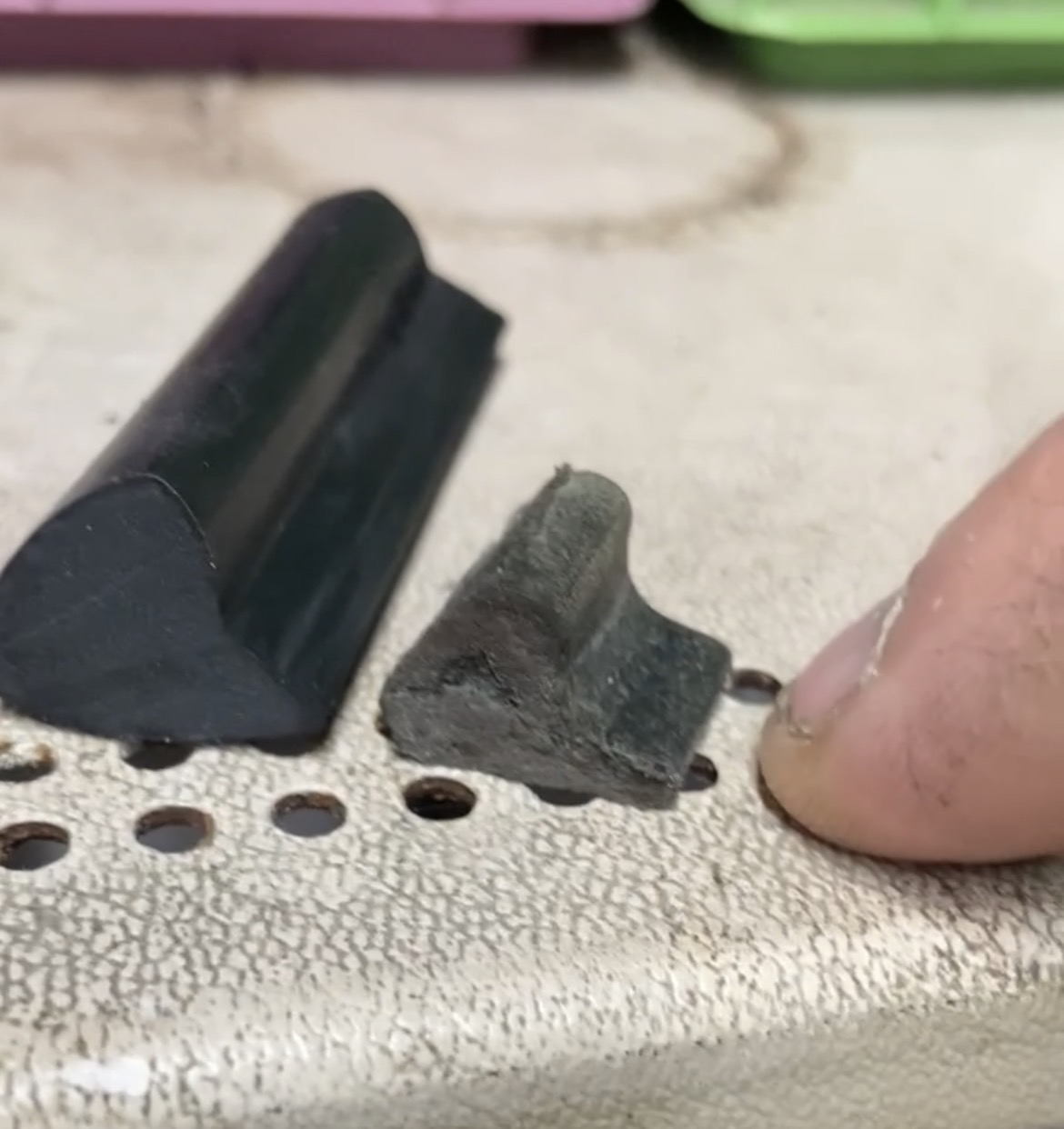

My car is a 73’ and seals were original.
Here is another great example.
This is the stuffer from the main targa seal at end.
The OEM stuffer is on right - it’s a closed cell, compressible neoprene type rubber.
The reproduction seal stuffer is on the left. It is hard nearly incompressible rubber.
I had to remove the stuffer to have any chance of the window triangle nesting in the seal. With the stuffer in place it pushed the glass outboard and out of the seal.
I have at least a handful of problems like this that I have photos or videos of that I documented when i did my seal install. I still have a number of seals in storage that I found to be unusable and can document those if that helps at all.
Thank you for the understanding and being willing to look at these things for improvement.

Thank you, this is exactly what I need. We have run the business like a co-op, building the things we need for our cars together. Any profits have just been rolled in to make the next part. So the first thing that we had to solve for was operations. We had to get systems in place to budget and plan so the business can run like a business and keep the parts on the shelf you need. We are about there on that part. Next is proper product development and consistent manufacturing processes and QC. I have the right people for this now and look forward to working through all of the parts we are currently making.
This is still very much a community service project, but I am investing in making it so it can serve the community better and for the long term. So I do honestly welcome anything that anyone has had issues with so we can improve things. I am sure that some things will have bigger price tags to improve on, and I need the community feedback. So Thank you.

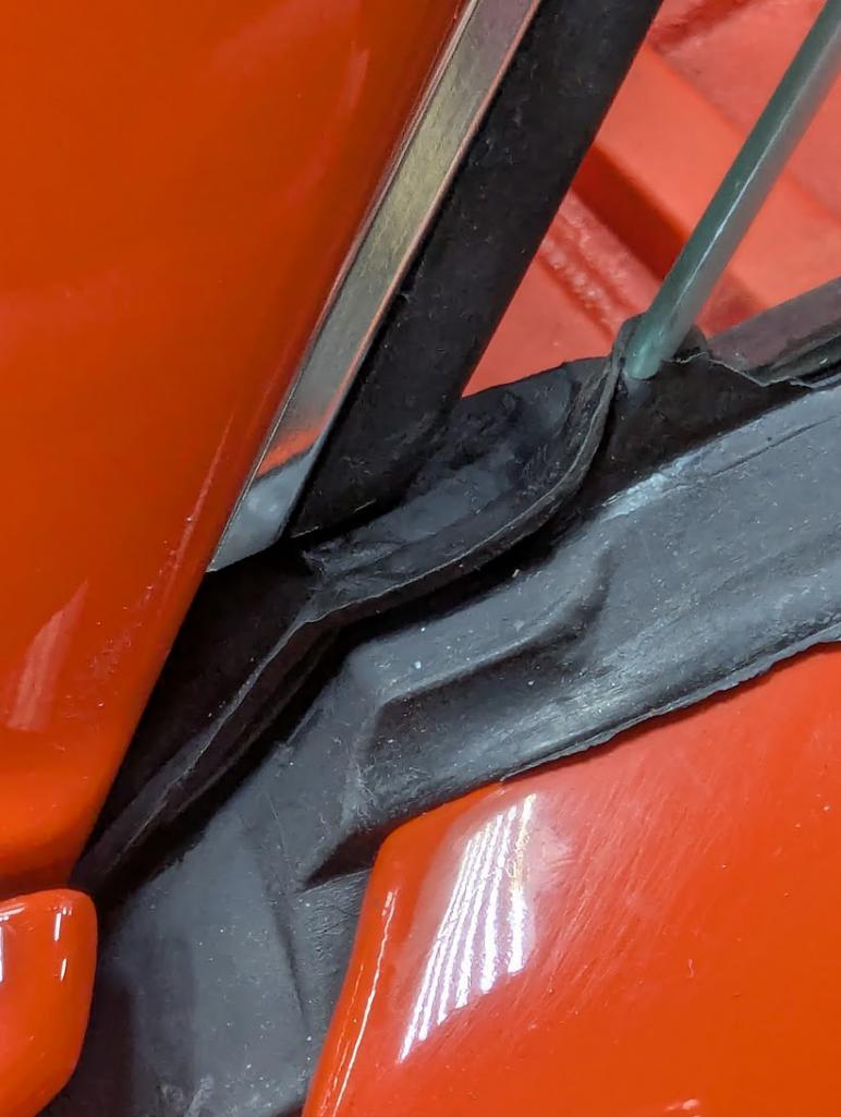

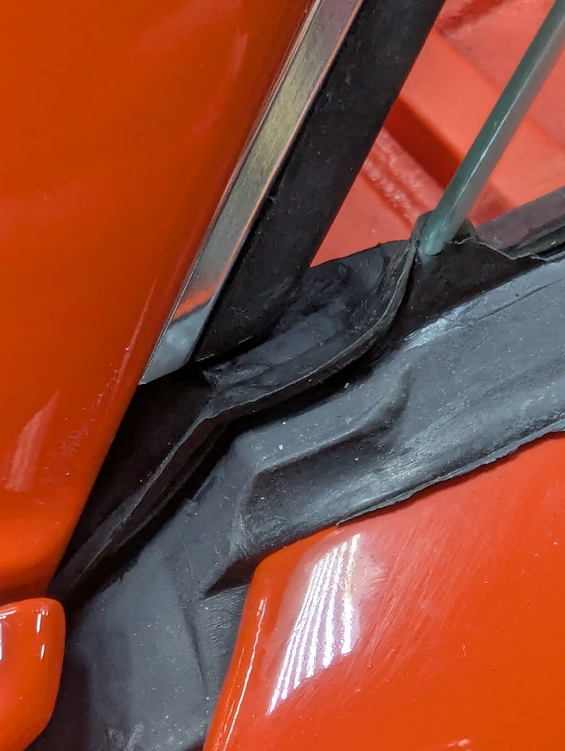

Let me know if this is helpful
https://www.youtube.com/watch?v=ui-GSfUS7ak?si=VmAI8wa4FdyLs-x0
This is how it worked out for me when putting the Main Targa seal on. I have another one for the Triangle window seal that I can dig up too

The problem I encountered with the triangle window seals had less to do with fitment/installation and was more one of durability. The material degraded in very short order in Utah heat/sun, even on a car that was stored indoors.
That said, the first time I switched to using Porsches seals on this specific area on a build I was blown away by how good the tolerances were out of the box. No joke I spent a couple minutes just opening and closing the doors in disbelief of how well everything fit on a 50+ year old car. If you really want to know what the benchmark is I suggest getting a set and installing them on a straight tub, the result is oddly satisfying the way everything interfaces.
Porsche sourced main Targa seal and triangle window seal, ZERO trimming(wish I had taken a video):
