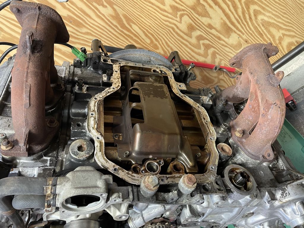

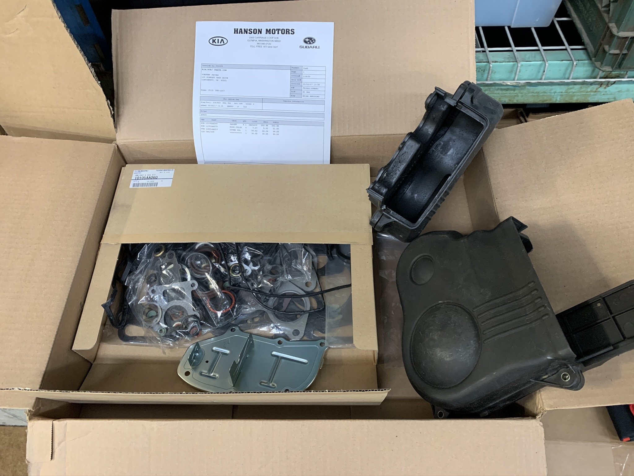

Yeah you really have to do the re-seal kit on that engine. You also want to change the oil separator cover under the flywheel from the plastic one to a metal one (e-bay has them). FYI the oil pan does not have a gasket, you just use sealant like Permatex grey. Usually don't need to do head gaskets, which makes it a lot easier.

(IMG:style_emoticons/default/agree.gif) And there is a magical box that has a bunch of that stuff in it. (IMG:style_emoticons/default/shades.gif) It is in one of the two sets of part drop offs that I did.
Water pump, that is also in a box that I dropped off. It just came from Australia, so water flows clockwise. (IMG:style_emoticons/default/screwy.gif)

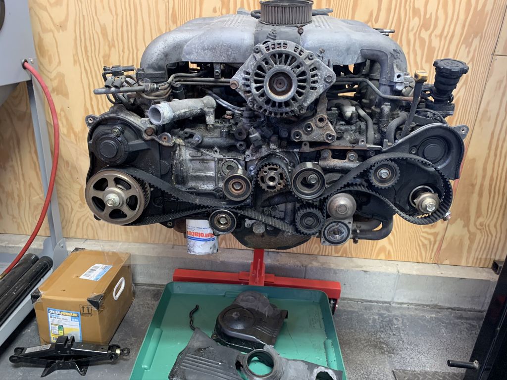

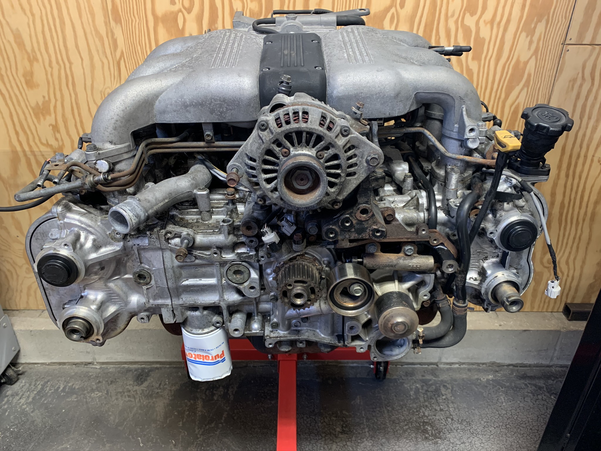

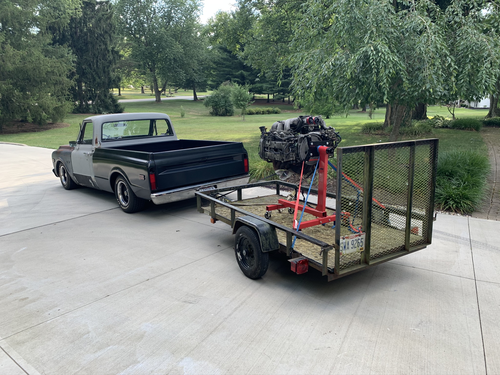

This project has had enough time to settle into the garage, let's get to work.
First step was to get a hitch on the C10 that was on back order forever due to the covid so that I could bring the engine to the power wash booth.
It was a bit dirty.
Best tow beast ever.
Clean, or at least clean enough to go near without getting filthy.

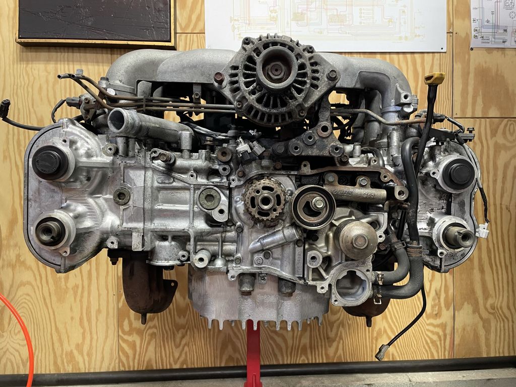

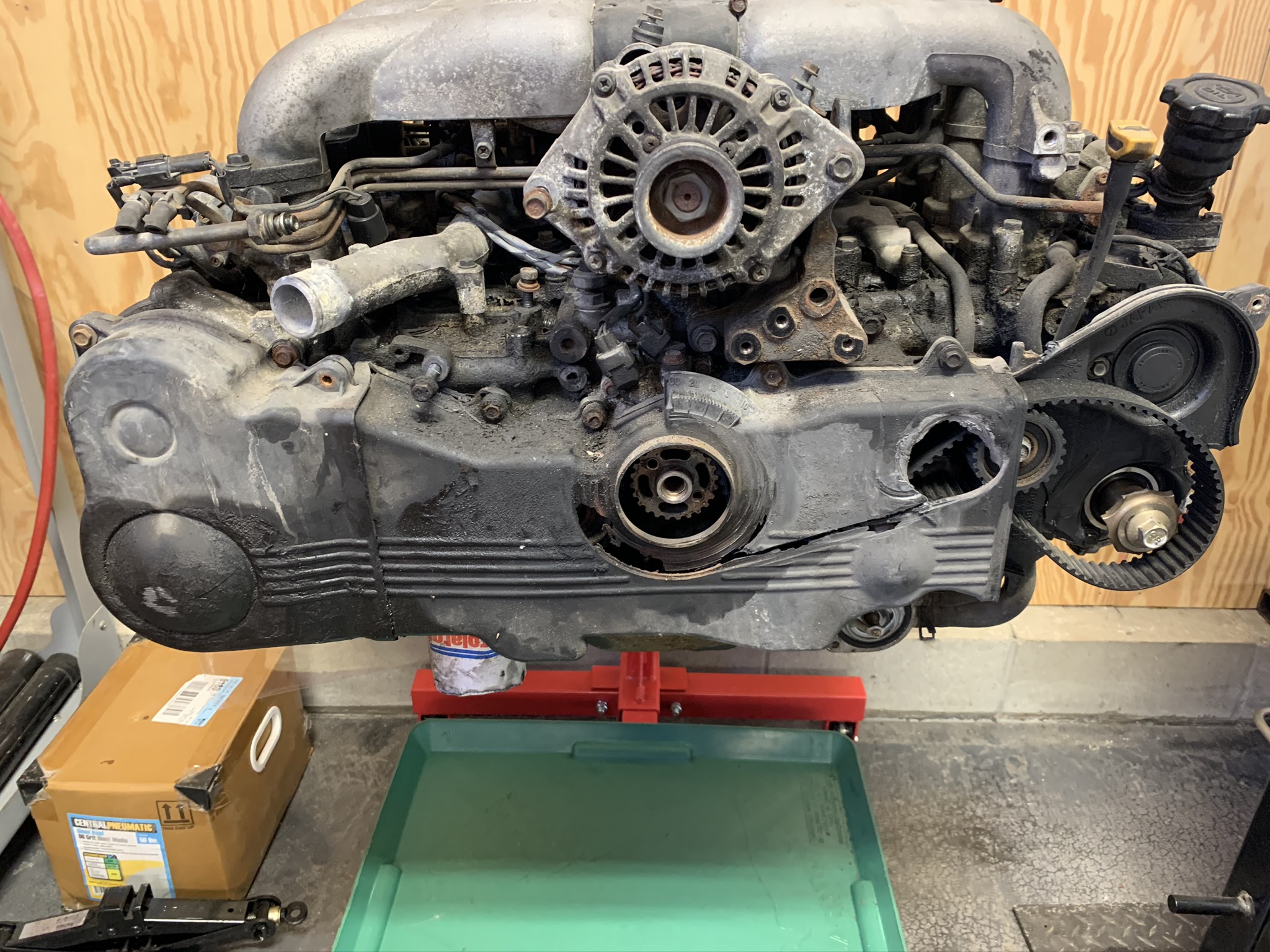

No idea how many miles were on the car since the last timing belt change but the idlers were all approaching the end of their service life. Most subies are 100k then replace belt, idlers, tensioner and water pump. This is definitely in order for the EG. All of the timing belt plastic was cracked from the drop or from the middle on over deteriorated from use. Fortunately Stephen had all but the center piece in the boxes of goodies. He also had all of the gaskets/seals for the reseal and a metal cover for the rear.

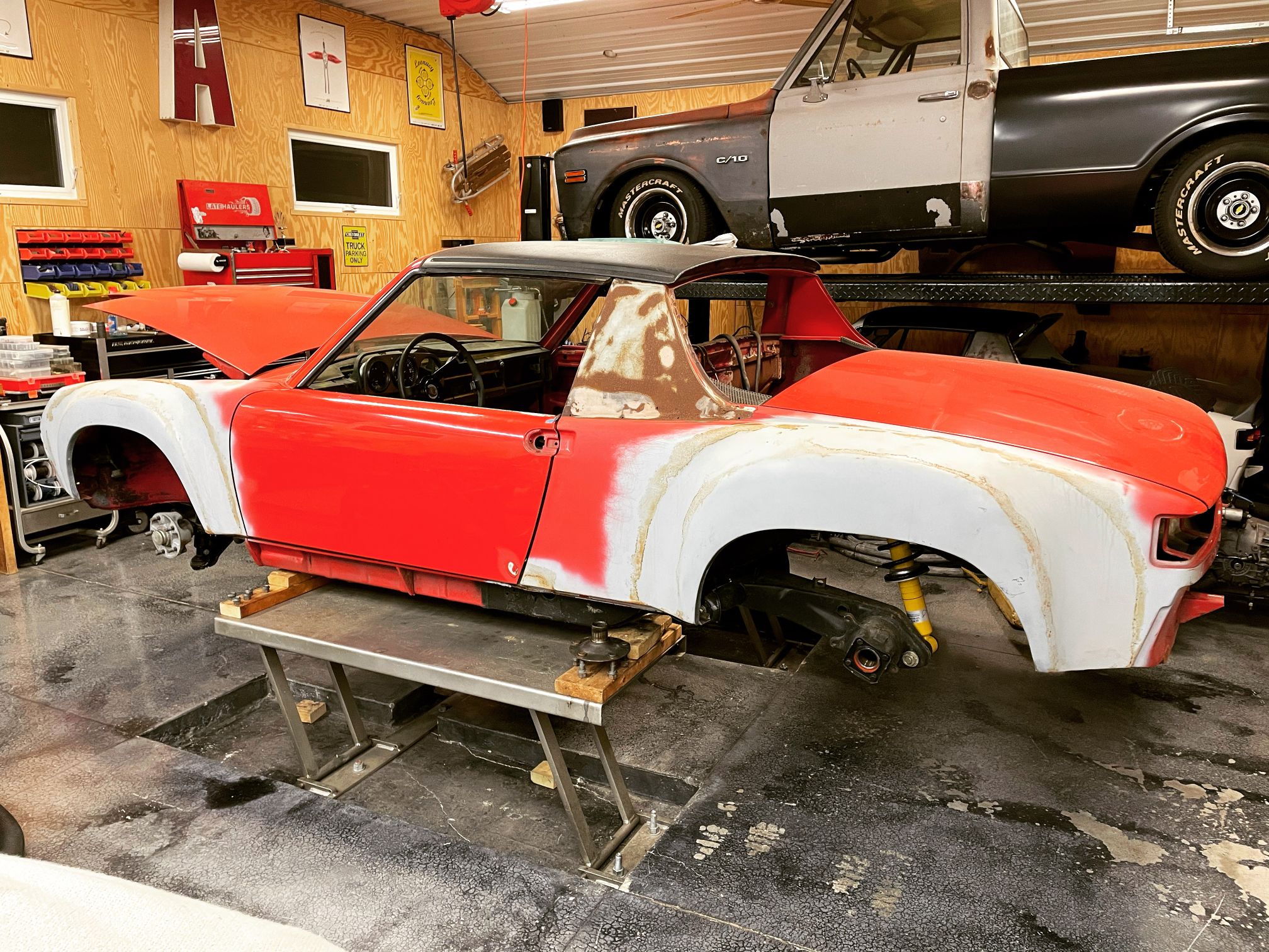

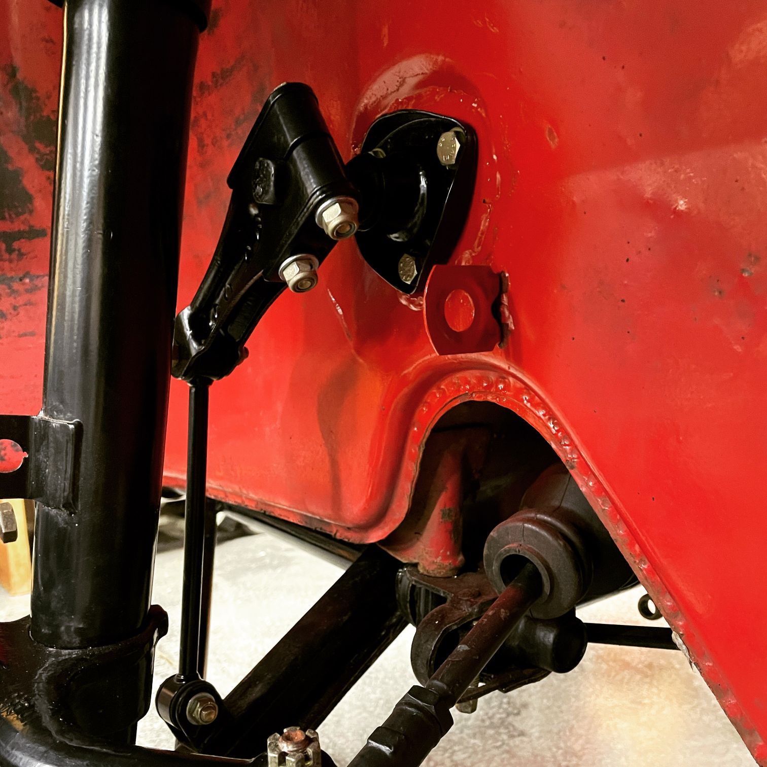

Probably about time to update the thread.

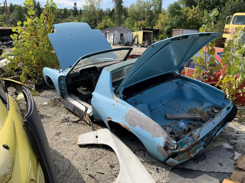

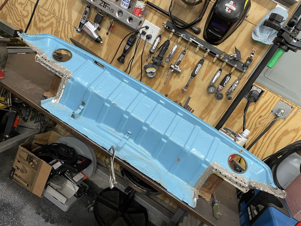

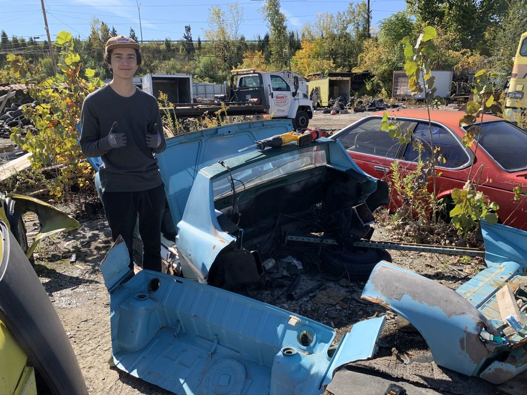

Managed to find a rear trunk section in a local junk yard.
Brought along my neighbor gearhead in training along with to help with the extraction.

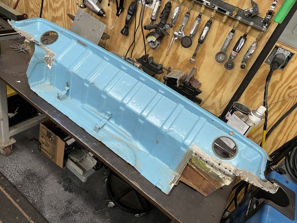

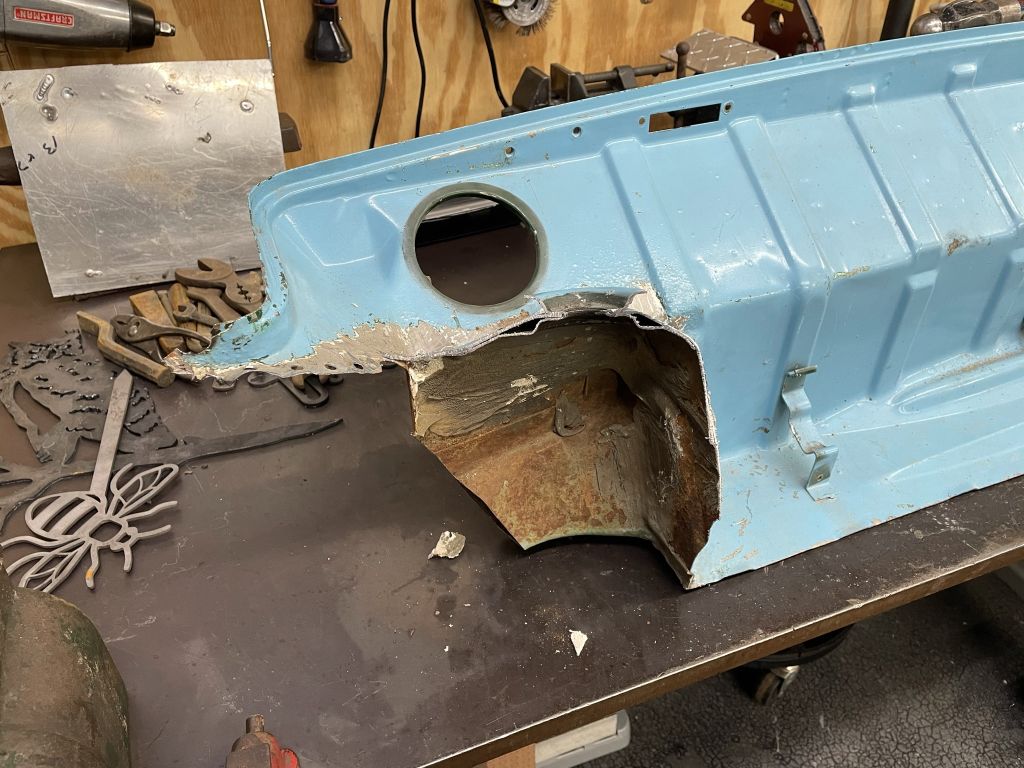

It is amazing how many layers come together in this part of the car.
Sort of kinda have it down to just what I need. Just another 30 spot welds to cut. Being very cautious to make sure that I don't cut out anything that is needed.

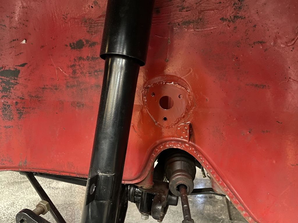

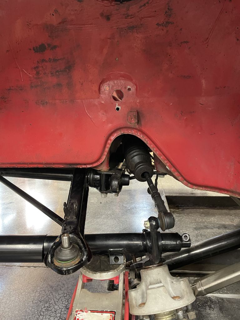

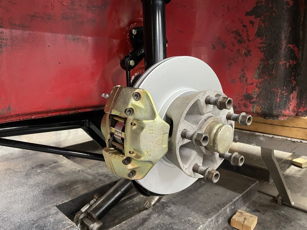

Also working on the suspension. Pulled the rear hubs to replace the bearings and install the 911 park brake.
Installed the front sway bar.
Assembling the park brake and calipers.
Shiny!

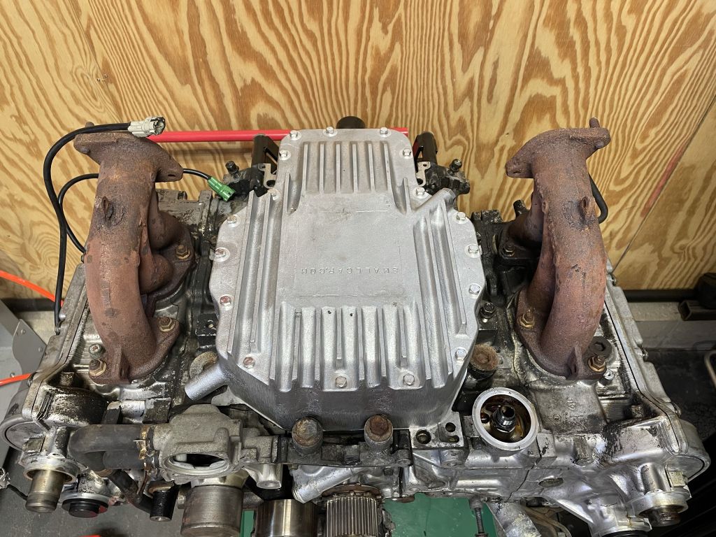

Couldn't resist test fitting the new oil pan.

Wow, I'm getting excited about this car again. Thank you!
I never showed a pic of the rear trunk but I'm happy that Scott is making it oem again. The metal bar connecting the shock towers was a terrible hack.
