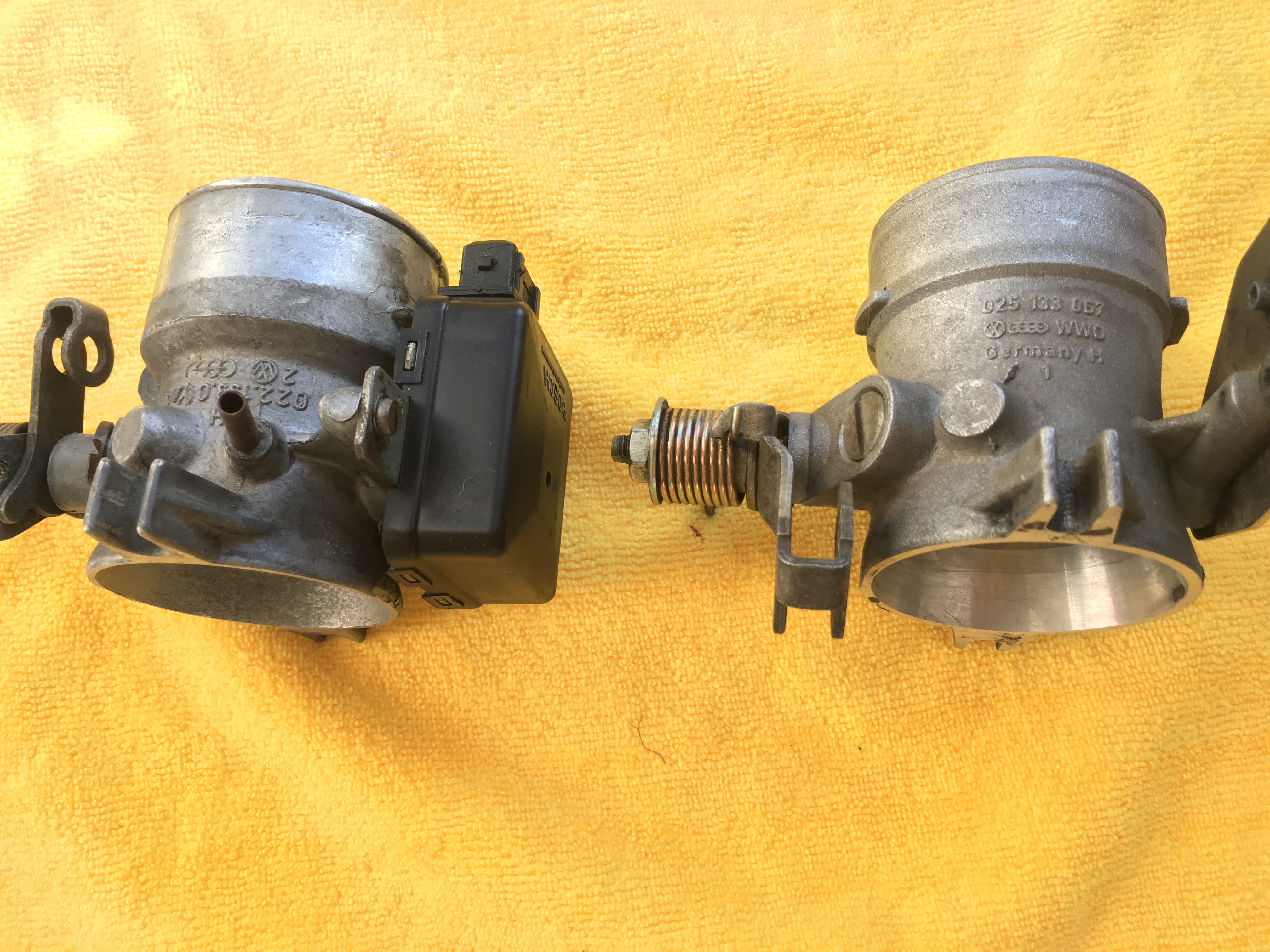

jim_hoyland
post Nov 16 2016, 09:41 PM
Post #34
Get that VIN ?
Posts: 10,130
Joined: 1-May 03
From: Sunset Beach, CA
Member No.: 643
Pic of the orig 914 TB next to the Vanagon before modifying
