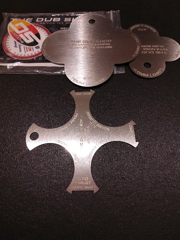

Hope you figured out your thrust bearing issue. @Mr.Vman
Posting this to update with a better (more comprehensive) than the one in the previouly posted link, useful to others that might come across this post in the future. It's from The Dub Shop and got it when parts shopping for an upcoming project. It's used to measure journals, use as a bearing/align bore gauge, bearings and thrust. Of course you can still use a bore gauge and calipers/micrometers, etc. Probably a good idea to measure it with all these different tools to confirm your measurements.
