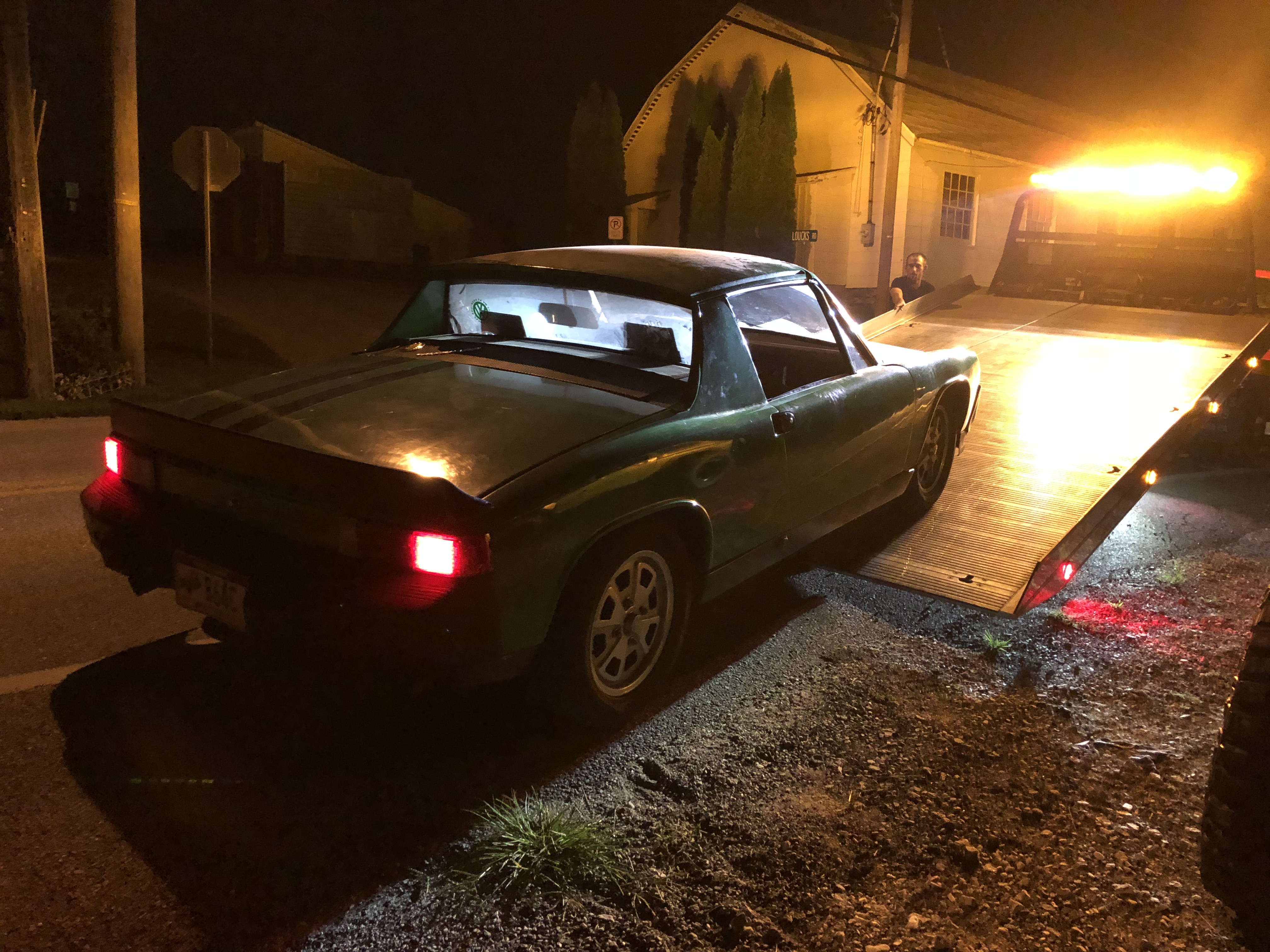

Waiting on the side of the road for a flatbed to take me home.
Engine ran great. Charging system not so much. Driving along. Lights started going dim. Car started bucking. Only 5 miles to home but it wasn’t going to make it, and no shoulders to pull over safe on the little farm roads. So I pulled into a spot I knew of and shut it down and parked it and now I wait.
McMark had said earlier he wasn’t sure about the charging system. But the alt light was not on and no issues before now.
So. What’s the alternator I need to buy?
Maybe a new VR as well?
I guess I should test the battery and make sure it’s okay too.
