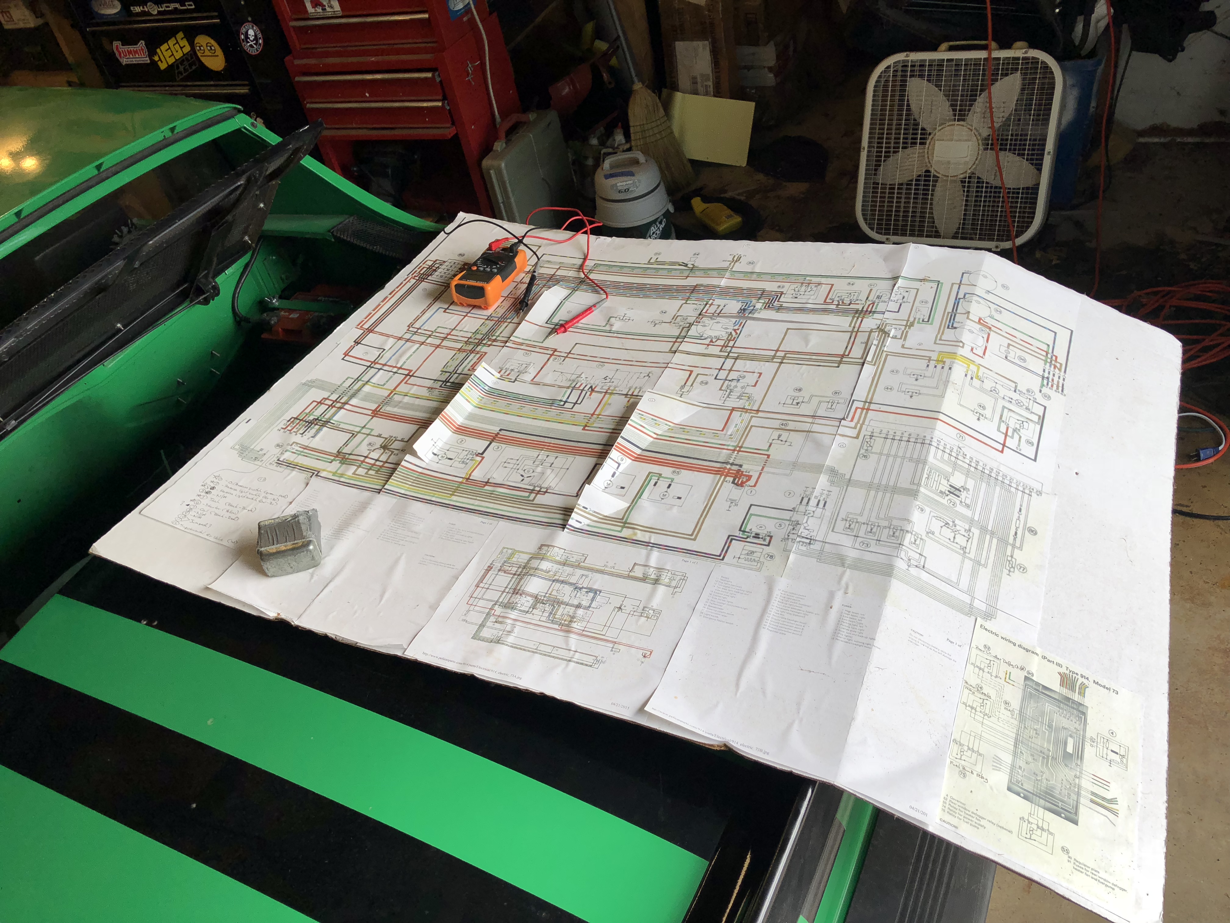

Just did Spokes test of shorting DF and D+.
Battery went from 12.12 volts engine off to 11.87 volts engine on at idle.
If I understand correctly even at idle I should expect to see greater then 12 volts with the VR shorted to Max Effort state. I’m guess the alternator is just dead.
I also made sure the belt was tight, and it was good and tight.
Going through grounds and don’t see anything too off kilter, though I have only looked at engine bay grounds as yet.
This alternator, by the way, only had about 300 miles on it. It failed really quick.
While I’m thinking about t, is there a way to bench test the voltage regulators?

A Bosch alternator is a B circuit alternator. That means that applying 12v to the field (DF) terminal on the alternator will make it provide maximum output, somewhere in the neighborhood of 15 to 18 volts. You should also hear the whine come from the alternator and an RPM drop on the motor.
Zach.. check and make sure the relay board is not the culprit. Pull the 3pin alternator plug off the relay board, and with the car running, apply 12v from the battery positive post to the DF terminal. If you don't get 15 to 18 volts and a whine, I would replace the alternator and the wiring harness to it. There is a group sale on the harnesses going on right now in another thread.
Buy a new Bosch alternator. A lot of the "rebuilt" alternators out there are just cleaned and maybe replace the brushes.

System still isn’t charging right.
I drove the car to the gym, and then around. Maybe 7 miles. Pulled into the house and got the mutimeter out.
At idle I was showing 12.12 volts across the battery terminals.
Revving the car to 3k and I was showing 12.06 across the terminals. I should be seeing more at rev.
Grounds are good
Alternator, voltage regulator, and voltage harness are all replaced. Gen light is acting like it should.
I shorted D+ to DF and the engine loaded up and I saw 15 volts bear idle.
So what’s next?
Relay board?
New VR still suspect?
Zach

A fully charged car battery should be 12.6 volts so I would say that if you have less than that at idle you are running off the battery.
A normal working charging system should read 13.5-14 at idle.
Do you have a known good VR you can try?
Doesn't make sense that the board is bad if you can jump the VR leads and get it to charge.
