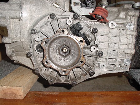

If your Audi transaxle has the bolt holes contained within the ring on the output flange, then it might fit the later 108mm Prosche CV. The Audi has six bolts, and uses no pins such as on the P stuff, AFAIK. This would be on the late model 012 5 speed Audi transaxle. Is that the one you have, or do you have the model 016 5 speed? If you have the 911 CV available for match-up, that would be best....Let us know. The Audi/Getrag 6 speed has a different flange, as pictured below
Andy
Not sure which one I have...it's out of a 99 Audi A4 FWD tranny.
Raxles's mentioned that there is a difference, I believe he said the porsche is 108mm and the audi is a bit smaller (100mm maybe) so that is the reason he could not make me an axle. And you cannot mix-n'-match audi CV with porsch 1.8mm CV because the number of splines on the axle rod are not the same. He could not locate any axle rod with the combination of the porsche and audi splines, it has to be custom made and that's very expensive.
I don't have a pic of my tranny handy....here's a pic of a quattro tranny...but the axle mounting is the exact same:

This looks totally do-able. The 911 driveshafts are shorter than the 914 ones too - so that will even buy you a little space. Damn. I'm going to have to get a setup like this. Does Audi have a 6-speed box????

The Quattro 6 speed has a hollow secondary shaft that the pinion shaft runs through. Wouldn't recommend it for high HP applications, but in your case it's probably not an issue. They are coupled together by a Thorsen for front to rear bias. There have been some that have considered locking the two shafts together to get a front drive only output, but the idea was shelved (can't recall exactly why).
Here's a pic of the boxster transaxle:

Your Audi output flanges must be 108mm to fit the 911 CV's. My Boxster 5 flanges are ~102mm. I will either try to fit standard 914 CV's or see if the larger flanges are interchangeable...
