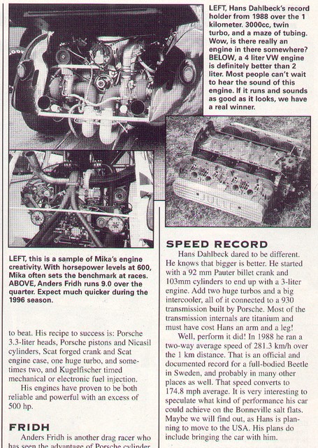

asked the same question a while back....
here's what I got.

Hans Dahlbeck? Isn't he the brain donor in 'Young Frankenstein'? Seems fitting.

QUOTE (Cloudbuster @ Jan 28 2005, 03:23 PM)
No, I think you mean Mr. Abby Normal (IMG:http://www.914world.com/bbs2/html/emoticons/wacko.gif)
