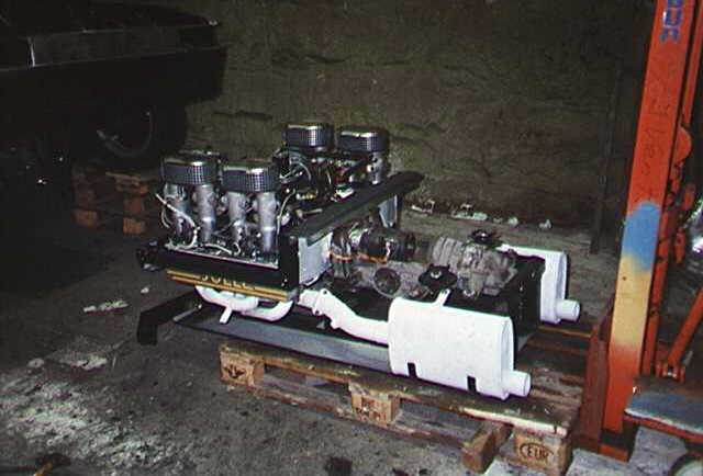

Has anyone tried to build a flat 8 with two type 4 motors?
Theoretical questions.
Assumptions
2 motors each producing 100 HP and 100 Lb/ft of Torque
The motors are end to end, front to rear.
The cranks are fastened together either bolted or welded.
1) Would you get 200hp and 200 lb/ft or torque? or is there some multiplier...seems like you would produce more torque..
2) could it be done with a single ignition system available for sale off the shelf.
3) could you do it without two distributors? crank fired ignition system..I am thinking that there could be a wheel placed in between the motors to give you something to time from.
4) I am assuming either a nice FI system, or four carbs.
Has anyone done this?
I would like to see some articles or web pages if this has been done in the aircooled world...
Thanx in advance
Rich

andys   It's been done both ways. I saw a pic years ag...   Jan 28 2005, 01:08 PM
r_towle   honestly cooling seems like a simple part of it .....   Jan 28 2005, 01:14 PM

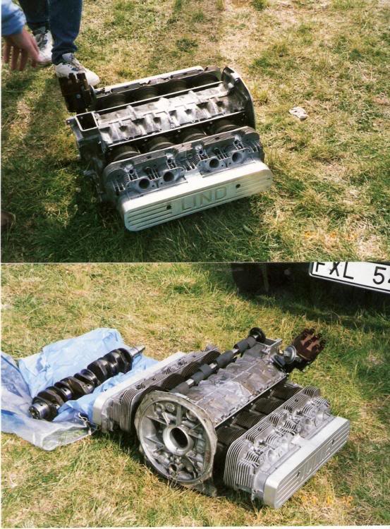

synthesisdv   asked the same question a while back.... here...   Jan 28 2005, 02:19 PM
Cloudbuster   Hans Dahlbeck? Isn't he the brain donor in ...   Jan 28 2005, 02:23 PM

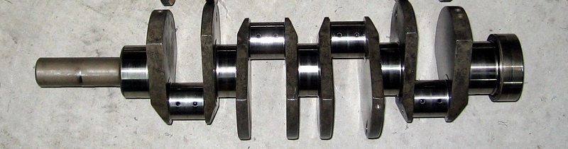

Brett W   The 180 degree 8 has a problem with second order i...   Feb 27 2006, 08:56 PM
Thorshammer   One of the problems must be the design of a crank ...   Feb 27 2006, 08:58 PM
alpha434   Why we couldn't use a Chevy crank: Counter ba...   Feb 27 2006, 09:03 PM
ClayPerrine   <...   Feb 27 2006, 09:06 PM
alpha434   ...   Feb 27 2006, 09:07 PM
lapuwali   ...   Feb 27 2006, 09:22 PM
Brett W   Sorry I was referring to a 180 degree V8. Don...   Feb 27 2006, 09:23 PM
