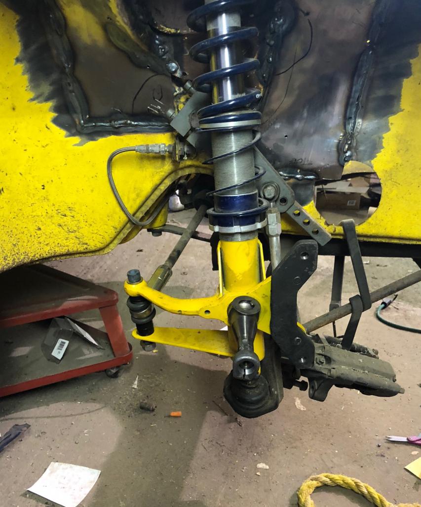

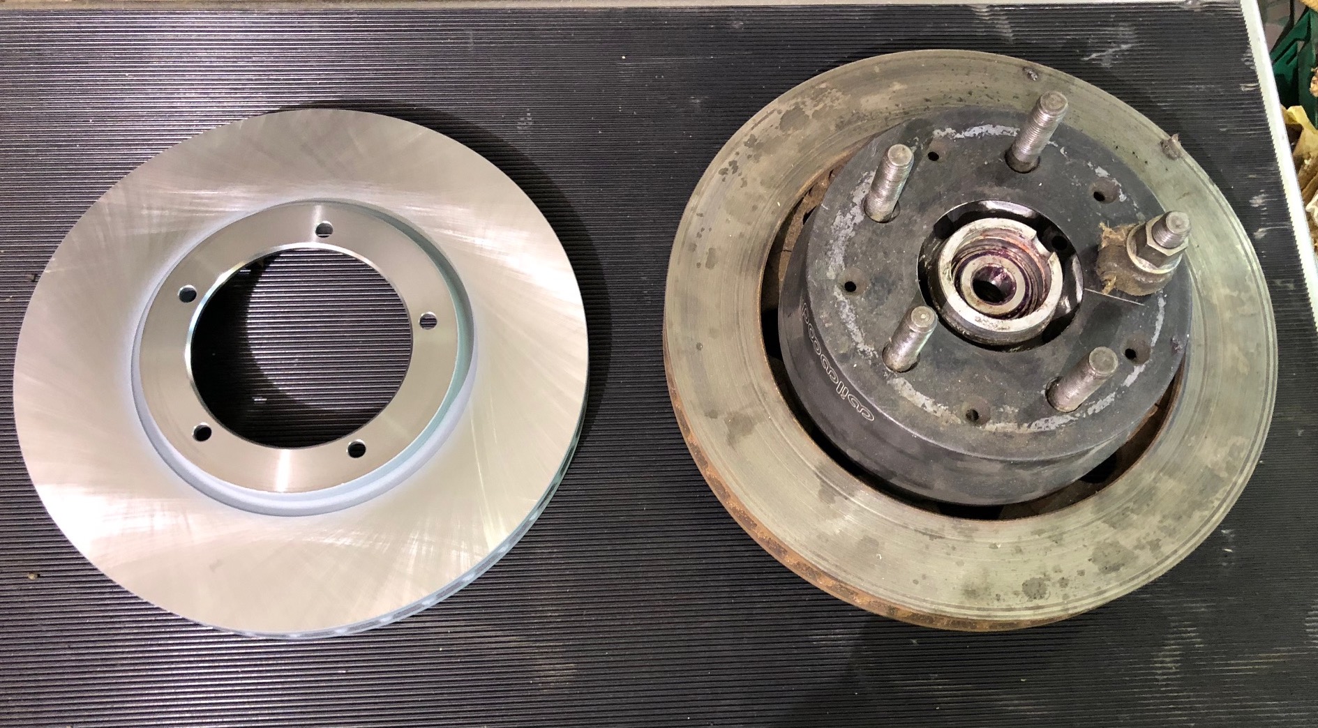

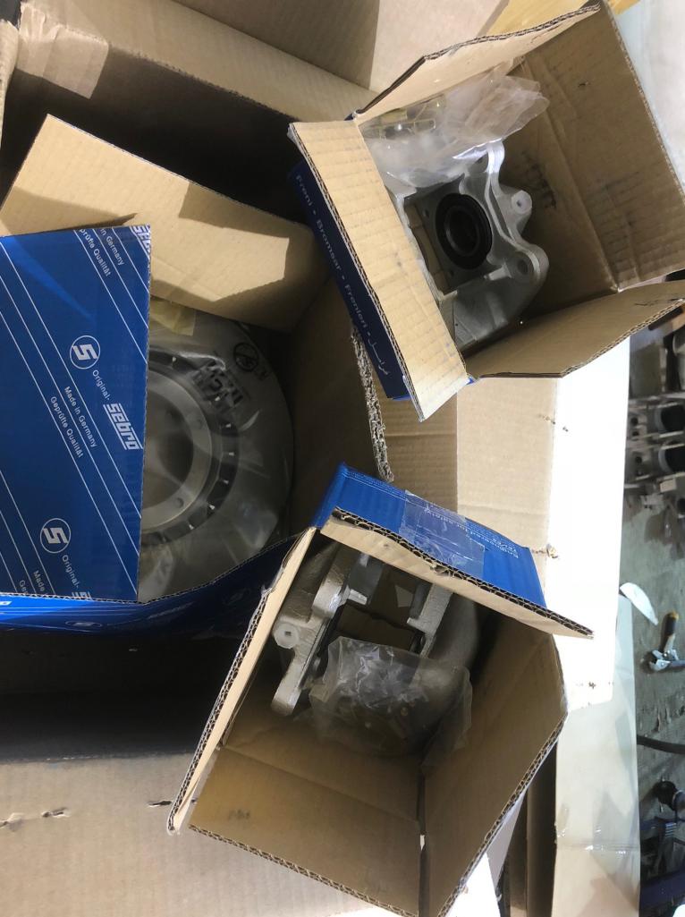

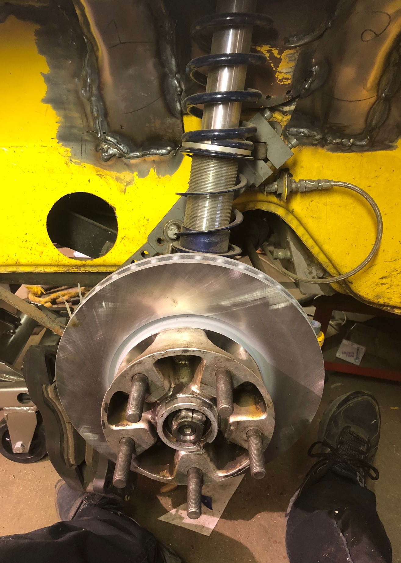

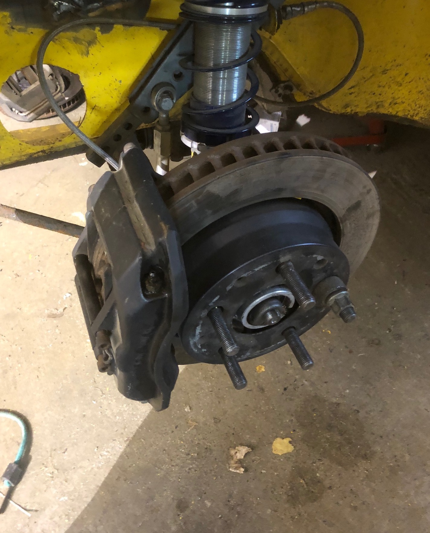

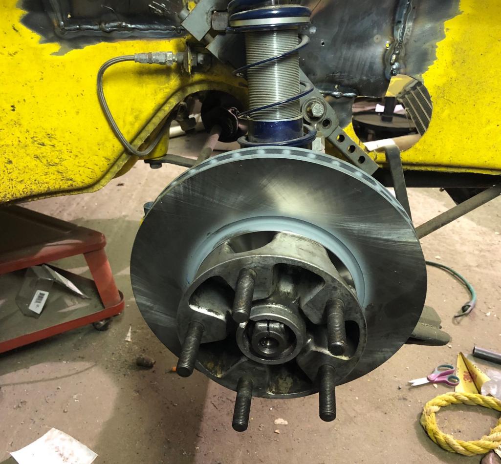

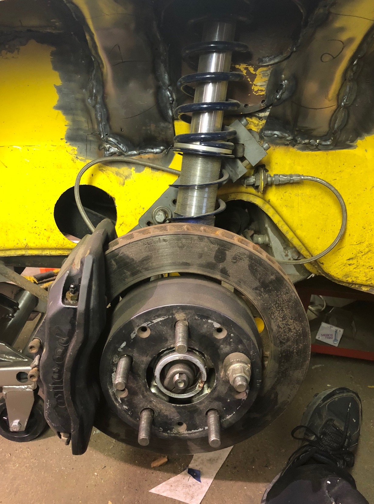

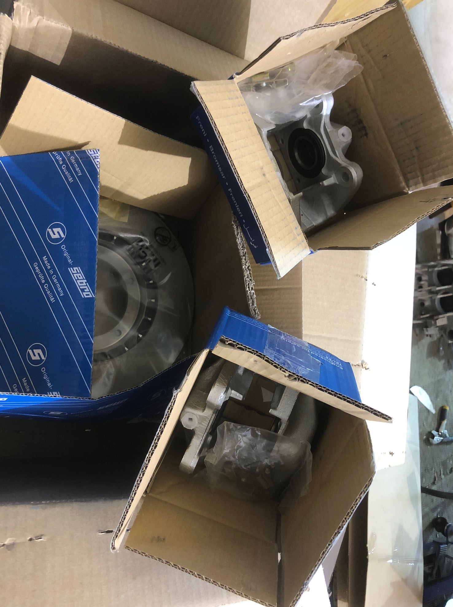

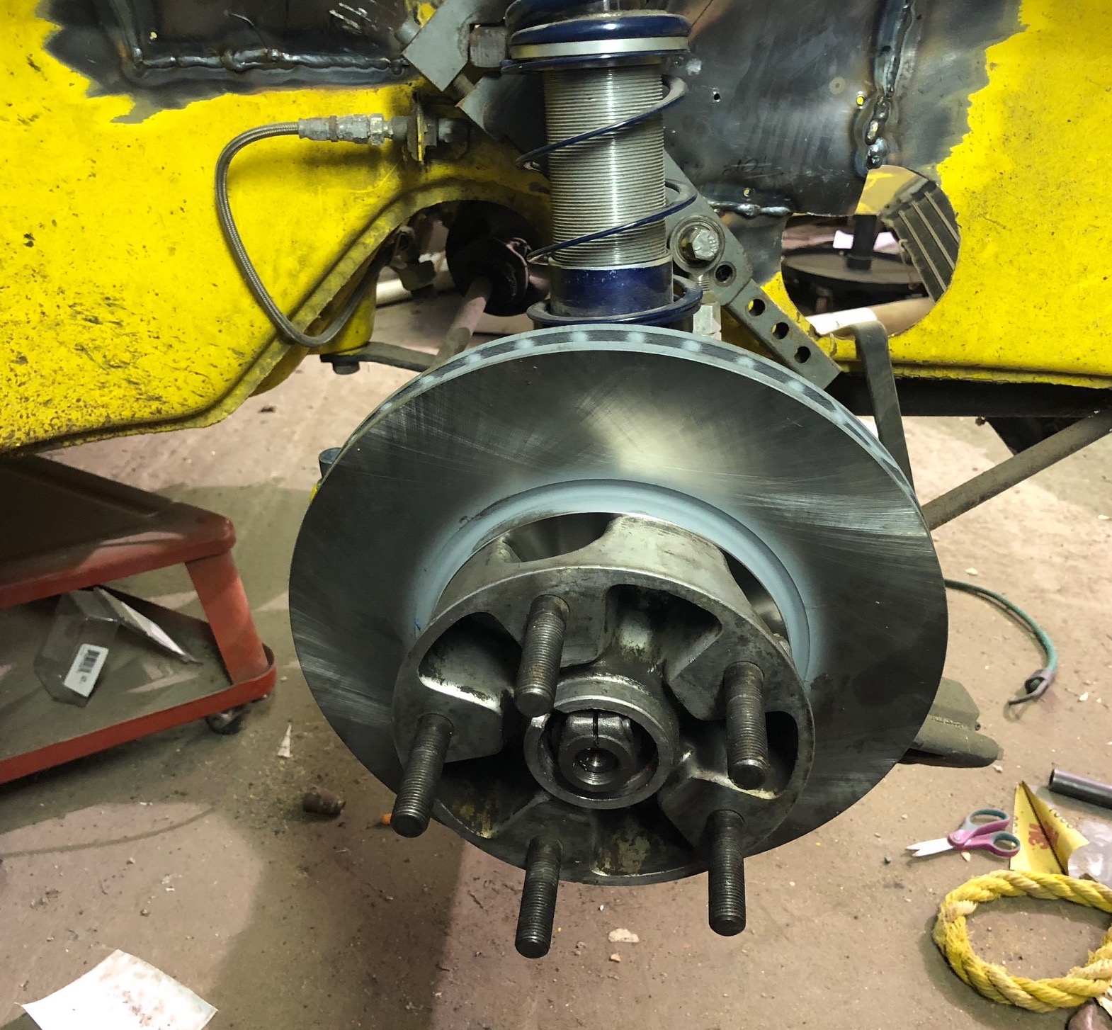

Nothing big this week, other than saying goodbye to the big brakes. In order to keep them I would have to run the super big wheels, and with the narrow body it wouldn't really work. So the big brakes are going and stock brakes are going on, they are 80's 911 SC/Carrera brakes, so still plenty of stopping power. Though I will miss the big ones, they were just so big!
Also, Rick can't help me this weekend, he is skiing, oh well. Next week more progress.

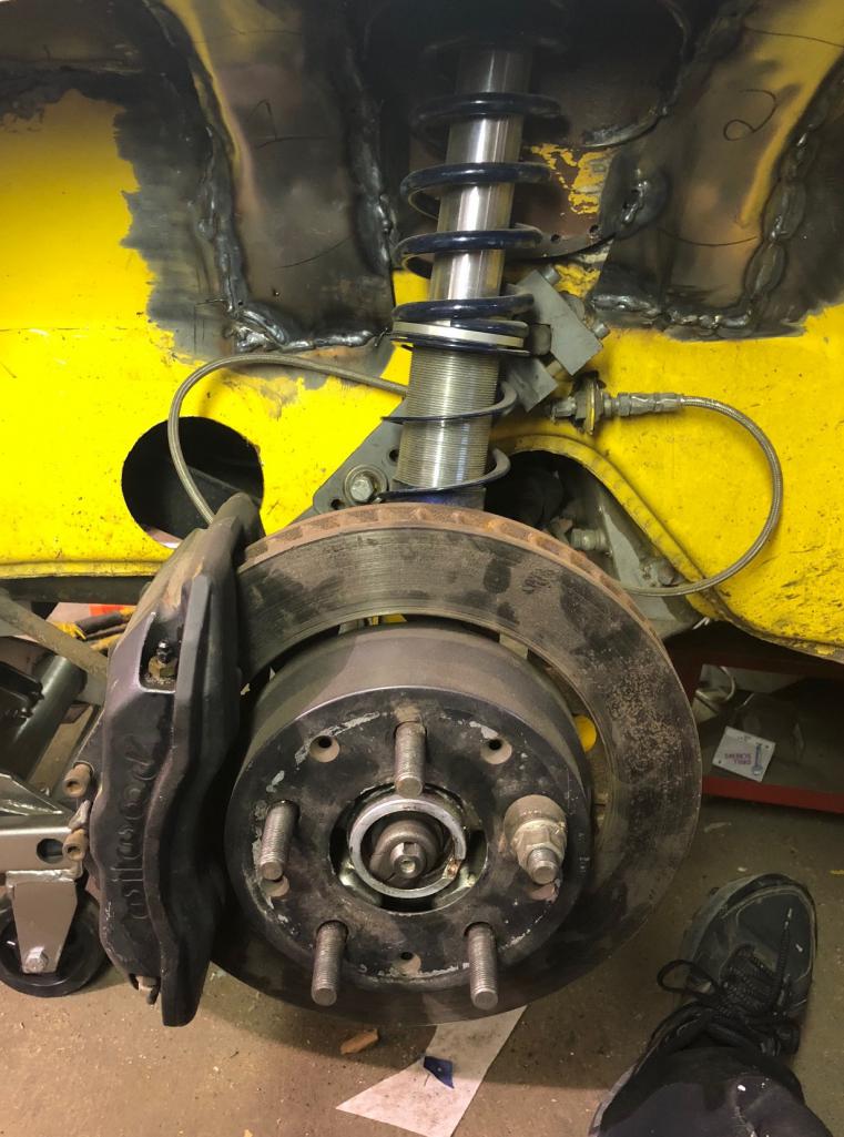

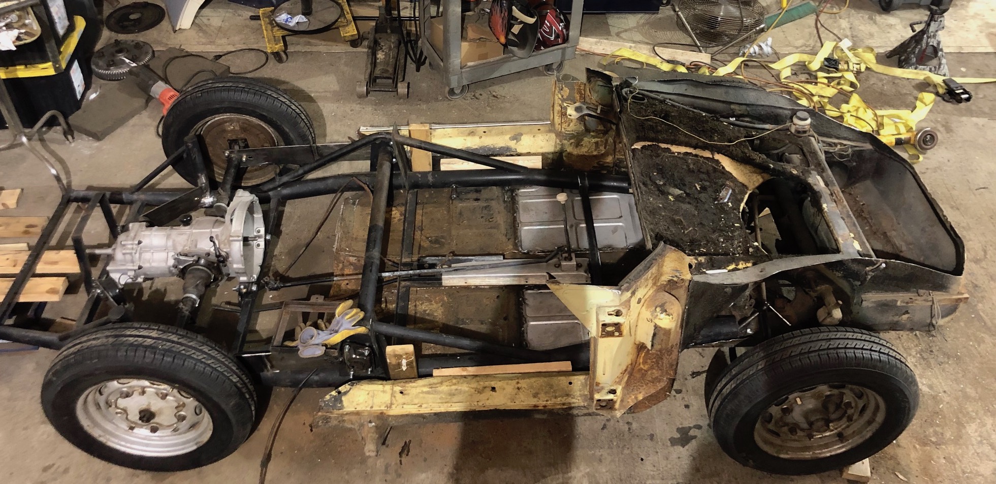

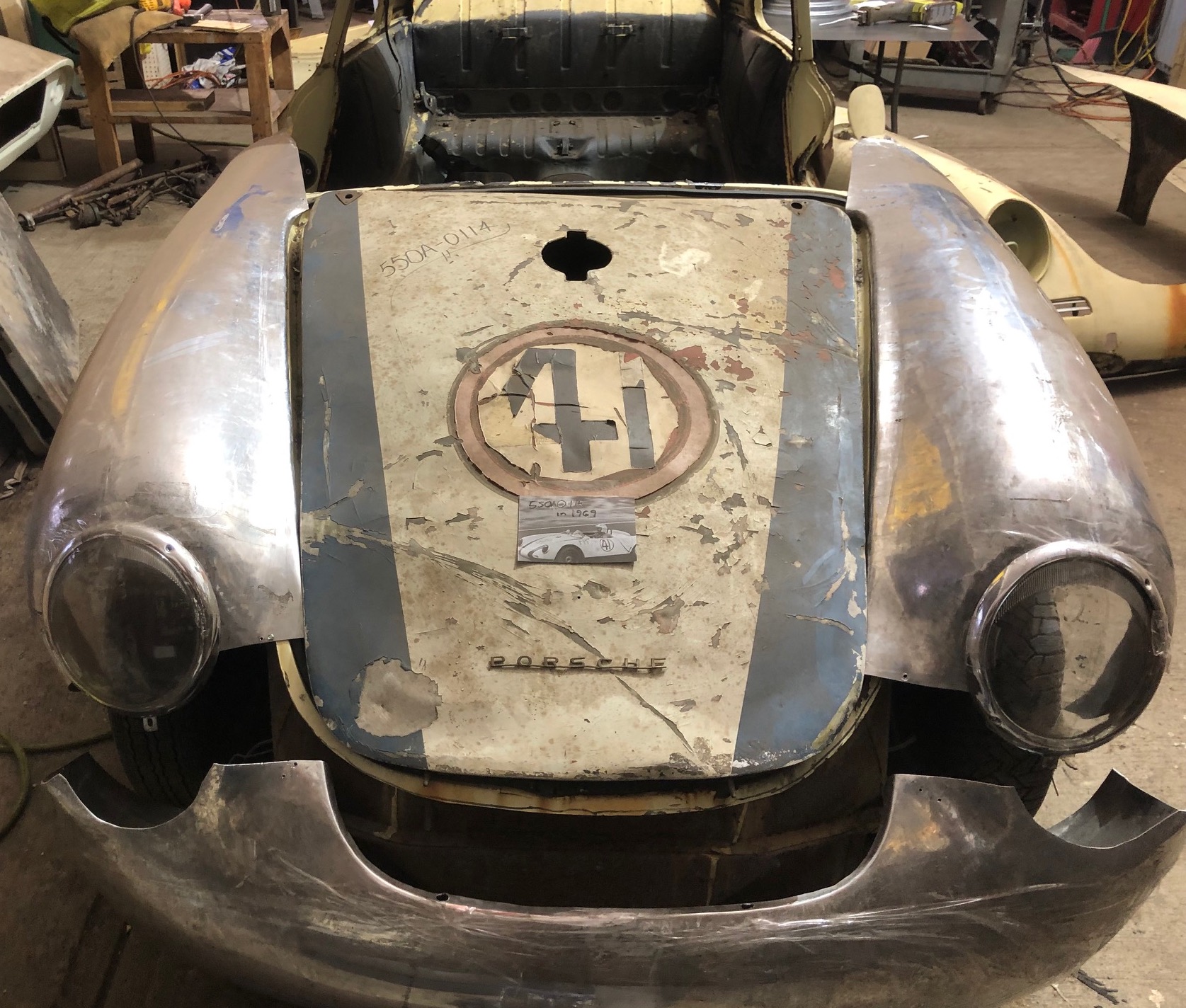

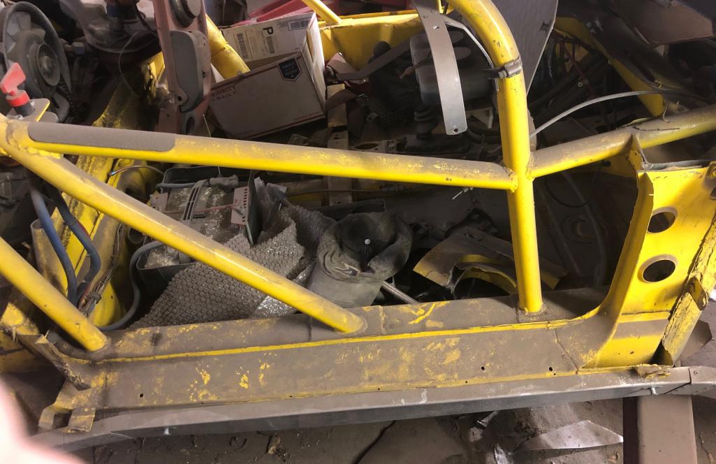

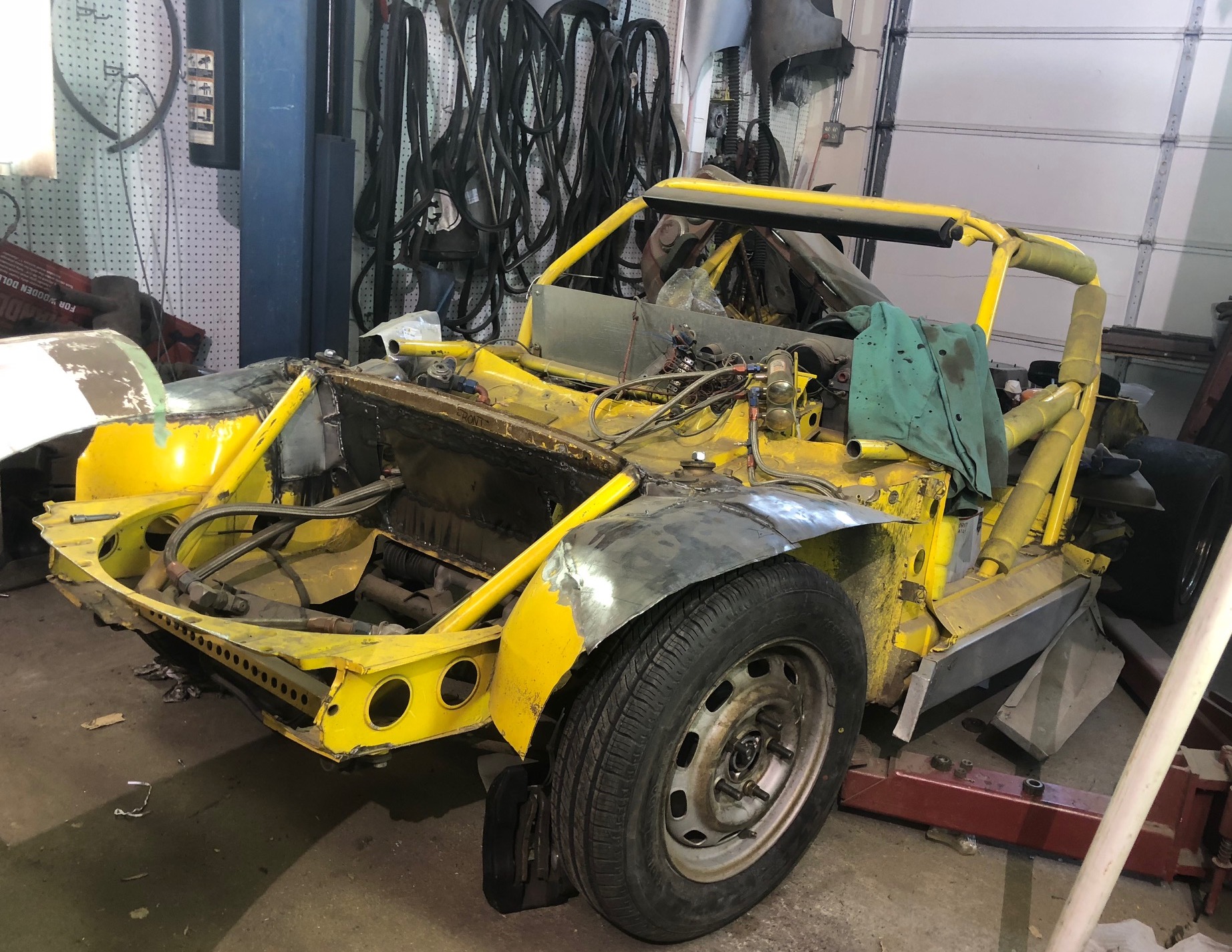

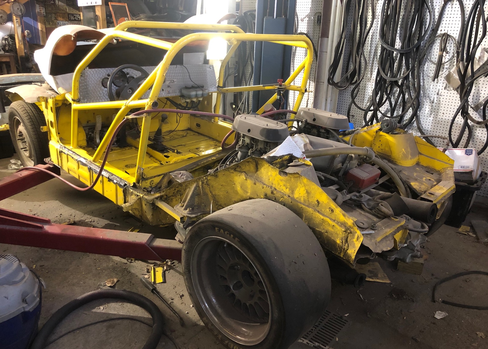

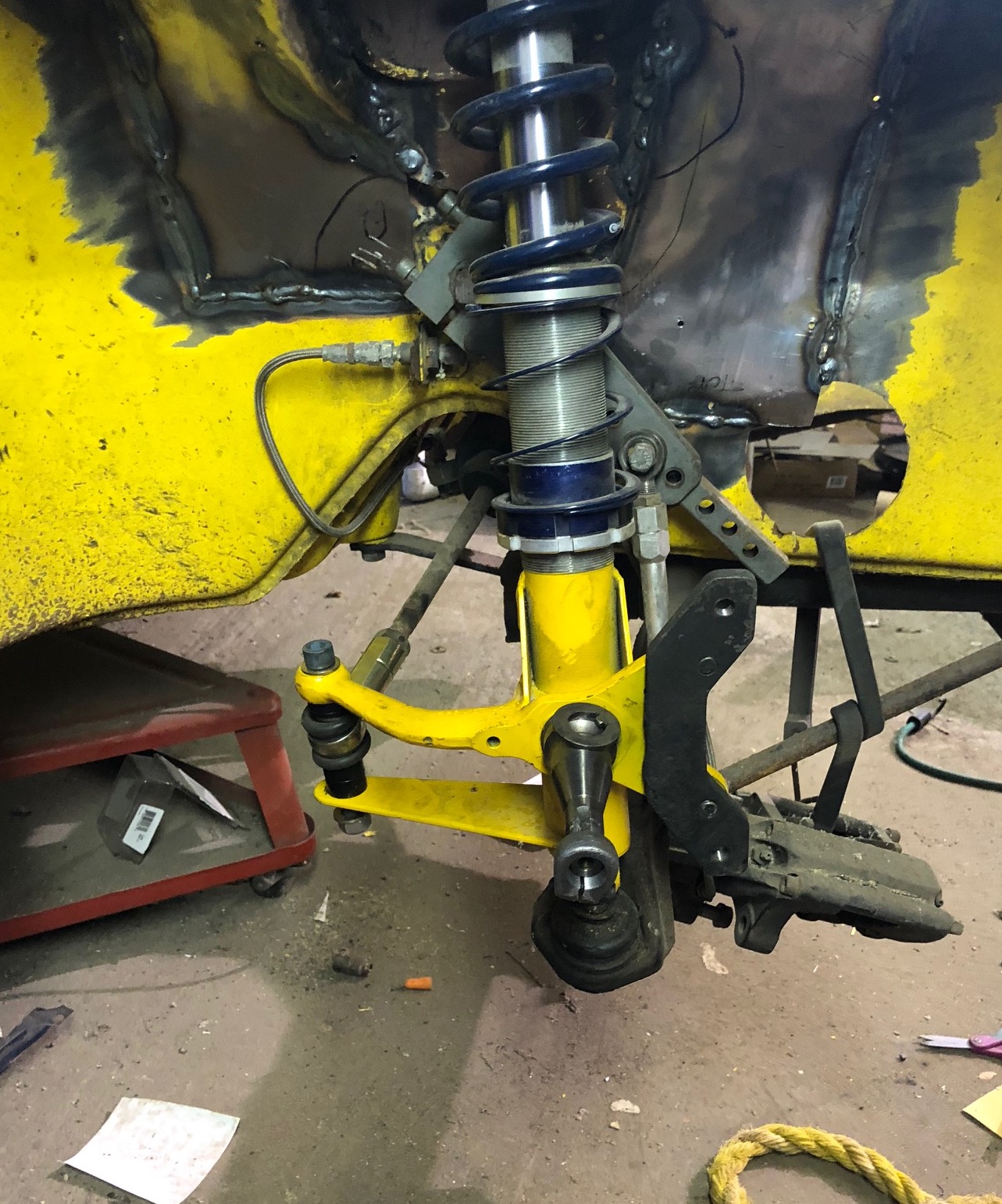

I was able to avoid a Sunday party that my wife went to today and got some time in on the car. I was able to get the front suspension done. Keep in mind the shock is completely out of adjustment, but you get the idea.
Hoping to get the car back on it's feet this week than the last big cut, right down the center of the car. I had to say goodbye to the big brakes today.

Ok, today was kind of monumental, the car is back on it's feet for the first time in several years. I put the wheels on and dropped it off the lift. Now I can move it into the main work area and start the final chassis work. A good day!
Also, bye-bye big brakes, anyone need some Wildwood big brakes?

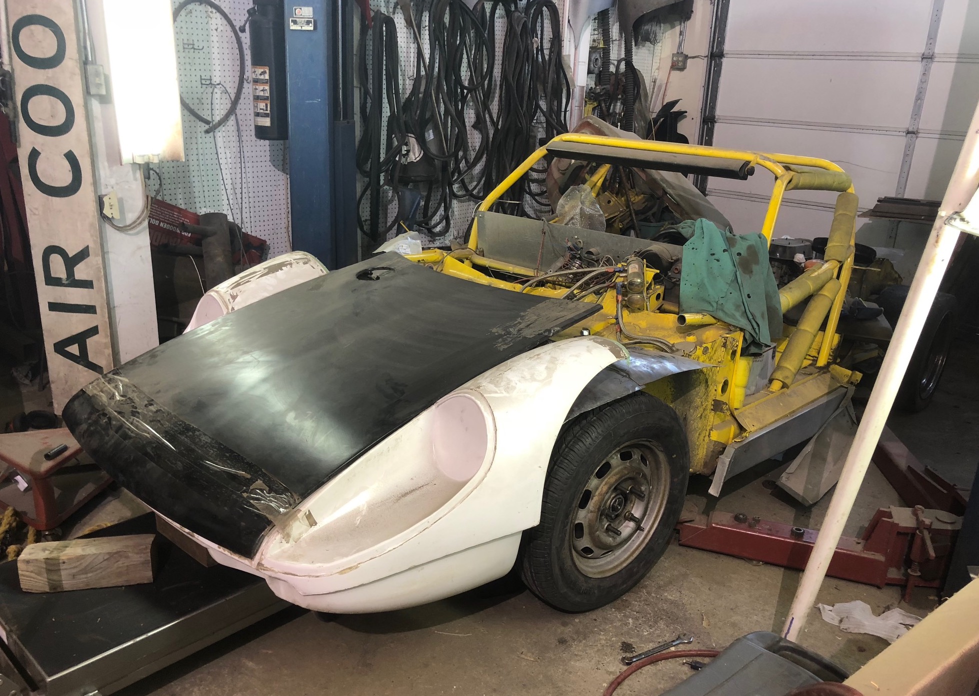

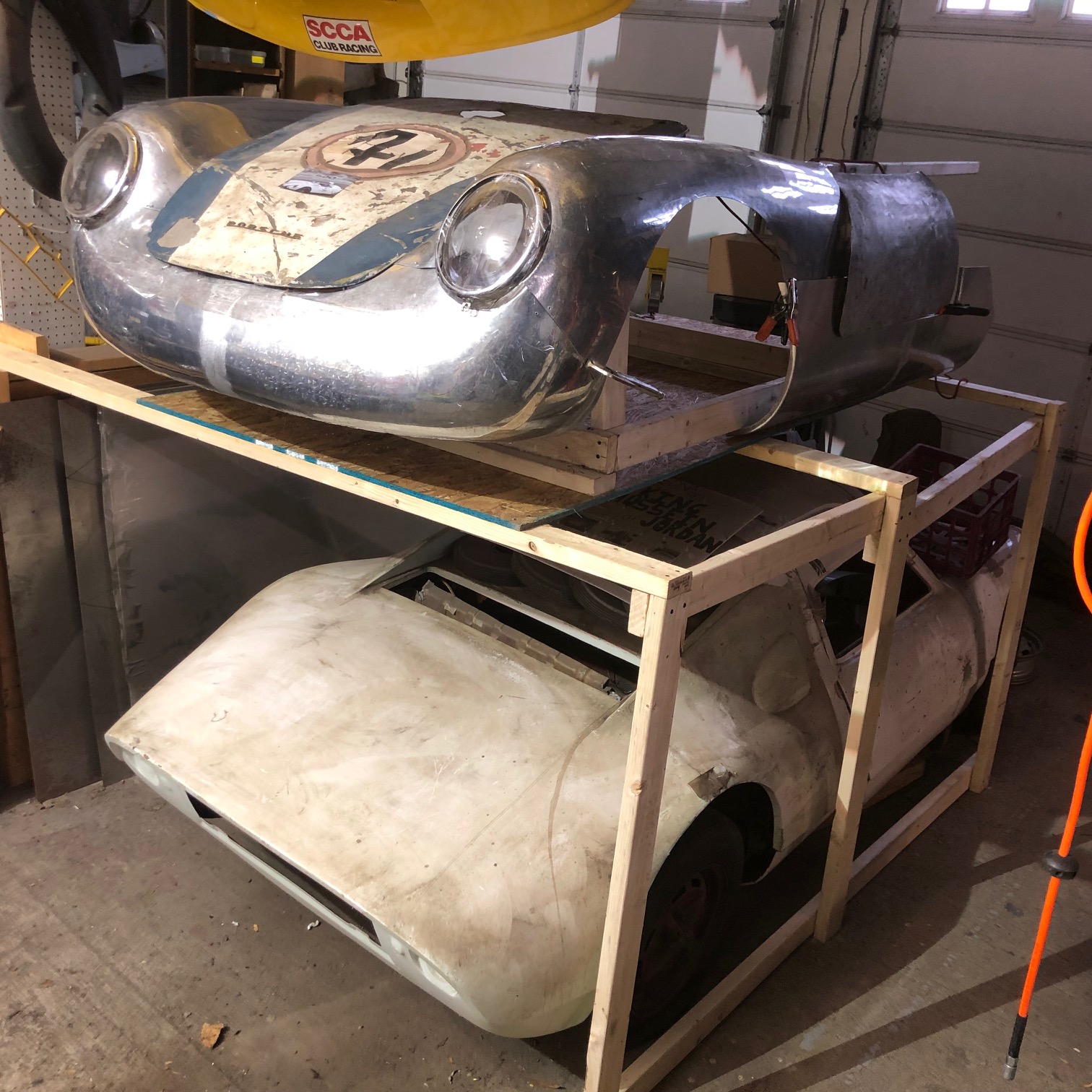

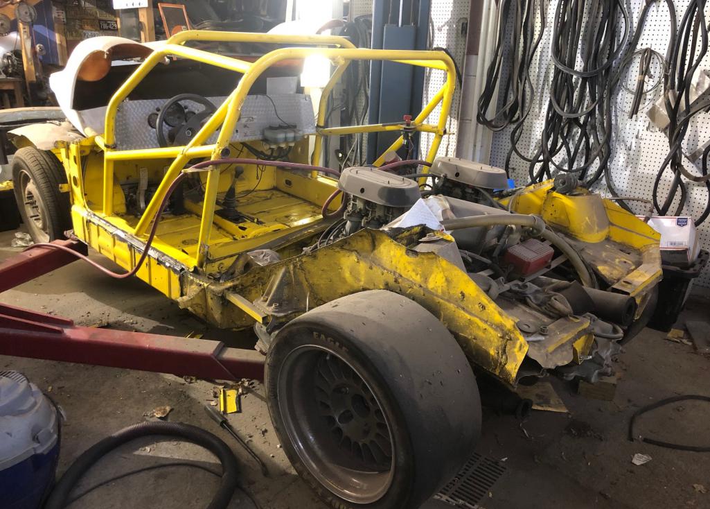

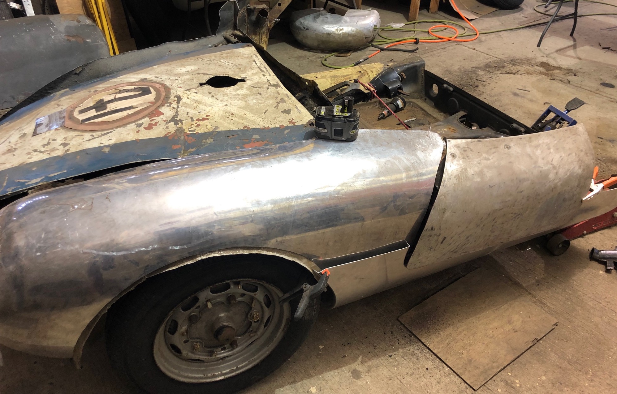

It's been on the back burner for a year, I went full steam ahead on my 550 project, it's now at a stoping point so in May I''m jumping back on the 904. I'm dropping the chassis for the 550 off at a friend's place to get it running and driving, I told him I don't want to see it for a year at least, so I can get really back into the 904 project, it's like having two girlfriends, with my job being my wife!
Stay tuned.

That storage rack seems way to sturdy!

Lucky for me, aluminum is lite!

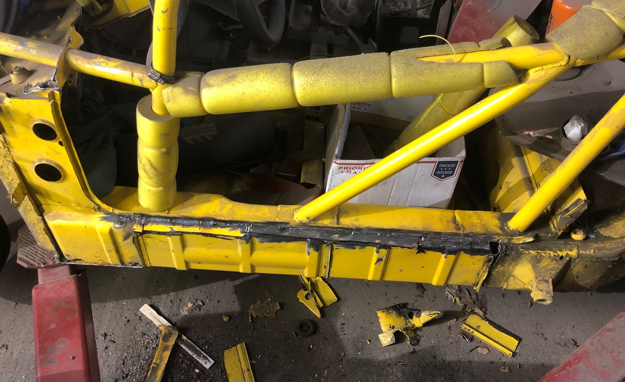

Ok, finally caught up at the shop with all the Covid backlog, now I can spend some time on my projects.

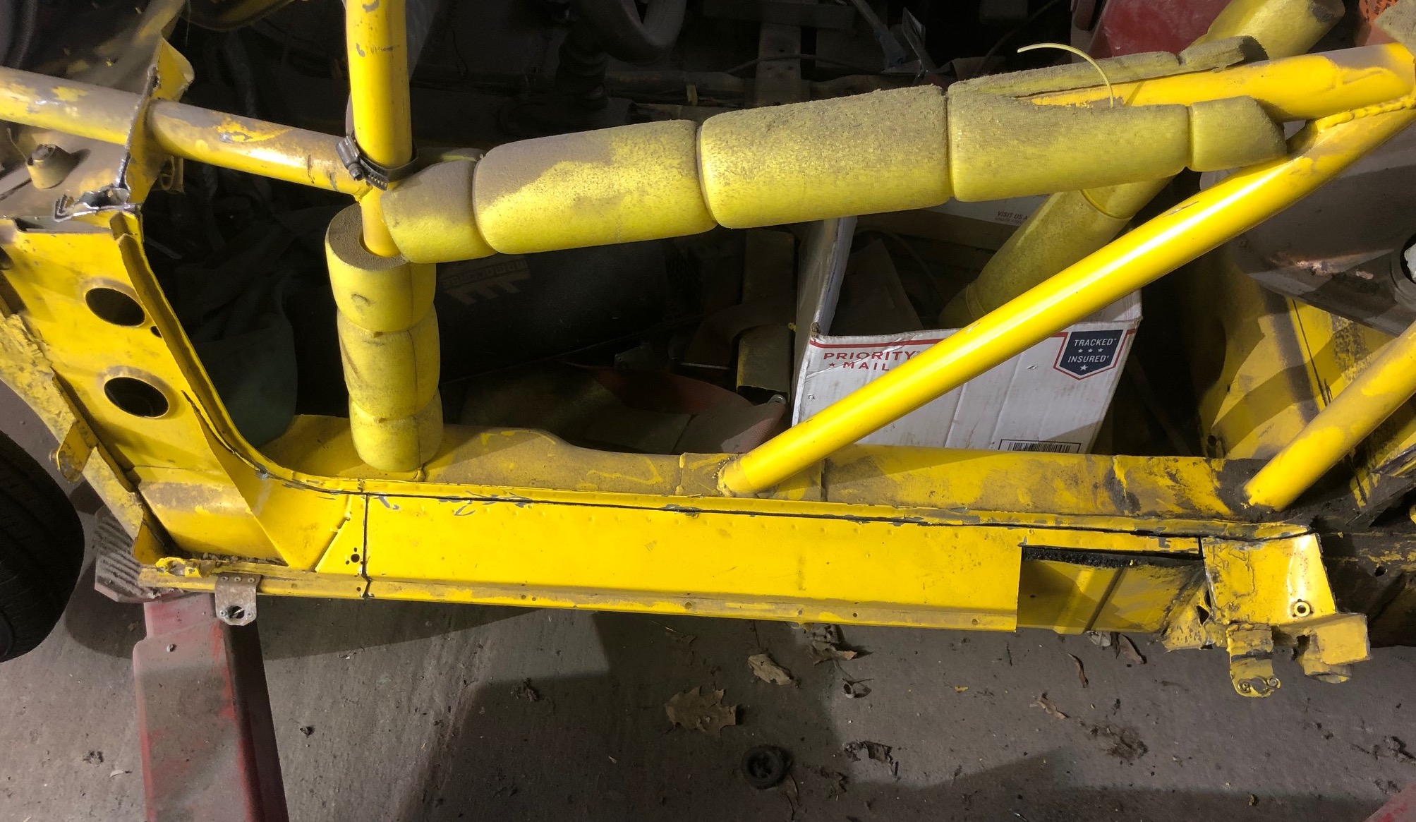

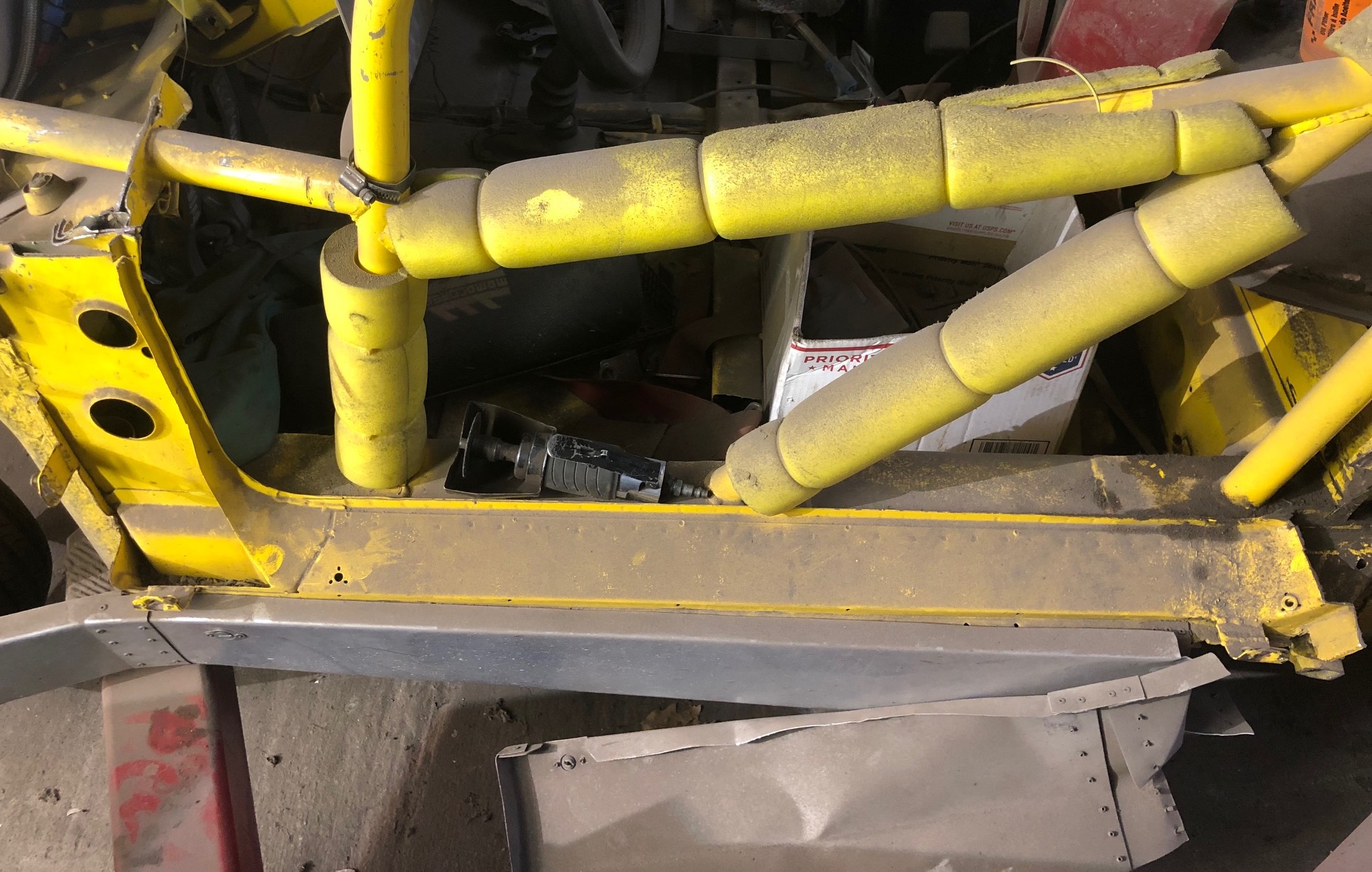

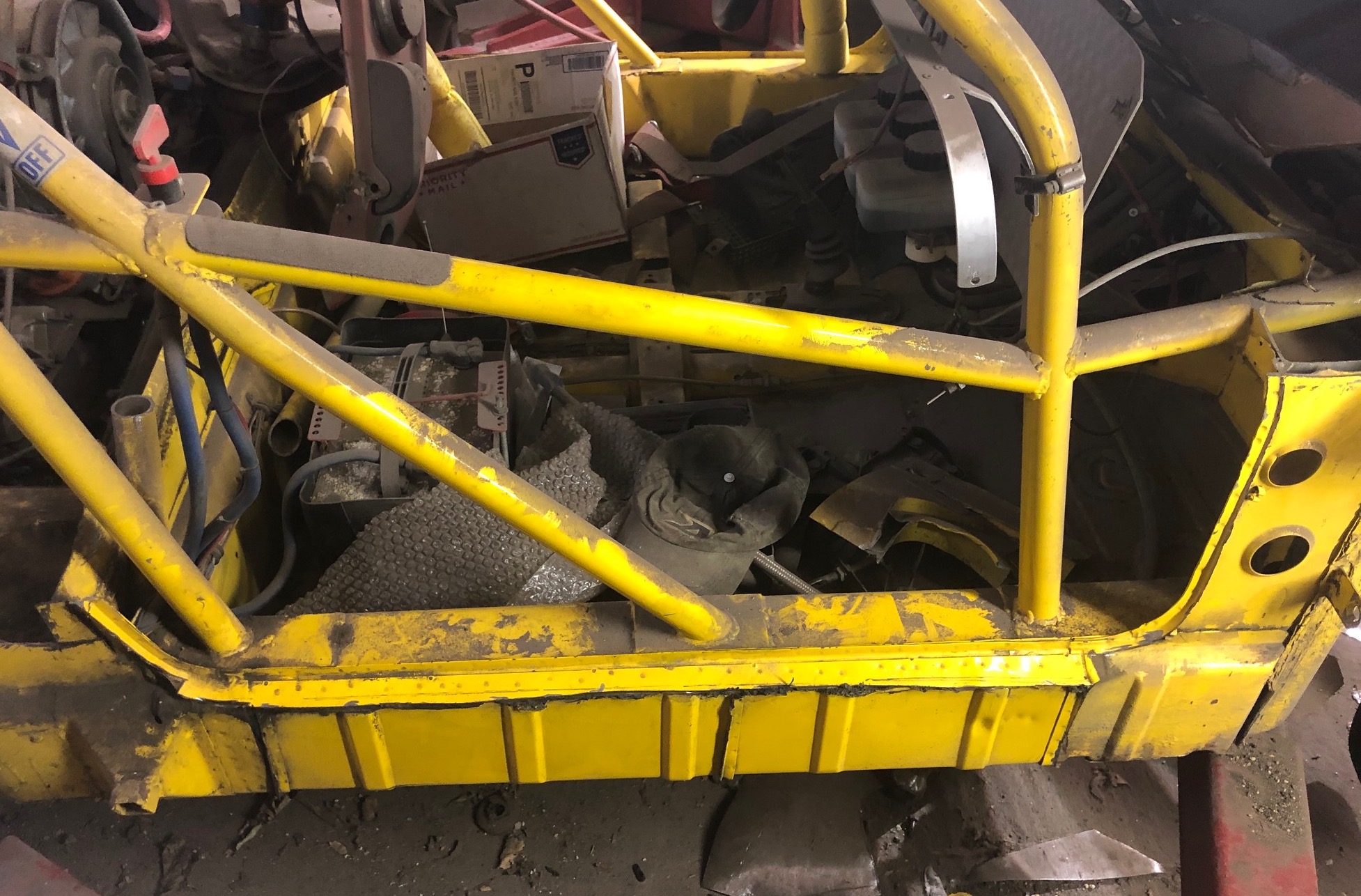

Started cutting the sides down in anticipation of the big cut, shortening the body.
Got the driver's side where I wanted it. I'm hoping I can retain the jack spur, it would be nice to have a hard jack point.

Got the passenger side done, and like most things on cars, the other side goes twice as fast as the first!
It feels really good to be humping this car again. Here's to a little bit of normal!!!! (IMG:style_emoticons/default/beerchug.gif) (IMG:style_emoticons/default/beerchug.gif) (IMG:style_emoticons/default/beerchug.gif)

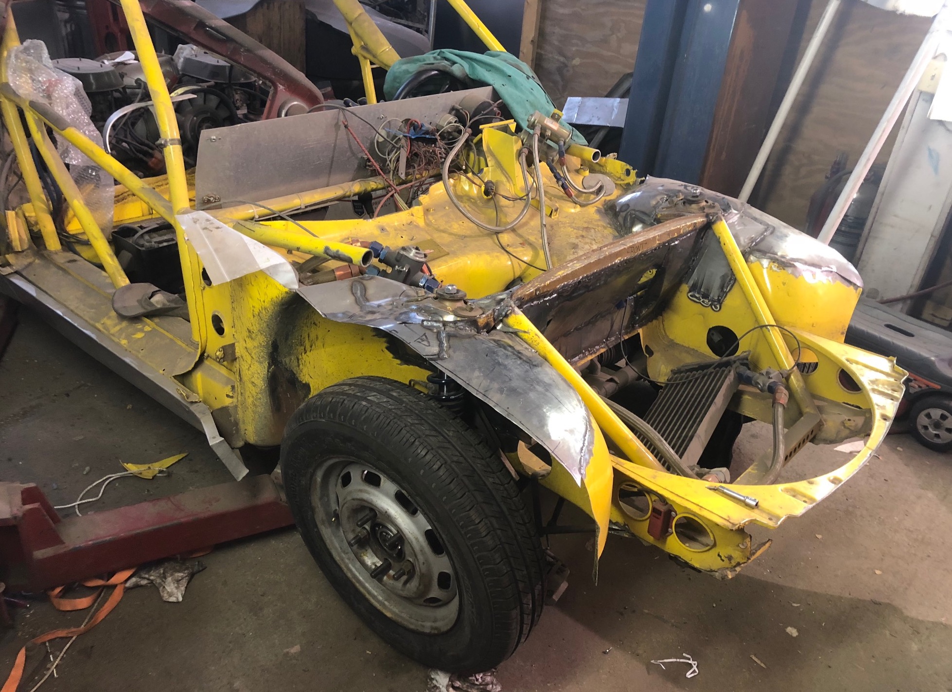

Nothing crazy today, just clearing the car for the big day tomorrow. Tomorrow we cut, the car in half! The day I've been both wanting and dreading. In order to make the 904 body fit I have to take 5 inches out of the length.
More updates tomorrow!
