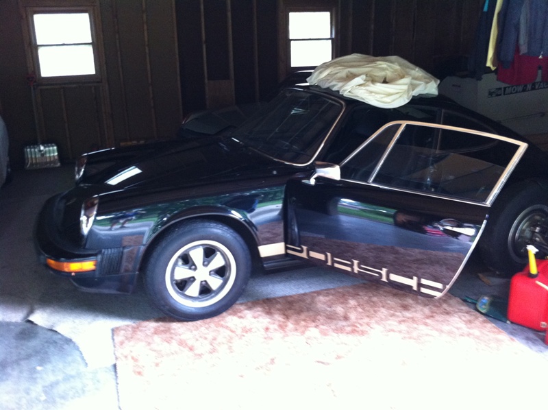

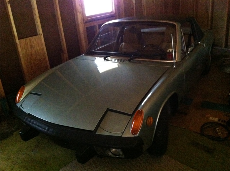

So I have been looking at some of the cars here in the midwest and I found one that might be a really nice find. Its a incredibly original 74 2.0L with 67000 original miles. it is a two owner car and had spent the last 20 years inside a garage, but has been started up and driven four times a year. it is factory painted a custom color-the owner says it is a 911 color, it is a very light metallic green. it has some surface scale in a few tiny sports. some of the undercoating on the bottom of the floor pan seems to be peeling off, but there doesn't seem to be structural rust. I looked VERY thoroughly. he is asking 8k for it.
he also has a black dealer-resprayed 1975 911s coupe in similar condition to the 914 (65000 miles) that he is asking 10 for.
Is the 914 a good deal?
is the 911 a better deal?
will I be ostracized from the 914 community for buying a 911?
Help please?
-Ross

Unless the 911 has a documented engine rebuild (with case savers and other good stuff) stay away from it. The original engines are known for breaking relatively easily, especially when fitted with the thermal reactors the 76-77 cars (maybe some 75s?) had.

Definitely no engine rebuild. The car is all original equipment. The engine would likely need sorting out from sitting so long. What would be a fair price?

Get a real PPI before you buy a 911. Then you'll know what you have to work with.

1976 is kinda the worst year for a 911
those 2.7's can have pulled head studs easily
the 1976 year was one of the worst due to the heat created from the emissions system.
and sitting isn't too kind on them.
I think bruce anderson recommended a top end rebuild on those heads with the 1976 thermal reactors at an early mileage (was it a 60,000 recommendation?)

That is the impression I am getting too. It is actually a 75', but it is the same engine. and it is seeming like even if it had just had the engine professionally rebuilt, 10 is still too high for it.

This 911 certainly has the original engine, and it is in unknown condition. It ran when it was parked 20 years ago.

If the 911 has pressure fed tensioners and a 11blade fan there is a good chance that it's had the updates.
But sitting that long and being CIS expect to spend 3k to get it driving again, BTDT.

It has an 11 blade fan and was bought from a dealer in 1983. The owner doesnt know anything about tensioners or a previous engine rebuild. He says the engine does turn over and has good compression, but he didn't want to start it on account of all the old gas. I have heard that those injection systems go bad if they sit for too long.
This car would need to have
  • Fuel lines
  • injectors
  • remove+clean gas tank
  • perhaps a new fuel pump
  • new brake lines
  • possible caliper rebuilds
  • possible future engine work including new head studs and/ or upgraded tensioner
am I missing anything?
