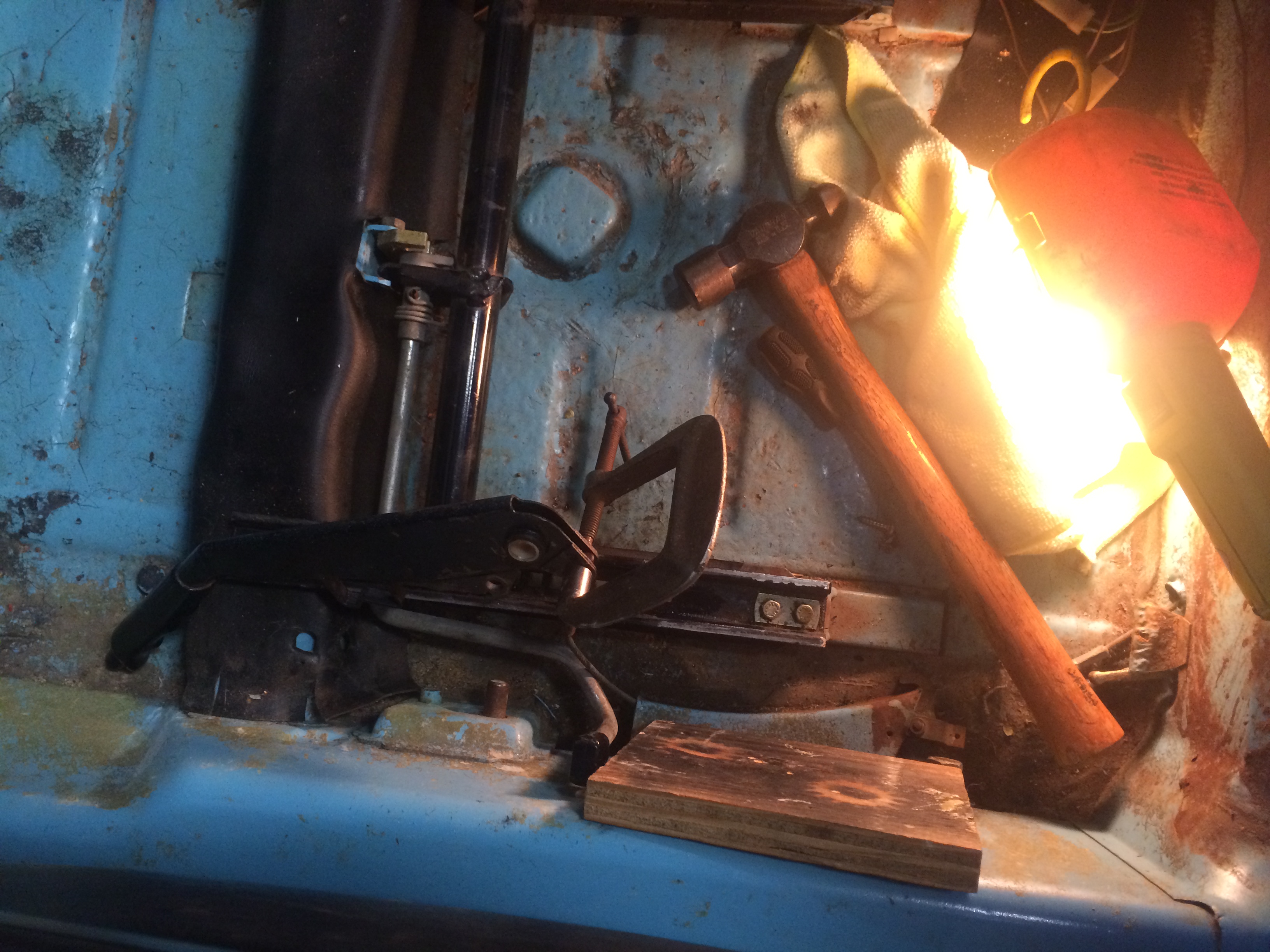

I need to take the e brake handle completely off but the cable assembly doesn't fit through the tunnel and the lever side pin seems frozen on. The picture is of me using PB Blaster and a grip to apply pressure to the pin but it's not budging.
Any ideas?

mepstein   Cut the cable. Remove the parts. R&R the parts...   Aug 24 2016, 02:59 PM
RobW   Cut the cable. Remove the parts. R&R the part...   Aug 24 2016, 04:28 PM
76-914   Have you tried the torch yet?   Aug 24 2016, 03:02 PM
RobW   Have you tried the torch yet? which part should ...   Aug 24 2016, 04:28 PM
RobW   Got lucky...   Aug 24 2016, 04:47 PM
mepstein   Good :)   Aug 24 2016, 05:02 PM
RobW   Little bit of paint....   Aug 24 2016, 05:06 PM
Tburt52359   Ok. I'm having the same problem. How'd y...   Aug 24 2016, 07:16 PM
cuddyk   On mine, the pin rusted solid to the lever. I used...   Aug 24 2016, 07:33 PM
mepstein   On mine, the pin rusted solid to the lever. I use...   Aug 24 2016, 07:39 PM
Tburt52359   Thx!   Aug 24 2016, 07:39 PM
914forme   I was not as lucky so I cut all the spot welds off...   Aug 24 2016, 08:03 PM
RobW   The other pin just came out. Kind of a bear to do,...   Aug 24 2016, 09:34 PM
