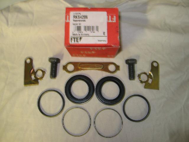

So do I have all the seals and stuff I need for the rebuild?
Heres a single front set

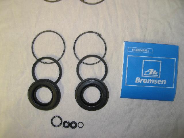

single rear set
If I'm missing anything I'll need to special order that (them).

You've got everything you need but... you've got your front and rear descriptions mixed up.
The fronts have the new piston/pad positioners.
The Rears have the o-rings. (Tip: Your rear dust cover retaining rings are too big. Get a strong pair of cutters and trim 1/8" past that overlap)
