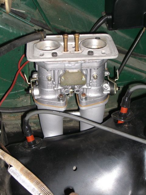

A Thing Of Beauty:
neil30076
post Oct 15 2009, 01:30 PM
Post #149
Recovering dismantler!
Posts: 397
Joined: 12-September 06
From: San Diego ( RB) CA
Member No.: 6,826
QUOTE(kenshapiro2002 @ Oct 15 2009, 12:19 PM) *
A Thing Of Beauty:
(IMG:style_emoticons/default/biggrin.gif) Way to clean, now get the other one on and get syncing!

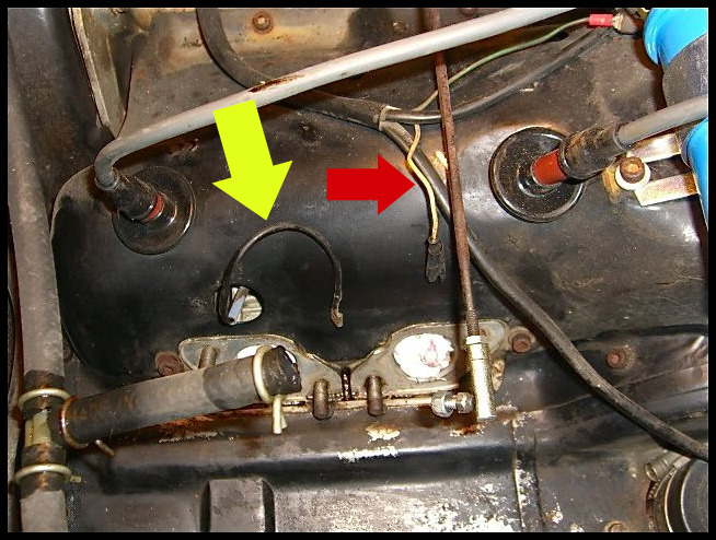

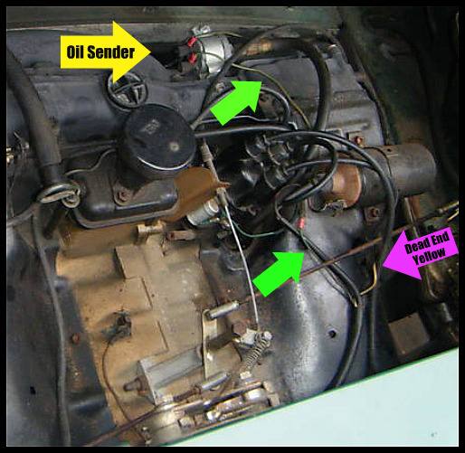

OK...so I'm back to work, cleaning off the flange for the intake manifold, when I see these two "dead" ends of wires. The red arrow is pointing to a yellow wire that is messily taped off, and the one the yellow arrow is pointing to is just lying bare against the tins. Any idea what these two guys are ?

Yellow arrow is the CHT used only for the FI system.
Red arrow may be the ambient air temp sensor used only for the FI system...
Show a pic of your oil pressure sensor...
Rich

Those are exactly what I said...both wires are not needed.
