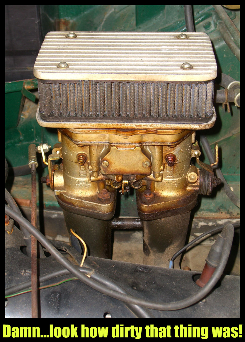

Here goes. Got everything buttoned back up. The linkages (sorry Mike) dropped right back into the throttle arm hole perfectly. Yeah...I know...I still need to adjust them to perfection. Let the fuel pump work her magic, hit the key, and she fired right up. Only leaks were right at both of the plugs under the fuel filter (could have been the actual fuel lines just running there), but stopped on it's own after a few minutes.
She idled beautifully after a few "burps" and ran for about 3-4 minutes when she just died, like she did the other day before I got into the carbs. This is what happened out on the road and caused me to get into the carbs. After 10 minutes or so, she fired right back up and ran for another few minutes before doing the same.
My logic is that this is either not carb related (fuel pump?), since the settings on the carbs were not touched before the "crap out" on the road, and the carbds have now been cleaned, tightened up, floats correctly set, etc.
Chime in my bruthas.
