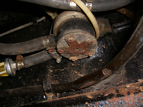

No idea what kind. I had a shot of it in another thread. I'll see if I can find it. It looks like it was sitting in a bucket of shit for a few decades.
QUOTE(Vacca Rabite @ Oct 19 2009, 03:04 PM) *
I forget if you have mentioned it earlier. What kind of fuel pump are you using? I agree that it sounds like you are draining the carb bowls and then your pump can't keep up.

Here it is:
Gint
post Oct 19 2009, 02:12 PM
Post #224
Mike Ginter
Posts: 16,108
Joined: 26-December 02
From: Denver CO.
Member No.: 20
What the hell kind of pump is that? Never seen anything quite like it.

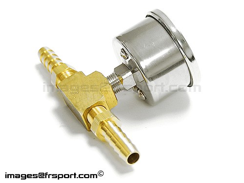

jmill
post Oct 19 2009, 02:17 PM
Post #225
Green Hornet
Posts: 2,449
Joined: 9-May 08
From: Racine, Wisconsin
Member No.: 9,038
Splice the gauge in before the furthest carb from the "T". That way you'll know your pressure is good up to the carb. You'll need to buy the gauge block with 2 fittings for your fuel line and the gauge. Brand doesn't really matter. Just be sure that the gauge glass isn't some cheesey plastic that will crack or pop off in a week.
Plugged suction is anything from a kinked line to a plugged filter or sock. You could even have some old hose that can't handle being under a vacuum. As I recall your pump is by the engine. Your flex line could even be sucking itself closed and limiting the volume.

I'm guessing that the gauge block is separate from the gauge, right? Is it a "T"? My pump is right under the hell hole. By "flex line" you're talking about my fuel line, right?
QUOTE(jmill @ Oct 19 2009, 04:17 PM) *
