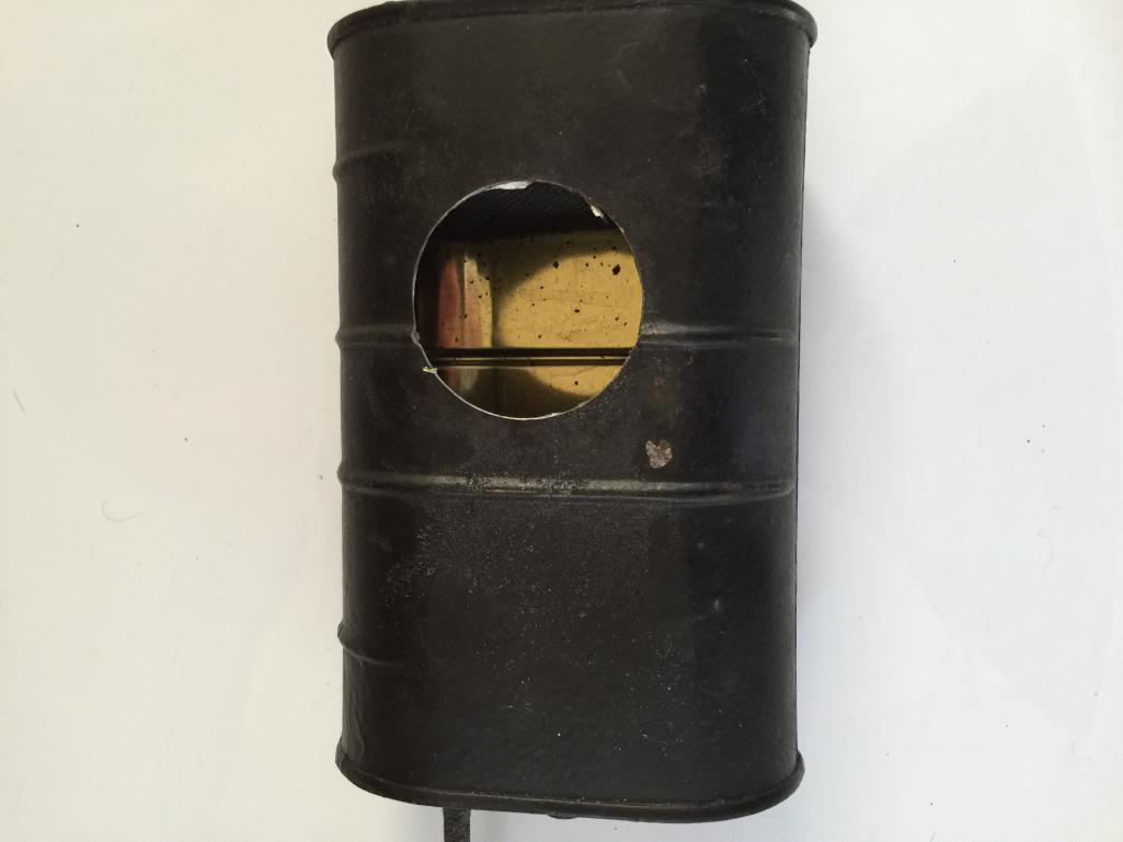

In the past I:
Ran new fuel and vacume lines
Cleaned the interior
Replaced seals and gaskets on the fuel injection
Today I decided it was time to replace the charcoal in the canister next to the fuel tank
I purchased some replacement charcoal on Amazon. I've read that this isn't optimal but I feel it's got to be better than leaving the 45 year old origional mixture in the car.
mepstein   Getting rid of the gas smell   Feb 28 2015, 10:40 AM

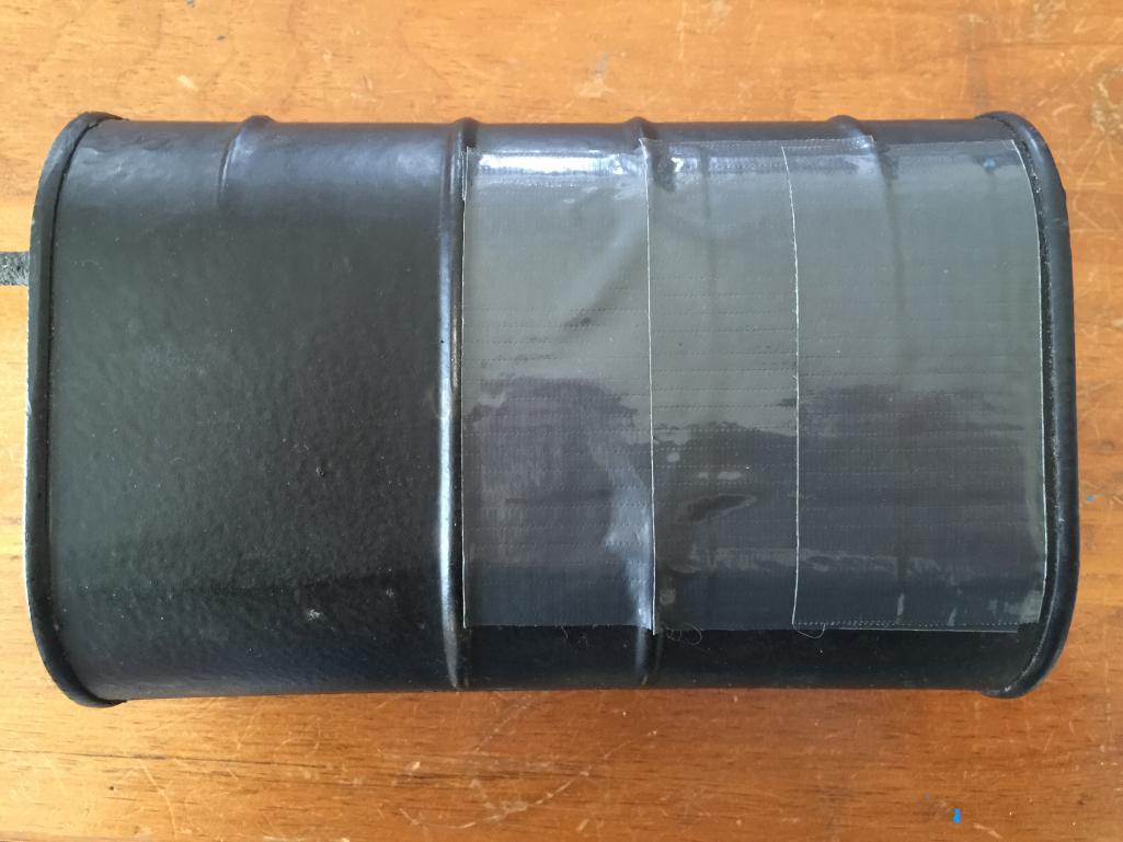

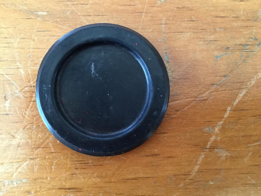

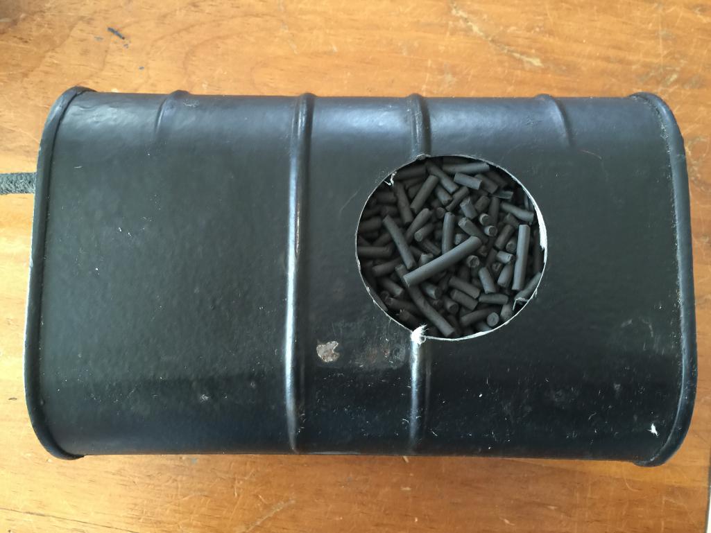

mepstein   Unlike the mid and late model 914's, on the ea...   Feb 28 2015, 10:43 AM
mepstein   Originally I drilled a small hole but when I dumpe...   Feb 28 2015, 11:01 AM
porsche913b_sp   Keep us updated if it gets rid of the gas smell. I...   Feb 28 2015, 11:27 AM
mepstein   The new lines, clamps and seals made a big differe...   Feb 28 2015, 11:35 AM
mepstein   Next time I'll use a hole saw with the same di...   Feb 28 2015, 12:42 PM
